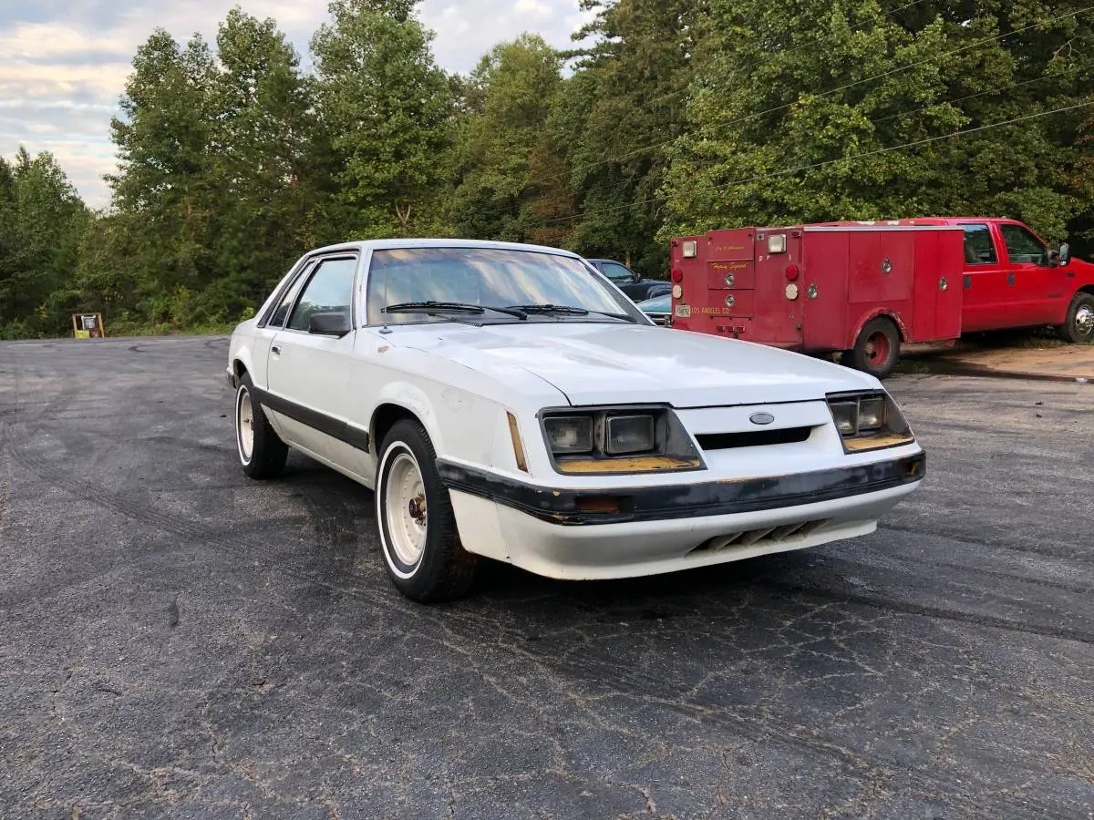

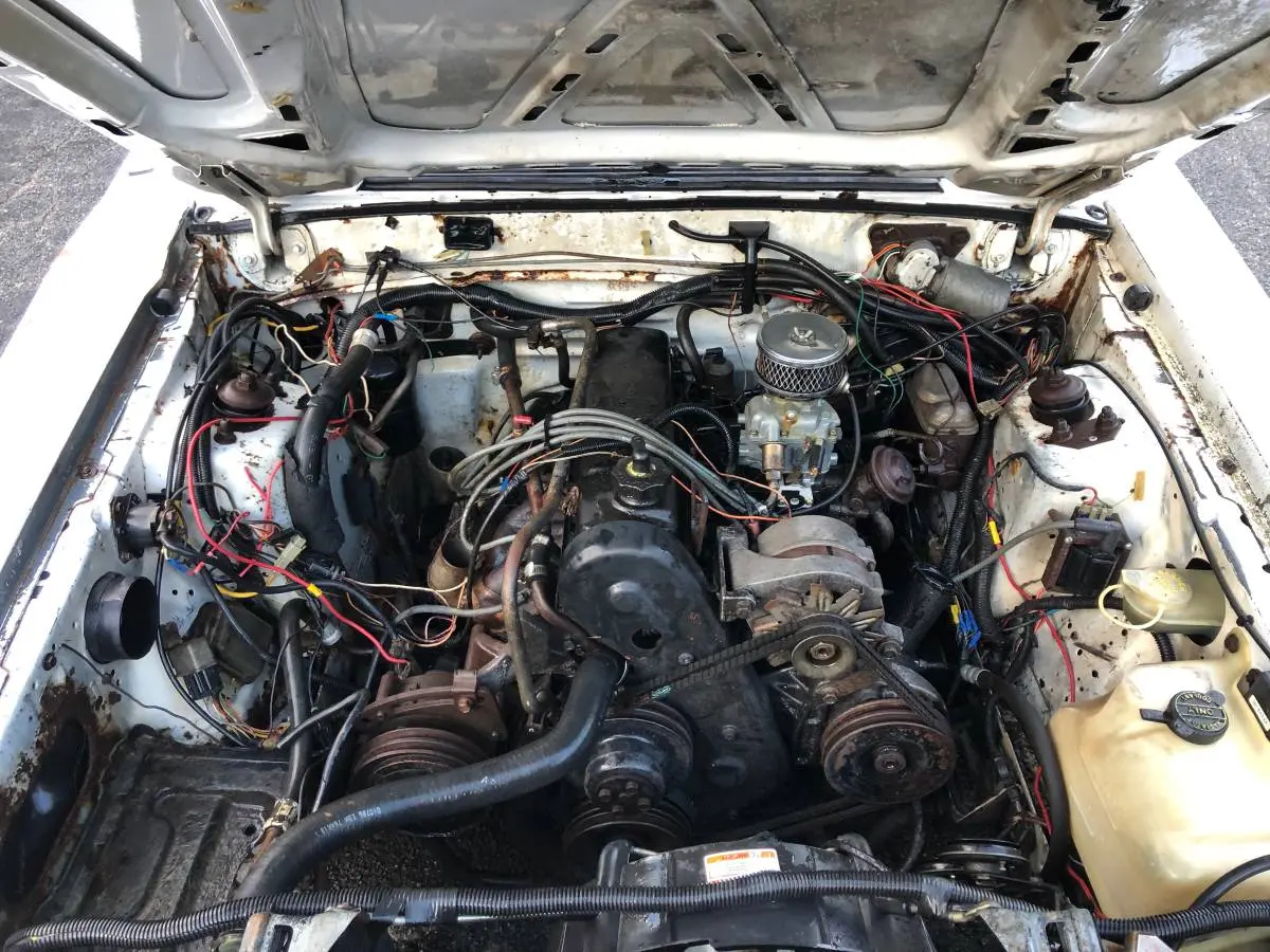

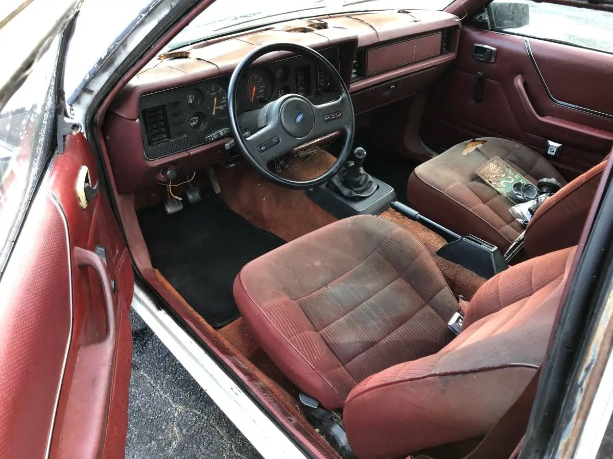

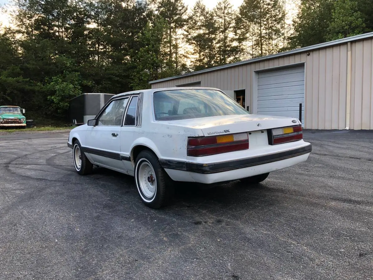

OR..... if you wanted to stick with a Fox for all of the reasons Mike said, there's this one.....
1986 Mustang Coupe - cars & trucks - by owner - vehicle automotive...
1986 Ford Mustang Coupe. 4cylinder manual. Needs fuel pump. It will run if you put fuel in the...
atlanta.craigslist.org
They're asking $1200
Dammit. I still have some Fox suspension stuff too. This is a Fox I would like. Hatch. Check. Four Eye. Check. Seems solid. Check. But it wouldn't cause Mike's right eye to twitch.
I'm busy the next 3 weekends, so we'll see if it's still out there or something like it. There's a 63 Falcon in Tulsa I'm keeping an eye on. Atlanta's closer.
Reactions: LILCBRA

I would definitely look at the front frame rails on that 86. It looks like the surface rust around the battery tray area spreads down toward the frame rail on that side. Then there's the driver side, who knows how much brake fluid may have spilled down that strut tower and compromised that side. Outward appearance looks like a viable candidate though. If I didn't have so much going on with my house I'd consider looking at this one for myself and use my convertible for parts.

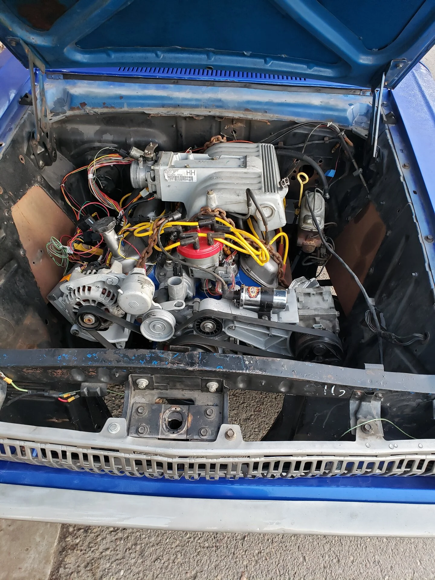

I hope to hell its there when you get back too.
I also hope you’re paying attention to the other guy on here that’s putting a falcon together.
This is what you get to look forward to: You can’t even get a fckin 302 to fit w/o cutting the shock towers out of the thing.
He's gonna be running a 2.3, its a lot narrower than that.
not when there’s a turbo manifold big enough to support the power he’s planning on making, and a twisted, forward facing plenum in the build.
I bet he has to notch the shock tower on that side at most.

If there's a Falcon, the $400 K member converts the front end to Fox. The fabricated shock towers are pricey, but would be pretty easy to fab. ESPECIALLY now that we have an Amada 3kw ENSIS laser, a turret punch, and a couple of press brakes at work. And oodles and oodles of 11, 14, & 16 gauge sheet metal we run and tons of drops we scrap.
Even if I didn't do the Fox K member conversion, I notched the shock towers on a Maverick when I was 17 or 18. It's not rocket surgery. Especially nowadays if you finagle a coil over spring in there, could probably cut it 2" deeper than I did then.
If I go with an actual Fox, it would probably get a tubular front end, so the frame rails in front of the strut towers don't matter. The roll cage will tie into the strut towers to stiffen it up.
Is that full exploder front dress....accessories are wider than the engine. Looks like a MII conversion. That's pretty cheap too, but for drag racing, I don't think enough suspension travel.
You do realize Ford put Windsors in them from the factory? You don't have to cut the shock towers to put a Windsor in it.
We'll see in 3 weeks what's what.
The title is listed as. 'lost' on that one, investigate it first,
there are a bunch of 260/289/302 engines in first gen falcons without taking the shock towers out, he put a mustang ll type front suspension in that one
