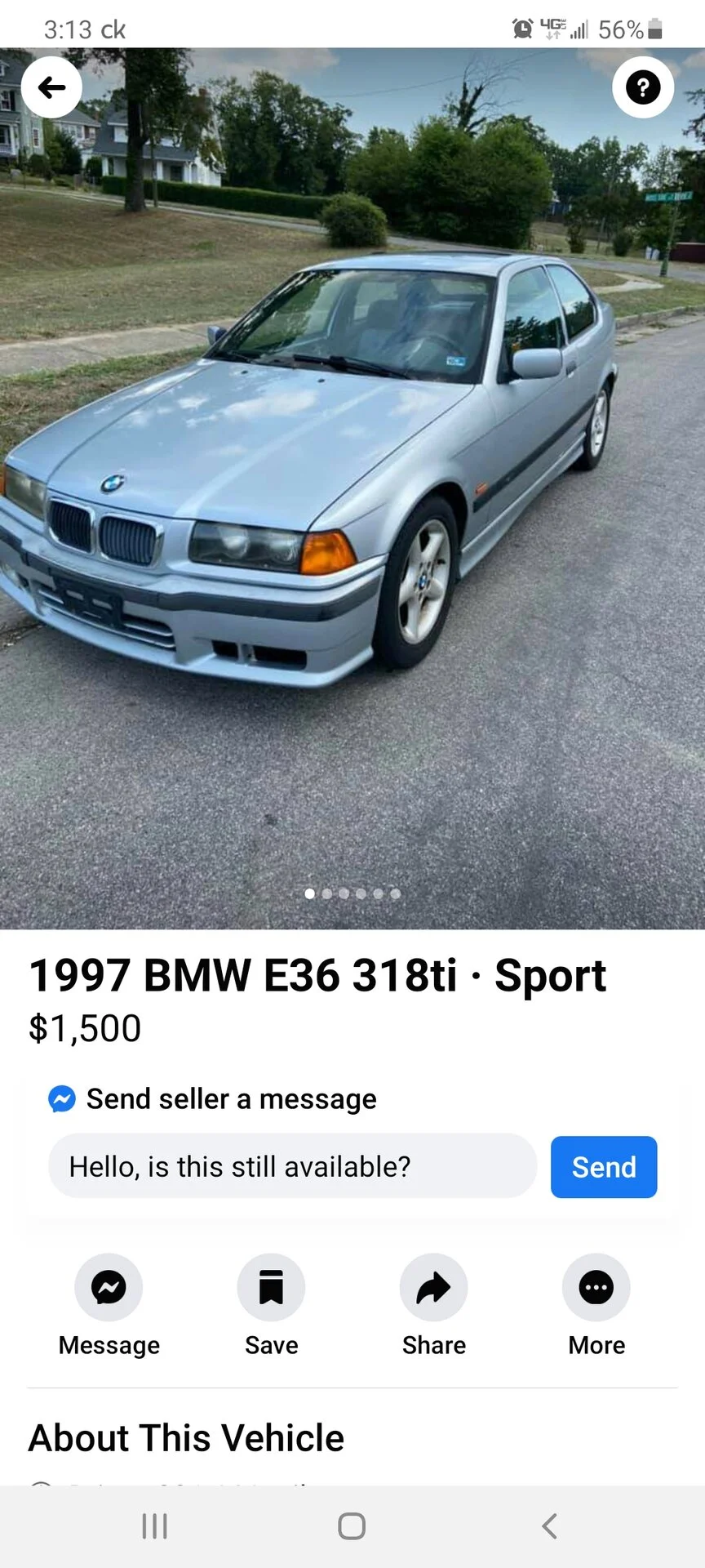

There was a 3 series roller with a cage in came up on FB last week. I thought about posting it, but figured the Falcon was already driving Mike over the edge enough to drink out of a metal can.
