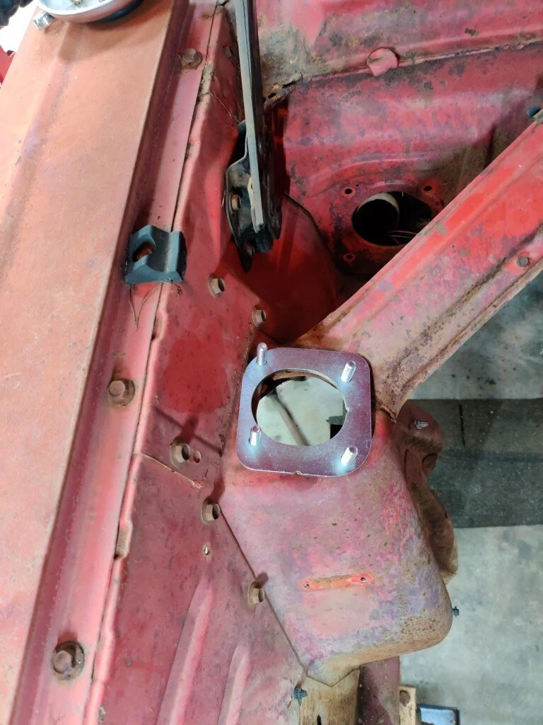

Today I think the goal is to get the front bumper and fenders off. Depending on how that goes, remove the front suspension. I need to make sure the SN95 caster camber plates aren't too big for the top of the shock tower. My other thought was to go to the JY and cut off the tops of an SN95 strut tower. But a quick measure and eyeball says the Maximum Motorsports CC plates will work. If I get that done, I'll start figuring out how much of and where to cut out the shock towers.

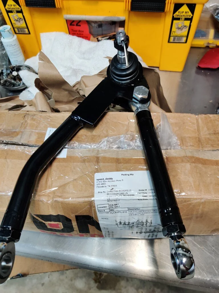

I also opened up all my 'goodies' that have come in this week. Manual rack, CC plates, control arms, bumpsteer kit, Evaporust, and a couple of cans of weld thru primer.

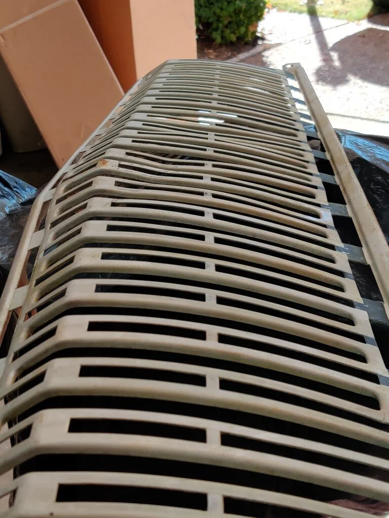

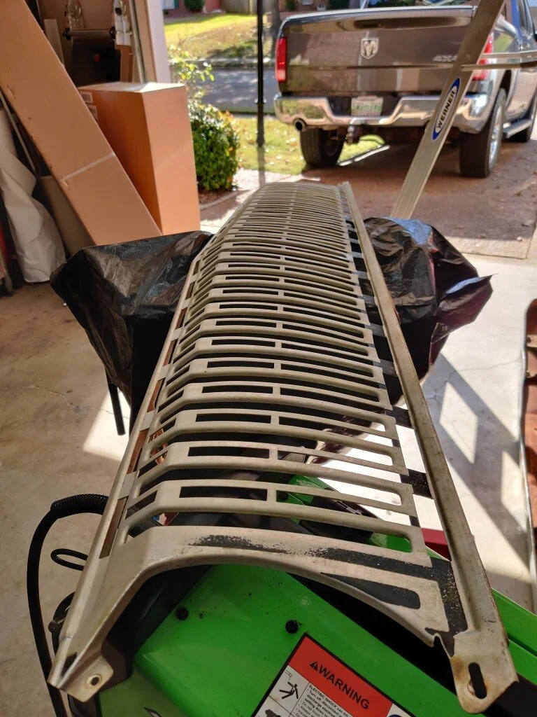

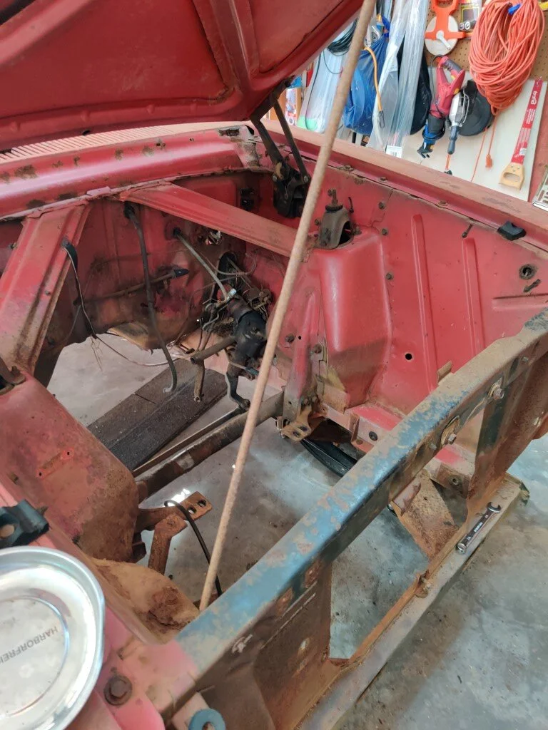

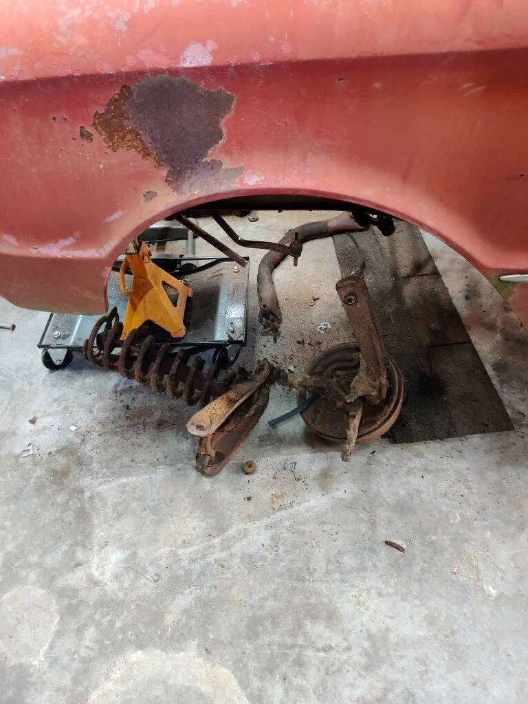

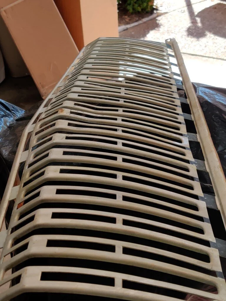

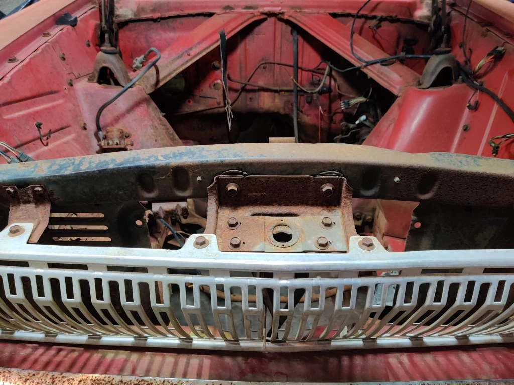

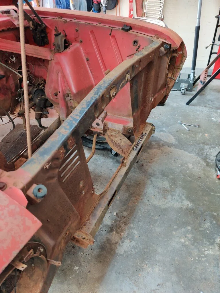

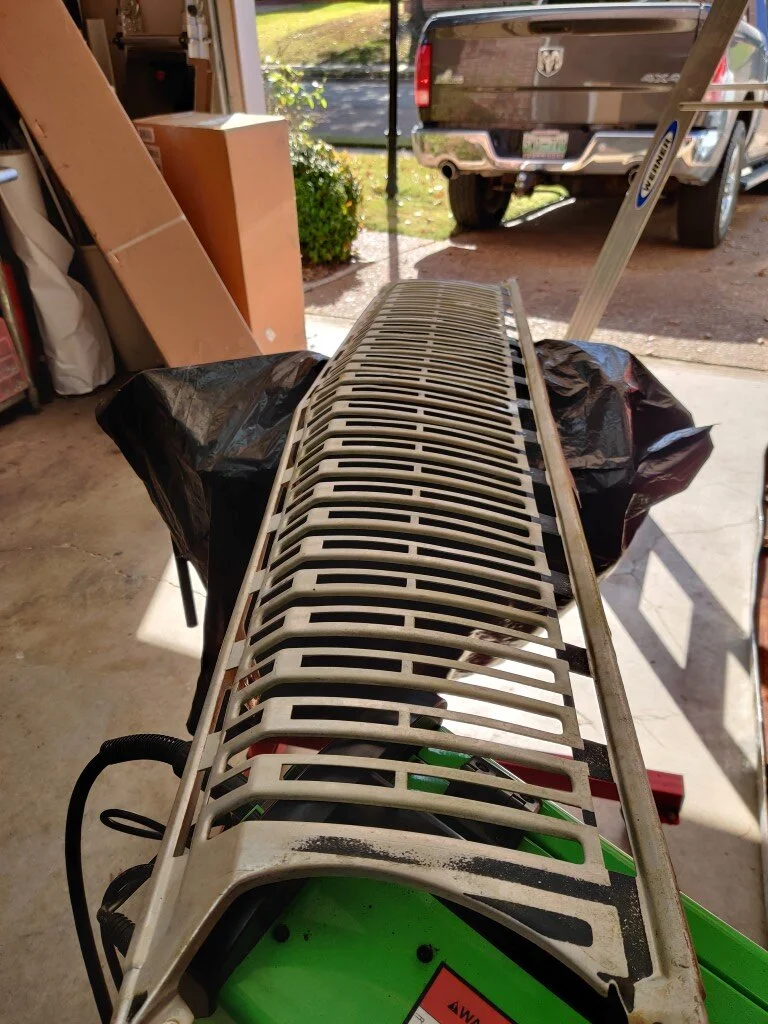

Woohoo. It's Modelo time. It turned out to be pretty damn warm today. About 84 in the garage. But I got alot done. I removed the grill, bumper, and front suspension dropped out.
I even did a little 'body work' on the grill. It had a crease down the front that I got worked out. I'm not body guy and I didn't want to get too carried away. But it looks good. Not perfect, but come on, have you seen the car???
I'm still thinking about how much of the shock tower comes out and how that hole gets filled back in. I also got the caster camber mounting plates out and laid them on the shock towers. Plenty of room. I'll have to figure out how I am reinforcing the towers. Probably a little extra metal on the top. The export braces are coming out. I'll probably come off the cage with some tubes to stiffen it back up.

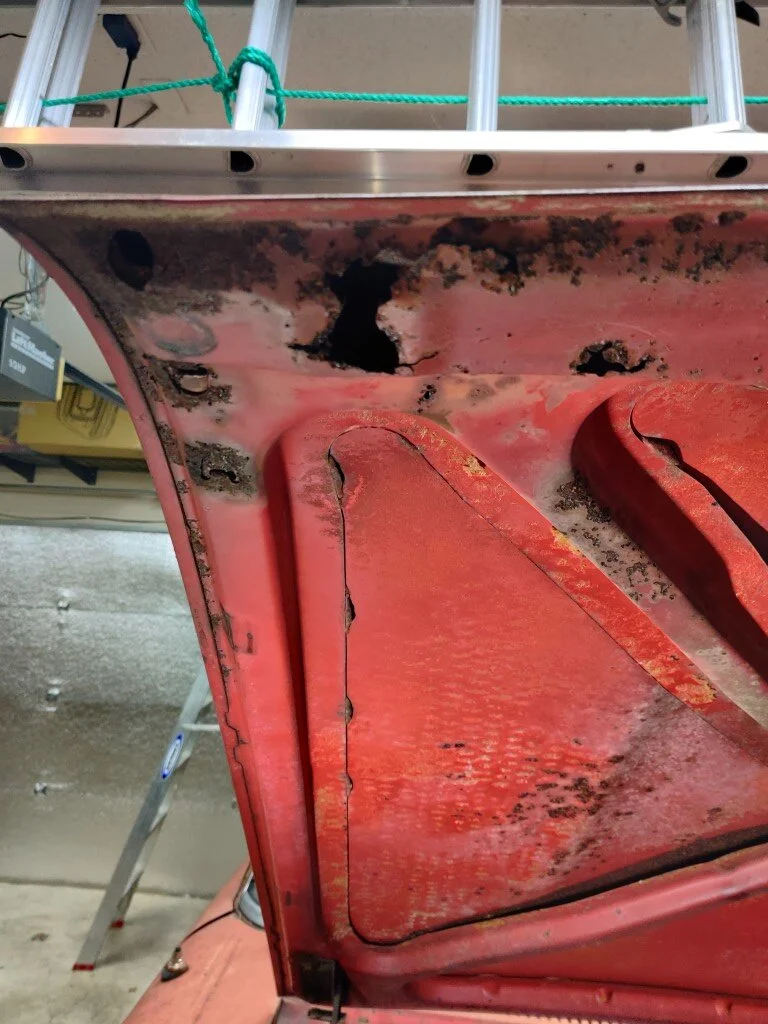

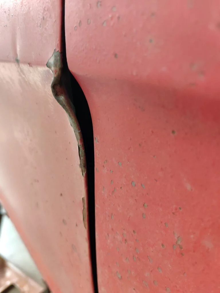

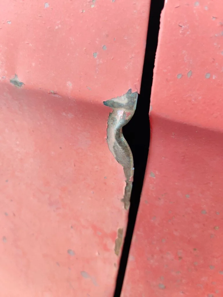

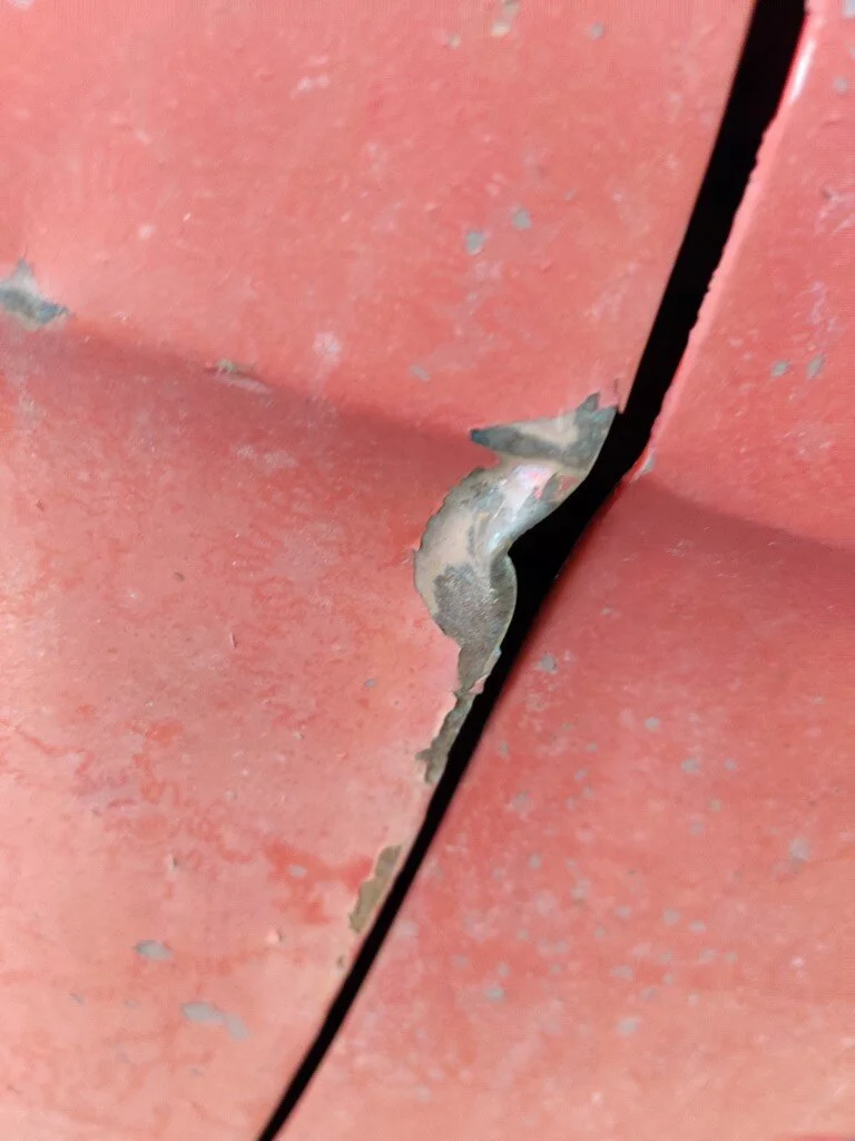

@Davedacarpainter What say you about this? Looks like the hinge is broken...the part that limits how far the door opens and this happened. I took my small hammer and hit it a couple of times, but it didn't really move. I don't want to make it worse. What's the correct way for a novice to work with this? Pay someone who knows what they're doing? :thinking:
Very cool project Drew:nice:
Do you have a hammer and dolly set?
Life will be easier for you trying to straighten this with either the fender off or the door off.
It‘s called a check strap, btw. The thing the stops the door from swinging way out.
No, I think I need to go buy a hammer and dolly set at the HF. Both will eventually come off. The fender first. But the door hinges will need to be rebuilt and the door is WAAAAY back...like no gap at the b pillar. Not sure why yet. Tomorrow I'll post some pics of the driver's door. Looks like it was hung on the fender and manhandled open. The entire front edge is bent out.
