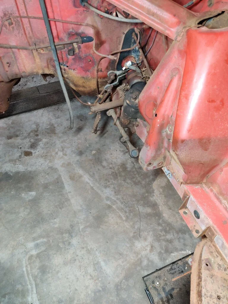

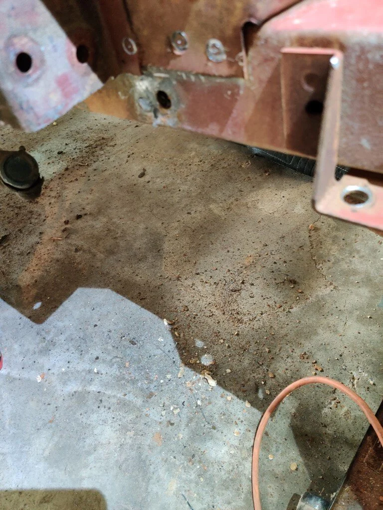

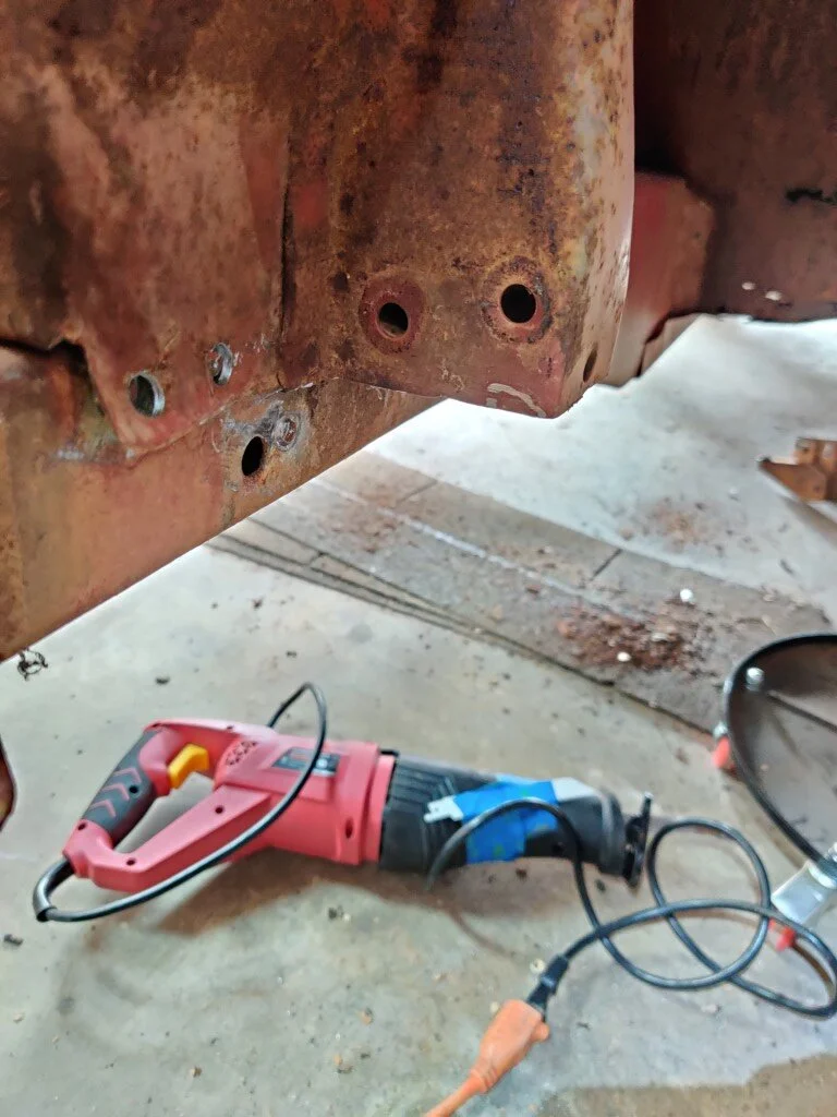

It doesn't seem like a did a lot today, but I put a solid 5 hours in. 3 words. Spot weld cutter. They are a blessing and a curse. They do their job, unless they break. At least I thought ahead and bought 3 at HF and the cutters are reversible so 6. Good thing too, because I was down to my last one after only doing about 12 spot welds on the bottom of the shock tower and the motor mount/lower control arm mount. I wanted to get that off, because then it's just a matter of deciding where/how much of the shock tower to cut out. I can get the K member mounted and mock everything up to make sure I can get the alignment in spec. I've seen online some guys using this k member on Falcons have to move the top mount up and out a hair. It's based on a Mustang and if you look at the shock towers in a 65 Mustang and a 62 Falcon, the top mount on the Falcon is a couple of inches lower.
With a cut off wheel, a grinder wheel, and a sawsall, I managed to get that part off and I don't believe I mangled the frame rail much. I took a bunch of crap to work and threw in the scrap metal trailer.
It's amazing how much chit falls out of the rest of the car when I am hammering on the front!

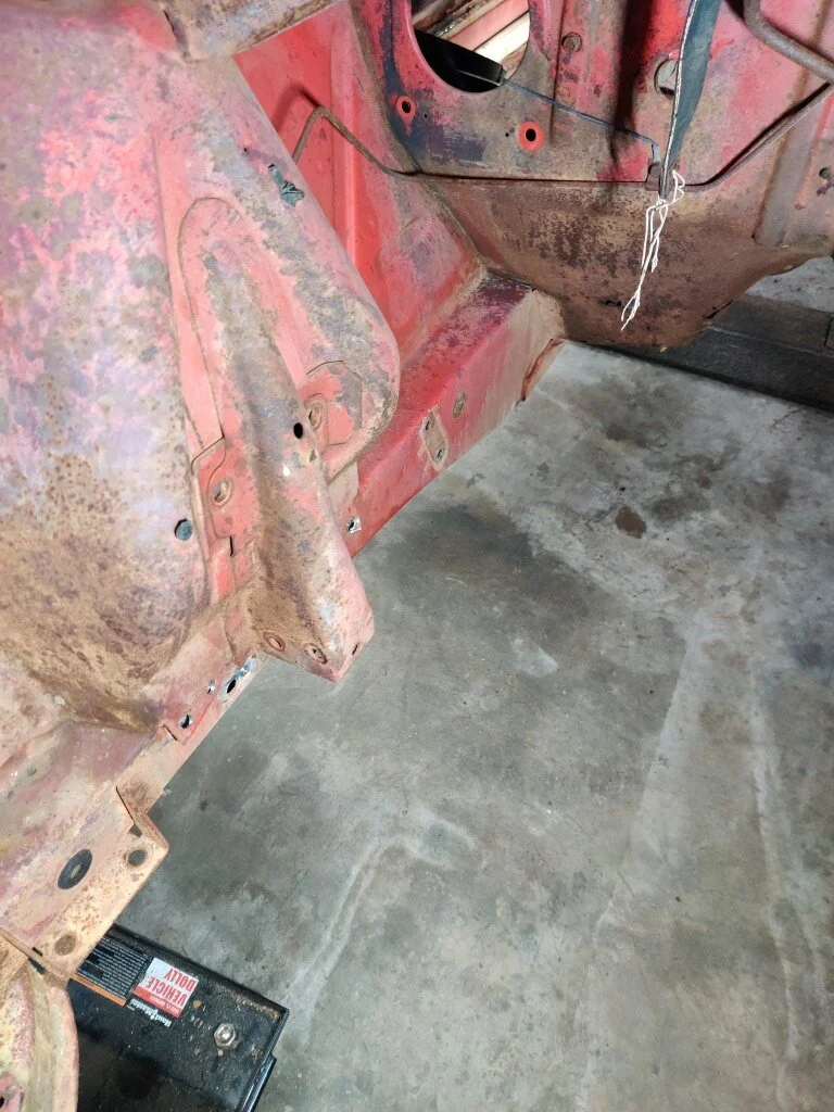

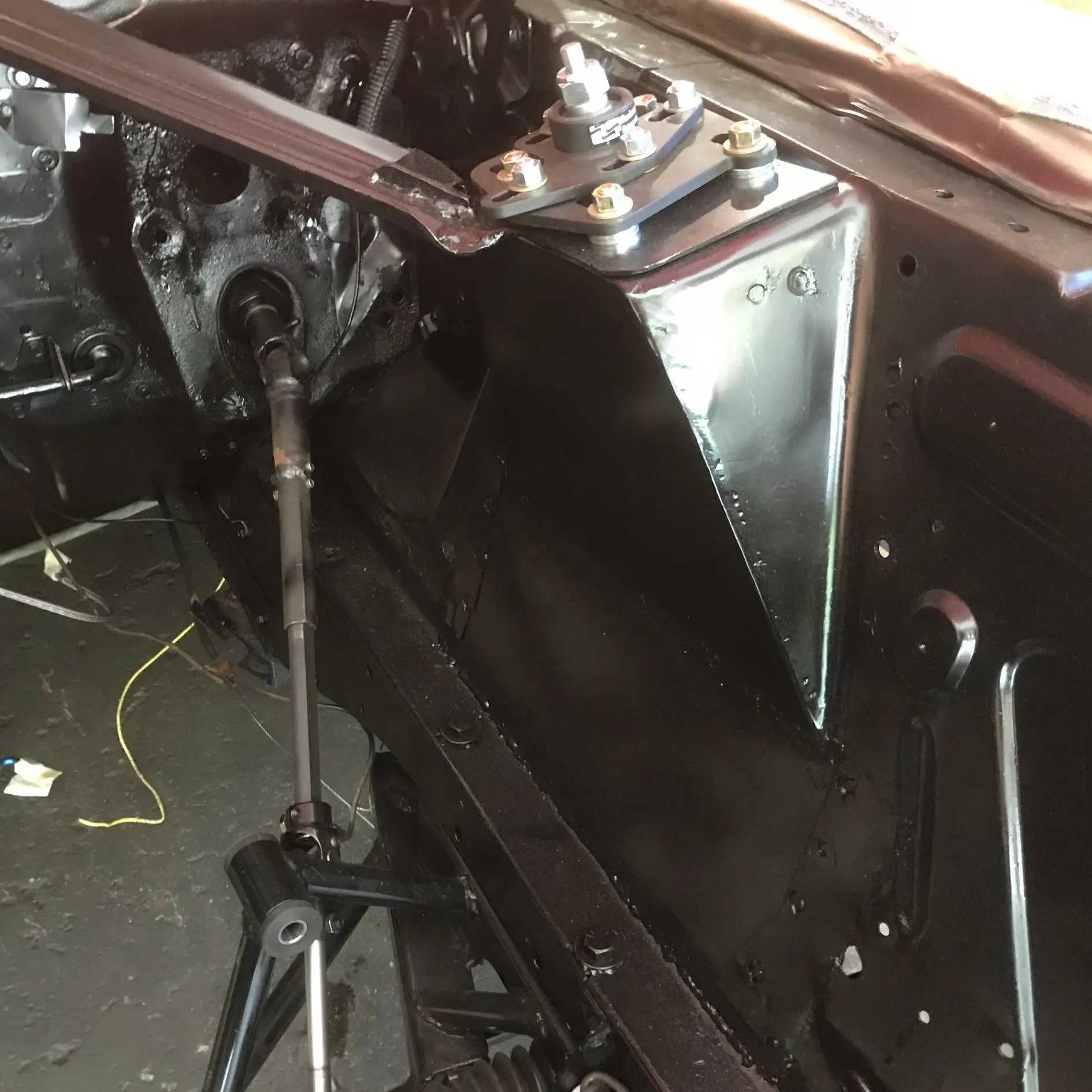

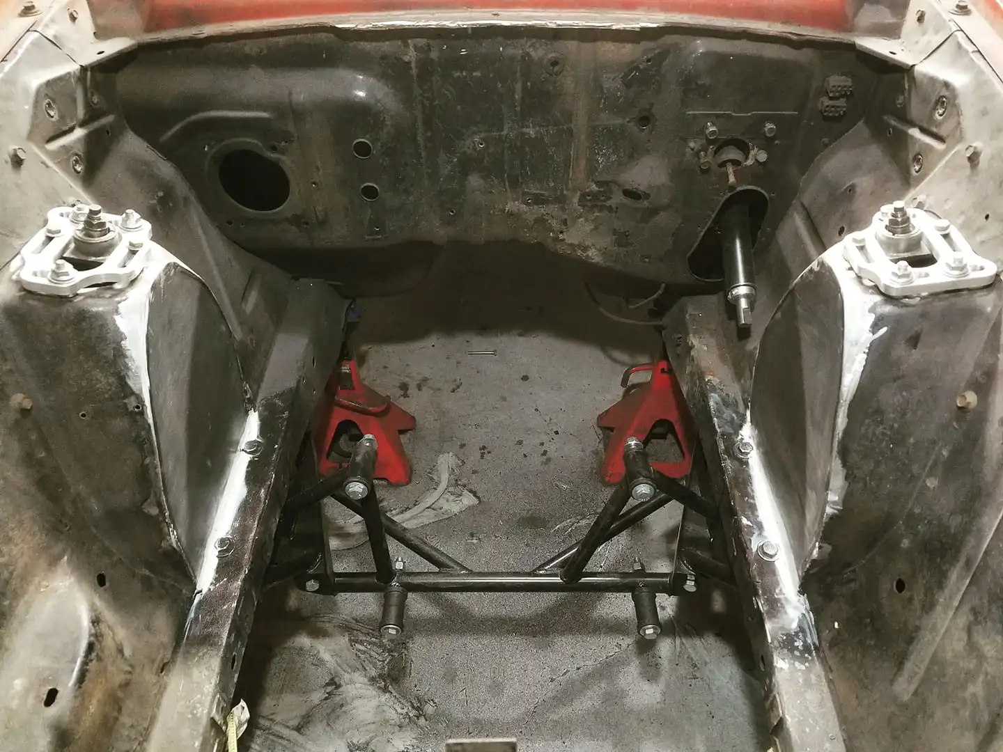

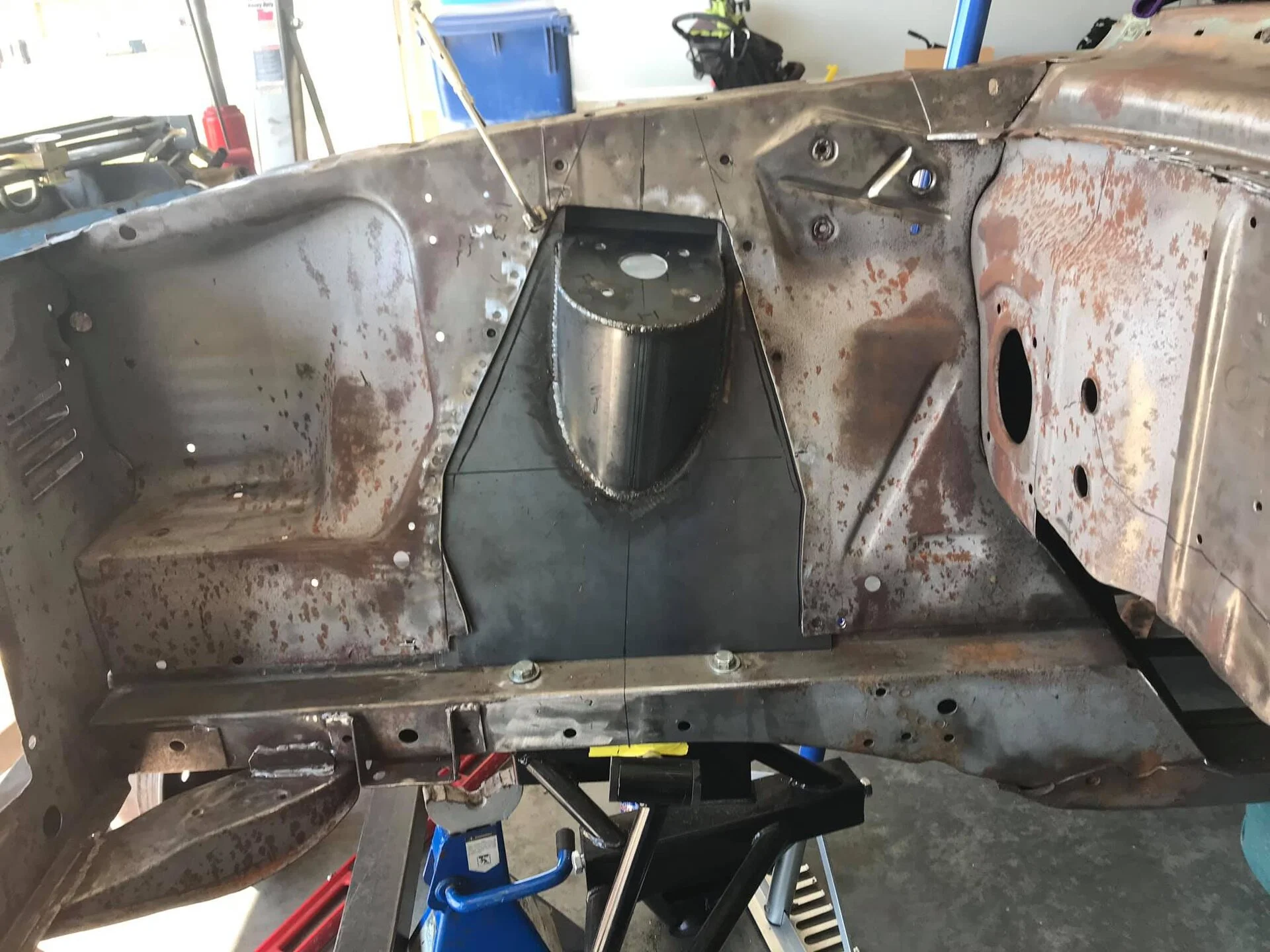

The fckn internet is amazing. I learned all sorts of chit on the AJE Colt 65 FB Group yesterday and spent some time messaging a dude doing the same thing on a 64 Falcon.
So I have all week to sit and plan and plan and sit to turn this:
Into this
Or this:
Or even this:
I measured the top of the shock tower and it's 12 gauge so I ordered a 2'x2' piece of 12 gauge to make the fillers. I might also take a piece of it and weld to the top of the shock mount to help reinforce it.
I am looking at cheap plasma cutters on Amazon. Anyone have any experience with these sub $300 beauties?
