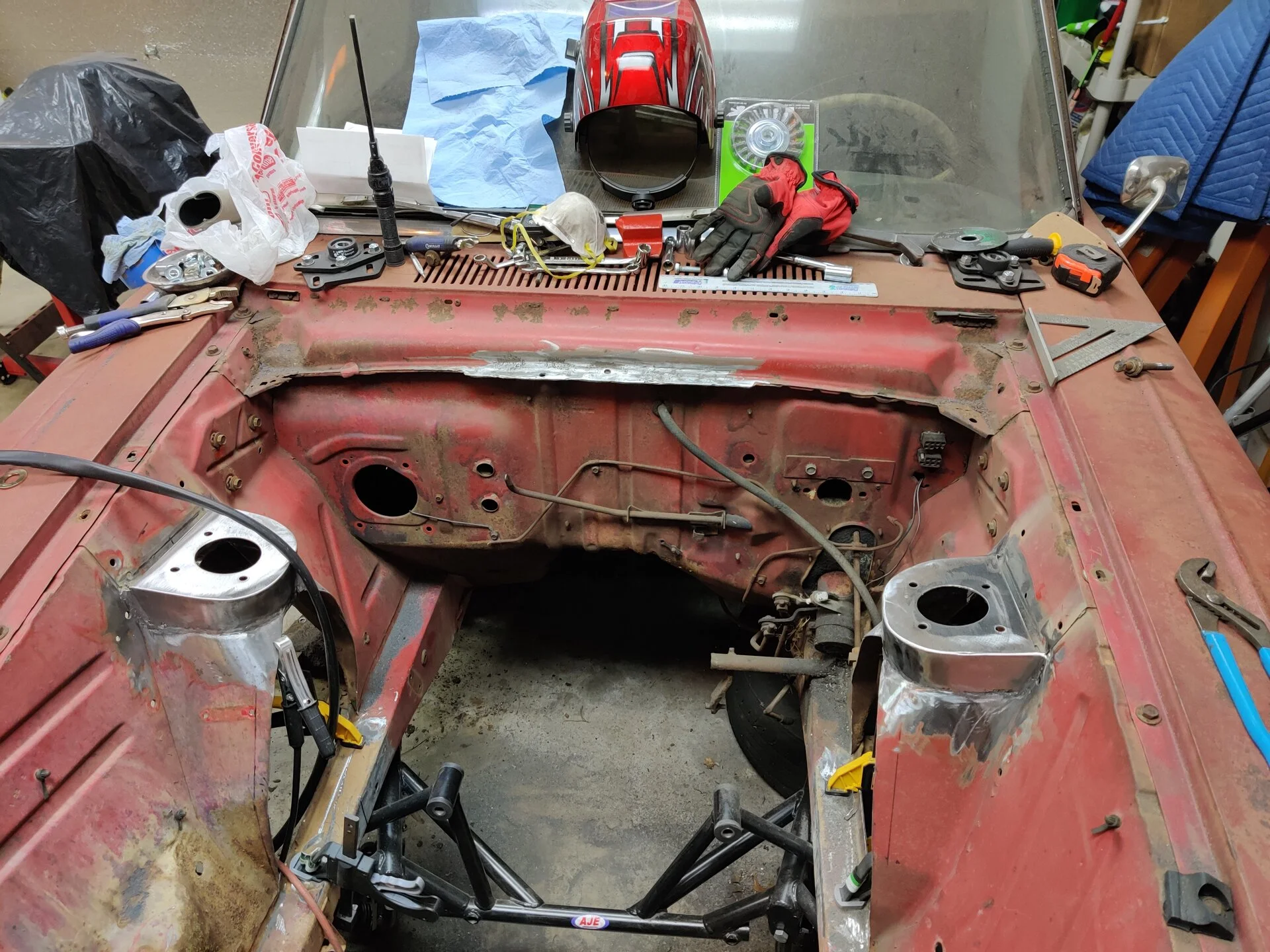

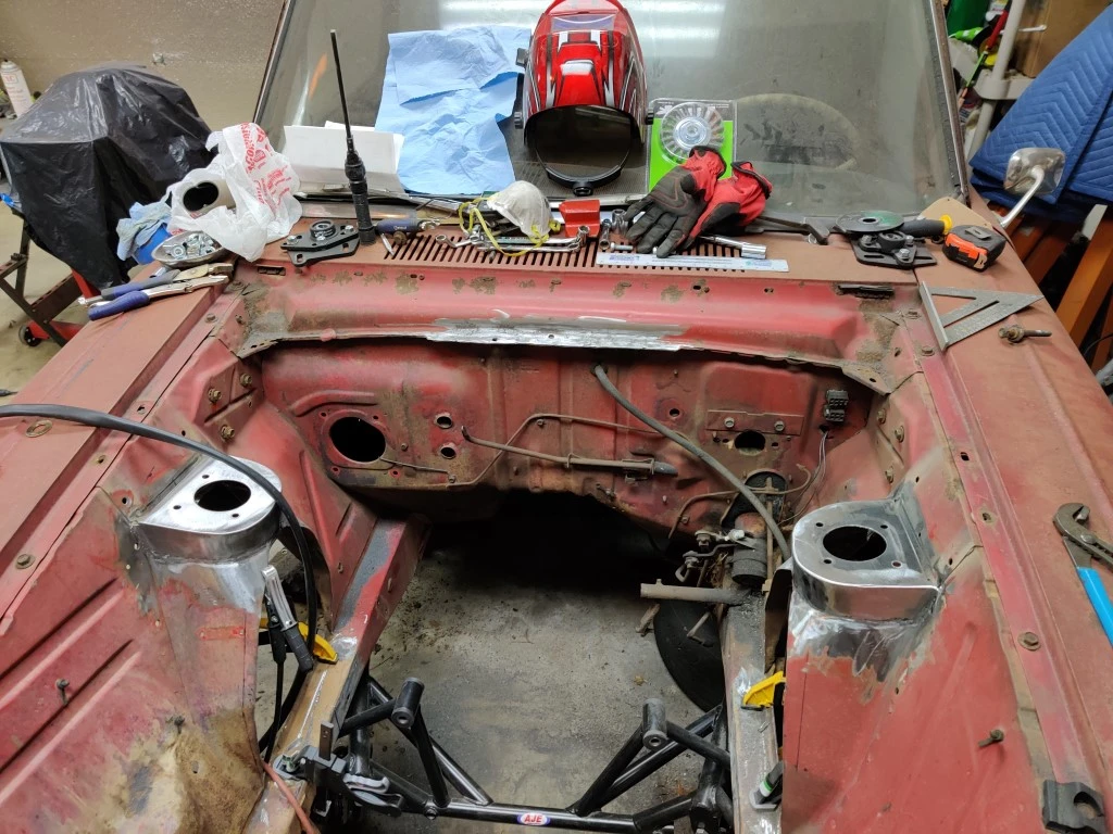

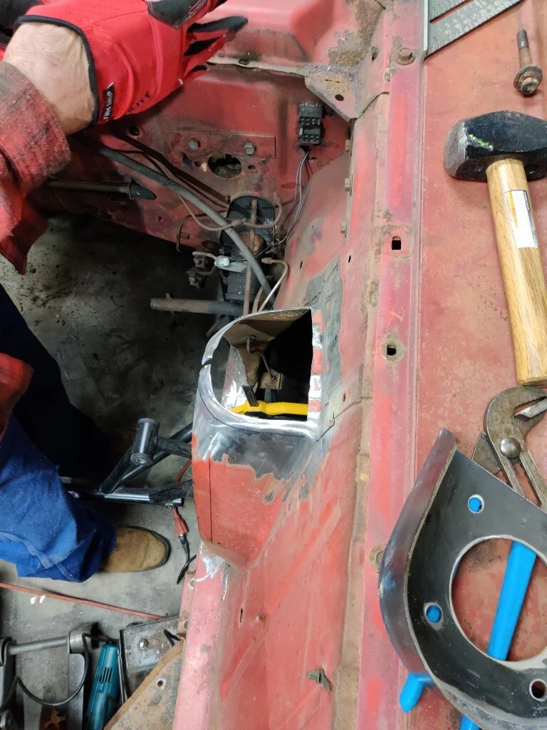

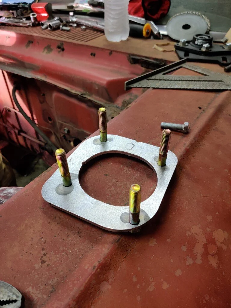

The shock towers are cut out to make way for the Fox/SN 95 strut suspension. Those will be filled in with 12 gauge sheet metal. No today's progress was making new strut tower top mounts that are 2" higher to get the ride height and strut stroke to jive.

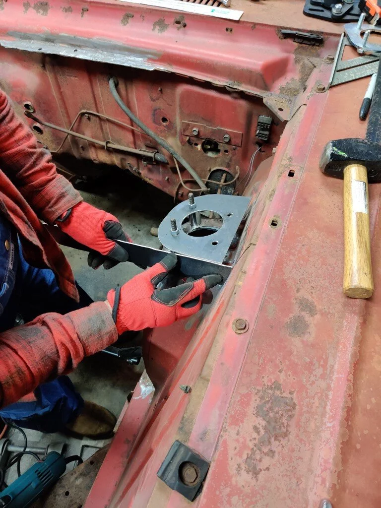

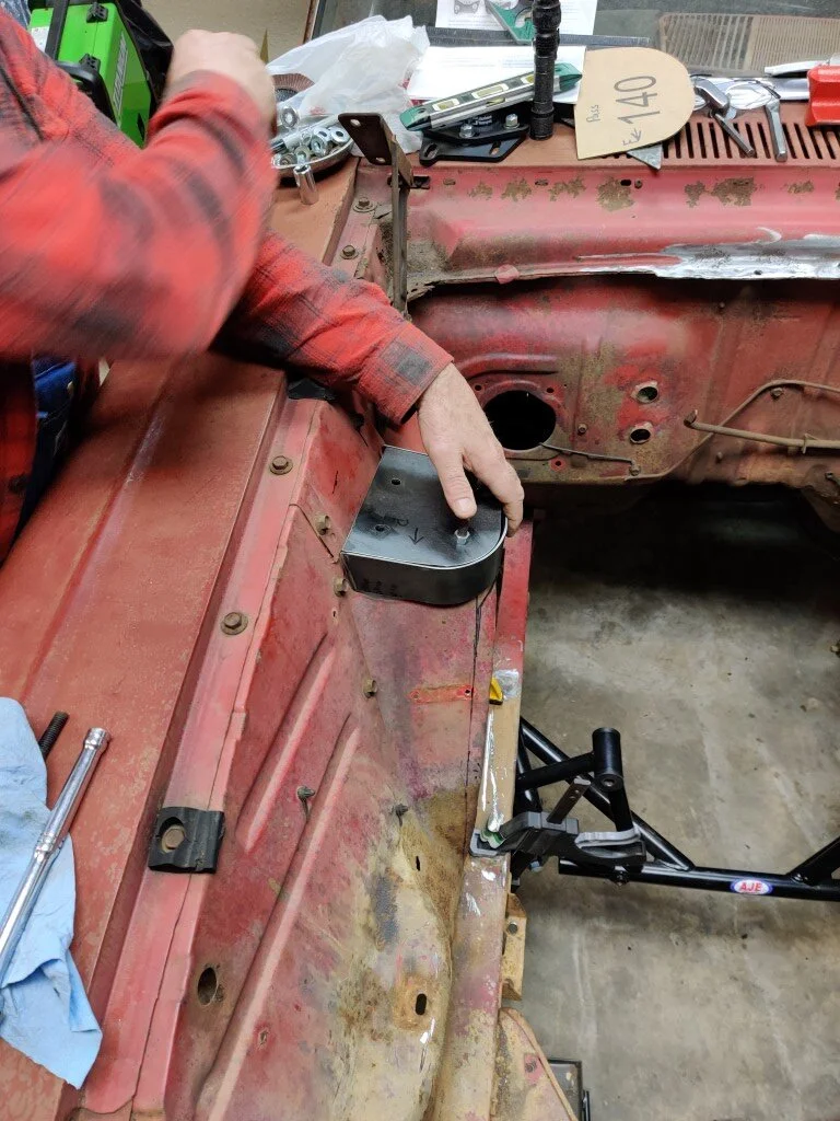

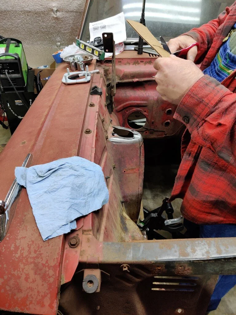

No worries. So today, my brother Jimmy came over. We did a bunch of mockup with the strut with and without the spring on it. The SN95 strut has about 6.5" of strut travel. We measure and at a good ride height, the strut only had about 2.75" of compression travel. We decided that if we could get the strut to the neighborhood of 3.5" to 4" of compression travel, that would be good.

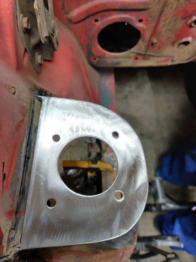

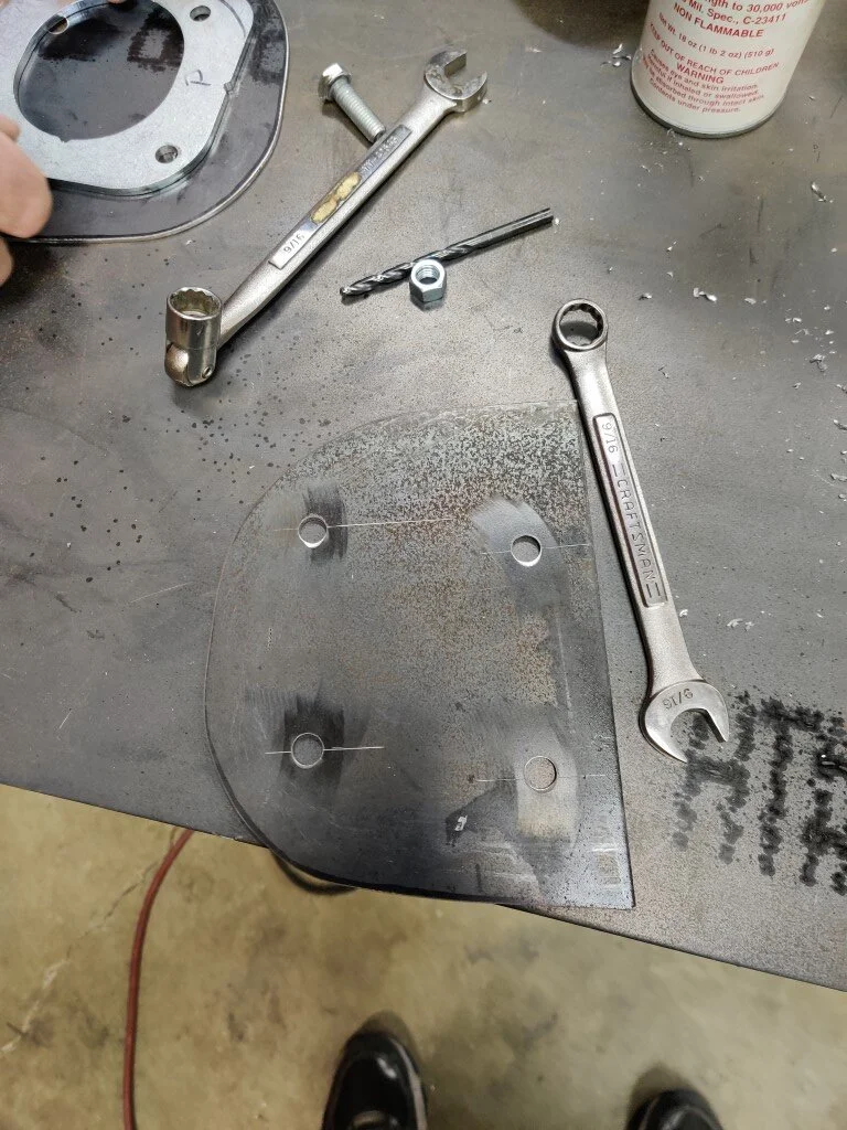

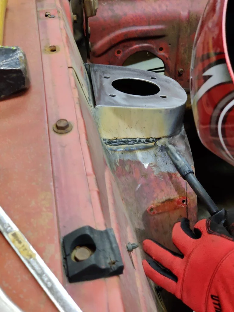

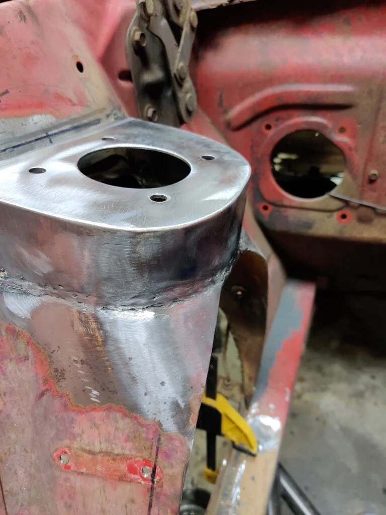

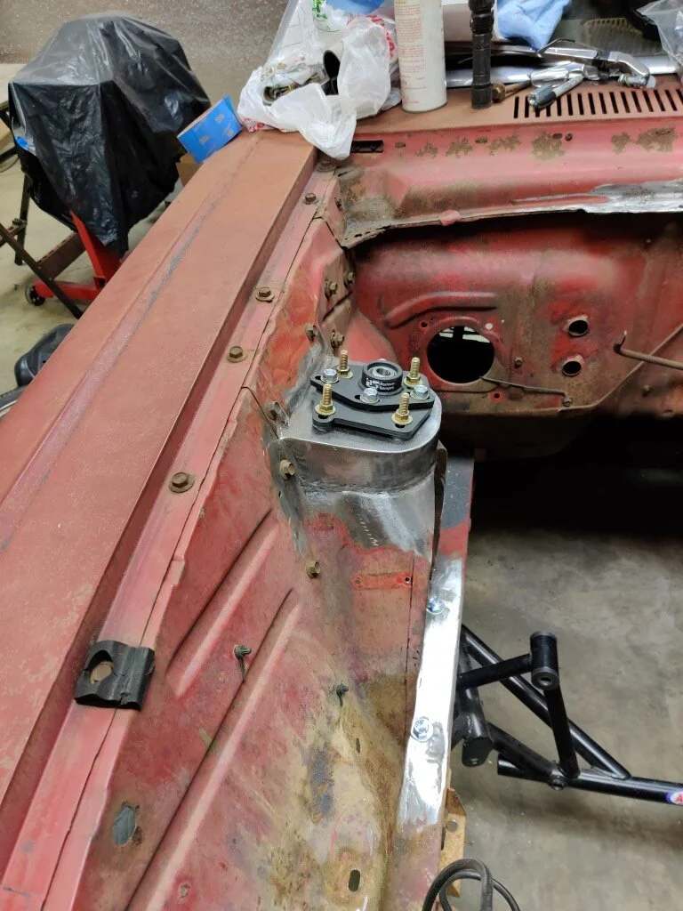

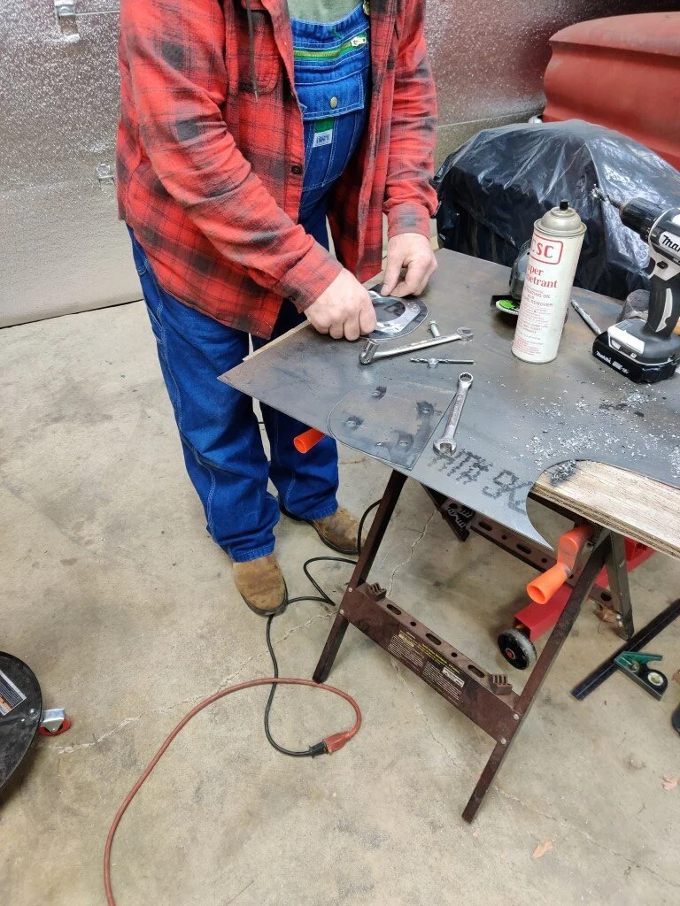

The decision was made to cut out the strut tower top, make a new one and space it up about 2". We made the top pieces exact duplicates of each other by cutting them out, drilling the holes, then clamping them together, with holes lined up and the used a flap wheel to grind them exactly identical.

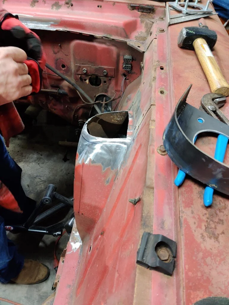

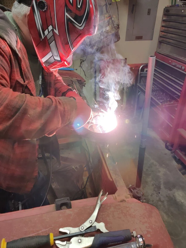

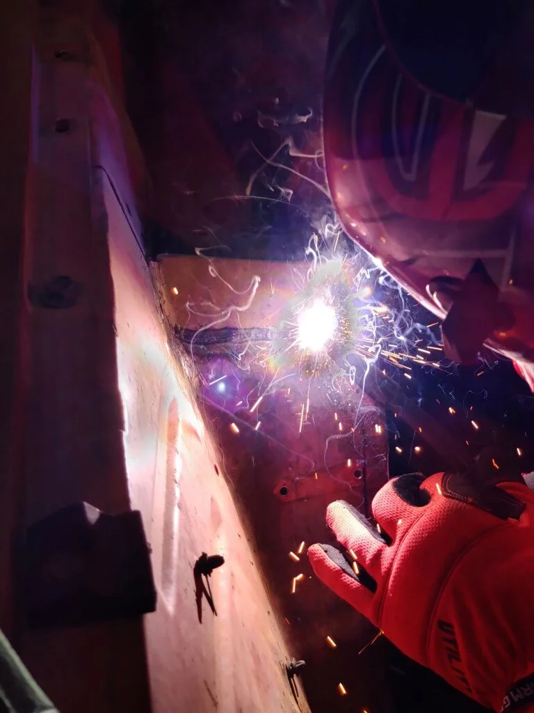

Then we proceed to mock up the strut tower top. This was some tacking in place and cutting apart to get it right. Then gently persuading the original metal to conform to the new metal with a 3 lb mechanic's hammer. The metal quickly saw the light and jumped into place. My brother was handicapped by having to use my 110v FC-90 Century flux core welder. It took him a few minutes, but he found the sweet spot on the settings.

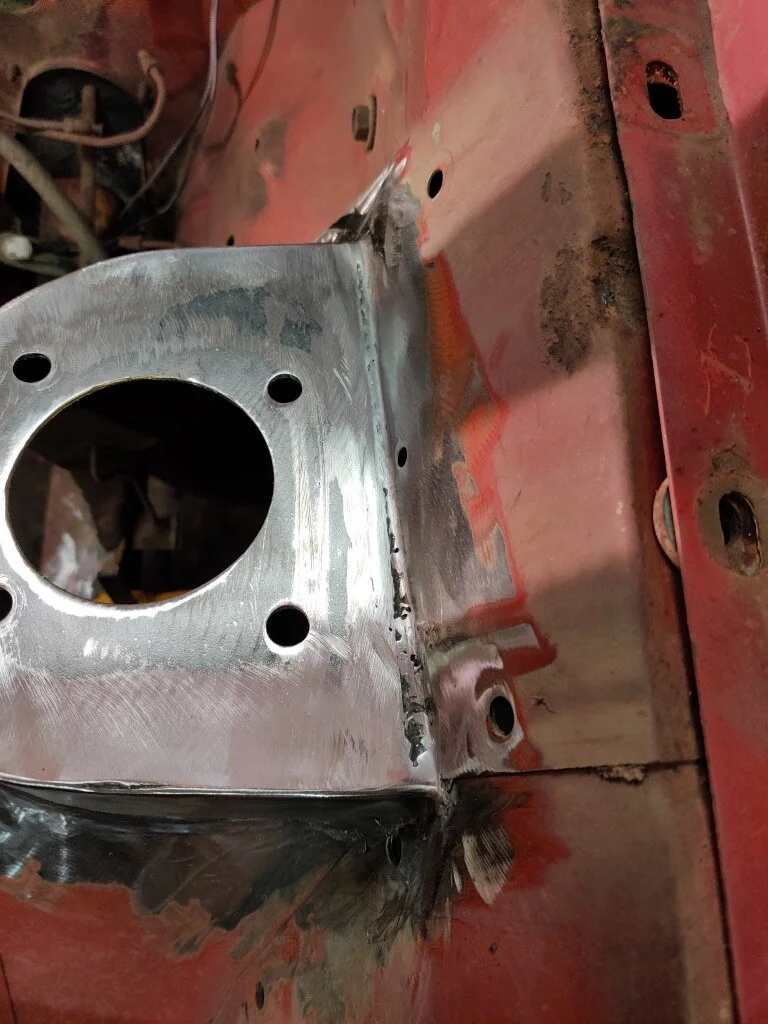

Tomorrow, we have to make a filler piece for that gap between the top and the fender apron. I think we are going to make a tip over jig. If that doesn't take too terribly long, and I can weld in some temp braces in the car, we may roll it on it's side and add some more weld beads from underneath. Jimmy wants to add some more weld at the seams to just even them out more. We're also looking at ways to add back an export brace and a Monte Carlo bar.

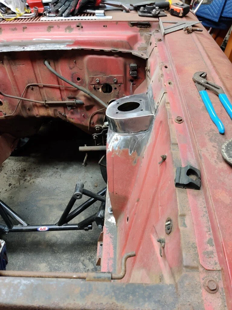

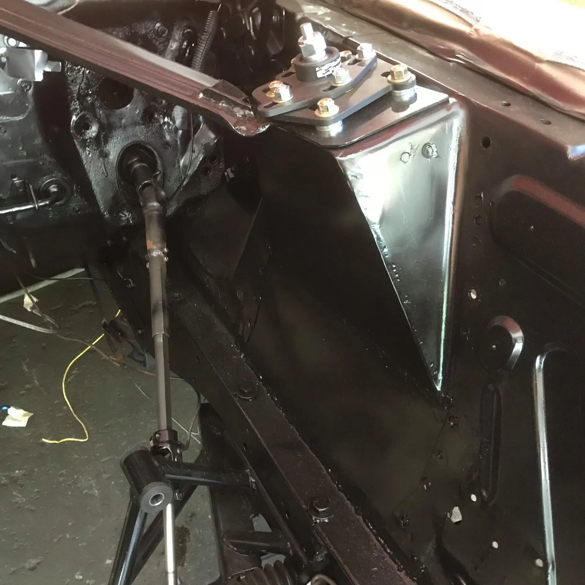

Big props to my brother for spending a weekend welding my :poo: up! I'll probably go in and add a little more weld on the towers and smooth them out. I'm going to probably cut the shock towers back a little more. Final plan will have filler piece going down to the frame rail and be stitch welded to it and welded to the small flange as well. It will come up and wrap onto the new part of the shock mount to add strength.
Speaking of strength, I said I wanted to keep these outer bolt in panels for strength. I have to remove the bump stop and carefully choose the front wheel back spacing to make it happen.
Good thing. With them out, the fender aprons bend very noticeably. With them out, you can't detect any bending. I am sure that there is, so there will be some kind of export brace made to triangulate the firewall to the towers. Also, probably on the outside of the fenders, we will bend up a 1 1/2" or 1 3/4" tube to be welded to the firewall, the go along the fender apron, to the front side of the shock tower and tie down to the frame to brace it all up.
I believe the added height will work fine. With the coil overs still all the way down, the car was very very low. The control arms pointed up by over an inch at the ball joints. Since we raised the mount approximately 2 inches, we raised the spring perch 2 inches. 2 simulate over 500lbs of engine/transmission, two fatass brothers stood on the front. Sitting static, there was about 4.5 inches of compression travel. With both of us standing on it, there was still almost 3 inches of compression. So I think we're good. If need be, I can gain a little more than an inch by going to a Fox strut...and I may eventually do that. I think with a front tire between 25 and 26 inches tall, it will be ok.
I replaced the bolts on the MM caster camber mounting plate with longer grade 8 bolts. This was to accommodate the future export brace creation and make sure the bolts are up to the take of holding this shiznit in. I picked up some 1/4" square stock and we used that to fill the gaps at the fender apron. It was much easier than trying to either fill in with weld or weld a tiny strip in.

I need to cut more of the shock towers out then make a pattern for the fill in piece. And order more 12 gauge...I think I am going to be just short of having enough.
