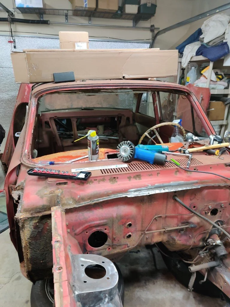

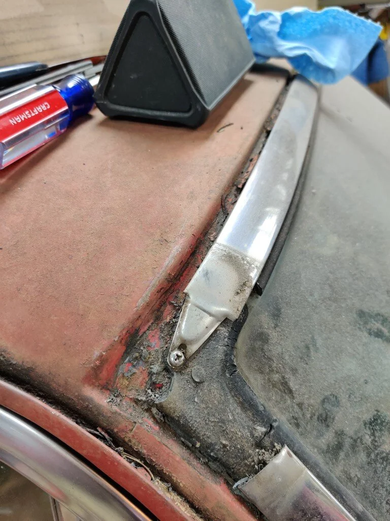

So the time has come to get down to the real nitty gritty. Taking the cowl off to fix that rusty mess. I'm waiting on a bit more 12 gauge to come in to make the shock tower fill in pieces. I have a bit more to trim them back.
But today, I pulled the windshield out...in one piece...not a crack...and got the trim out of the weather-stripping...straight. I was pretty happy with myself. Usually I am not patient enough to get it out in one piece. But I did it. Next up is to get the cowl cover off. I got the pieces off that connect the cowl to the fender aprons. They are pretty rusty. Probably going to have to try to fab some new ones....there's not much left of these to even fix. I doubt anyone makes them. After I get up tomorrow, I start on the 150+ spot welds on the cowl. Which means I need to knock about 150+ center punches. Tasty.

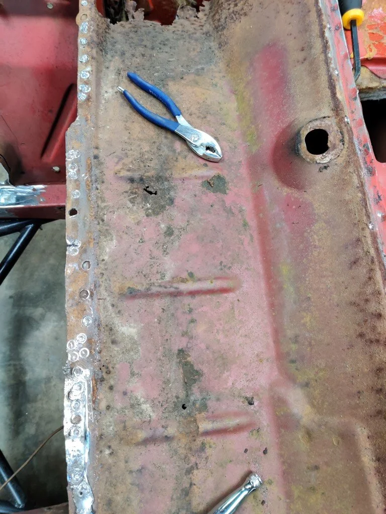

Well, as Marcellus Wallace says in Pulp Fiction, the driver's side is far from ok. But as luck would have it, I'm on a Falcon FB group and a guy has the two areas that are rusted out that we're working on me buying and him shipping to me. Maybe even the cowl cover since mine's a bit worse for wear. It's not terrible, just need to remake the side flanges since they were rusted so bad I just snipped them off. And the last bit on the front center, dude assembling it must have been reprimanded for not using enough spot welds. On the last 4 inch strip I had left to get loose, one I got to number 9, I quit and snipped it off. It was going to end up being cut off by all the spot weld cutter holes anyway.
The nice thing is the top along the windshield was so easy because all the spot welds were obvious and it wasn't rusty. If it was rusty, it was hard as hell to find the spot weld center. I pretty much sacrificed a gasket scraper. I will get it in between the two pieces of metal and beat it along until it stopped, then try it from the other direction and mark where the weld should be. Sometimes I marked right, sometimes not so right.
In case anyone needs to do spot weld removal and are using the HF spot weld cutters. Here's how I ended making the most of them. When you first get them, you can just take a center punch, mark the center of the spot weld and drill thru it. Be careful not to go thru the second layer of metal. On the Falcon, that was evident when rust would start coming out of the hole. The spring loaded tip of the cutter is nice and sharp when new. But after just 2 or 3 cuts, the tip gets rounded down and likes to jump out of the center punch mark.
What I found was take a small 3/16 or so drill bit (until I broke 3 of those off) and center punch, drill a little pilot hole...not even really a hole, just a good indention. Then the cutter would usually stay put. Another bit of advice...let the cutter work. Once it gets started and makes a nice groove all the way around, you can add pressure. If you add pressure before it's cut a full groove it will jump out. And usually when it jumps, it snaps cutter teeth off. And they will still cut with half the teeth missing....ask me how I know. The cutters are 2 sided, so if you break one, get some pliers, unscrew it, flip it over and put it back on.
On my last trip to HF they had 5 cutters on the shelf and I got all of them. Good thing too...when I got down to the end, I had all 5 cutters going thru each one to find one that would still work. I did the entire upper windshield side with 1 cutter. So basically the engine side used up 9 cutting heads.
On to the show:

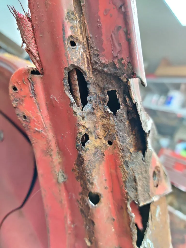

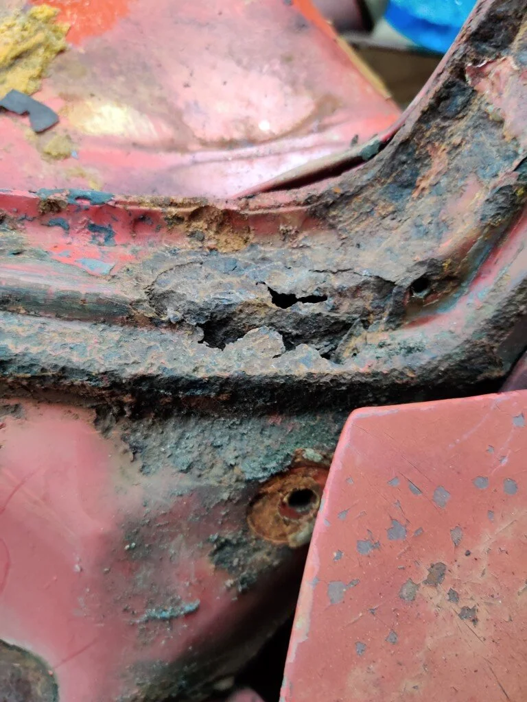

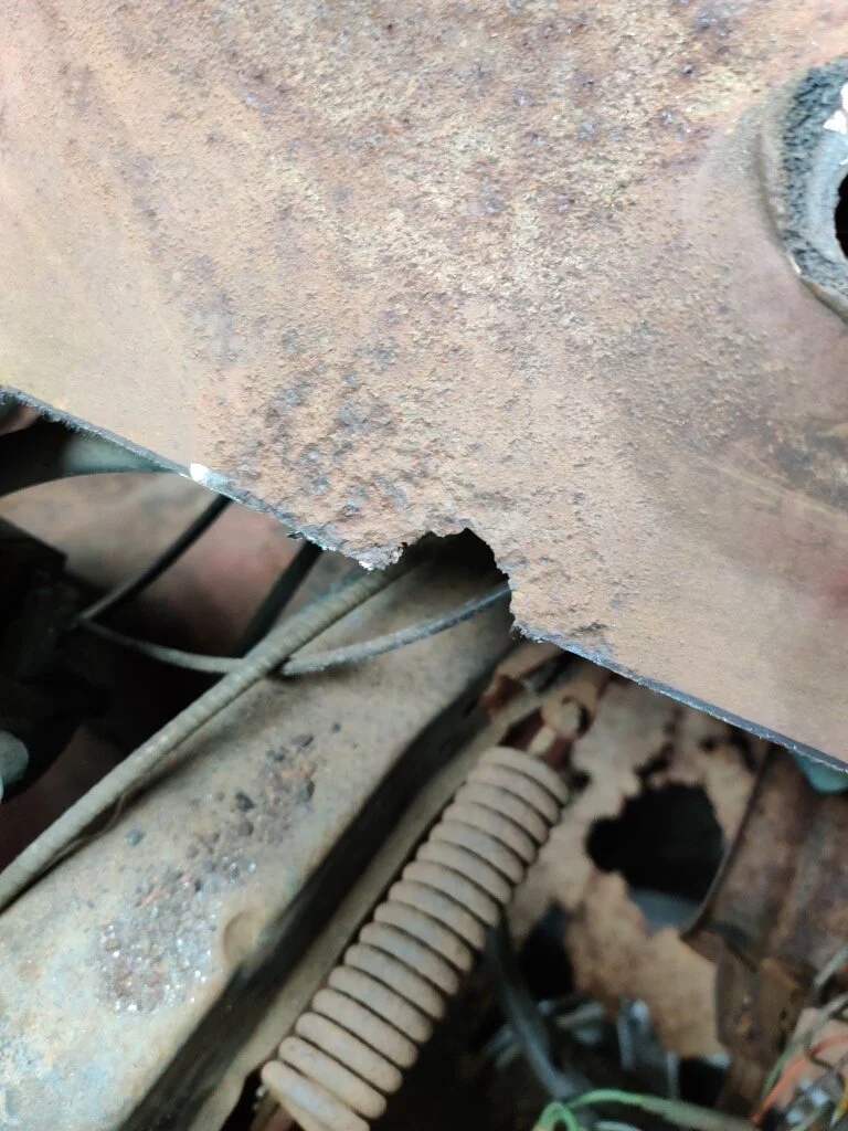

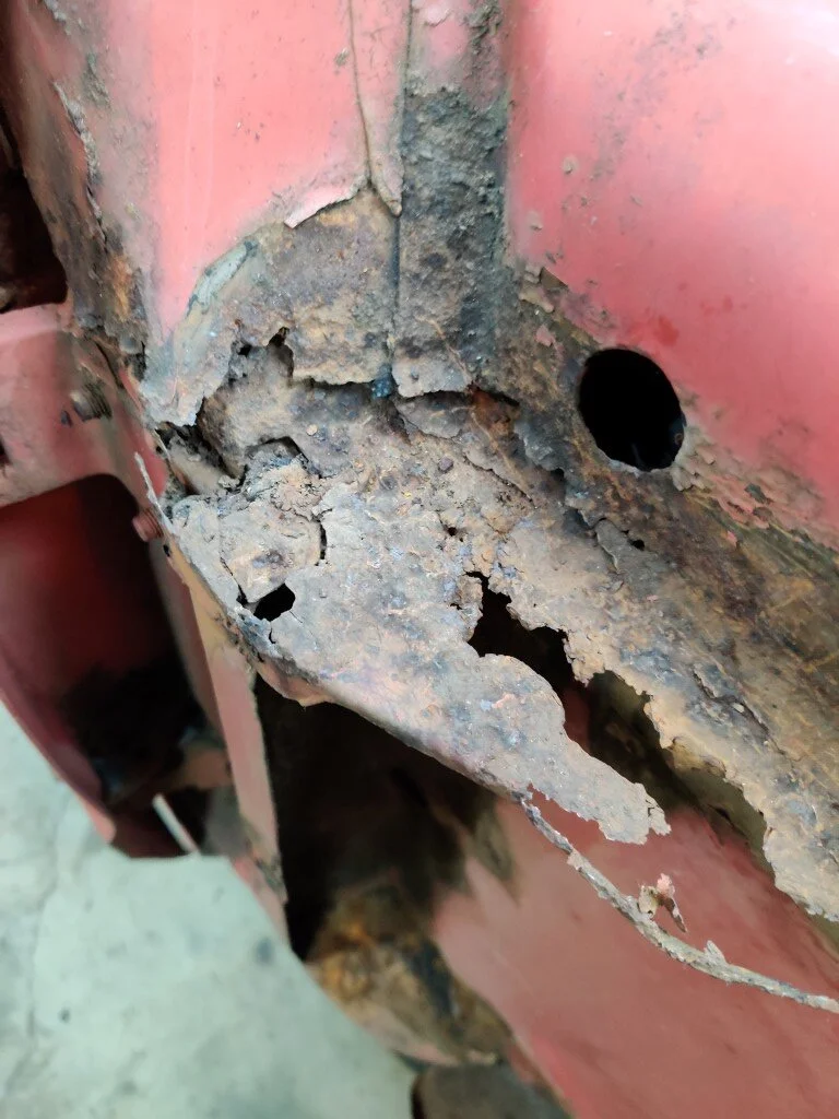

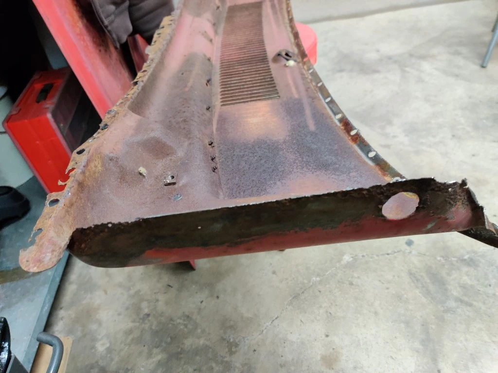

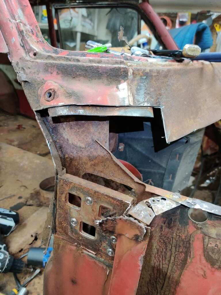

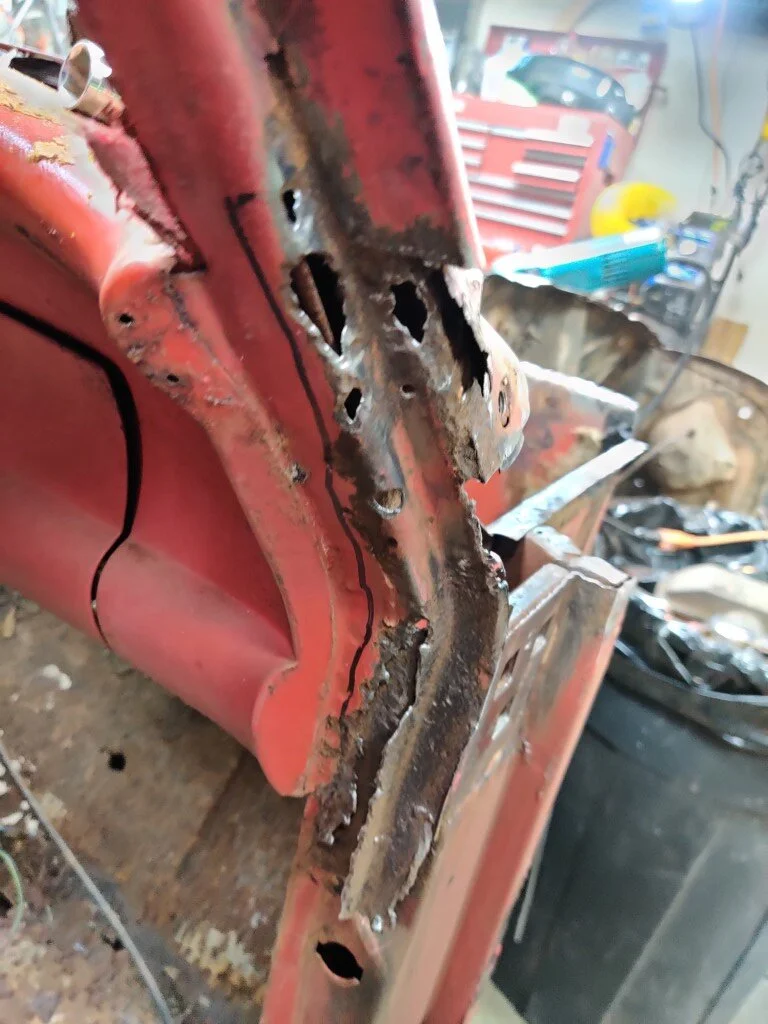

This is how it started and the one area that concerns me. Not from it's totally frcked, but how can I fix this easily. I don't care about looks, because it's not going to be seen, unless the door is open and I doubt it then. It' under the fender.
Here's the bad part. Bottom corner of the drivers side windshield channel. The rust doesn't seem to be all the way down into the hinge structure area. I need to get some pics of the passenger side. Over there the windshield channel is perfect, but down towards the upper hinge it is rusted pretty heavily, but not into the door hinge structure either. I guess I need to make room in the shed for the doors and get them off.

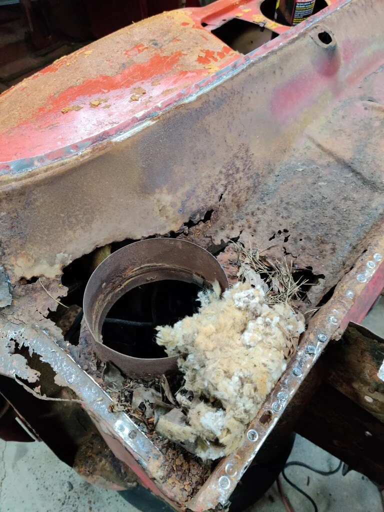

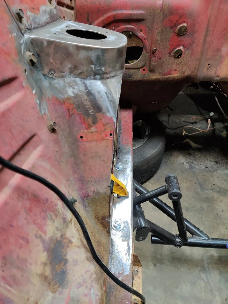

I found a guy on FB that actually has the 2 air intake hats. But the more I thought of it, I am going to just close them off. If I tag it and ever drive it, I can put one of those small hot rod universal heaters in it....mainly for defrost. Plus, the heater box is pretty much messed up I noticed today. Where the blend door is located is broken off!

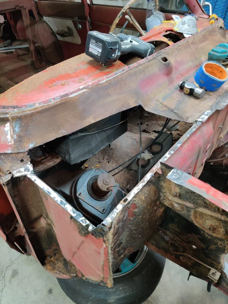

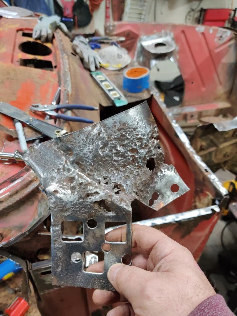

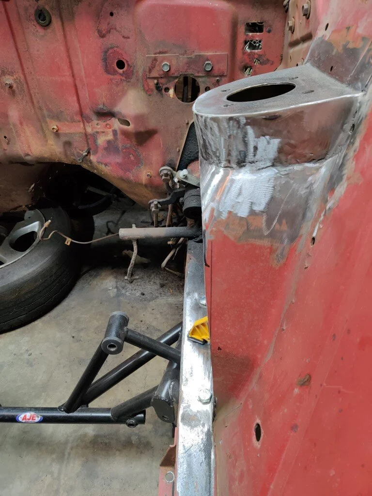

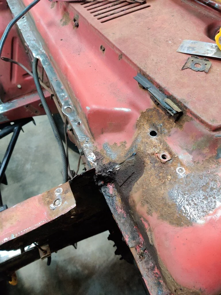

Today I got the holes pretty much rough cut to where they need to be patched. The driver's is worse just under the wiper arm. I'll have to cut some more out there. I also got all the layers of flanges off the top of the firewall where the cowl is gone.. Tomorrow, my son is 'supposed' to come over. If he comes over, I'll get him to help me get the doors off. The passenger side will need some repair above the top door hinge and the A pillar inner support is pretty rusty at the bottom. I'll have to fix that, then patch the outer skin back on around to the cowl. Luckily, I don't think this can be seen with the door and fender on.
I also trimmed the shock towers back. The filler panel from those will go from the frame rail and end up on the top plate for more strength.

Definitely need to pull the doors off. It's difficult to tell, but it looks kind of like the lower cowl wraps around and forms the lower radius of both sides of the windshield opening? I would do my best to remove it and make patch pieces to replace the rust with it off the car.
Yeah, on the passenger side, I am going to get the door off, slice the outer cowl piece up further, patch in the heavier gauge A piller support at the bottom and then patch the cowl piece back on. Good place for me to start body work like this, since it won't be seen. The drivers window channel looks a lot more complicated. Luckily it looks like the A pillar structure is fine. I'm gong to drown everything exposed in rust neutralizer as well.

No, the cowl just has a big gaping hole at the corner towards the front of the car, the water from there drips onto the rocker extension, which on the driver's side has a hole, passenger side is perfect.

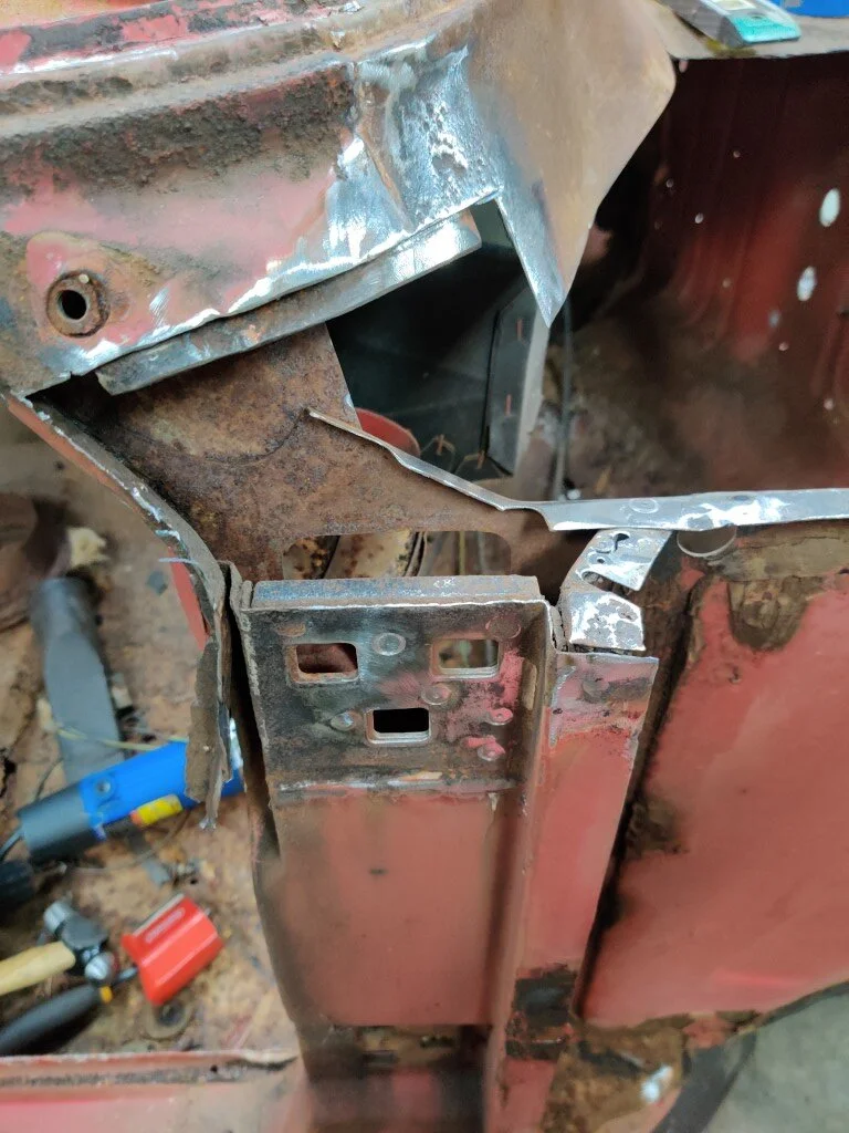

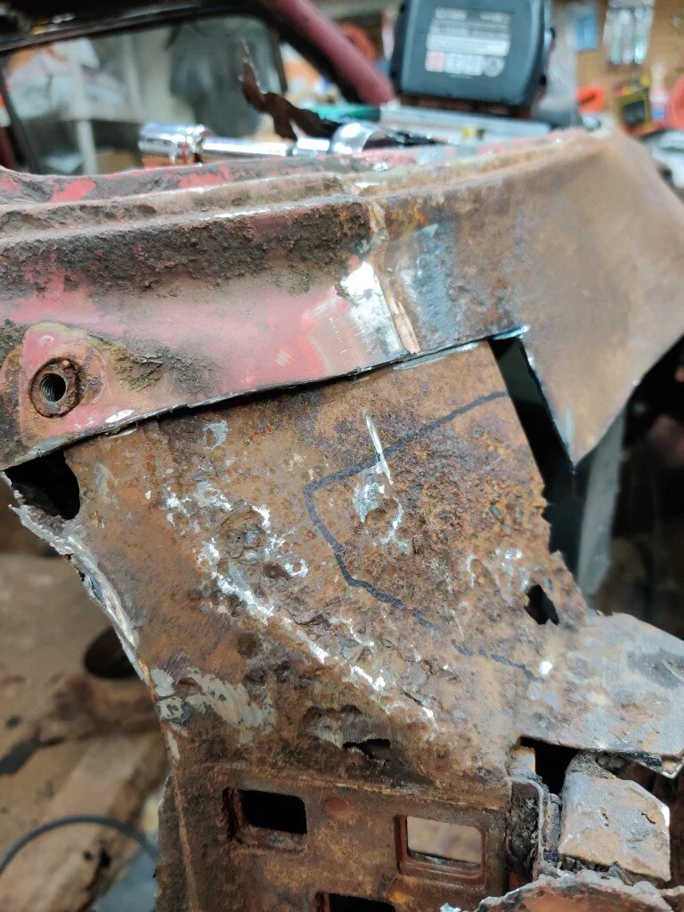

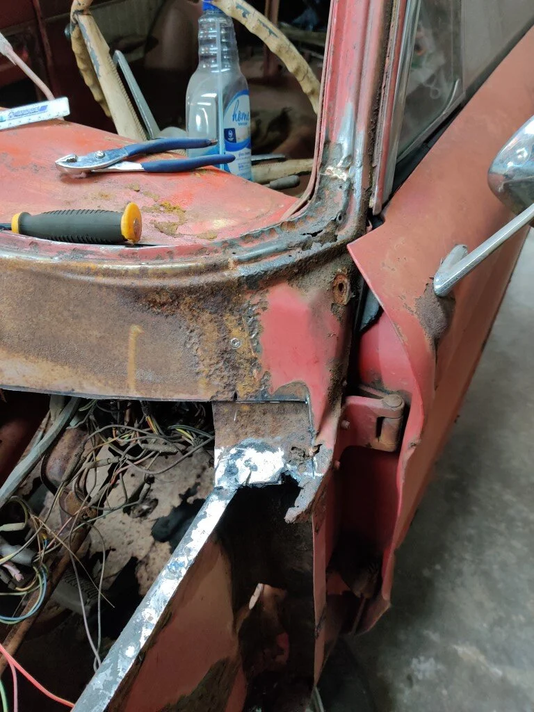

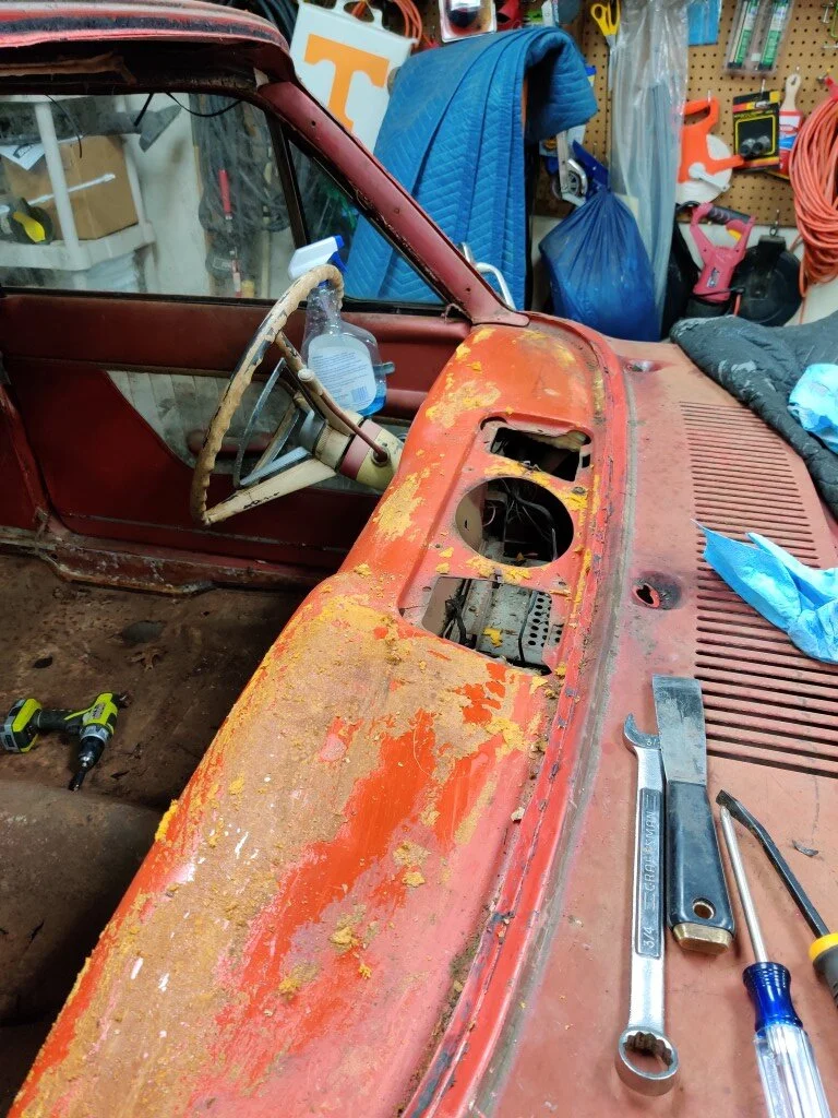

More, rust, that is what sheila has. I am working on fixing up the passenger A pillar. I think I have the bulk of the inner structure with the worst rust cut out. I need to run by work tomorrow and get some bigger pieces of 16 gauge scrap and see if we have any 18 or preferably 20 gauge to make the cowl and body side a pillar fill in pieces. We will see how overly ambitious this may have been to tackle. My brother called me today and said I see a whole lotta cutting out pictures but no putting back pictures.
Maybe tomorrow some put back happens. I have a physical in the morning so who knows how much time I'll have. Then I am supposed to take my wife for a day trip lunch NYE, and then I am smoking a shoulder NYD. So maybe some time Saturday and Sunday will be available to do some putting back. Then back to work and the heavy work will have to only be done on weekends.
In my mind, I can make that piece out of one piece of metal,. but I am prepared for reality where it has to be multiple pieces. I'm getting some rust neutralizer to spray all in this shiznit before it gets covered up.
My biggest challenge will be the body side of the a pillar.

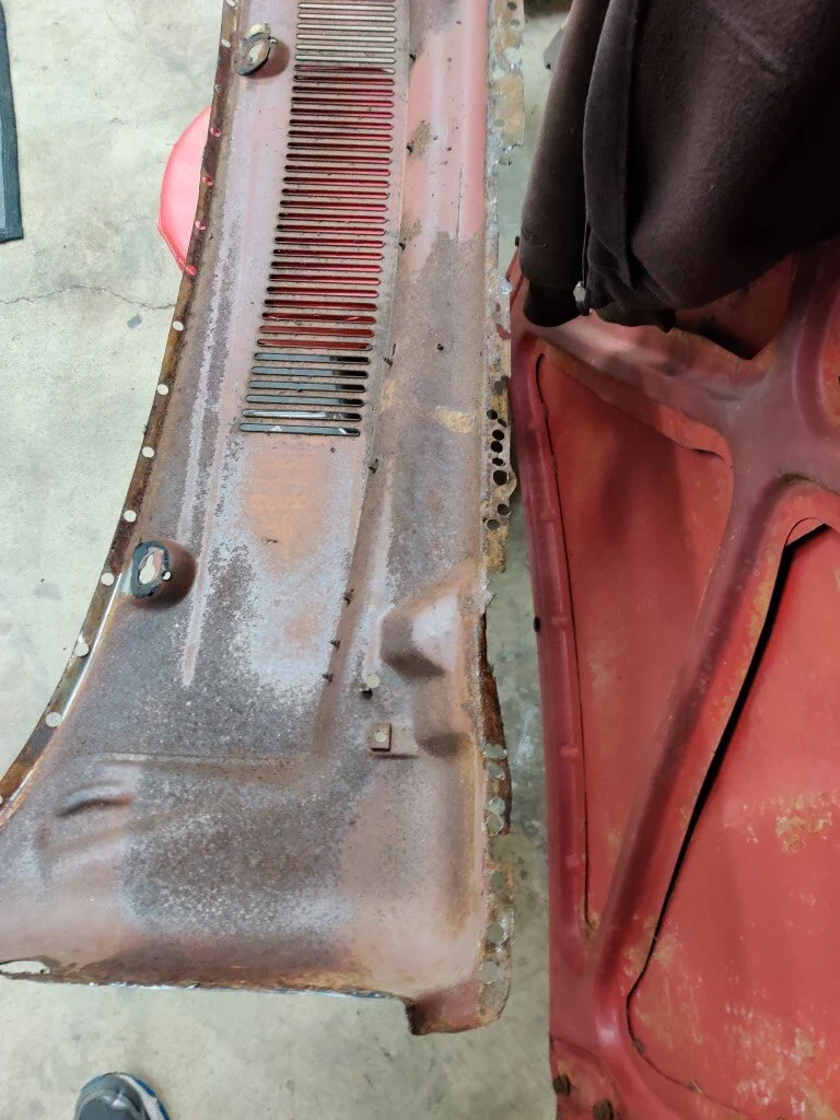

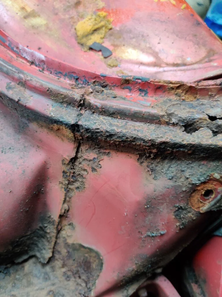

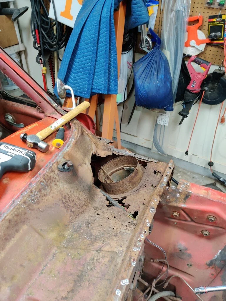

Part of my challenge was identifying which layer was which..which part overlaps the next because some of this was so rusted, the top layer is gone, just blended into the next layer.
I'm trying to stay away from the drip rail, which luckily the rust only is up there in the small hole. If you see my sharpie line, I think I'll snip it out there and probably have to make several pieces to make the fill in. Most of that cowl piece where you can see the nut for the top fender mount will have to come off to fix the inner structure over here. Still not too worried, because that area is still mostly hidden by the fender. I'm not looking for show quality, just the worst rust cut out and the end result a 10 footer. Or maybe 25 footer. All with a 110v flux core machine. I also have a better welder, but it's 220 and setup for flux core and my panel is full. I need a 4 pole breaker and do some dancing in there to get an outlet, but I think for this 18 and 20 gauge metal the 110v welder is doing a pretty good job.
