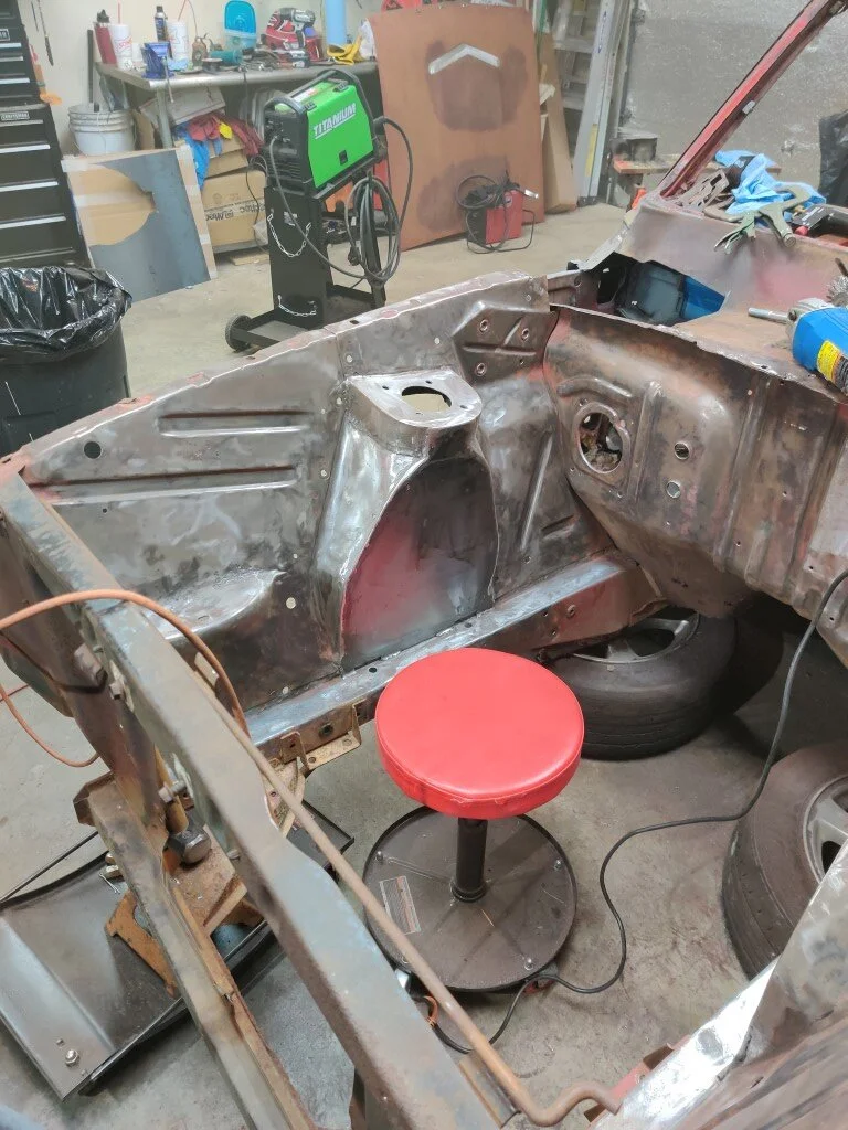

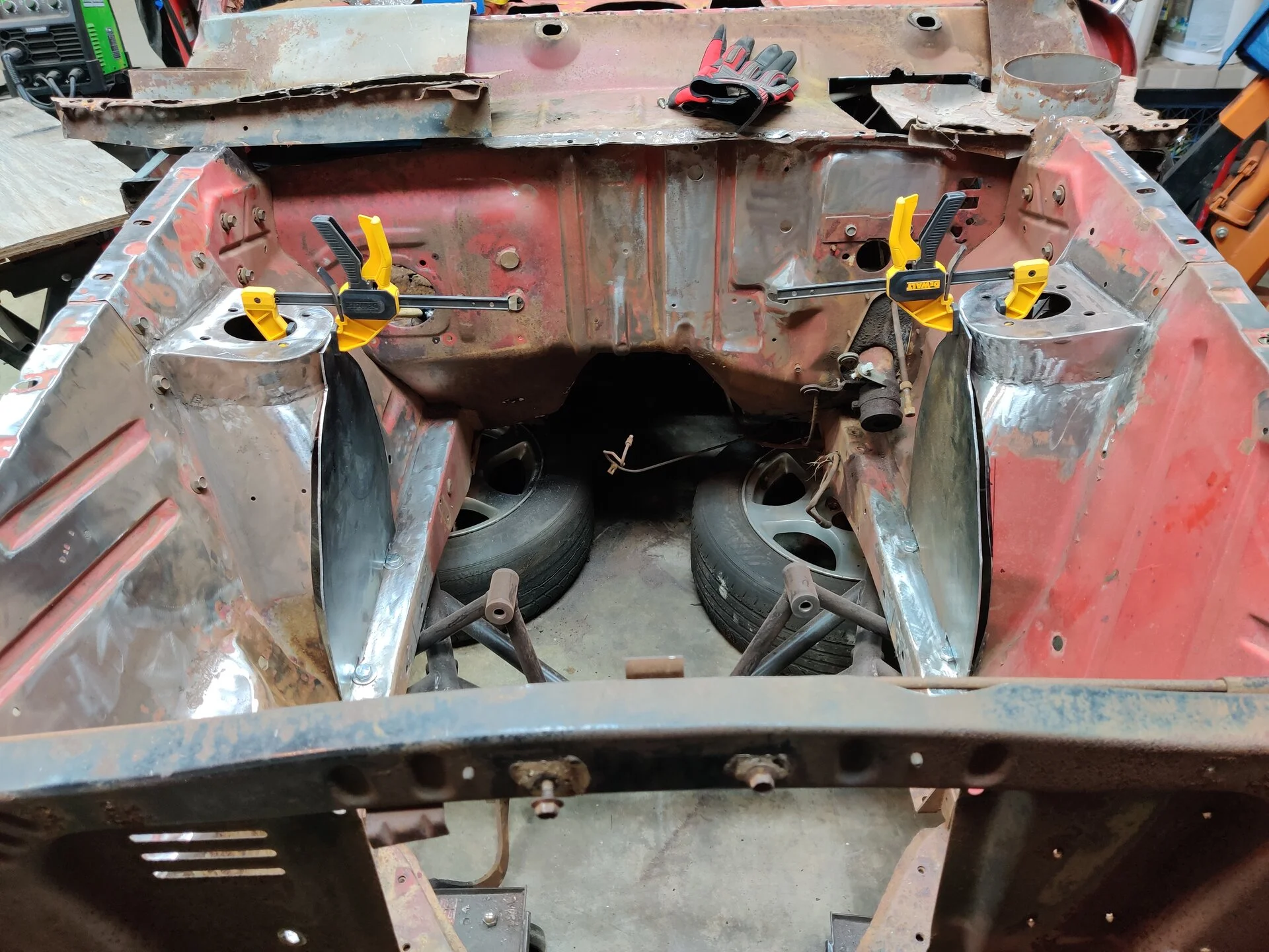

Jeez 12 gauge is a bitch to cut with a jig saw. I cut out the filler panels. I'll Weld them from the fender well and grind them down on the engine side. I need to trim a bit more and start to shape them into place.
Reactions: KZGUNS, 90sickfox, a91what and 2 others

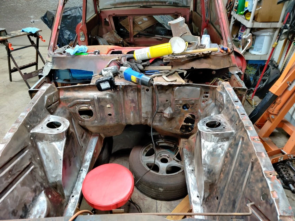

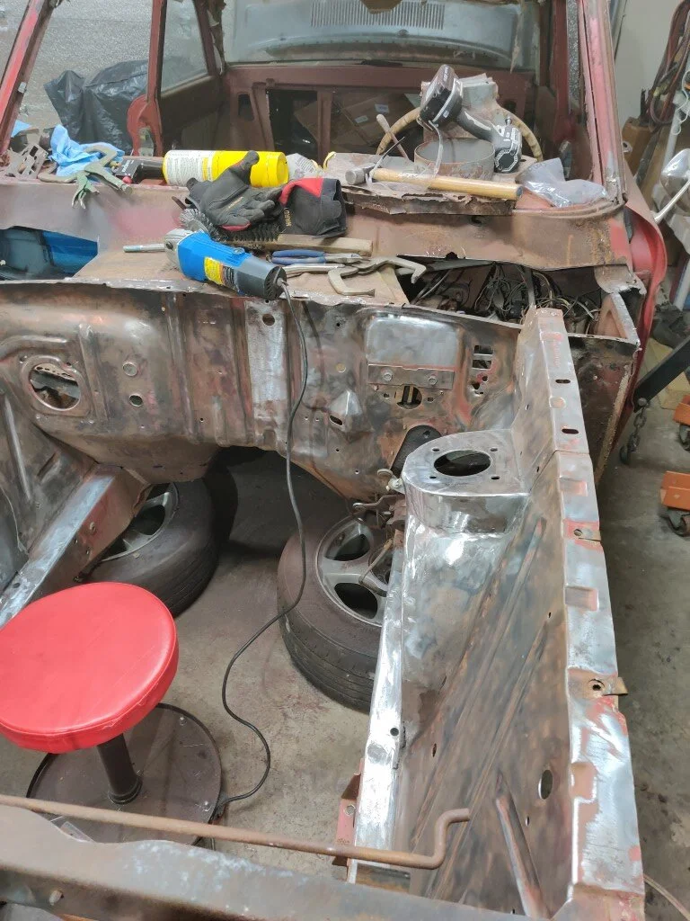

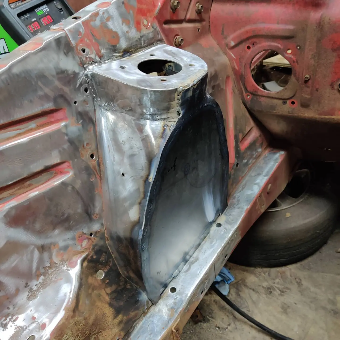

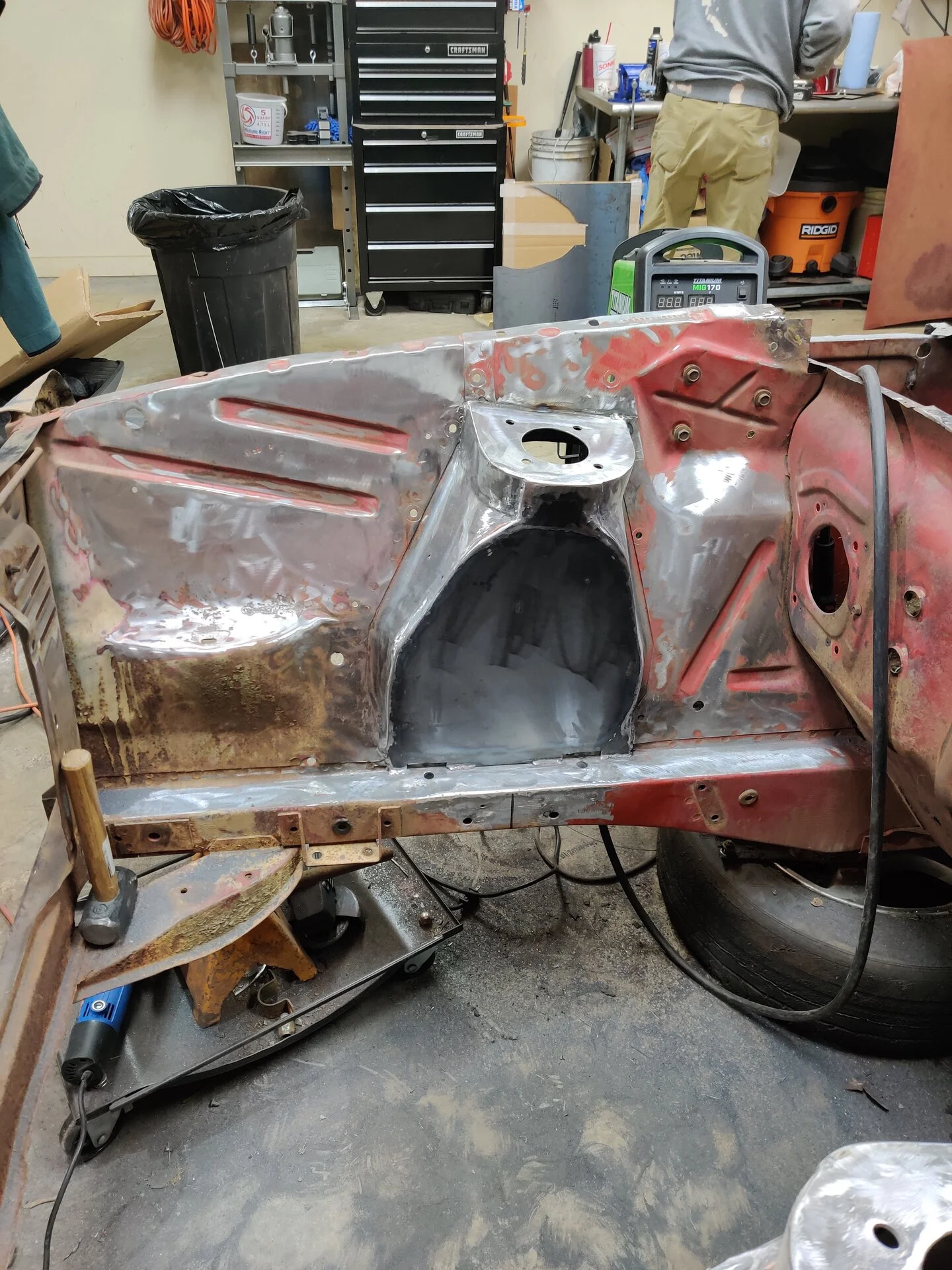

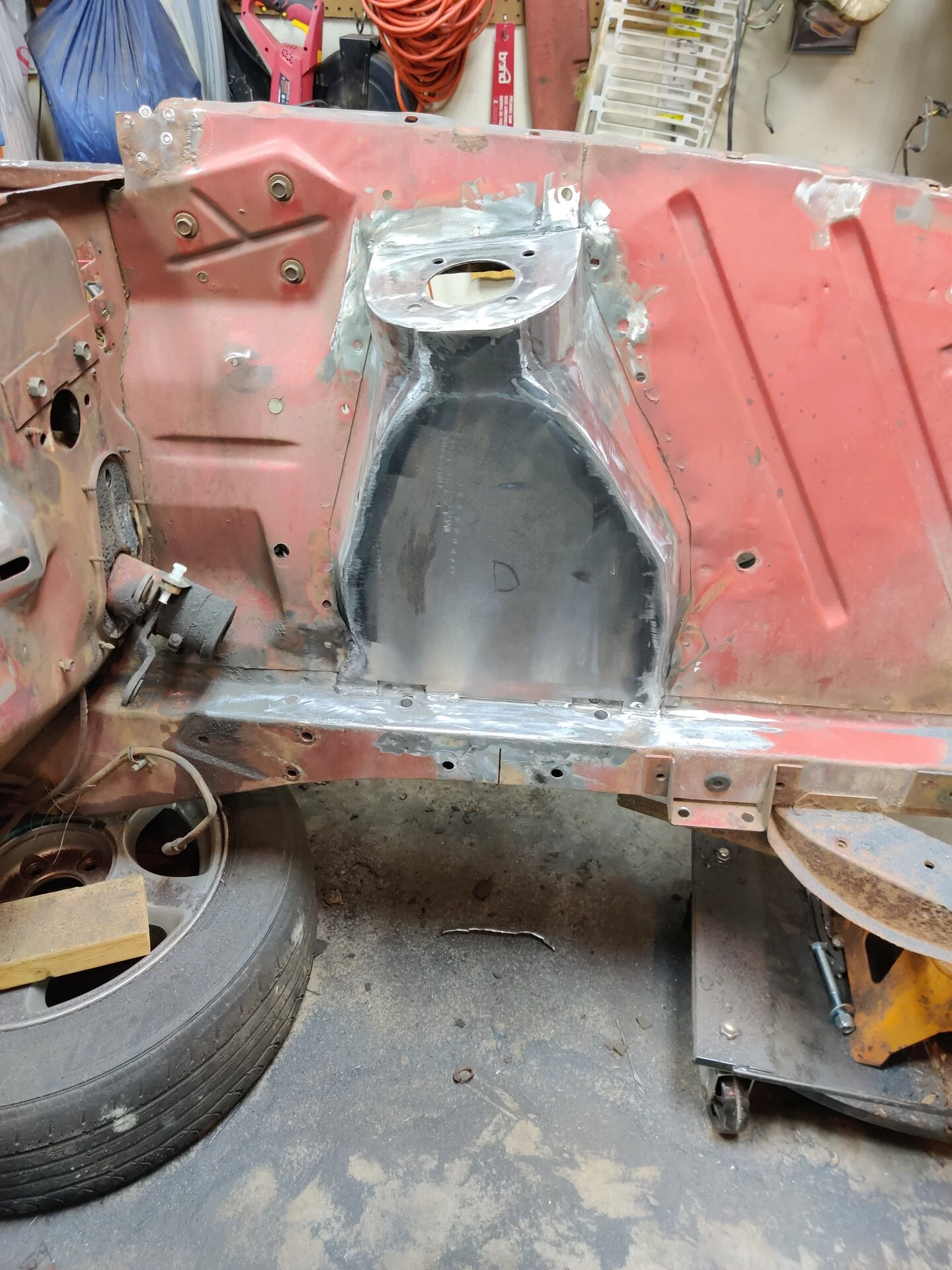

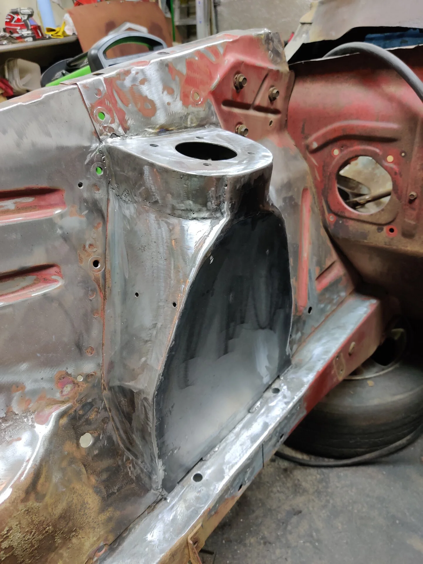

Back at today with my brother's help. Which is fair since last week I went to his place in Heber Springs and helped him replace the bath tub in the 2nd bathroom with a shower. Being that it's a mobile home that meant cutting a hole in the wall to the bedroom next door to get it in.
Today we welded in the full in pieces. Lots of grinding was involved to get them to fit.
They are welded on the inside and out.
Reactions: 90sickfox and General karthief

It is impressive how much more rigid the aprons are now.
Reactions: KZGUNS, a91what, 90sickfox and 3 others

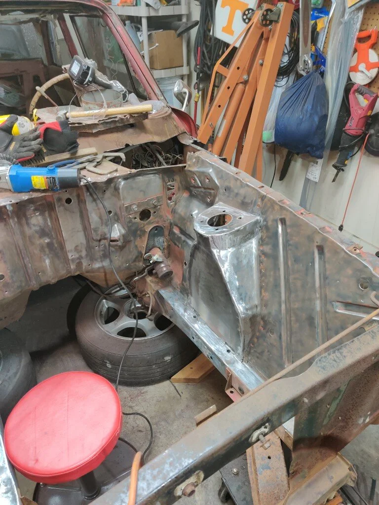

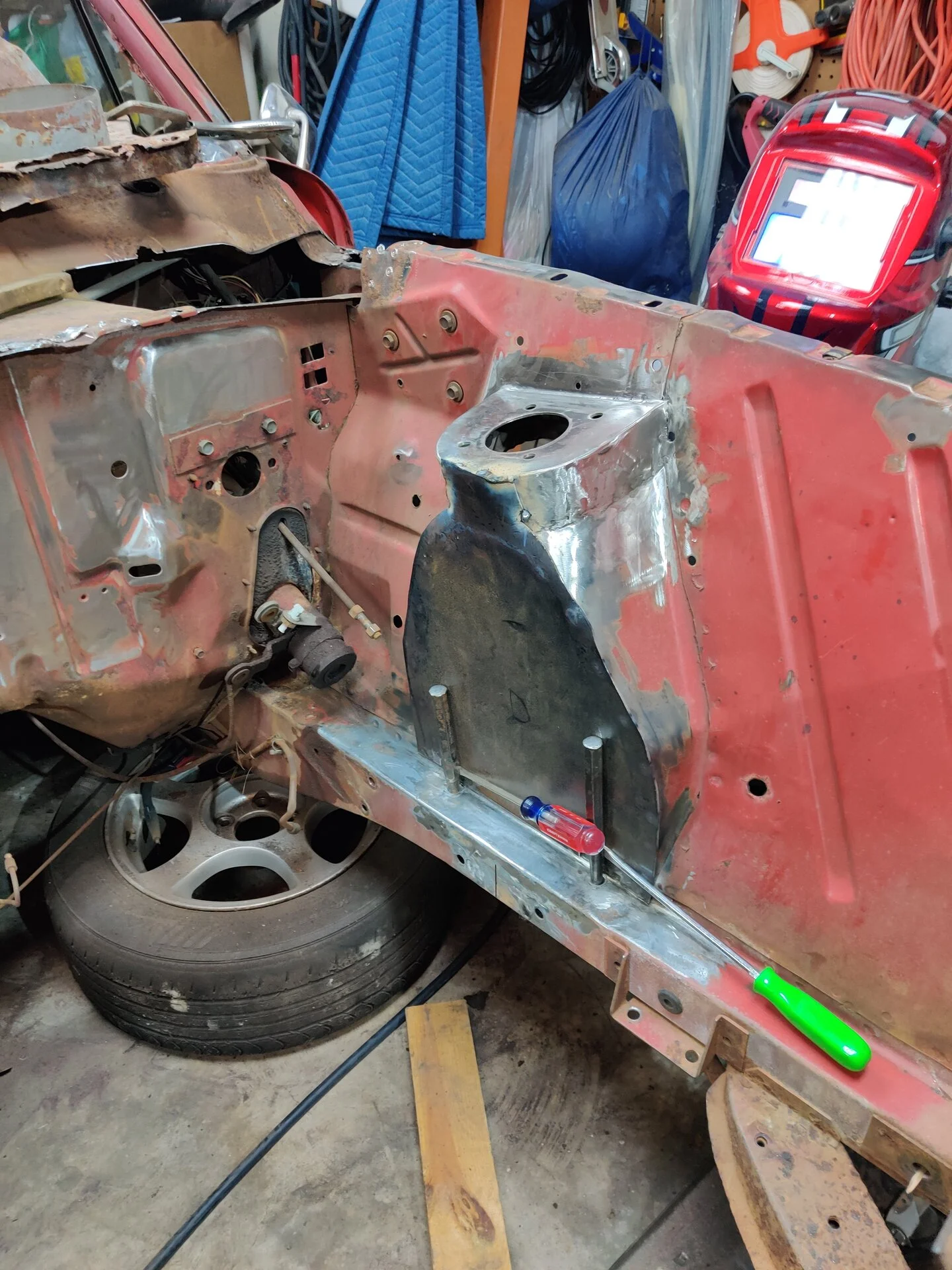

I guess in a few minutes, I will go pull the steering column. My hands are tingling from running the grinder non-stop over an hour. I decided to take a break and let me hands get the feeling back...and pick out all the wire splinters. I need to see if I have another wire wheel for the grinder. I think this one is used up. It's spitting wire non-stop now. OUCH. I just picked 2 wires out of my mustache.
Reactions: KZGUNS, Olivethefet, 90sickfox and 2 others

I might have forgotten to put on the dust make and breathed in all this . I'll be blowing out red, pink, and black boogers for days. Sorry @Davedacarpainter no green ones...I had the 'vid back in Dec. 2019.
At last, I removed everything from the firewall. I need to get some more wire wheels but it's almost ready to wipe down and put some epoxy primer on to prevent the rust. Next project when my brother comes over is going to be a wood tip over jig. My next project will be fixing the cowl and the rust areas around the windshield. I'm picking up a 75/25 bottle this week and setting up with some .025 wire. Once I get the cowl and rust repair around the windshield done, time to remove and replace the floor. They make some floors that will replace most of it from the back seat to the front, but I am sure I have to fab up the toe boards....they make them, but I need to see how high up they go. Also, when I get some more wire wheels, I will clean the fender well areas too. It's old undercoat/caked dirt...so gonna be a mess.
Reactions: KZGUNS, a91what, CarMichael Angelo and 3 others

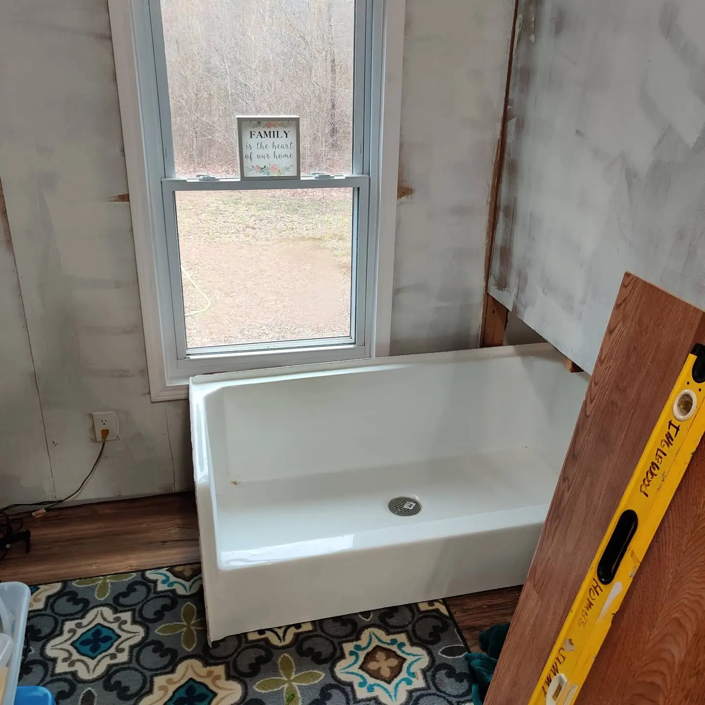

Spent all day Sat running errands with the wife. She did convince me to buy a new stand for the tv. I've been opposed, but of all places there was one at Hobby Lobby that was 1) On sale, 2) matched out decor pretty well.
Of course no good deed goes unpunished, so I had to cut the back of it out a bit to get the receiver to recess enough so the barn doors on the sides will open and close, but that was quick. But there's no recess under the back so it won't get close to the wall because of the outlet strip. Which I will need to get a longer one so I can put the strip on the 2nd shelf behind the center channel speaker. Jeez....but I digress.
