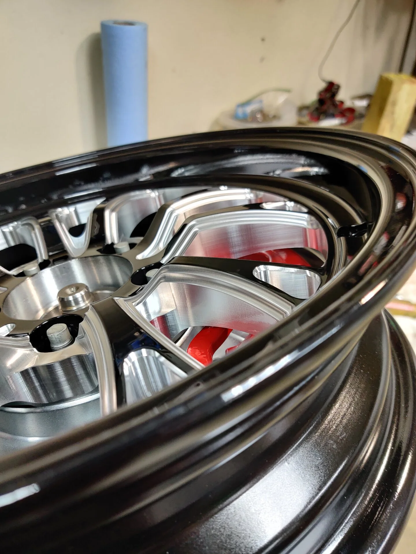

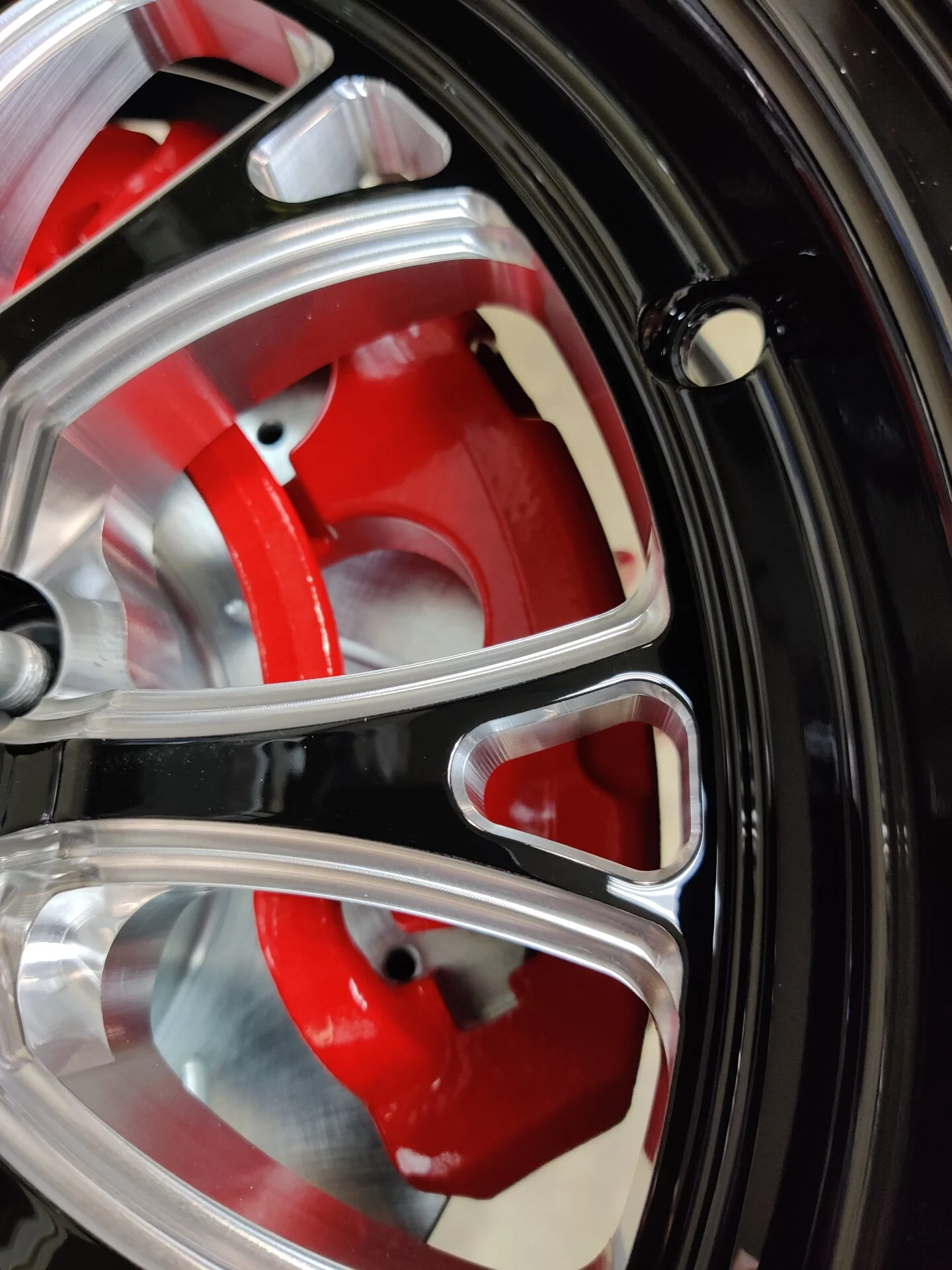

And I ordered a set of 15x4 Jegs Spike wheels for the front.

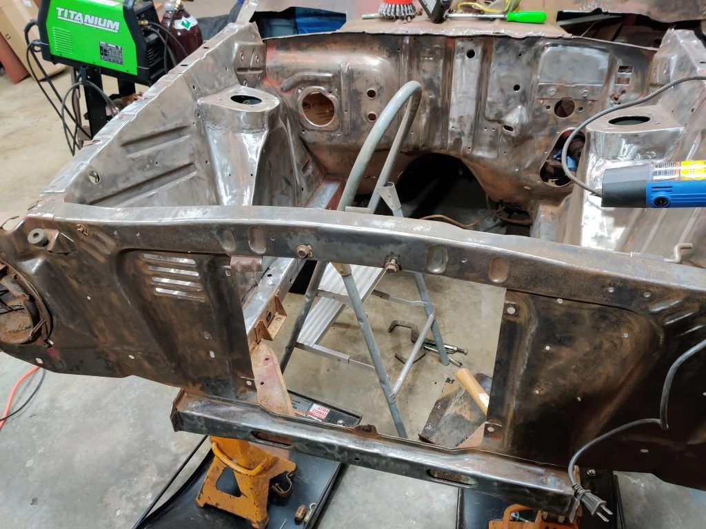

As you can see most of this purchase is to do an almost for real mockup of the front end once it's stripped and in primer.

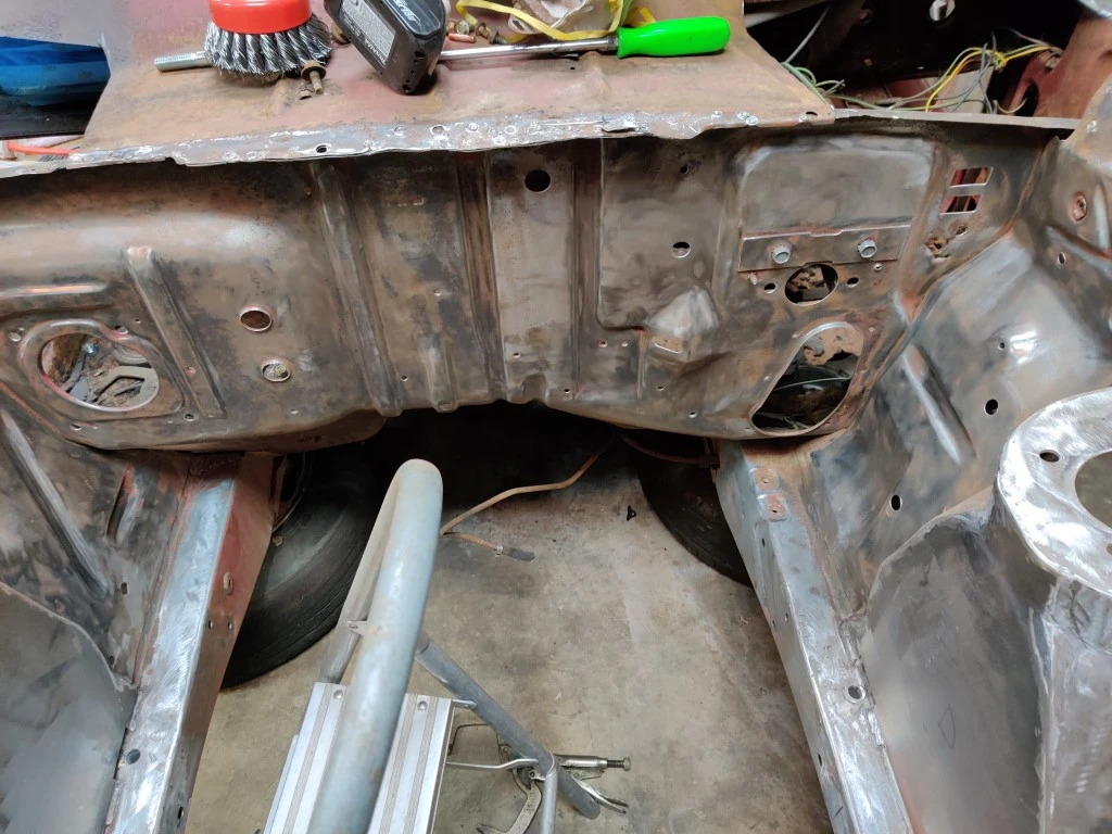

I need to pickup some 1.5" .120 wall DOM tubing to make the braces to the shock towers that will go in from the outside. And I need to pickup my bottle of 75/25 this week. Unless something comes up, I plan on a lot of garage time this weekend.
