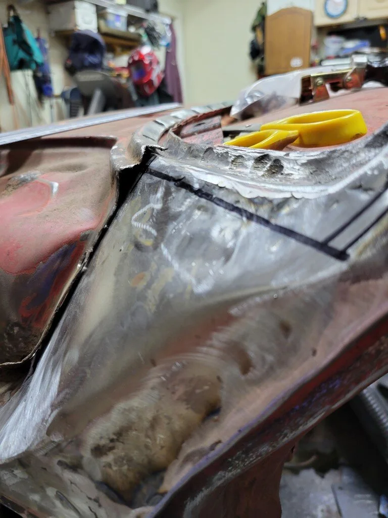

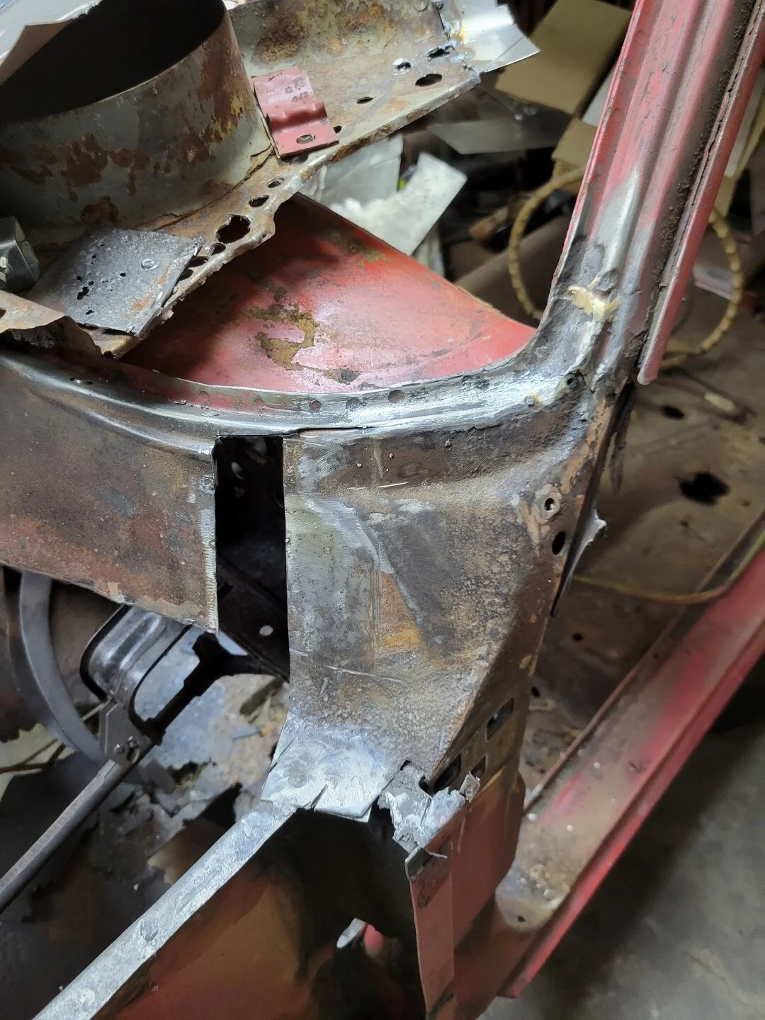

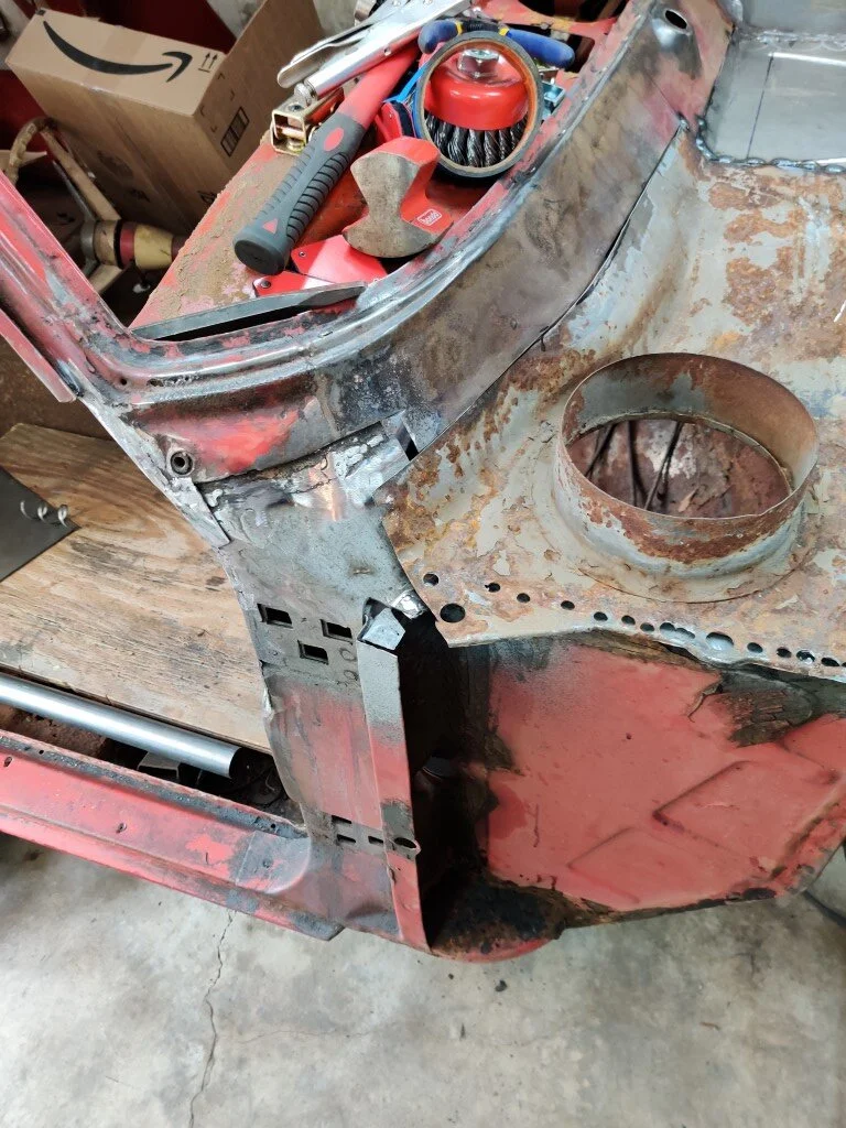

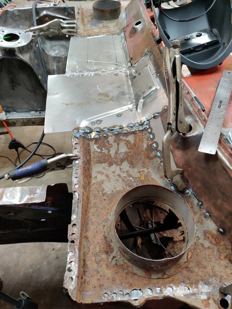

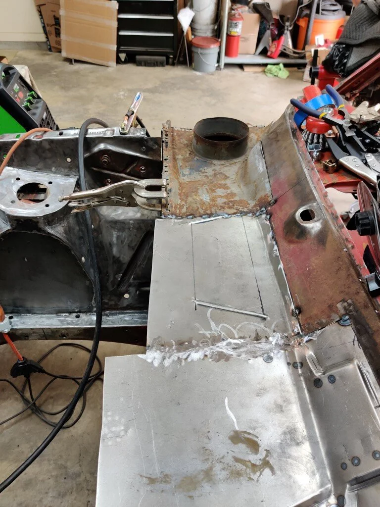

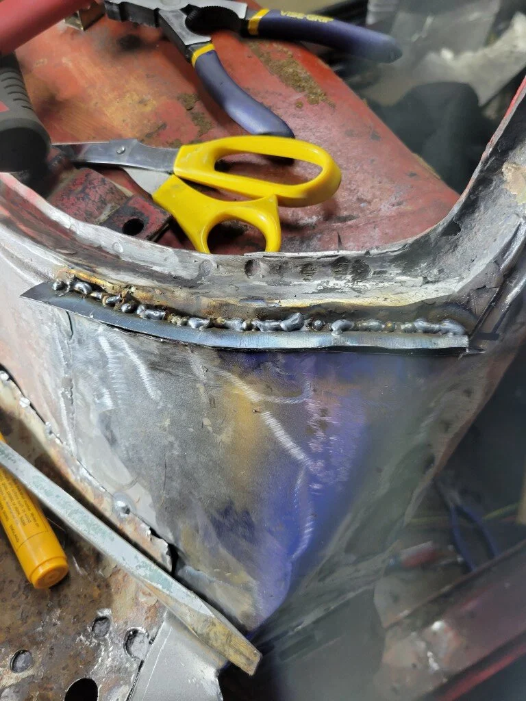

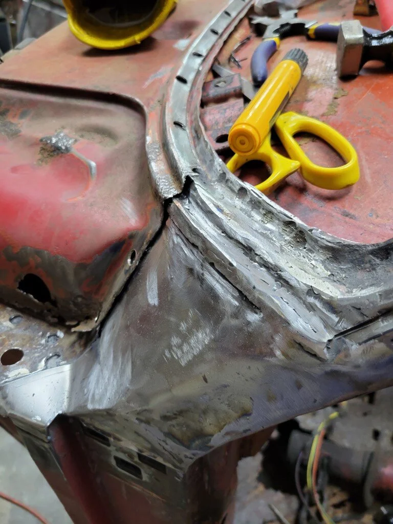

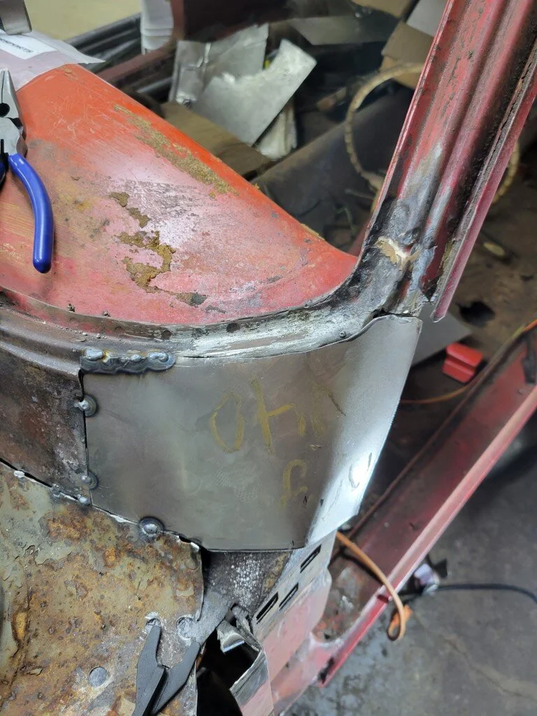

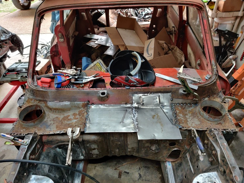

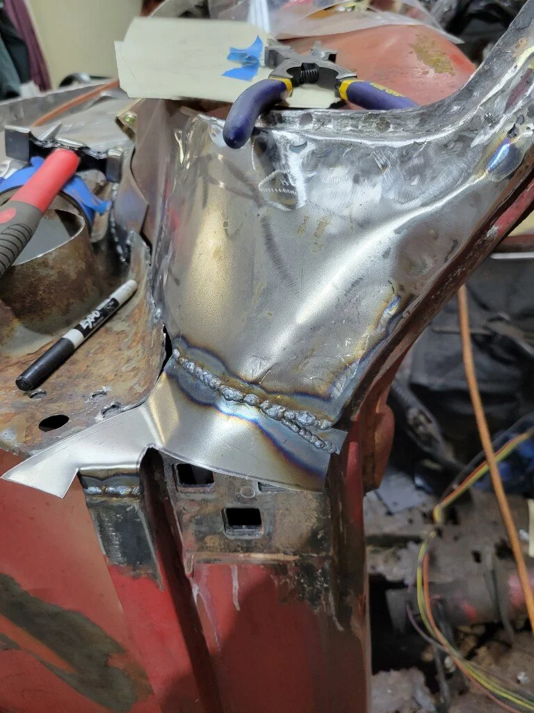

Back to progress updates:
So I finished the metal patching on the passenger A pillar. I need a carbide bit to get into the curves to finish grinding the weld, but it's good enough for now.
Then I started working on making the cowl. I am going to leave it out until I get the 10 (or more) point cage installed so I can tuck the windshield bar up high, maybe above the brake pedal mount. I will do the thru the dash kit...since I have the cowl out access will be easy and even if this turns into a dedicated drag car, I want the cage tucked up out of the way as much as possible. I still need to work on my sheet metal welding and grinding technique, but I am getting better. But I think the welder could have a problem. It doesn't seem to feed right. Like 100 and 250 on the dial feed about the same until you hold the trigger about 4 or 5 seconds then 250 takes off like a sprinter. I checked the spool and it's almost too loose. The feed roller is right and it's tight enough, but not too tight. I'm wondering if the liner has gotten kinked. It's only had 2 of the small spools and about half of this big spool run thru it. I need to go ahead and put in a 220v outlet and try it on 220.
Anyway, I took the piece of the cowl I had already made with the windshield wiper mount and started making pieces to go with that. I used my handy bead roller to put some beads in the new pieces for strength. Yes, the angle between the one on the left and the 2 in the center is off. I set the angle correctly but to match the curve of the dash, I ended up having to cut the piece on the left at an angle.
View attachment 676207View attachment 676208View attachment 676210View attachment 676211View attachment 676209

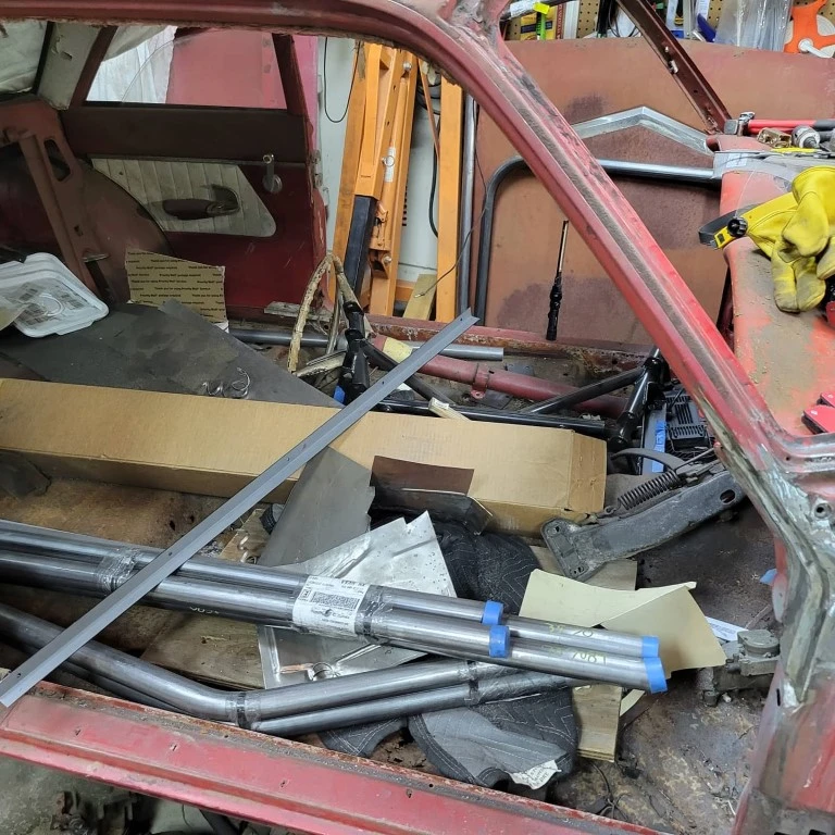

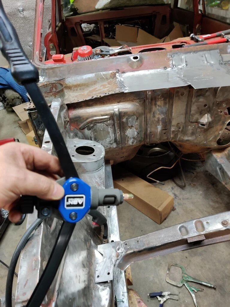

OK, getting past the post distractions, back to actual work. My brother was in town this weekend, so I had him come over yesterday and check out the cowl and see how we could incorporate the two factory air hat sections in. The thought here is to tack it all together and weld it up. Then cut it back loose from the car and once the roll cage is in, install it for good. I am calling S&W this week to talk to them about their 10 point thru the dash kit. I want to see where the A pillar bars and the windshield bar go in their kit. I want to keep the bars tuck up to the roof and out against the A pillar as much as possible.
This morning after I helped him do some errands, he wanted to come back and weld some more before heading back to Heber Springs. So the inner cowl is pretty much done. Need to grind and dress the welds, then get some primer and seam sealer on everything. Once the cage is done, the inner and upper cowls will be ready to go back on.

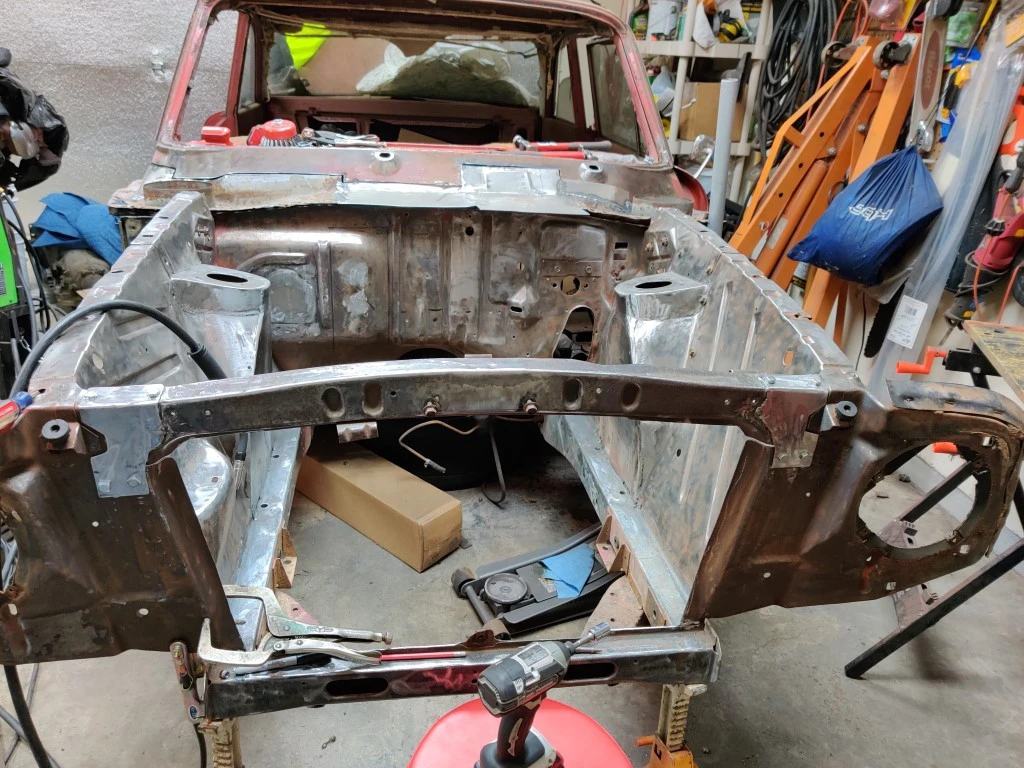

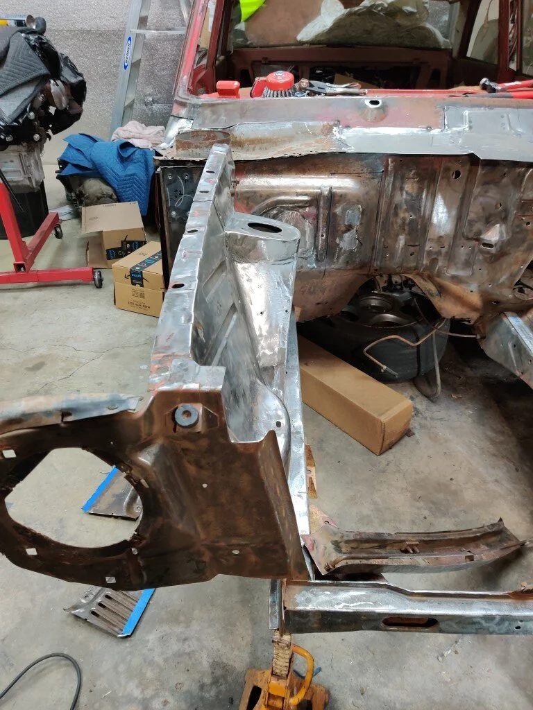

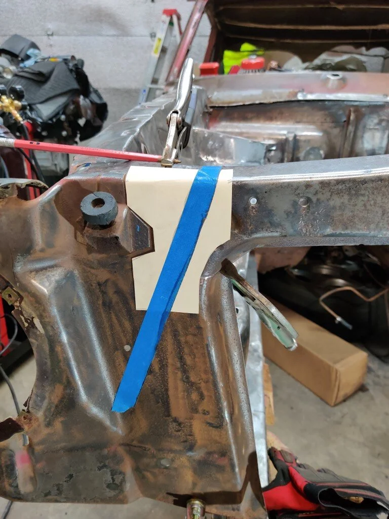

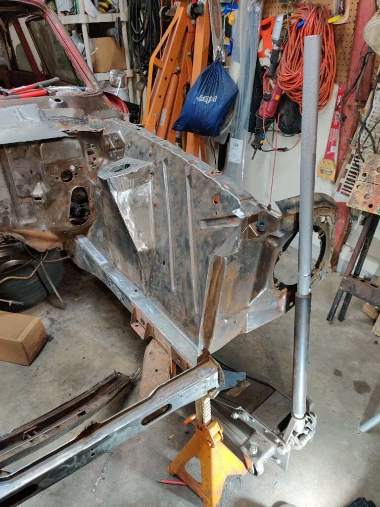

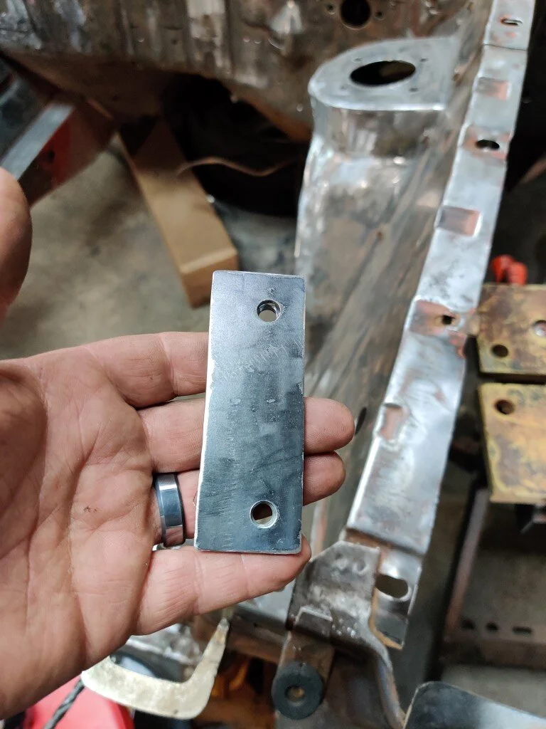

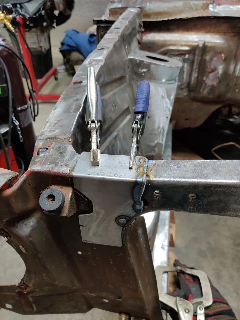

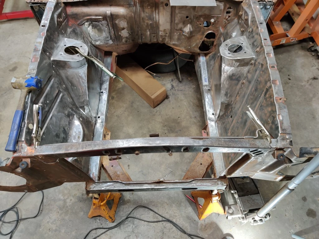

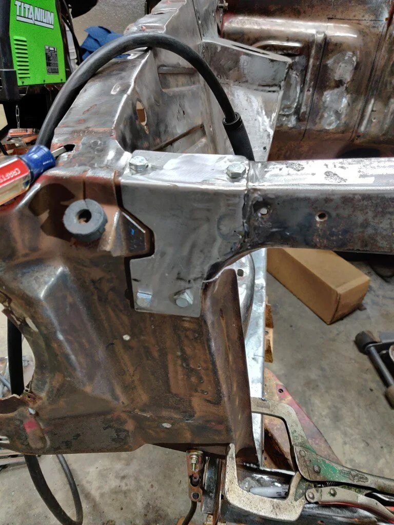

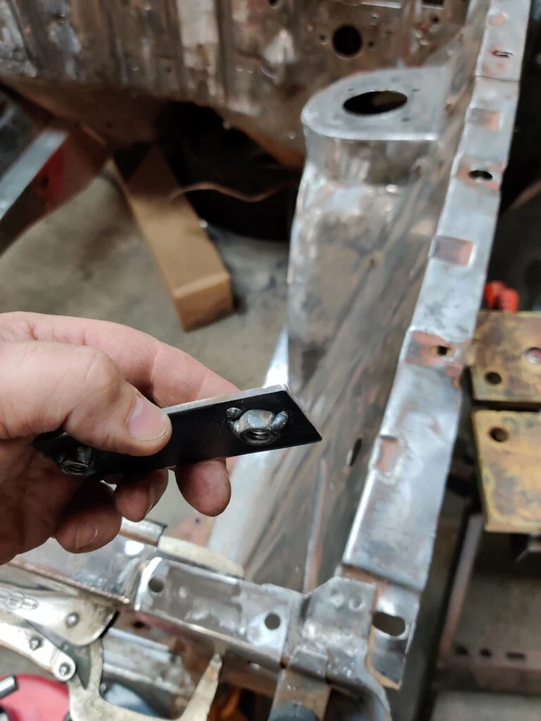

Today I made it easier to get any engine and transmission in and out of the Falcon. I made the core support larger and in support of more powa, opened up the tiny opening for the radiator. I'm thinking of replacing the square tube front crossmember with a round tube and make a slight drop mount for the radiator. I wanted to put a backup plate with nuts under the top flange, but I wanted a big flange over the top to cover the gap you always see when people do this. I put riv-nuts on the bottom. They are there mainly for looks and to pull the flange nice and flat. I plug welded it to the core support and also welded the edge...mainly to keep water and stuff from getting in back there. I will pull it off and weld up the back for the same reason soon. I need to buy some matching hardware to bolt this thing in when the time comes.
Reactions: RaggedGT

More pictures of the today's work.
Welcome to the removable top saddle brigade. Removing that top brace is the only way anybody can get an inline six with a 4l80e attached to go into a fox. Obviously the same can said about any engine attached to any transmission when talking about an old assed Falcon.
Good work D.

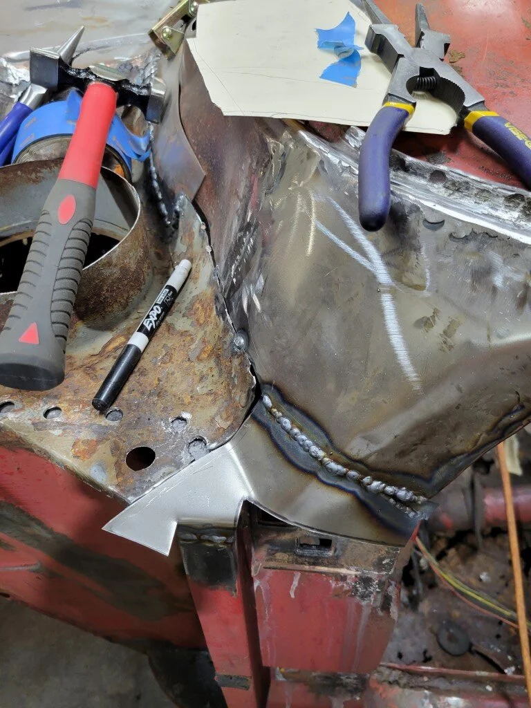

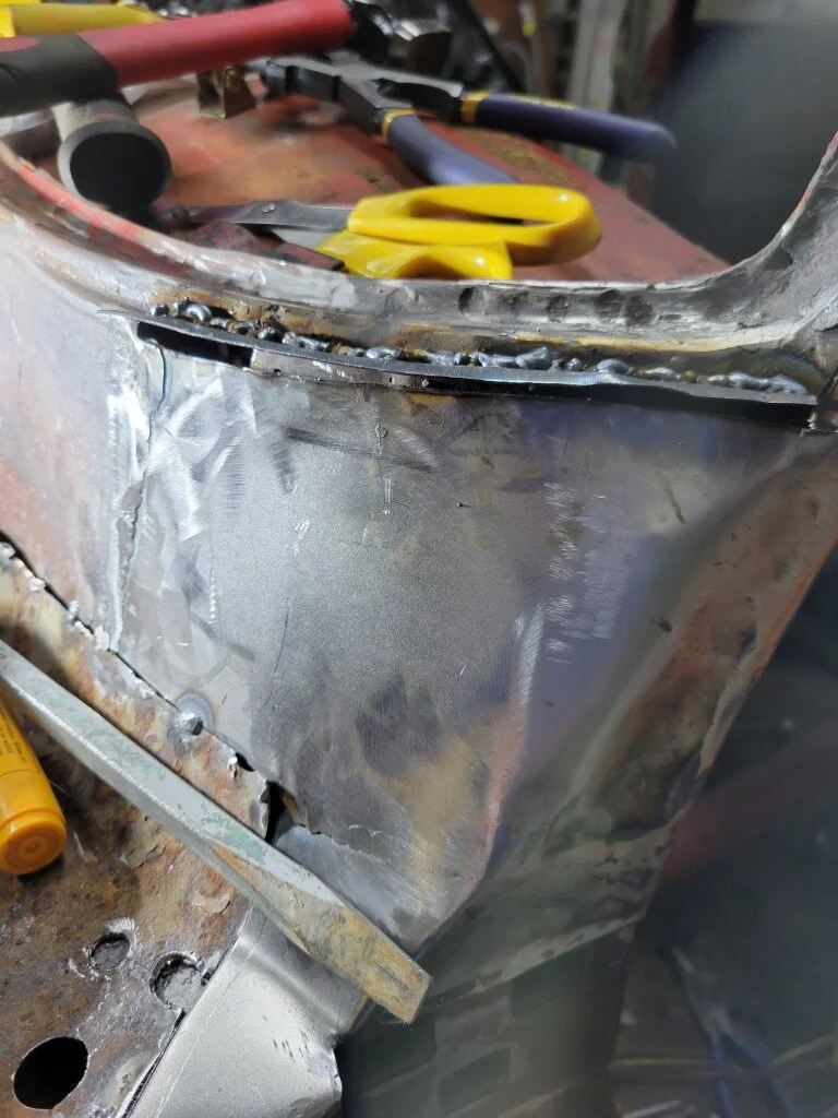

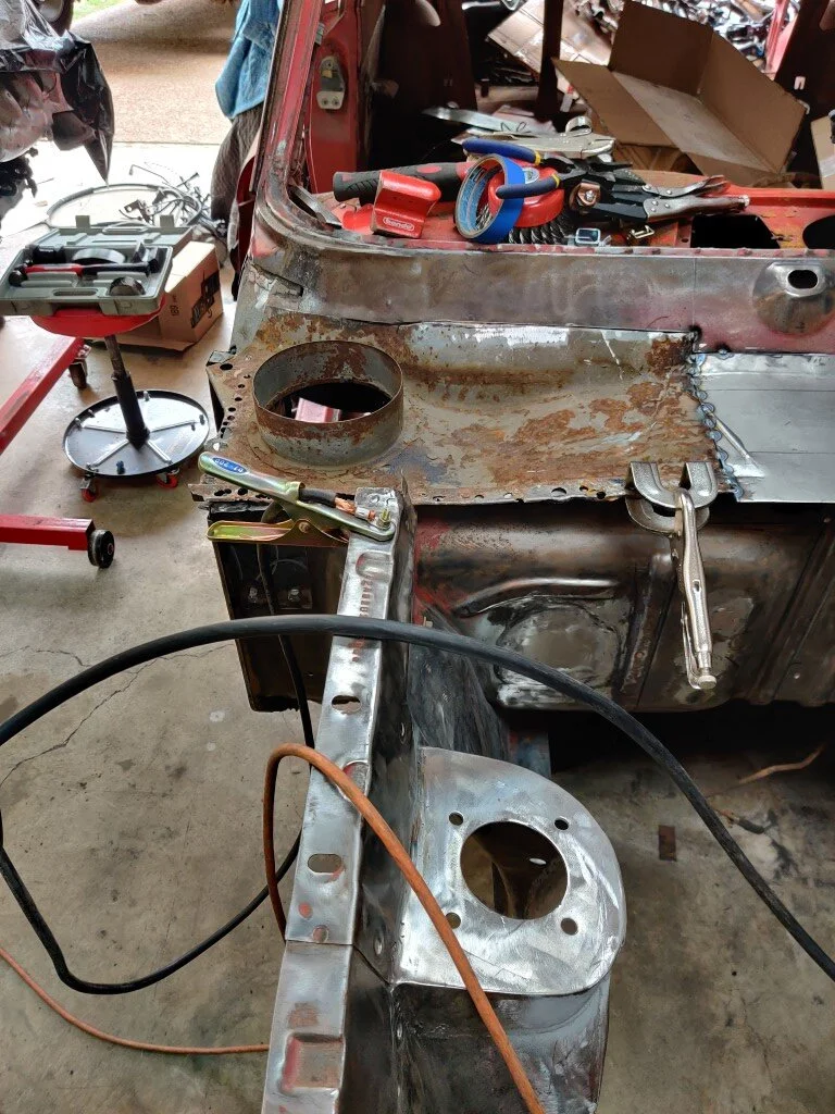

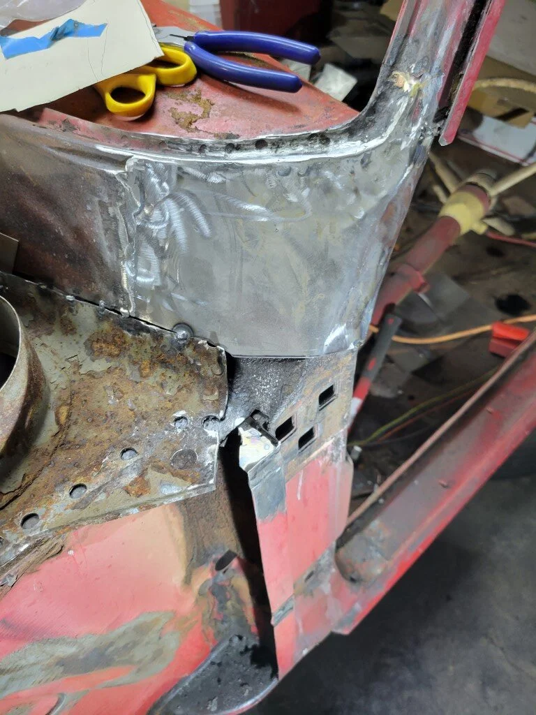

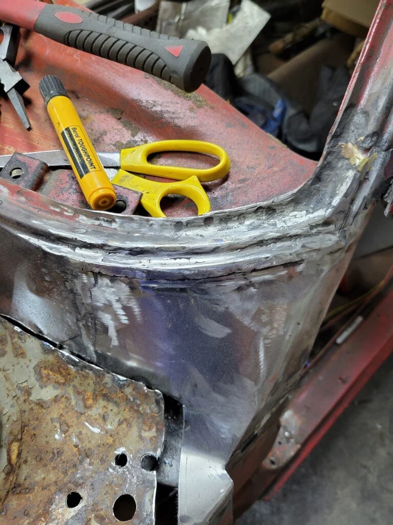

Previous someone said I better be a good welder to have this car and I said, I should be by the time I am done. Well, I'm still not a good welder, but I am much better. I tackled the driver side A pillar repair last weekend and today. Last weekend I tried to repair by just welding up the holes and trying to use lead free body solder. FAIL. I may have failed again by not putting the 2nd roll or offset under the windshield, but I need to put the upper cowl on and see how the windshield would fit back in. I figure I can slice it, use the hammer to move it and weld back in a piece if need be. I think it will be ok, but that's what I get for getting excited that my welding was better and forgetting that. The first pic and 2nd pic should explain it...that's how I noticed it...when I was uploading pics just now.
So I cut it all out. Today I patched it in. It's not show car quality. It's probably not even MAACO quality. But it's solid and looks good enough. Also, this week the 10 point S&W cage came in. Since the floor is rotted out, I'll probably get some 2x3 tubing or 1 3/4 .120 wall to make outriggers to mount the hood and down tubes on and patch the floor in later
Anyway to today's work.

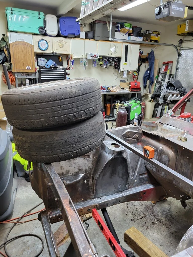

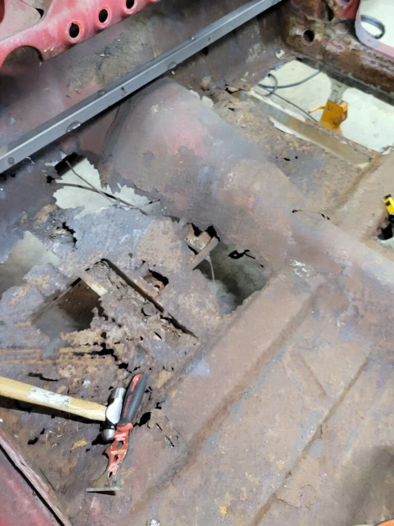

The guy who bought my 85 stopped by in it a few weekends ago. He's not a computer guy and when I sold it to him, I said it would be just a minute to convert it back to carb. He went ahead and bought the Holley HP EFI setup and said he was going to put that in and learn. Well, when he came by he had put a carb on it. LOL. And new tires...not sure what he did with the drag radials that had less than 1000 miles on them, but the fronts were a dry rotted mess. It still sounds as good as I remember. But you know what, I didn't miss it.
So, not sure if anyone on StangNet cares for my thread becoming FalconNet, but here it is. I've been piddling, but haven't had a lot of time to work on the PBF. Took a week at Memorial Day to go to Gulf Shores and drink rum like water. I have really dry feet and despite lathering them up with some kind of concoction my wife gave me, the 2nd day the soles of my feet didn't like walking across the sand and shells to our chairs and split open. I suffered thru it until Friday...my left sole was split wide open and I was drinking rum at 8am to help kill the pain. I actually stayed in the room all day keeping my feet up and icing them intermittently. It took about 2 weeks for that to get over. She bought some stuff called O'Keefes Healthy Feet. Man, I wish I knew about this stuff 5 years ago. I imagine I'll deal with this on my hands and feet the rest of my life. My dad has the same issue, except his hands are worse. The skin on his fingers will crack open sometimes.
Anyway, the vacation and foot wound took me out a couple of weeks. Then, we are really really busy at work. And having to work some Saturdays. So after working 8-10 hrs a day 6 days a week, I have just been a couch potato on Sundays.
And then there was Father's Day. My stepson and DiL came over with the baby. She was talking about how she must've gotten food poisoning on Friday night and were just starting to feel a bit better. Monday morning when I woke up my wife was in the bathroom spraying out of both ends. Needless to say, a terrible stomach bug was an unwelcome visitor. I missed the first 2 days off work sick in 17 years. I didn't get stuck on the toilet too long, but I ran a fever and felt like I had been hit by a Mack truck towing an M1A1 Abrams. Every joint hurt...even my knuckles. I finally feel somewhat normal after 2 weeks, but still not exactly right.
On Prime Day I looked for any deals on a Plasma/Tig machine. Not necessarily a Prime Day deal, but I bought an Amico CTS-160. DC Tig, Plasma, Stick. It was less than $500. I'm mainly interested in the plasma for now and it seems to work great. Makes short work of the rusted out floor. I need to buy an argon bottle and play with the TIG function. I will probably use that to try and do some more rust repair on the windshield channel.

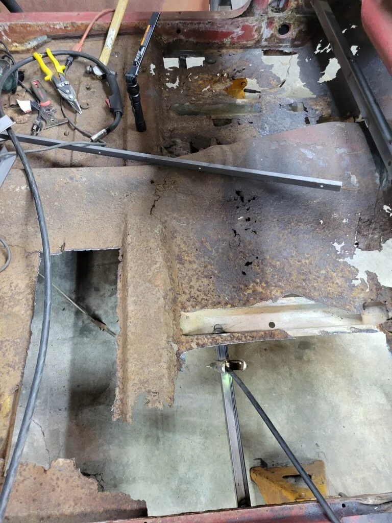

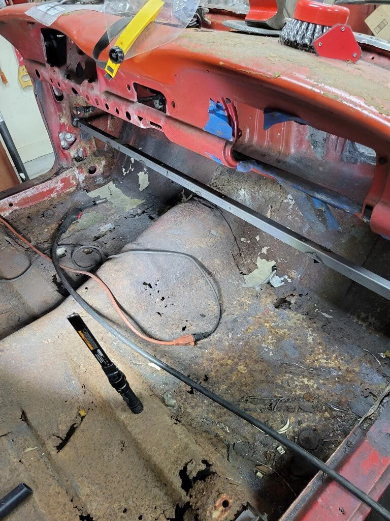

Saturday and yesterday, I was working to clean out the car to start cutting out the floors and put subframe connectors in. One thing I was worried about was all the rust and having the cowl out makes the car very flimsy. So I started by putting a brace from kick panel to kick panel to tie the rockers so they can't spread out. I then noticed the back of the front frame rails, which was the floor supports in the car were not even. I started playing with the jack and realized that the weight of the front end would flex the firewall and allow the entire front end to move up and down over an inch. After a bunch of web research, I've come to the conclusion that the rockers and frame rails should be parallel, so I bought a digital angle finder and started blocking the car up yesterday. It's got a decent twist to it. The car is level side to side, the rockers and drivers frame rail are within .1 degree, but the passenger rail is 3 degrees up. I put two tires and wheels on the front corner and it's still up a little. I need more weight to get the rail parallel when I weld the subframe connector in. It will also get locked in when the cowl gets welded back in and with the bars that will come off the dash bar and go to the shock towers.
I went and bought a piece of 1x1 tubing and welded across the rockers at the pinch weld to lock the passenger end of the front frame rails down. This will let me get the subfame connectors in after I cut more of the floor out. I think it will be possible to put them in from the top and weld them in pretty solid. I plan on making a roll over jig soon, so I can roll it on its side and finish the underneath welding a lot easier. I'm not sure if I am going to buy floor plans for just sheet steel and fill in the floor after the cage installation. I already have some 2x3x.120 tubing on the way to make outriggers for the cage, since I would trust putting the cage on a replacement floor anyway.
One cool side effect of the rust out floors. They are so rusted, I just took the painter scraper and a hammer and peeled them off the rocker and most of the frame rail. The frame rail must be galvanized because it's perfect and the rocker is in decent shape....but no drilling of 100's of spot welds! Yay me.
Pics for those who don't want to read this useless diatribe:

After working with it more, I am buying some more 2x2x.120 tubing and extending the sfc. I want more in the front subframe and it to go farther back toward the spring mount. Even if I back half the car, I will use the back of the sfc to mount a crossmember to build the back of the car from. I'll get some pics when I extend it.
