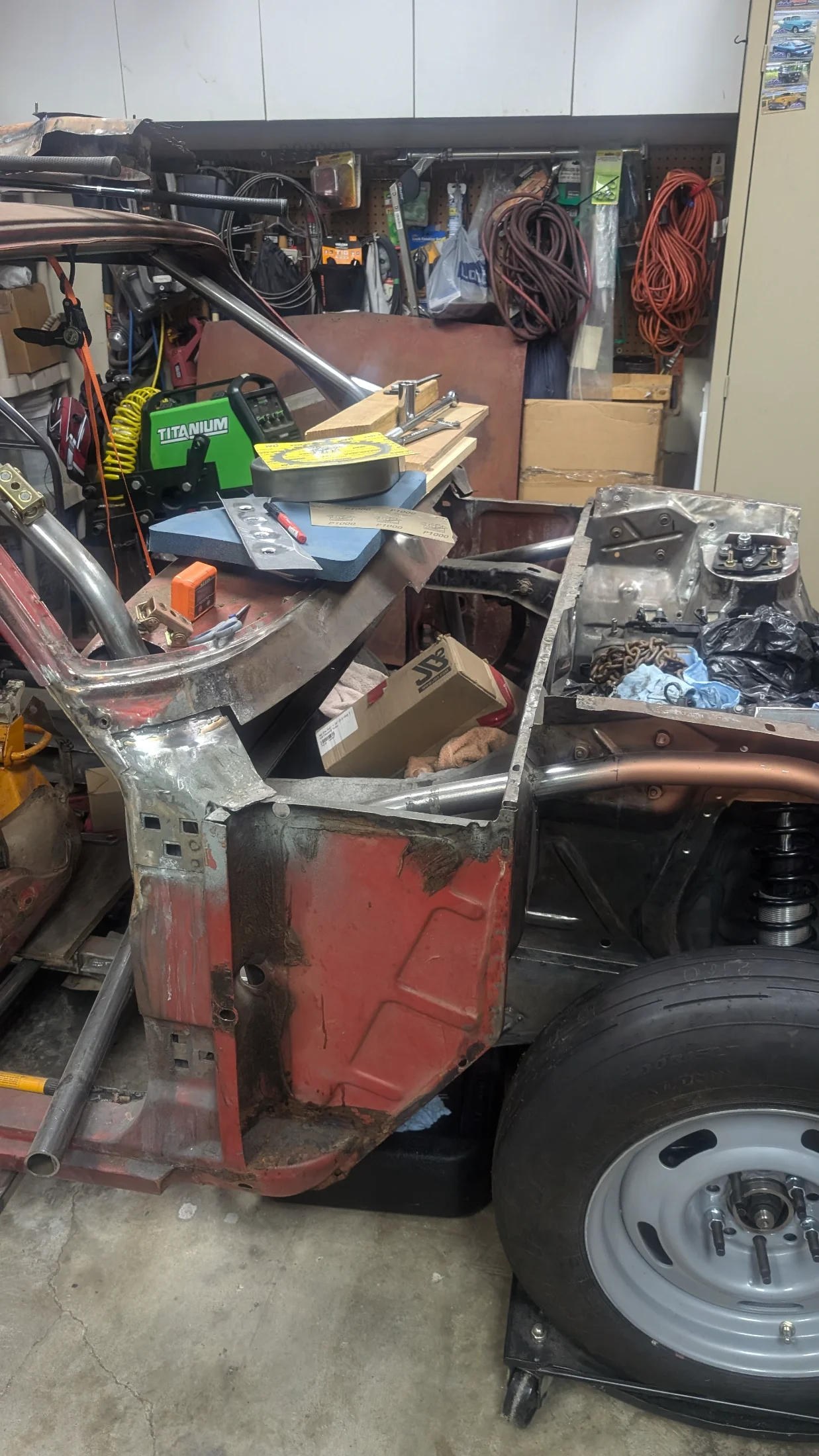

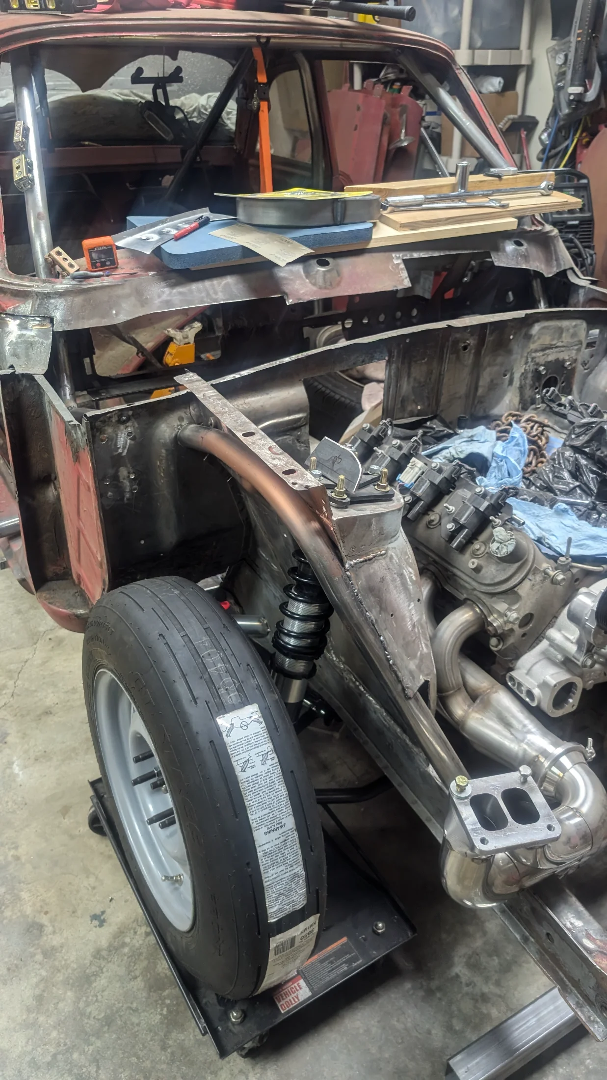

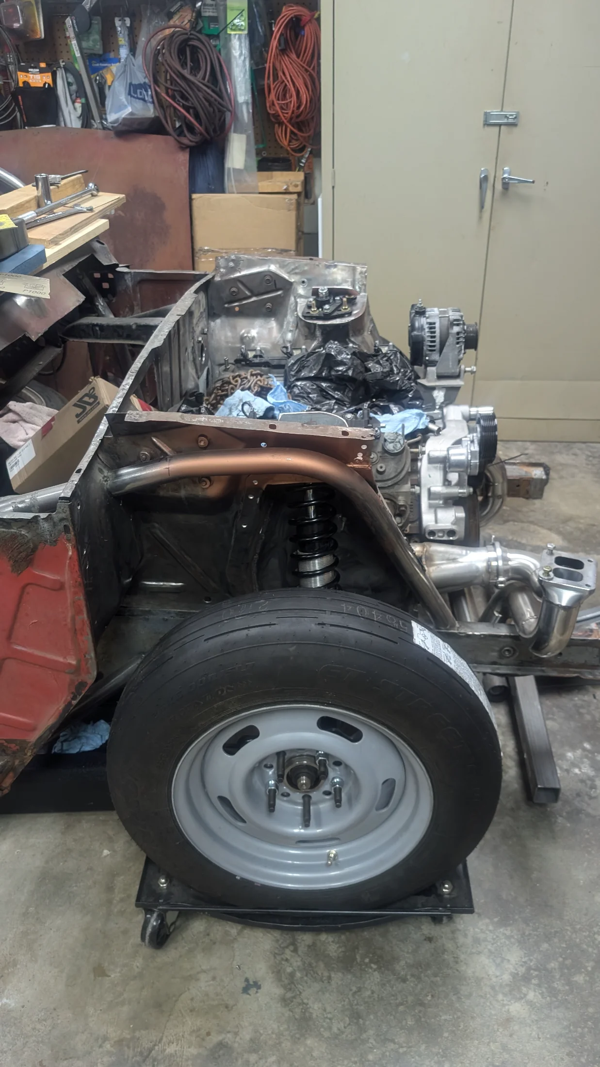

Well, I've been busy, but when I have free time getting some work done on HeHateMe. I ended up not liking how the S&W a pillar down tubes fit. So I got the JD2 tubing bender from my brother and ordered a 1 5/8" die for it. I messed up a tube getting the hang of it but made a down tube that fits good.
Then I tried making a dash bar. Again messed up but ended up getting it tucked in just under the dash top. It's just sitting in there and won't get final welded until the entire cage drops gets welded and gets put back in. I'll probably have to cut a flap in the dash top to weld it but it's worth it since it's above the glove box.
Then I made the bars from the down bar to the firewall and from the firewall to the fender apron.

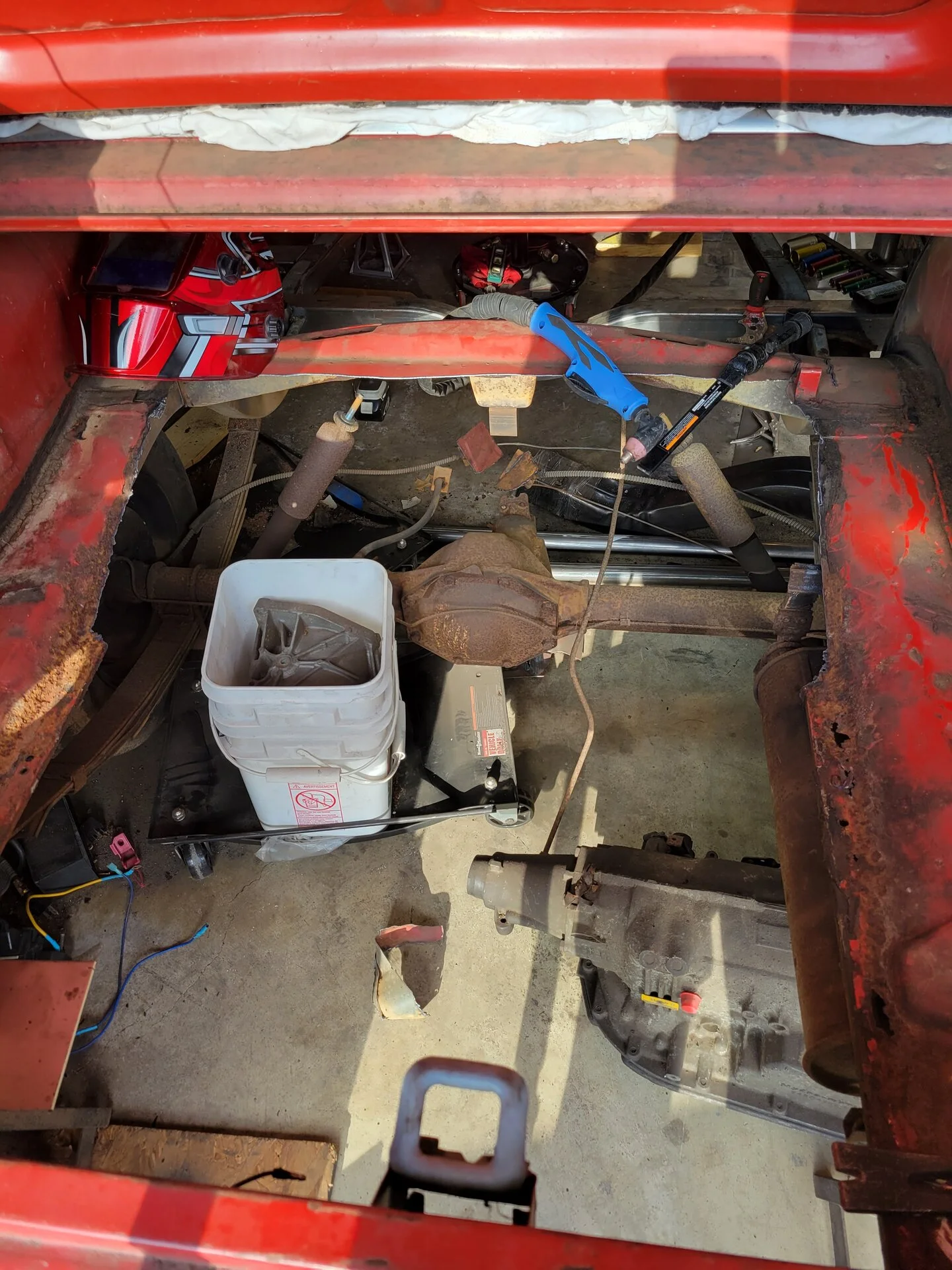

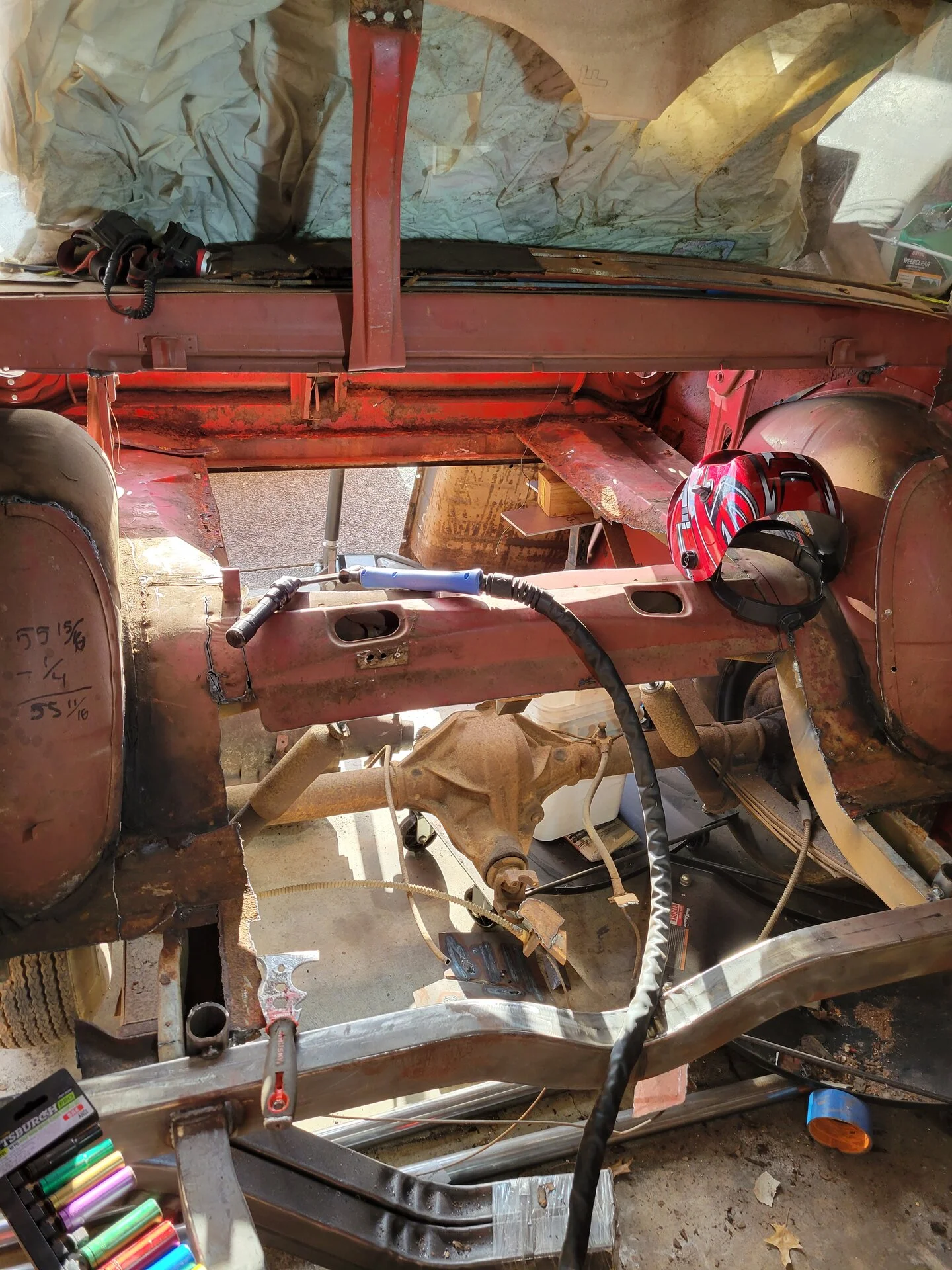

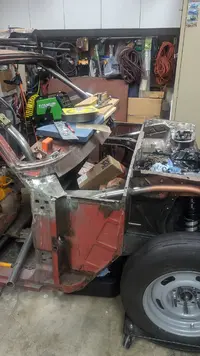

Not much going on here for Xmas eve so I am about to go out fire up the plasma saw and cut the back out and start laying out the rear frame.

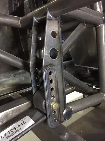

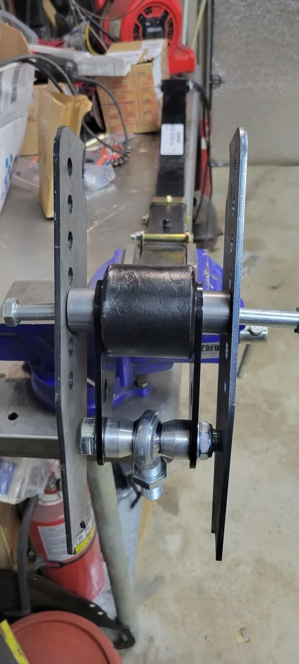

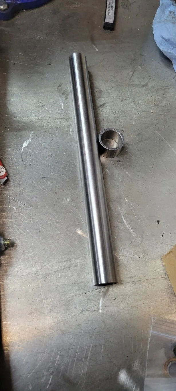

So this is a Tin Soldiers Race Cars adjustable front leaf spring mount. I was super excited when I saw this. This is what I want for the front of the leaf springs. But I read it won't work with Caltracs, but will work with Smith Racecraft Assassin bars. Why I wondered? So I got them and found out really fast. The Caltrac has a clevis and the bolt sticks thru and would hit the leaf spring perch once you moved up to the 2nd or 3rd hole. Well, FMR. I can sell the Tin Soldiers and get most of my money, but they also came with rear slider adjustable mounts that I will be able to use.

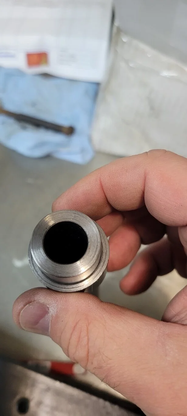

But after doing some thinking and measuring I came up with a plan. The Caltrac split mono leaf has a 1" id bushing in front. It comes with a 1" od sleeve to go thru and bolt it into the car with a washer on the outside to space it enough to keep it pivoting free. So, I bought a length of 1" od tubing and 4 3/4" long 1" id pieces of tubing. So I will measure and cut off the 1" od tubing to the right length and this contraption will space the brackets far enough for the Caltrac to work. I spent about $40 on all of this. I will have to get some grade 8 5/8" bolts of sufficient length, but this should work fine.

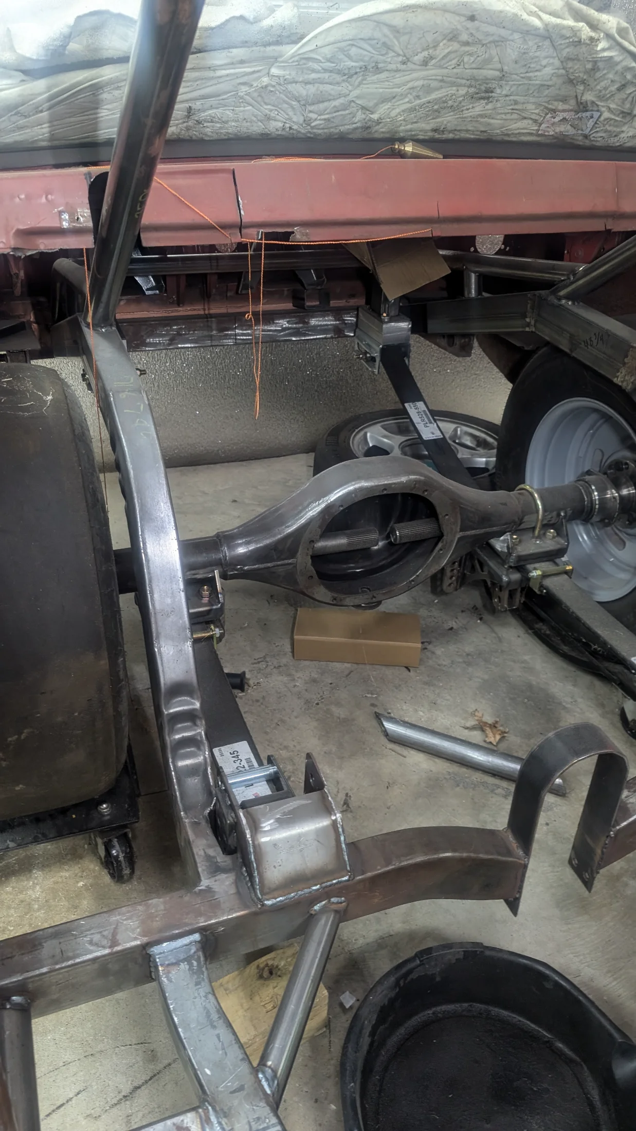

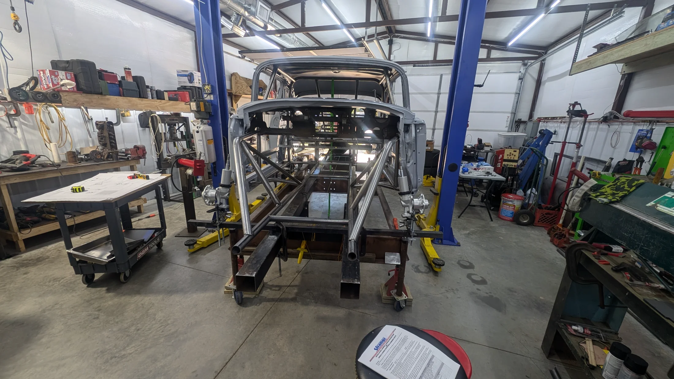

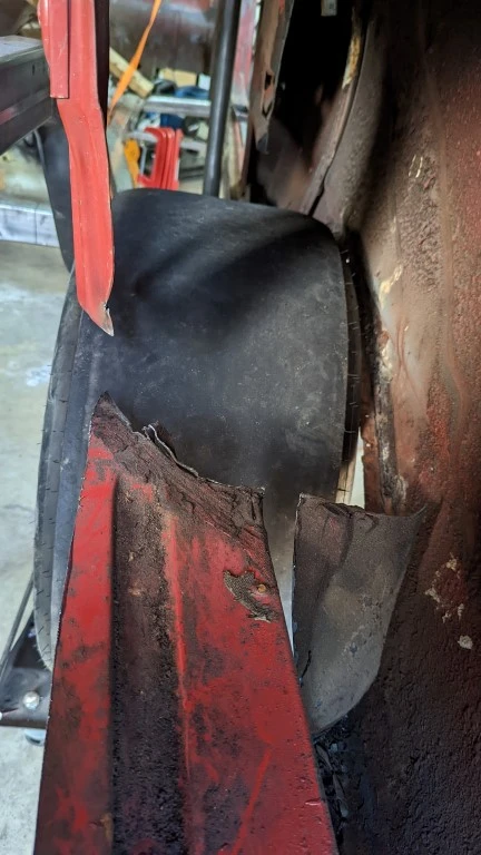

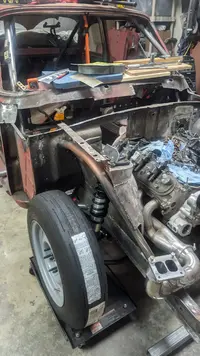

I have gotten a few things done on HeHateMe. My brother came over 3 weeks ago and we cut the roll cage out and dropped it and he welded the halo and windshield bars completely in. Then we put it back up and semi- welded the bottom in. Then we took the S&W frame rails and decided to modify them to make sure that there's never going to be a reason the car can't sit low enough.
On our 83 Regal in our youth, we didn't put the tubs up high enough and then put the cage down tubes over the top of them. We never felt like cutting the cage out and cutting the tubs out to fix it.
I have room for 13" of tire. I kept the frame rails as far apart as I could so the springs will be as far apart as possible. Maybe next weekend, I will start working the rest of the bracing for the cage. It's a 12 point, so good to 8.50. I have the 25.5 sfi book and will add some of the floor bracing, not so much for cert, but for safety.

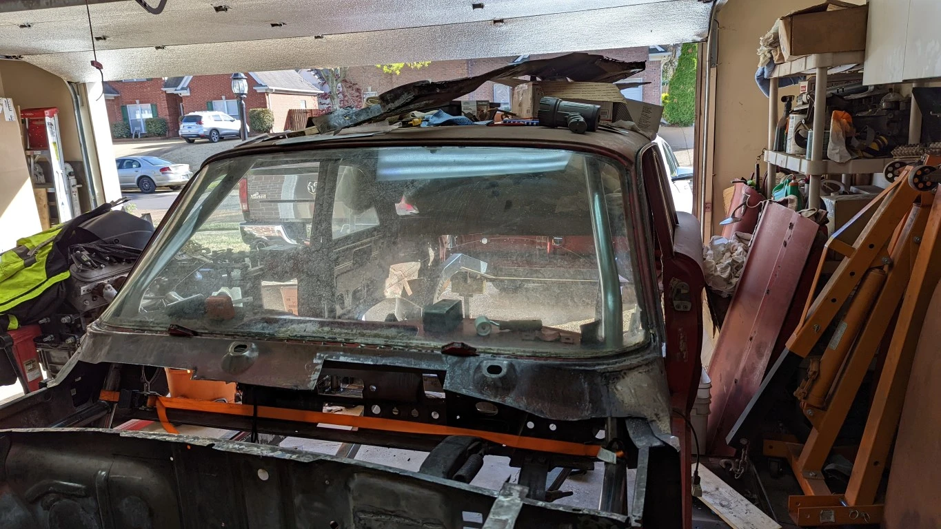

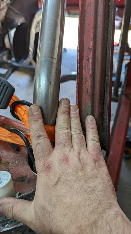

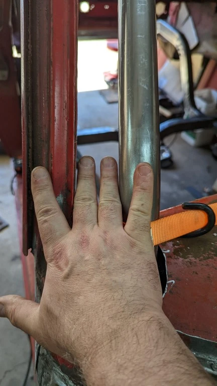

And then there is the hole measure twice cut once thing. So, when I bent up my A pillar bars, I kept thinking, they are really close to the windshield. I never got the windshield to test fit. So 2 weeks ago, AFTER they had been welded in, I got the windshield down. It clears on the the passenger side, but not the driver...the windshield was resting about 1/2" off the flange sitting on the bar. Boy was I pissed. But then the more I looked at it, I realized the bar had moved towards the a pillar. So with all my ratchet straps and making some wedges, I was able to move it over towards the center. I had to then cut a huger hole in the dash to weld the dash bar in to hold it. I'll make a pleather cover or carpet cover to cover the dash when I am done.
It's good now with no gasket, so the space the gasket adds will probably leave the glass 1/4 to 1/2" away from the bar.

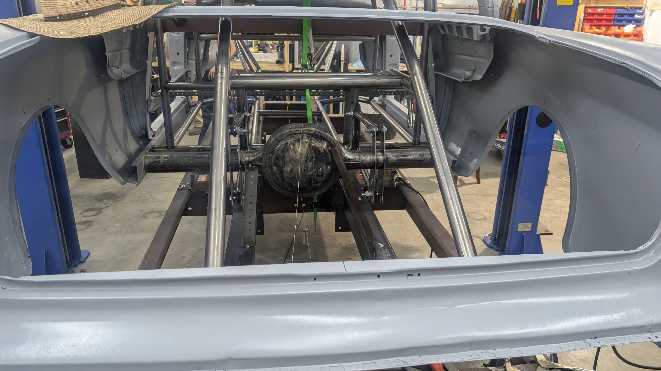

I'll post some pics...I may have over built, over thought the leaf springs, but I have them all pretty much tacked in with a way to raise and lower them in the car if I want to change ride height.

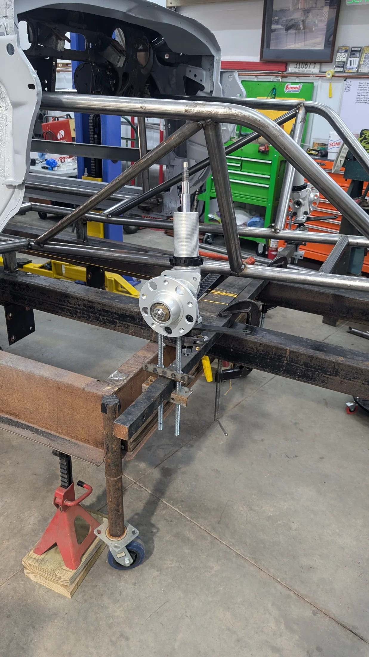

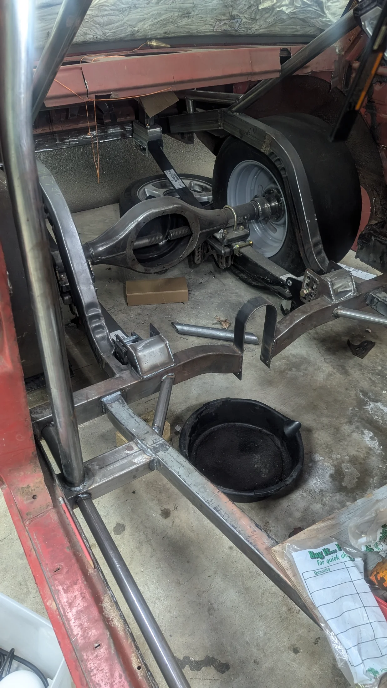

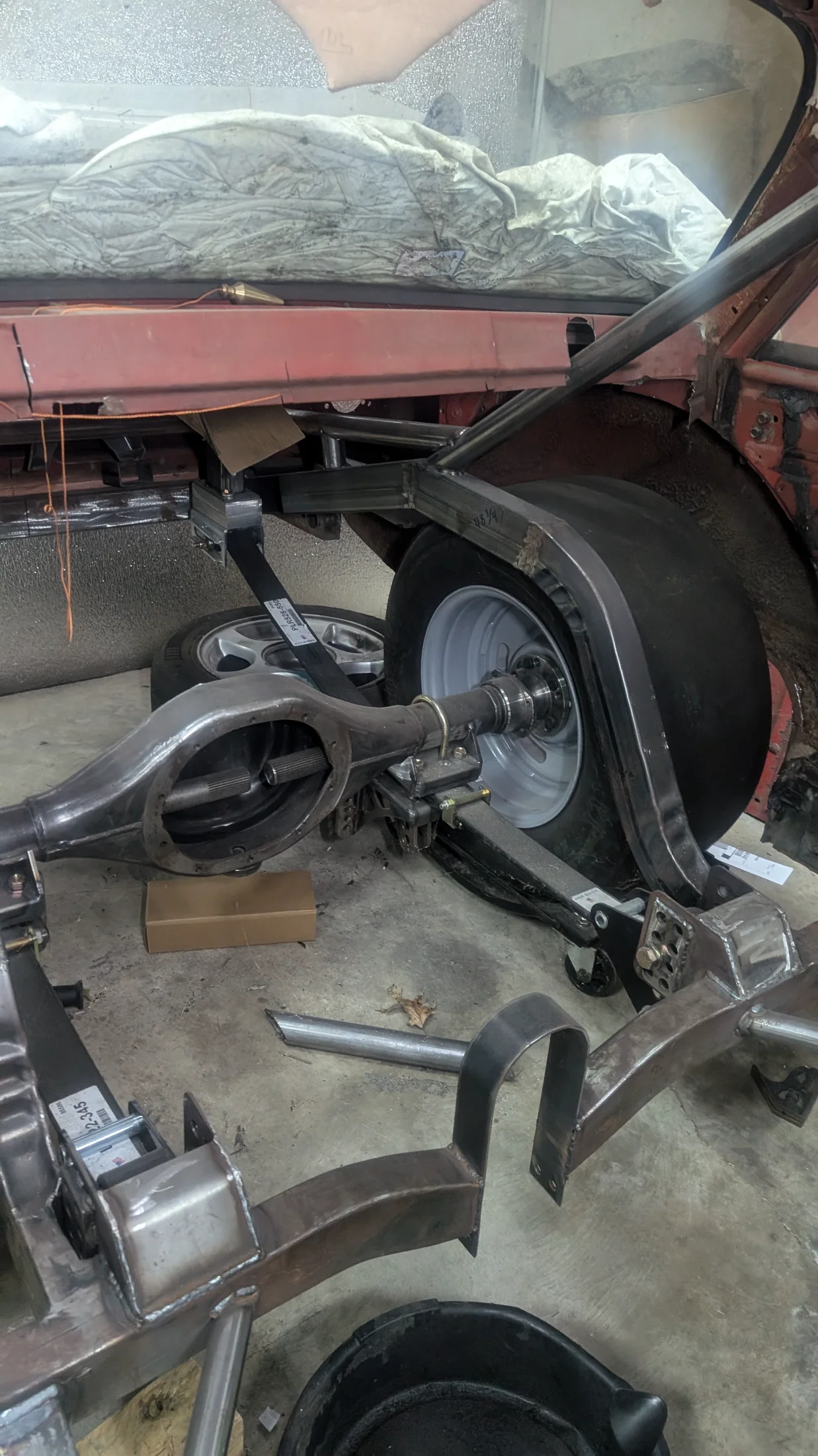

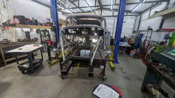

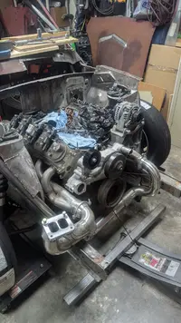

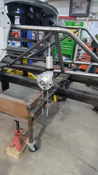

Well, these storms were bad...we got a ton of rain, but NOTHING like east TN and NC. Pray for those folks!!! Here's where HeHateMe sits now. I have gotten some stuff done. The lasst thing was my brother building the homemad driveshaft loop. Only for us to get done and say, well that sucks...it's so low. I'm going to cut the loop out of the 2x3 crossmember, so that what is left is straight and level. And instead of the homemade ds loop, put in a 2x1 rectangle tube loop. Next up is to figure out the elevation of the driveshaft and do all of that. As you can see I made changes to the front bar setup.
Instead of the bolt on affair that goes to the side of the shock tower, I made full down bars. I'd gotten pretty decent with my tube bending skillz. I added a pnuematic over hyldraulic jack which makes that JD2 bender work like butta. This is just going to be an 8.50 cert but I am pretty much going to put everything in except the FC cage to be able to 7.50 cert it in the future if I want to. I know there was a lot back n forth between me and Mike about bracket racing, but honestly the goal for this car was always to do at least 1 drag n drive. Hence the turbo. The LS is mainly so on drag n drive, if I blow an engine we can run down to the nearest Kroger and buy another one and throw in to at least finish the week.
Still a lot of tubes and welding to go. My bother built a 25x30 shop at his house in Ark where the 55 is and at some point will drag this hooptie there to use the lift and get under to weld or build a roll over jig and do it here..
Before anyone asks...those are Funkhouser Race cars U-boltless axle perches...top notch stuff. The U-bolt was cut off and welded to the perch to hold the axle until we get everything to the point to set the final pinion angle and weld the housing to the perch. Then removed the u-bolts. I made the Leaf spring mounts adjustable, just in case, but I think I like the ride height about where it is now. I decided to go with steelies. 15x10 in the back and there's room for a 12"tire. At some point I need to cut the back glass out. I am sure I will find part/most/all of the bottom channel rusted out.

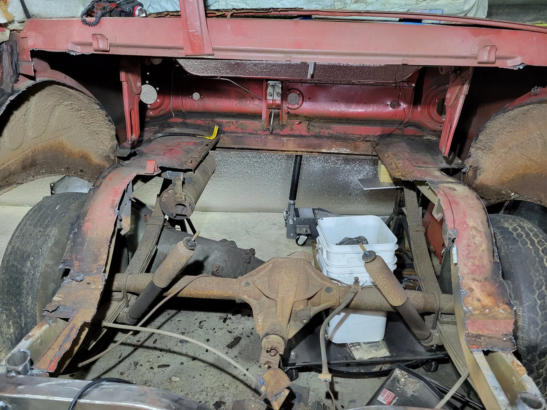

As far as the 55 goes, we had a set of T/A Aluminum heads back in the day which got lost over the last 30 years. But my brother has decided he wants to build the fastest factory cast iron head 455. He has spent a ton of time cutting up the heads, and welding them back up. He has raised the intake/exhaust ports significantly and will fill in the bottoms with epoxy. He's cut up an aluminum edelbrok intake for the flanges and started making a sheet metal aluminum high rise intake. He just contacted a company to make exhaust flanges with 2 1/4 stubs and should have those soon. Going by ET calculators, the 455 in the Regal was making somewhere between 675-750hp depending of you use ET or MPH. So adding almost 70 cuibic inches pretty much adds another 100-125 hp min. It's a mild steel tube chassis, so we might be cert limited on ET and speed.
