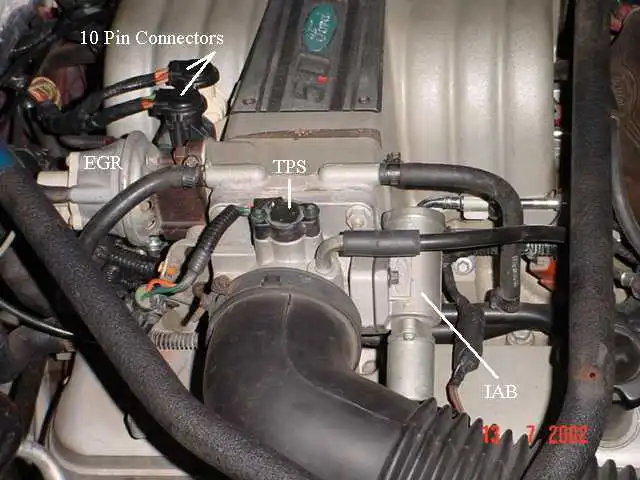

How do you guys clean your throttle body? Doesnt it say not to clean it? Also were is the salt/pepper connector located?
I bought that IAC adjuster from 50resto.com and it sucks!..used the new gasket that it came with and threw the rest! :nonono:
Some TB's are coated and are marked "Do not clean". If they have no markings, spray them down & use a toothbrush to do the tough places that refuse to come clean. Spray some more and wipe up the mess with a paper towel. The rest will go through the engine with no problems.
The salt & pepper shakers are the 10 pin connectors on the rear of the upper manifold.
Photo courtsey of Tmoss & Stang&2birds.
