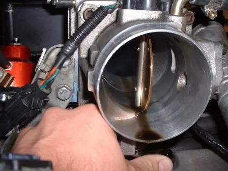

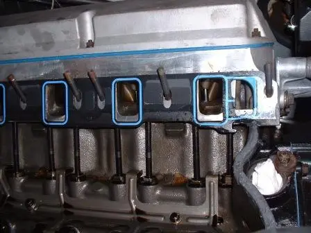

I reset my idle and it still idles like boo boo with the AC on it doesnt surge as much but taking it out of gear and coming to a stop it falls on his face dies or "surges." I reset the idle to around 900 (thats as low as my TB would allow). so I give up with the AC on my car idles better without the IAC. I hate removing stuff like that, but if it does more harm than good...
jrichker said:
Advancing the timing (within reason) makes the engine speed and vacuum increase on any healthly engine. If you had a small vacuum leak, advancing the timing would still increase the idle speed.
You were dead on jrichker. My problem was a vac leak. But it was a little tough to find it since it was coming from the lower intake manifold, on the lifter valley side. I was actually pulling full engine vac on the crankcase! Check out the pics, you can actually see the bottom surface of the head through the intake port of the gasket.
