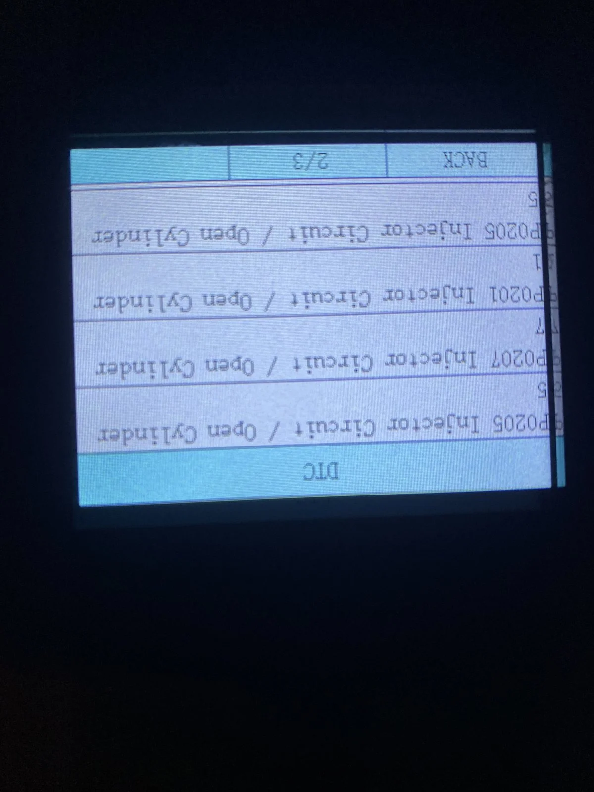

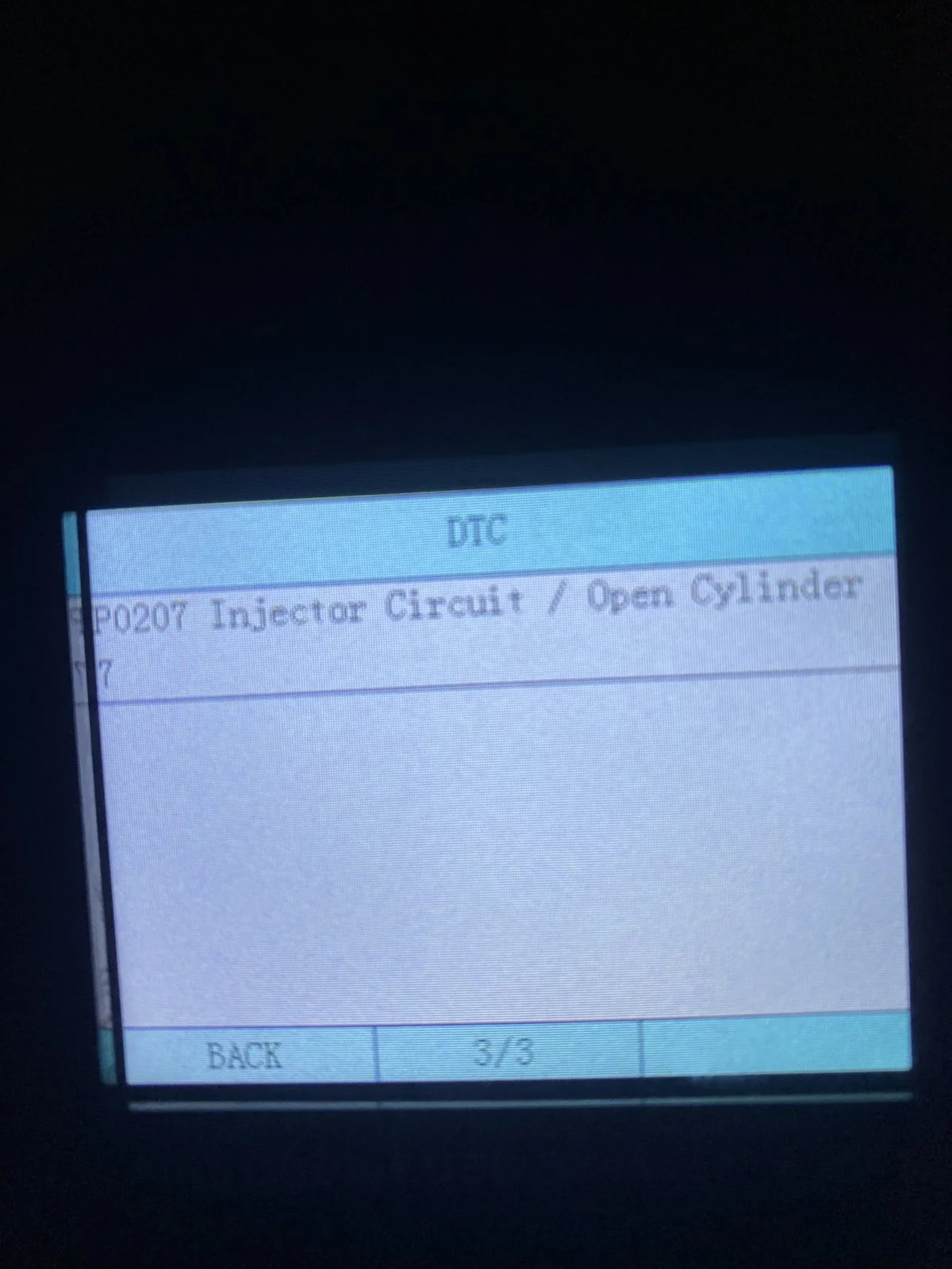

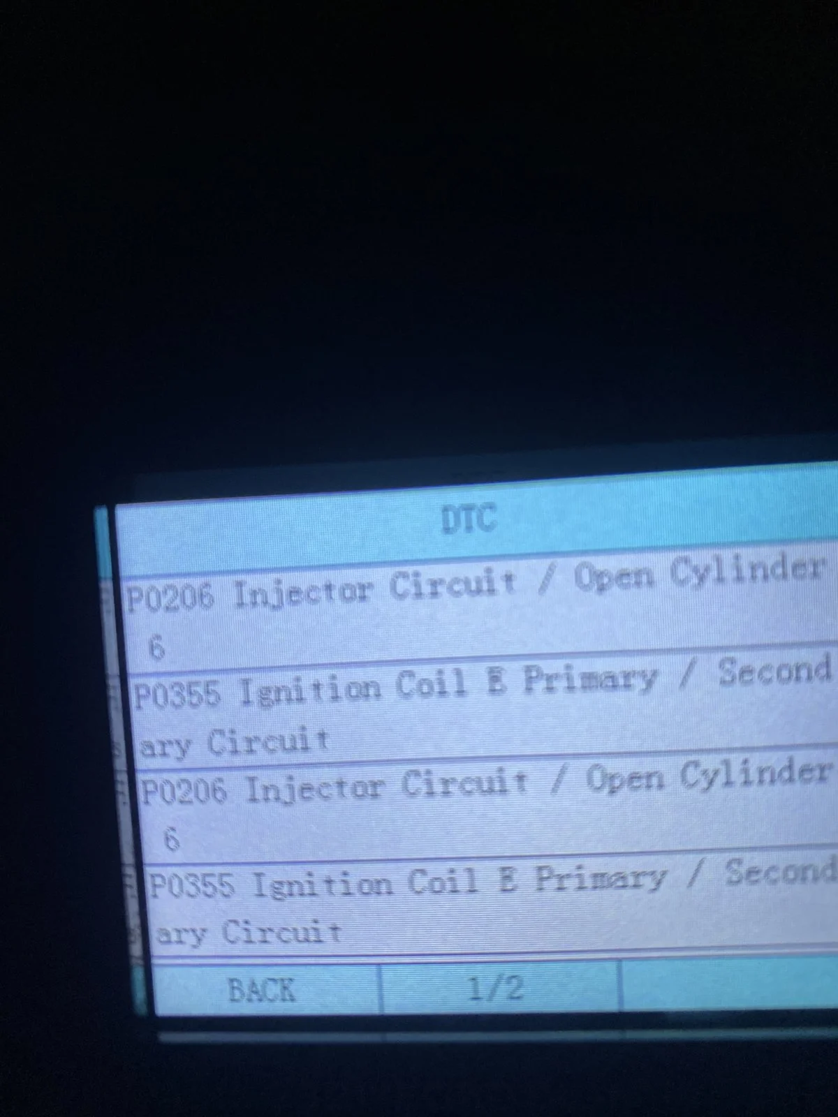

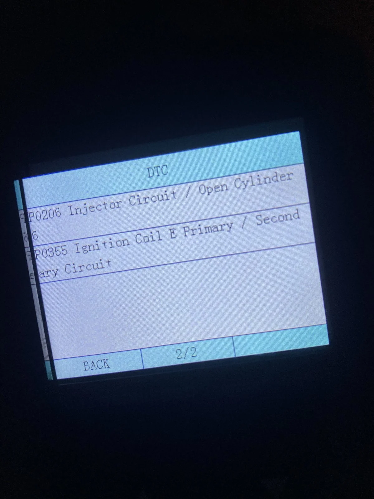

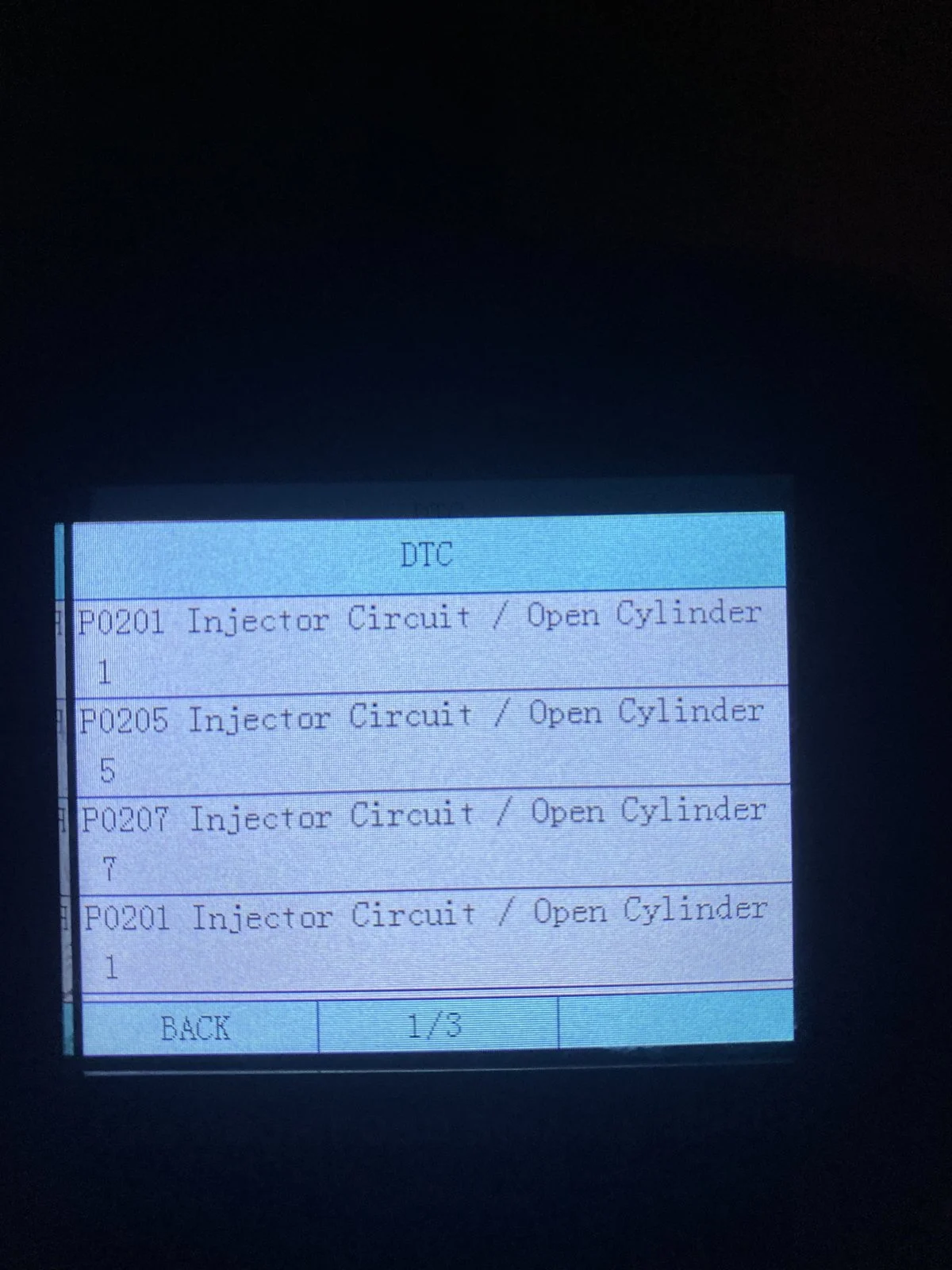

Help!! Open Injector Circuit Codes
I recently bought a 2004 “v6” but it turn out it had an engine swap to it aftermarket halos and a swapped transmission. The engine was a 99 Gt. I can’t figure out why these open injector codes keep popping up and I can’t get a smog with them. Do you guys know how I can fix this?

Hi,
So, does the car experience serious drivability issues as the data indicates? The vehicle was intended to be a V-6 based Auto...or 5 speed? I see Cyl 5, 7, 1, 6 Injectors showing as open as well as the Coil code. They the only 4 cylinders, or do others pop up, too?
Its showing up a cylinder 7 code & is a 6 cylinder CPU..a very confused (or incorrect) CPU..or corrupt programming. Up to ten cylinders may show codes within a damaged CPU.
It could be the injectors, grounds, wiring damaged or hacked together during the engine swap, it could be the wrong CPU, or drivers within the CPU. If it’s an auto, does it shift normally?
I’ve not seen a mismatched strategy coded CPU do this unless inoperable..or incorrect. Better understand this once we know how it runs, can you snap a shot of the Computer’s identification?

I think it was supposed to be a v6 manual nothing seems wrong with the car at all tbh but I’ve never driven a manual my dad it seems a little off but that’s all. He doesn’t know cars that much either here’s a pic of the computer I’m going to get a 2002 gt one later if I shouldn’t let me know.

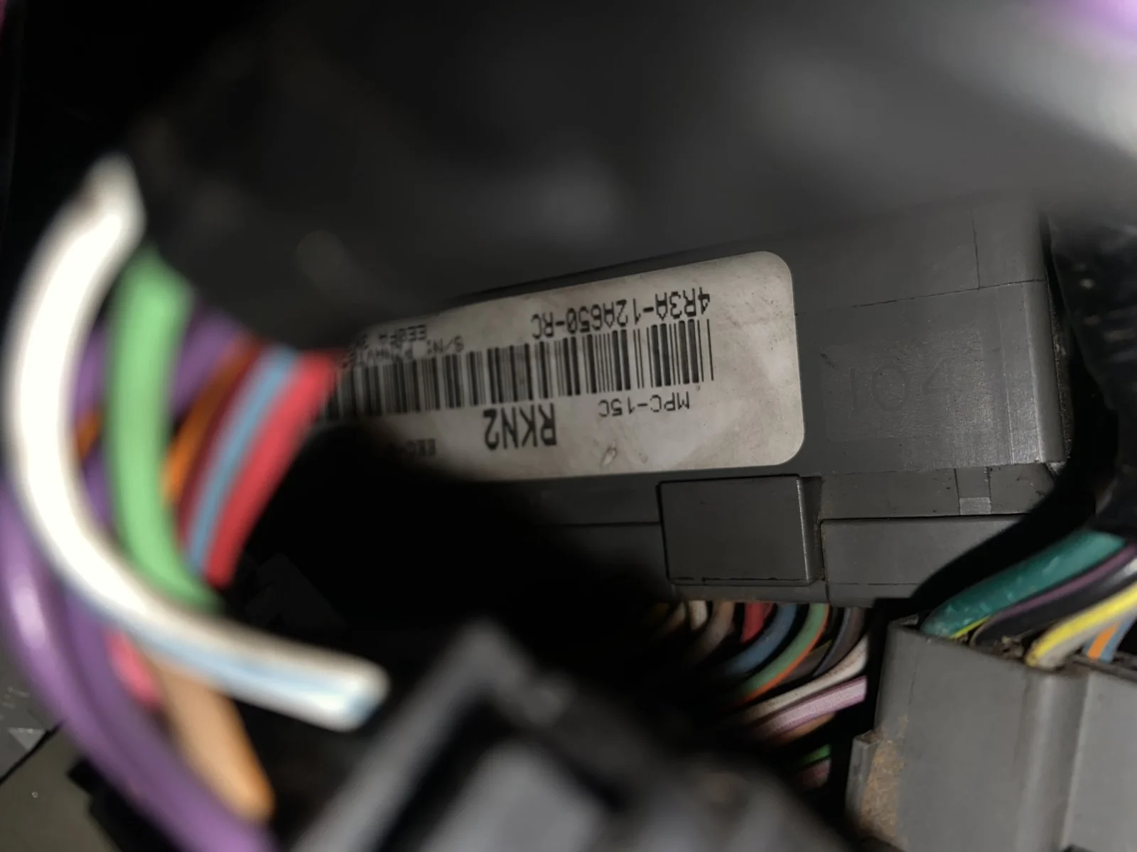

Hi, Ok-
I did a bit of digging & found this is the ECU for the 2004 Chassis with a strategy number for a 4.6L V-8. Not a 3.8L V-6.
Yes, this is likely your issue.
I wouldn’t worry about acquiring another computer just yet, this is obviously getting through the PATS handshake & is highly likely the stock CPU.
You can get a V-6 to run off a V-8 CPU, tuning is involved to get around issues such as you’re having, or- like the typical individual- you can buy a V-6 CPU (which I recommend against at this point). Certain CPU parameters need to be correct. First- let’s establish what the Mfg. says this pony was really bred as from the factory.
You can snap a pic of the vin plate, I’m not available tonight- but post it, and this you can also do this yourself. I fail to see why they would do a V-6 swap into a GT, but this mindset helps nothing. Moving forward....
Type the VIN # into a google search, some sites will pop up and allow you to see if the car was actually equipped with a 4.6L V-8 (Making it a GT). I’ll get back with you tomorrow, so- post a VIN # pic up, I’ll verify this for you then-k?
It’s also pretty easy to visually tell a V-6 Mustang from a V-8 by certain design(s), styling and parts under the chassis. If it’s been modified, may be more difficult for you.
It’s discussed here on Stangnet in the archives, here’s a link..
https://www.stangnet.com/mustang-forums/threads/differences-between-v6-and-v8.716798/
Ok, talk tomorrow- good luck!
-John
P.S.
Please verify I got that CPU ID right, fuzzy..
4R3A-12A650-RC PCM MPC-15C

Hey not I did vin check the car it is for a v6 3.8 and I bought a used pcm off a pick n pull for mustang he said no problems with it the old pcm had “4.6 v8” written but I can’t really tell so i got another one I installed and the car cranks but no start which is most likely because it needs to be reprogrammed so I have a guy coming later to do this job but yes the vin is for a 3.8 v6 and the guy at the junk yard said the shouldn’t be running good or alright and should be misfiring and not properly working if the fuel injectors actually had an open circuit and the vin is IFAPP40644F199919

Hi,
I’d mentioned that the PCM is for a 4.6, which is confirmed. There’s a quite uncertain history of this car, motor swaps. This is why I suggested proceeding with caution, so it doesn’t cost you a pile of money.
When you’d mentioned a “99”’ 4.6L installed previously, now a 3.9L V6 is why it’s best & you first gather information & verify there’s no wiring harness “hacks” or accidentally damaged wiring, in contrast to just installing another CPU without inspecting.
Component issues, grounds, or differences incorporated within the harness by the individual installing the motor(s) may cause CPU trouble codes to be thrown, even when the engine seems to run ok. It’s not the correct CPU, Nor the first time I’ve seen this.
This is why I’d asked about how the car ran.
Indirect wiring damage or modifications to the same may confuse or cause damage to a CPU & I was going to have you to run a few tests as a precautionary measure to ensure that was not going to happen to you before you installed the correct CPU.
Yes. The CPU will need to be reflashed to work correctly with your car’s security system, PATS. It’s not recognizing your transponder key as the one which it was paired, and is likely why it’s not starting.
Is there a security light lit up on your dash?
The ECU, key & gauge cluster are components of PATS. The software to re-assign is WDS (World Diagnostic System) and can reprogram the VIN# to the CPU & PATS to function correctly, match each other again. Do you have the VIN# from the vehicle the new ECU came from?
Verify this is done correctly, with WDS or a high end Scantool’s relearn program.
Verify the person/location is not just disabling PATS with a handheld flash tuner, this will start the car, but other issues that may make you fail inspection may arise.
Ensure VIN# matches the vehicle & all your gauges & accessories function properly.
It’s beneficial to have the Ignition and key from the car where the CPU came from, and install it, or a new one purchased & programmed via locksmith with the software or dealer.(if you want a spare, now’s the time to do it).
If you have any questions, feel free to post. Hope it all works out for you!
Good luck!!

Yea I got it started he reprogrammed the cpu with the key and everything last night it sounds fine still and the scan tool showing no codes and no lights on dash the speedometer still however doesn’t work it goes up to the 150mph tick mark which I believe is for a gt sn95 correct next if I’m wrong and I can still do those tests you mentioned
