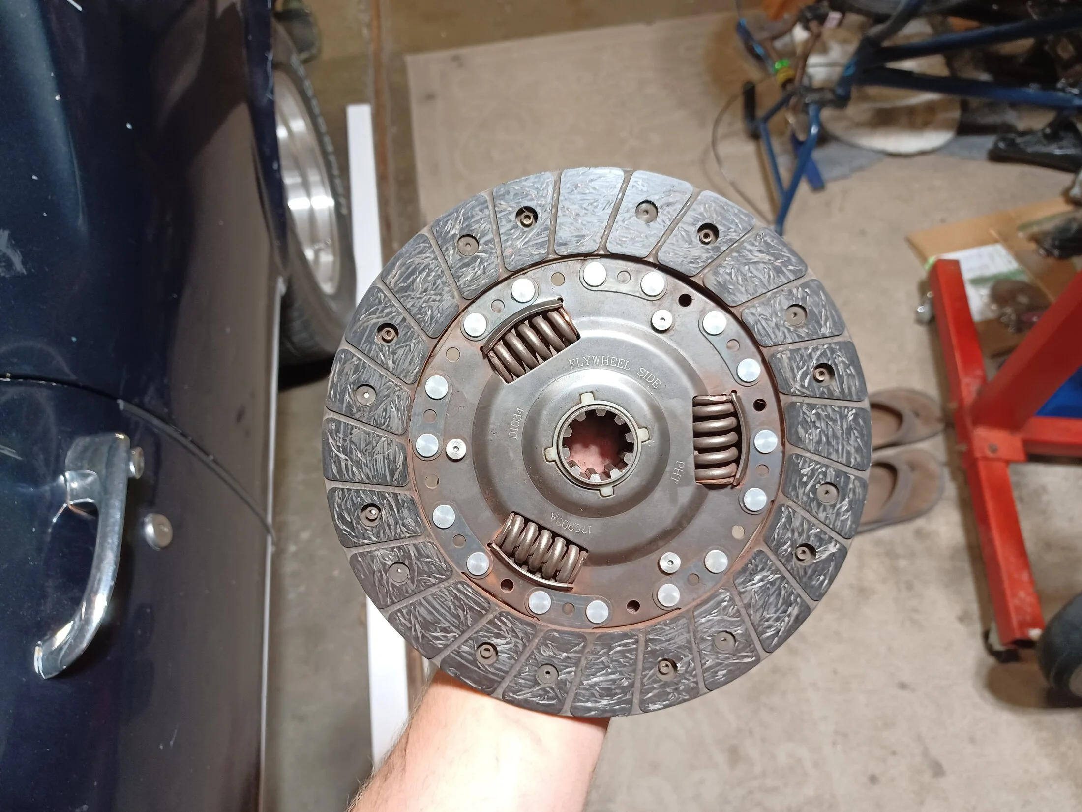

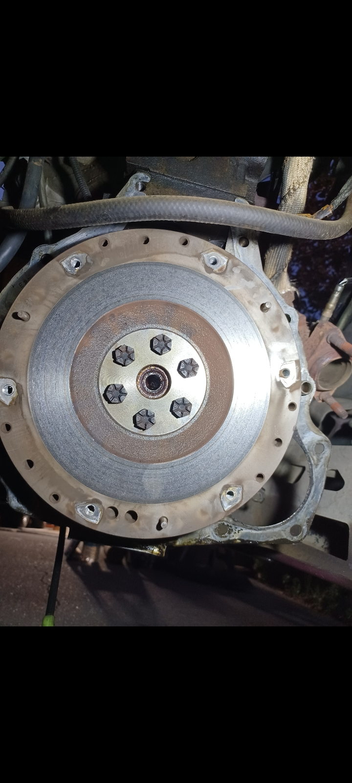

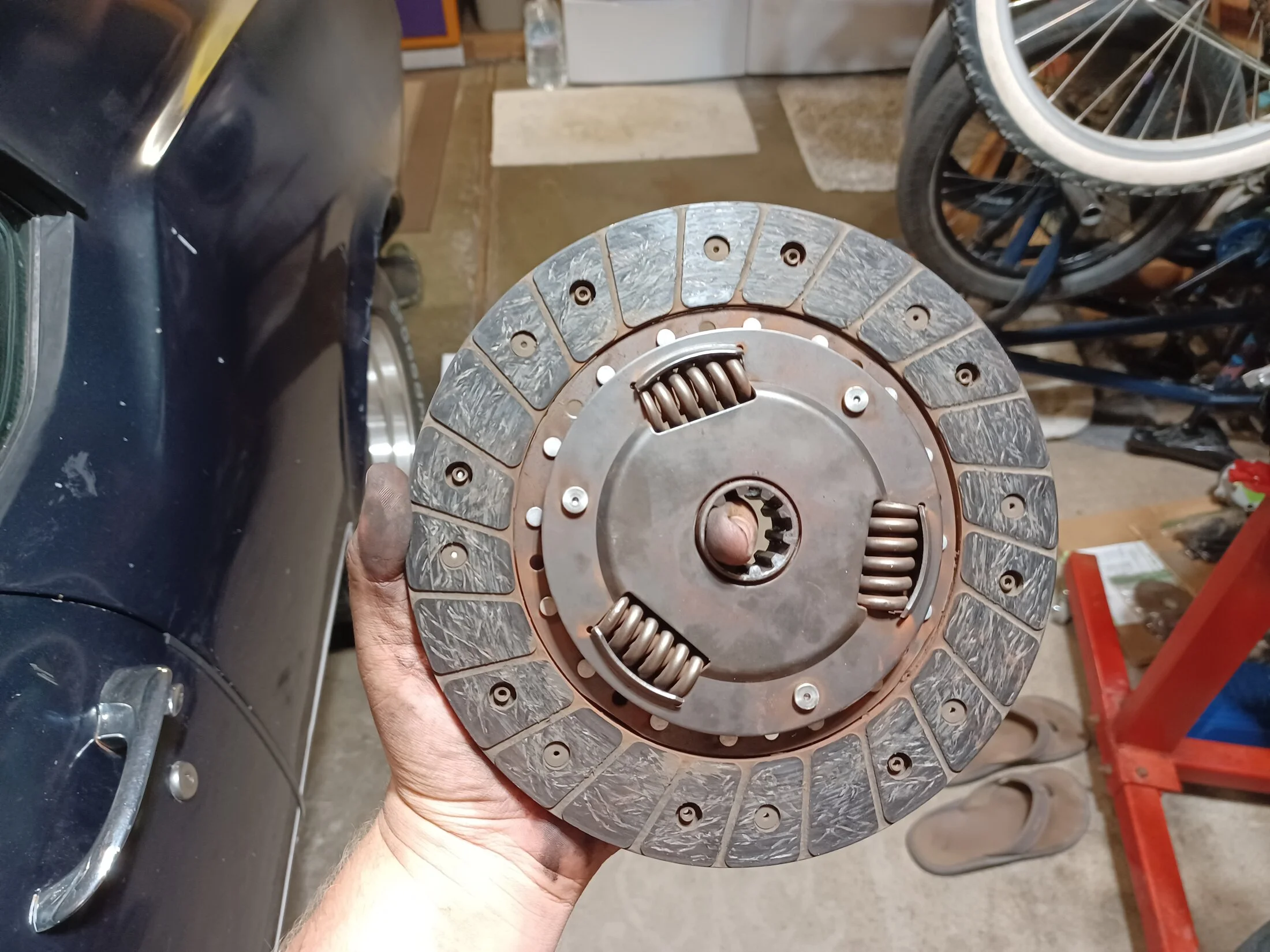

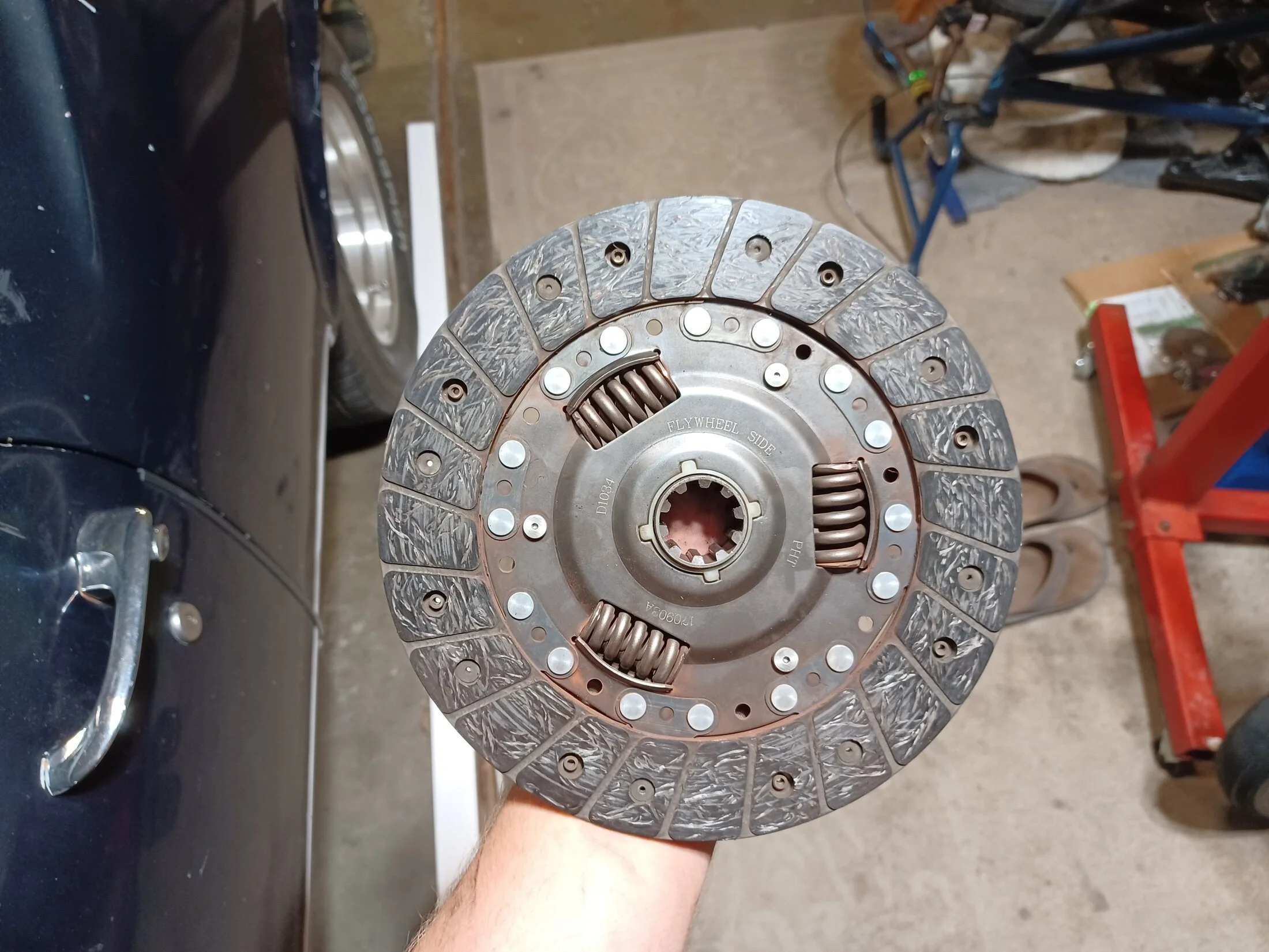

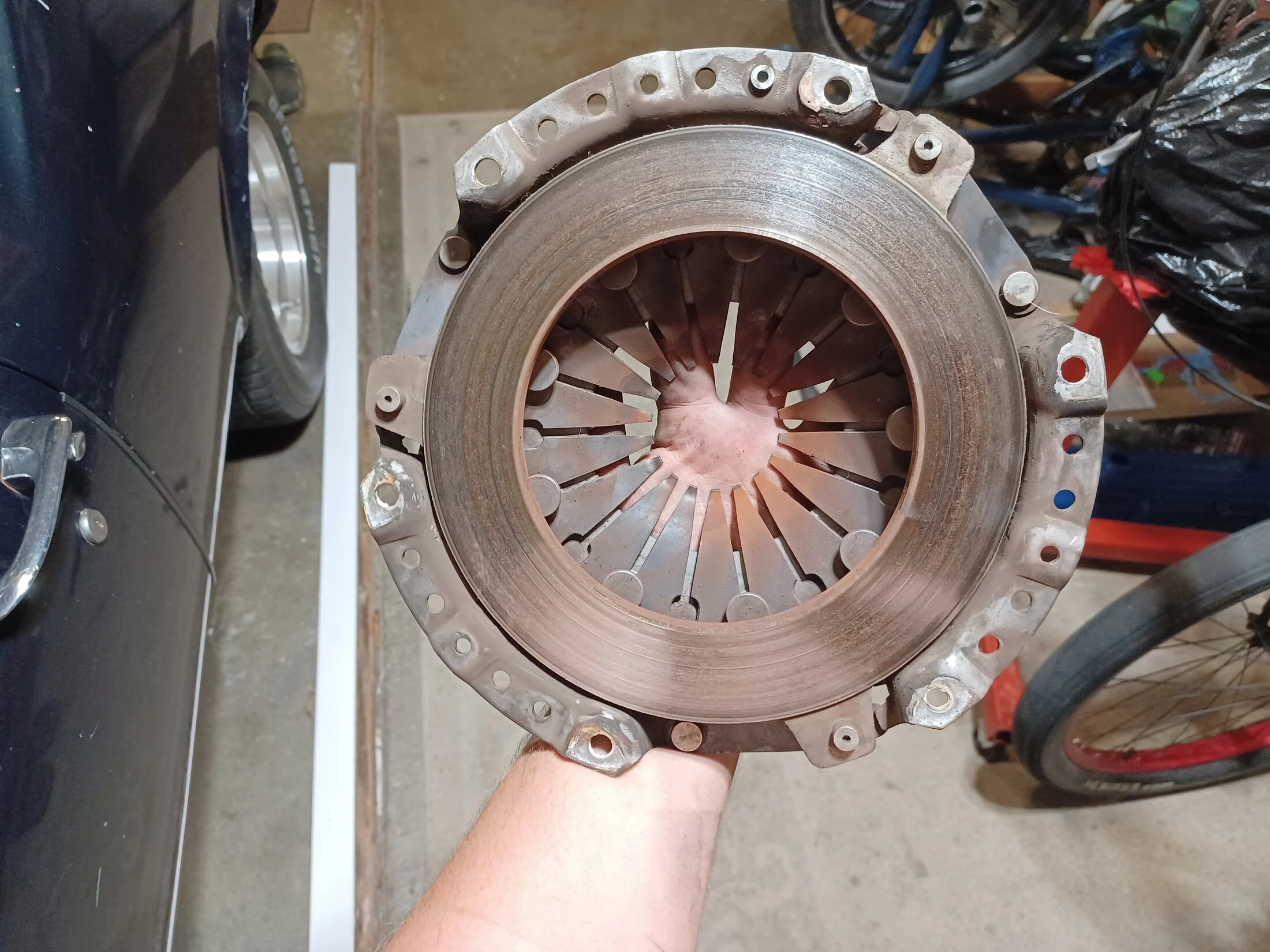

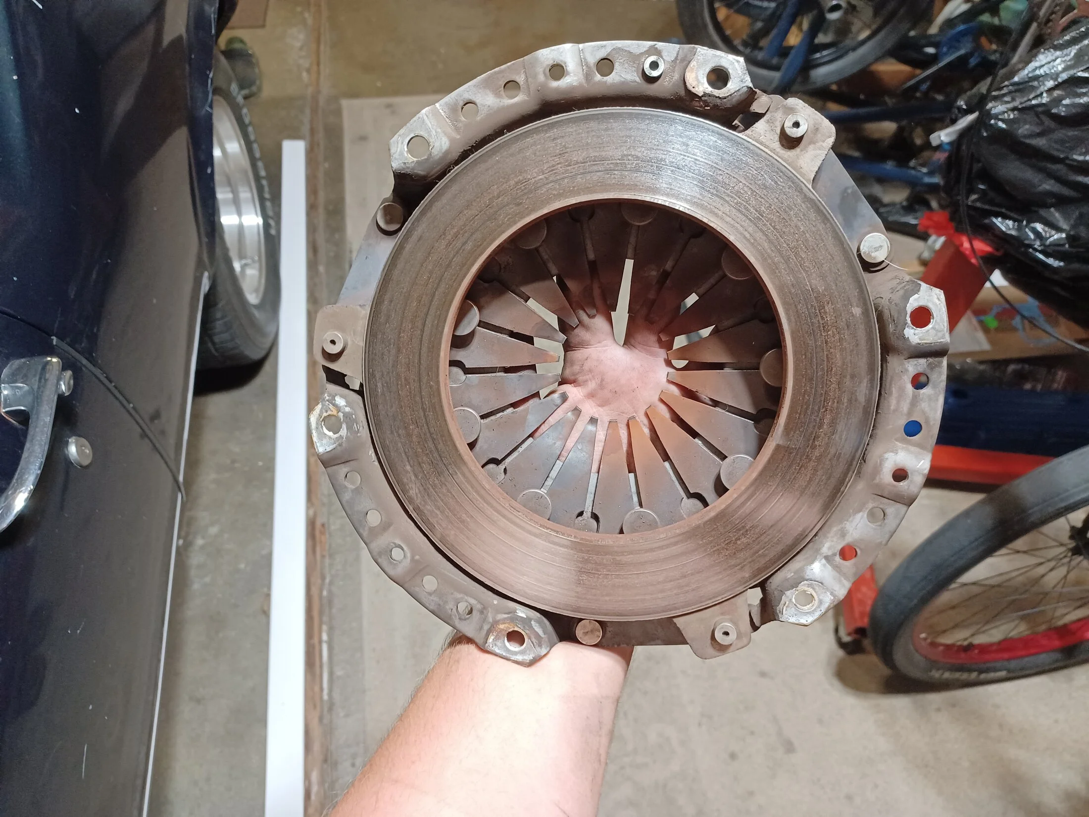

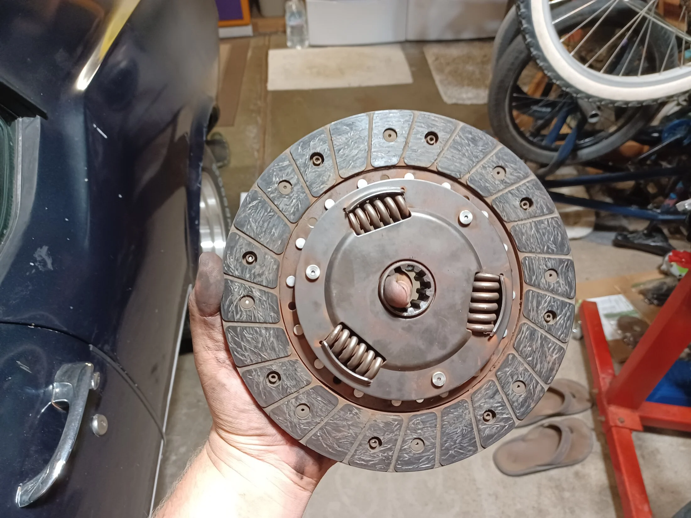

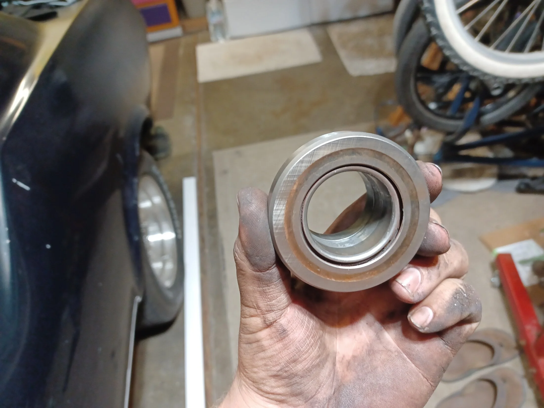

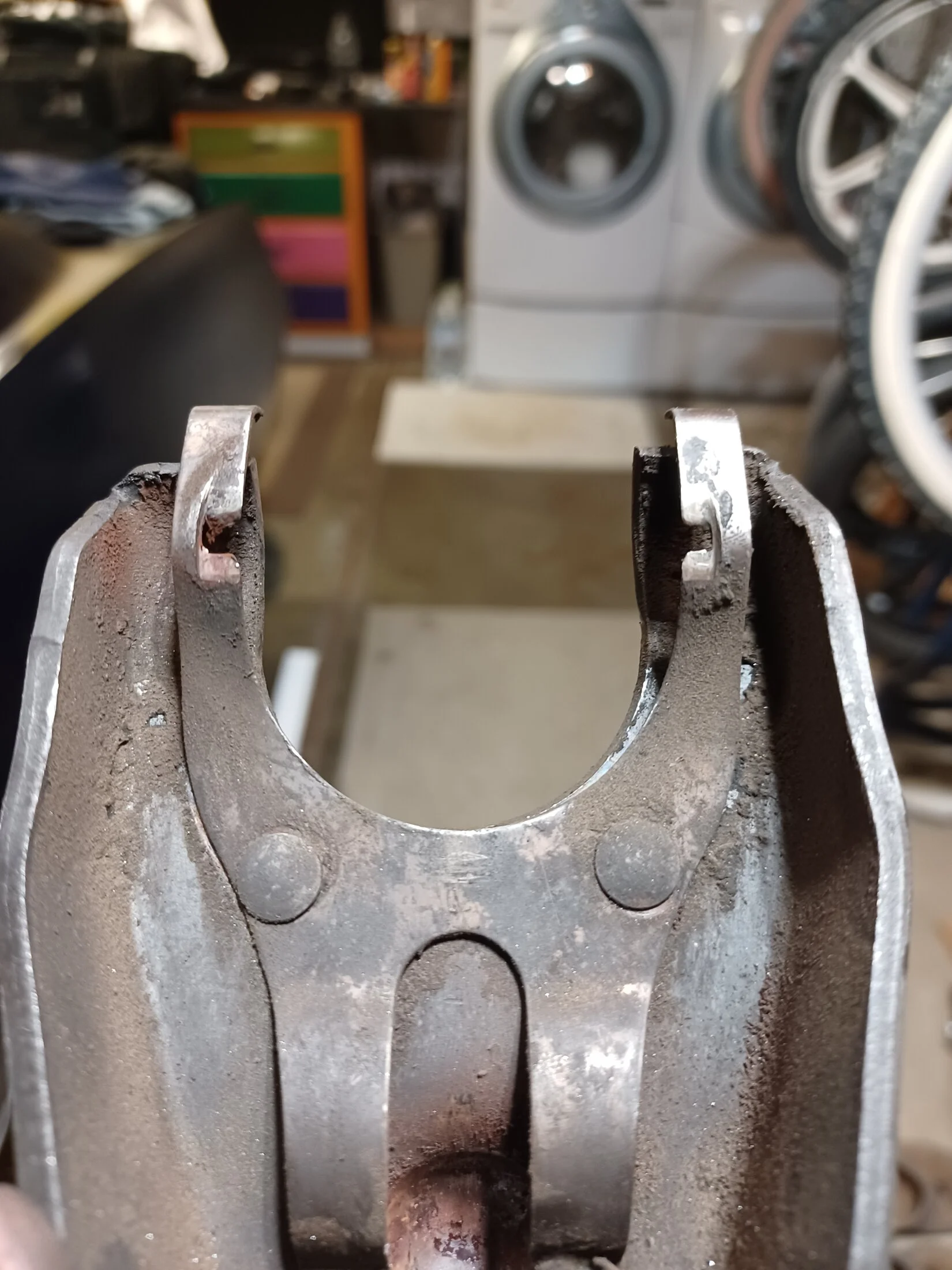

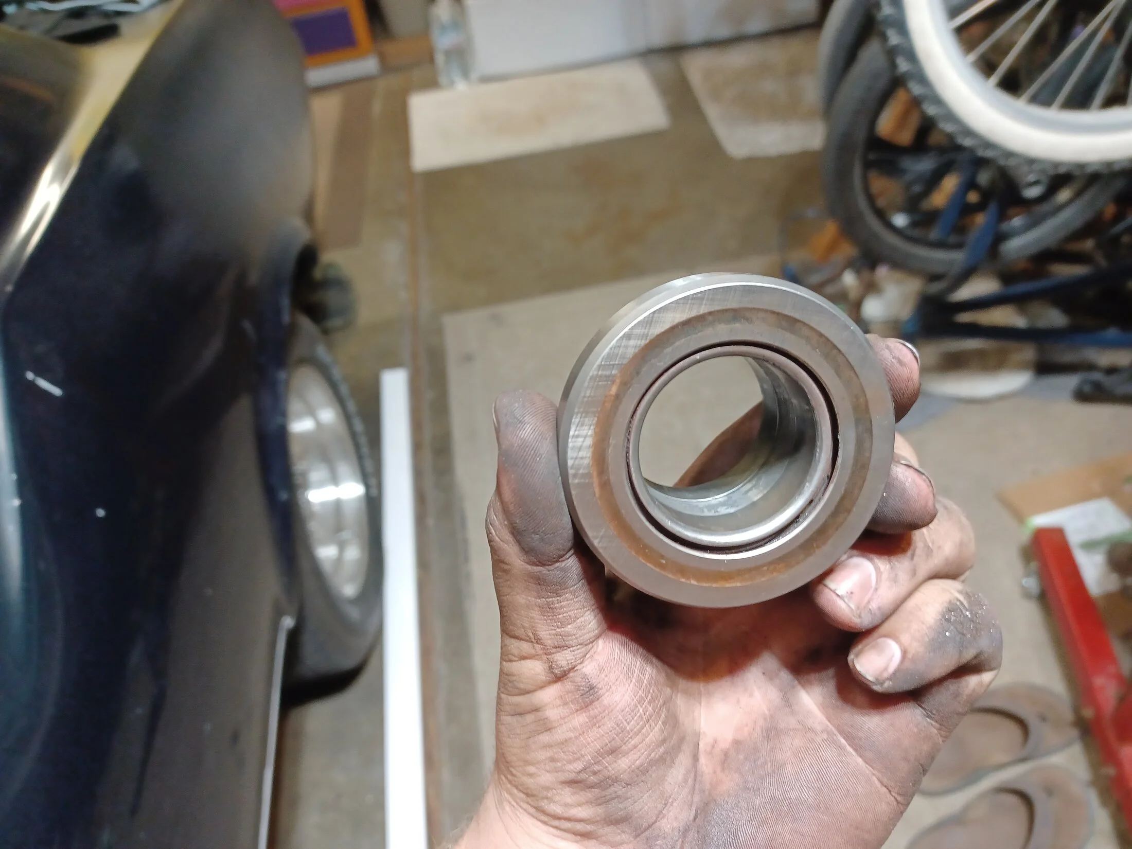

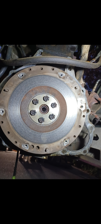

I also am in the middle of fixing the NA 2.3 still in the car. It developed a sound that reminded me of a crushed aluminum can bouncing around my bellhousing, and on my way home from work, it started making a low hissing sound and i had now power, as if it was slipping, today i pulled the tranny and found that my clutch has been glazed and has a couple rings on the pressure plate side the throughout bearing is dry, and grinds occasionally, and the pilot bearing has a lot of play, the flywheel seems fine. Im going to take the clutch to autozone and see if i can get it warrentied, and through it all back together with new bearings and stuff.
Heres pictures of the parts! Theres also a ring in the throughout bearing were the pressure plate meets, i feel like the fly wheel is still usable. There are also gouges in the springs on the clutch, more than a 64th of an inch

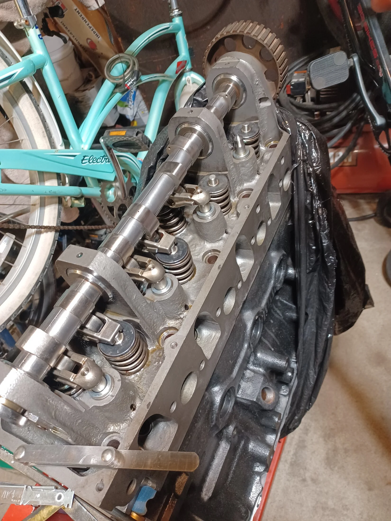

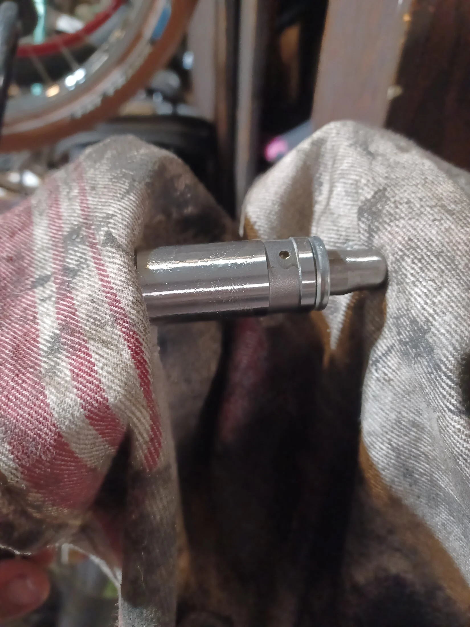

Shimming da Big R ranger X cam! Any advice on how to shim this thing? I vice bled all the lifters, and my tolerances are from 0.030-0.050, i find myself having to push the lifter down a lil bit to fit my guages in between thr lobe and rocker, but i am not able to push it all the way down, and im getting measurements of .058 or .056 or less, so im using my size 1 and 2 shims that are includes, there about 0.015" thick to 0.020 ish for size two. Am i doing this wrong? Or is it sounding good?
I'd contact Chip and do what he says.....
