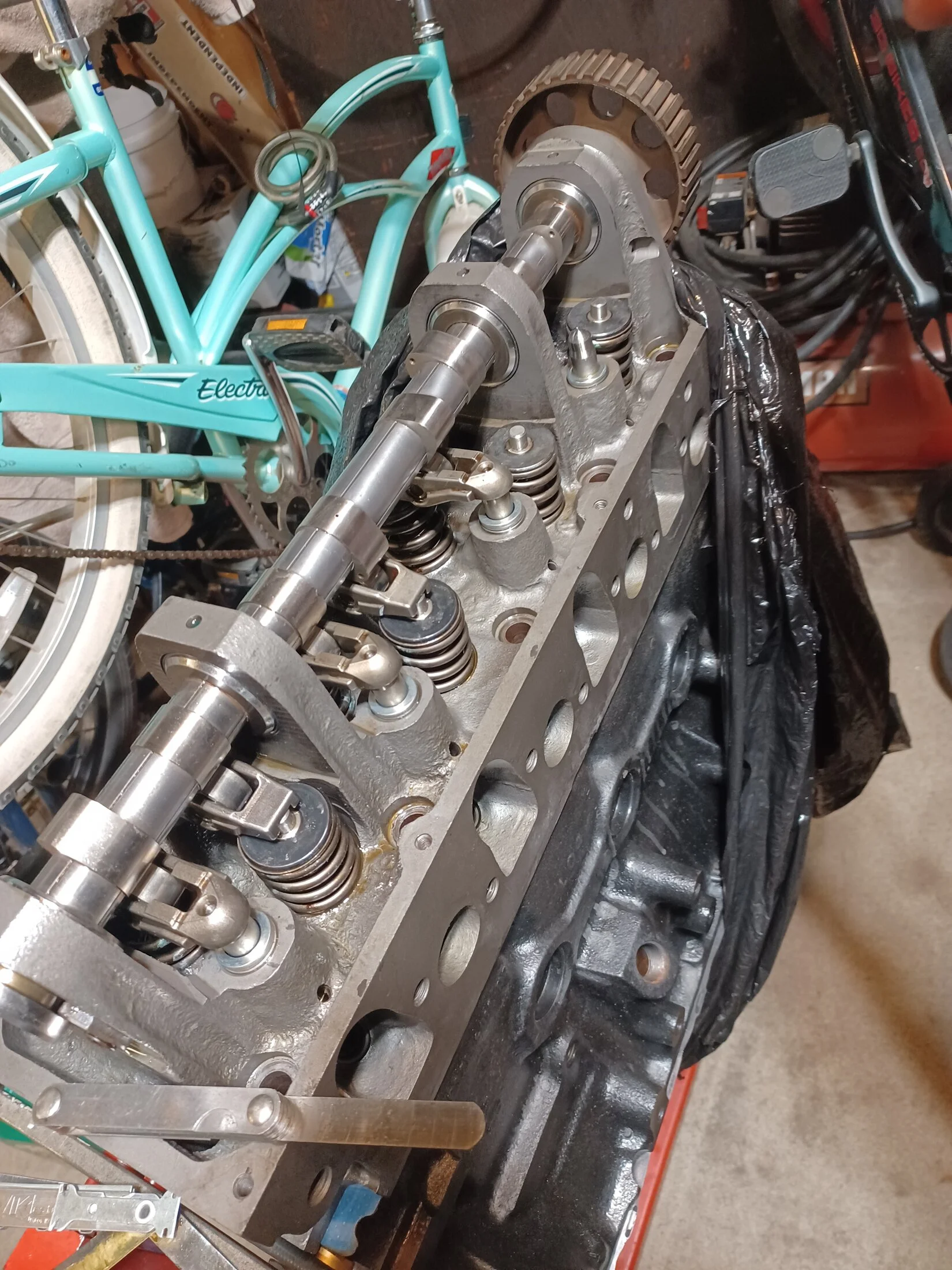

1. Guys, I got an update for ya! I shimmed my head, and finished all the cam work. so, the head is DONE I just gotta put a cam seal in and bolt it on the block. I haven't gotten to my rings yet, still need to verify the gap and make sure I did it right I'm getting a weird tight spot at top and bottom dead center, and I find it fishy that I didn't have to file any rings. so figure since I gotta replace my head bolts and gasket since I took the head off might as well verify.

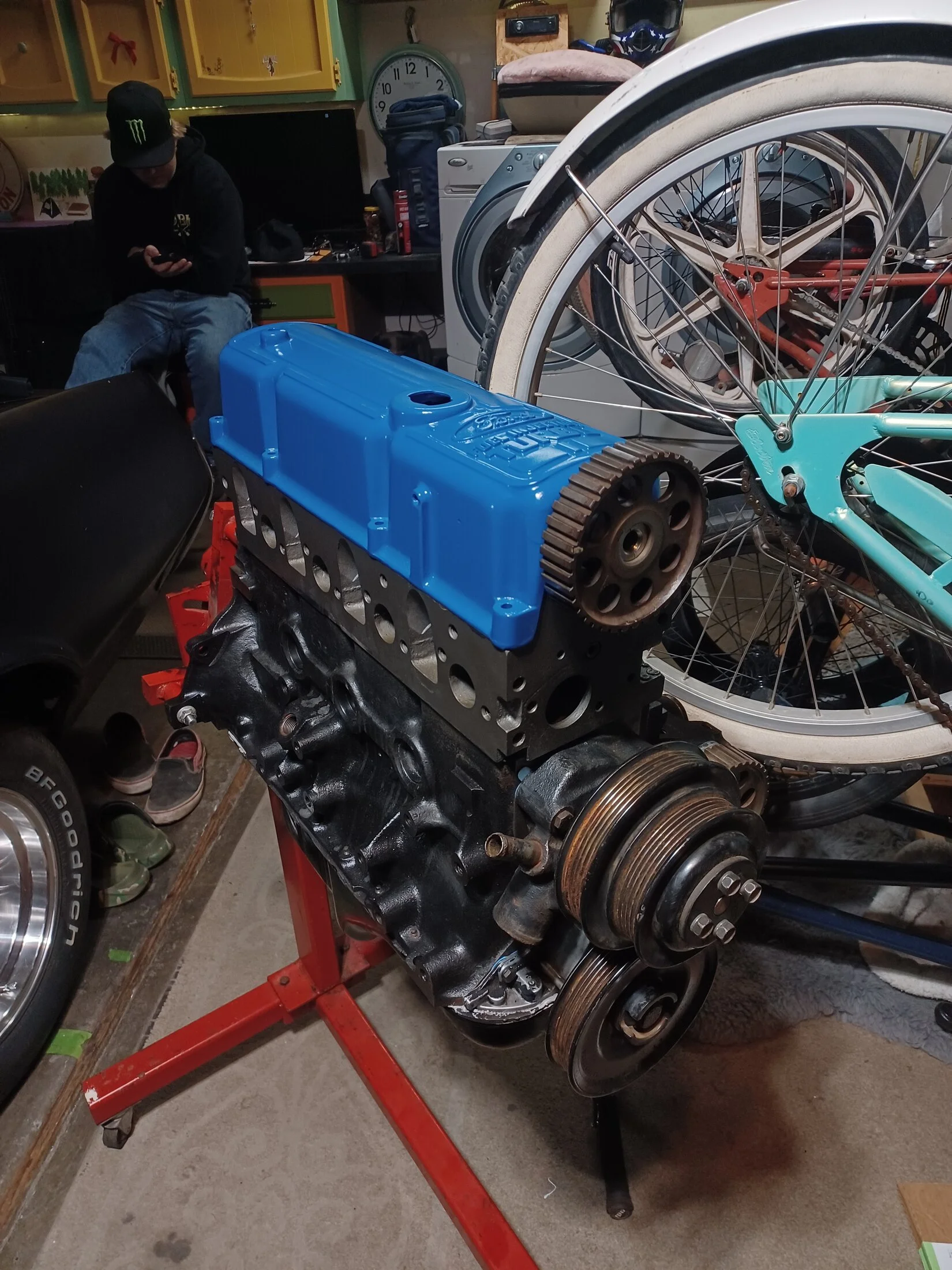

2. also, what do you guys think of the color? its supposed to be the darker ford blue, I'm going to sand the raised lettering and give it a clear coat and I was thinking leave the block and head black so I dont over do the blue. Annnd I polished/ cleaned the stock manifold as best as I could, its pretty much silver again, I got some more work to do though.

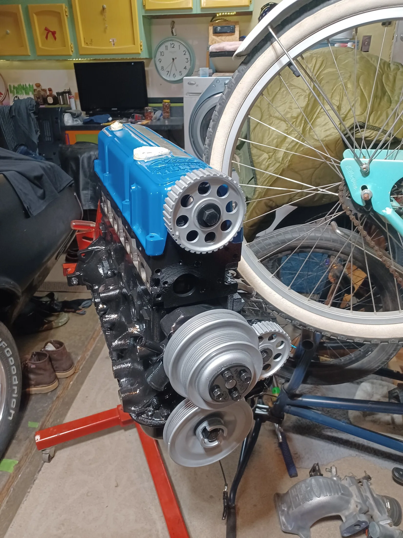

Yea, that blue doesn't look very dark.... may just be the pic tho. Does it look darker in person? Even so, I like it. And really I like your plan for the raised vc lettering. The block looks fine black. I think all that.... the black, blue and silver.... will make for a sharp looking, contrasting color combo. :nice:
Now, what about those pulleys? Any plan to freshen up their paint? They don't fit in with the rest of the pretty.
You put rings in there? You didn't bore it out, did you? If not, with 300k the cylinders are guaranteed to be out of round and the new rings probably won't seal. I'd check with Chip and see what his thoughts are on that.

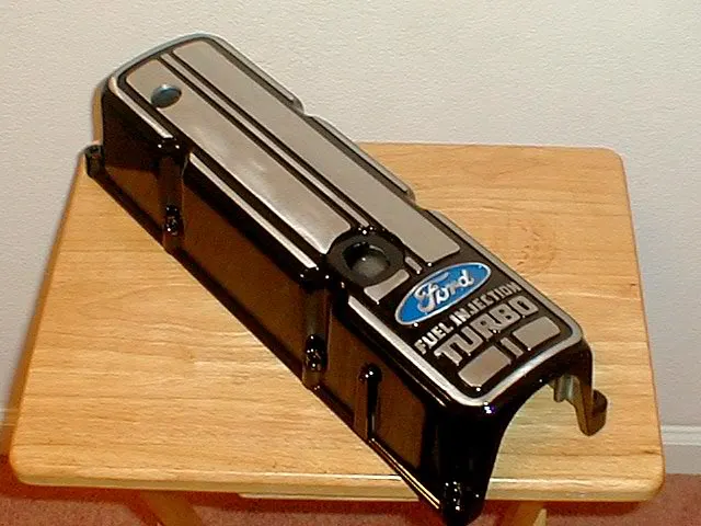

As far as color combo, I'm not a fan of black blocks cuz it's harder to see any leaks that might pop up. But, to each his own. Paint the manifold with AlumaBlast. It's available at AutoZone. Here's a pic of my valve cover. It's powdercoated but gives you an idea of what yours will look like with the letters sanded off and clearcoated.........
yes! im gonna clean the water pump pulley up, give it a new coat of black, and the cam gear i was thinking of painting silver so it matches the intake and turbo. and as far as color, its slightly more dark in person, but definitely darker than the light ford blue
well, I had the cylinders honed, not bored and i just bought stock replacement rings because that's what was recommended by the machine shop
also, i love what you did with the ford emblem, the blue makes it pop, and as far as the block goes, I wanted to do a dark ford blue, but i couldn't find the right color and ended up with this lighter blue, and figured it would end up lookin a little weak, so to save time im leaving it black with blue accents.

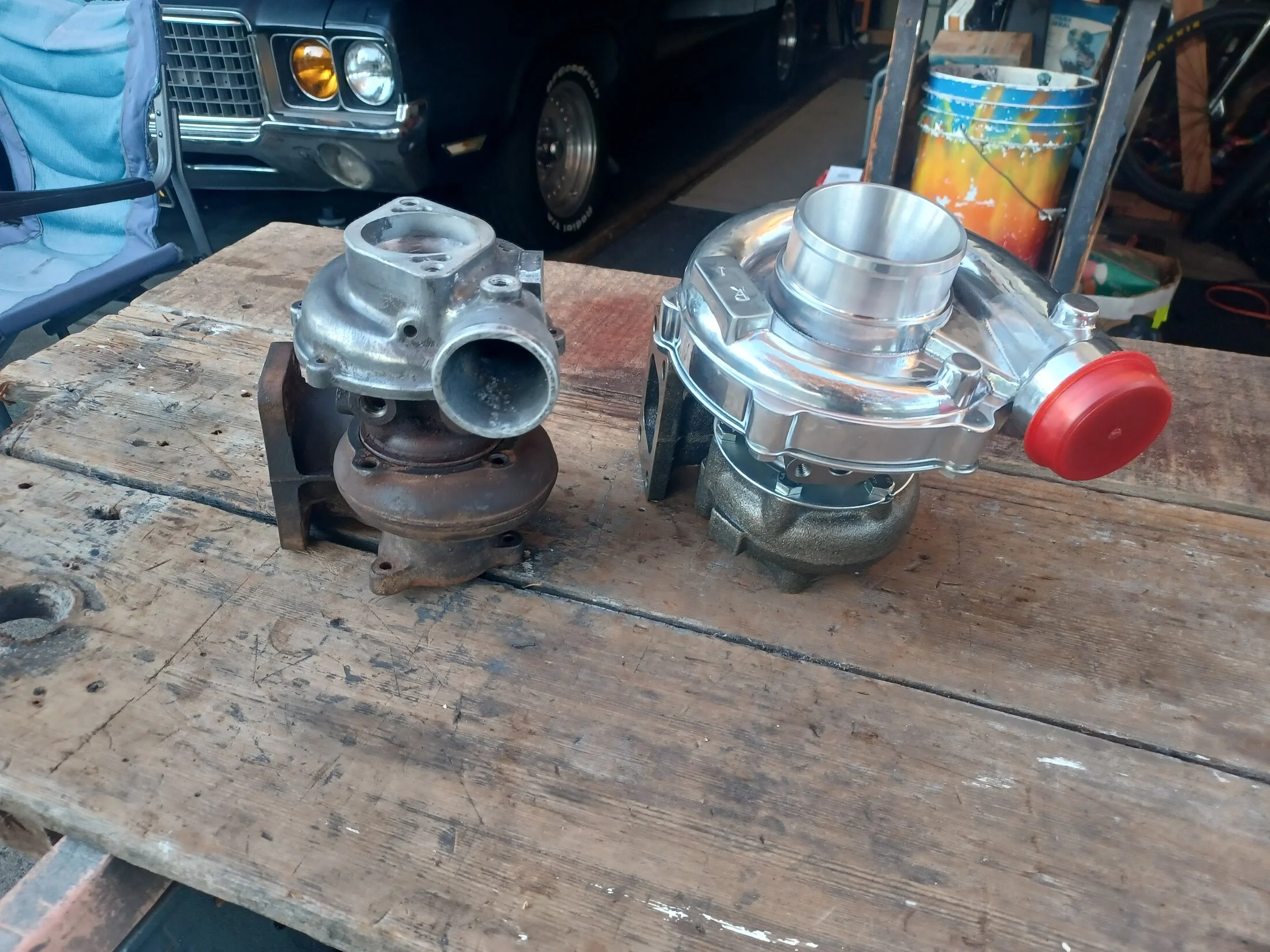

TURBO CAME IN THE MAIL!!!!!!! now i got both turbo, and exhaust manifold! Im absolutely pumped!!!! This weekend im gonna put it all together! I just gotta wait for my new head gasket and head bolts to come im the mail!

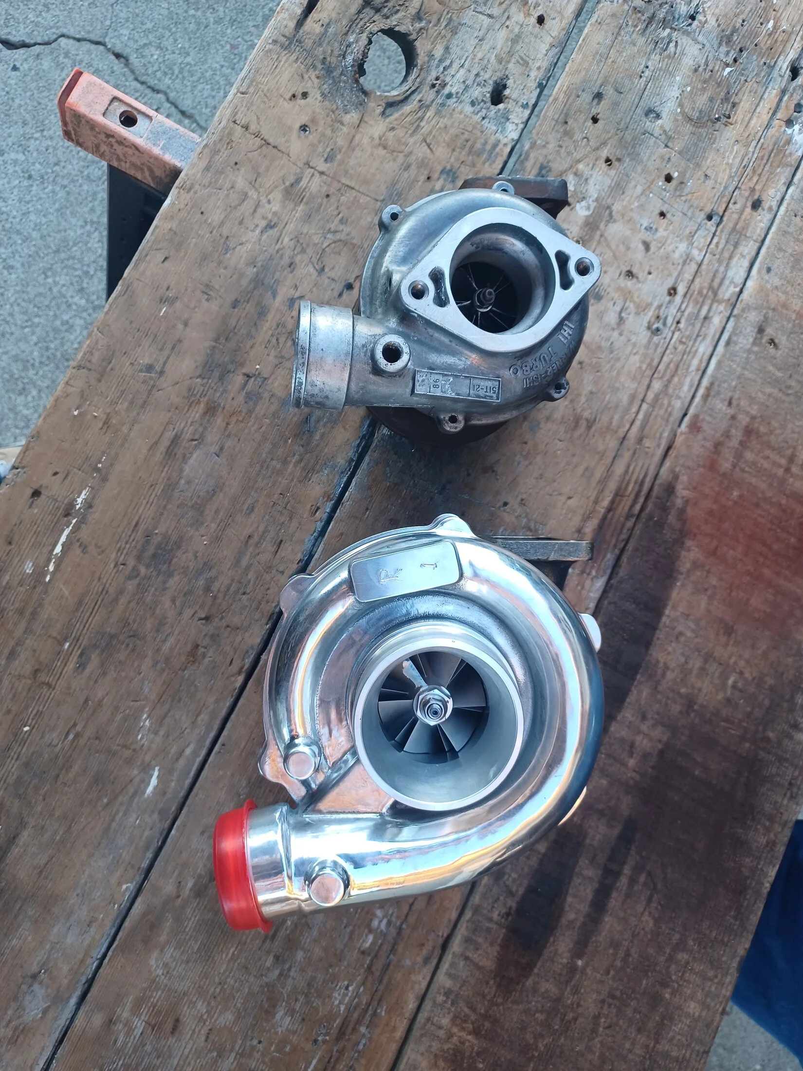

Heres a lil comparison of the turbos! I got the old IHI turbo and the shiny guy is the big R stage 1 turbo! I didnt go with stage 2 or 3 because he states it takes longer to spool and spools at higher rpm, i dont drive that way so i went with the stage one since its a bit more for evreything and makes boost throughout more of the "rev range" it also should compliment my cam a bit better!

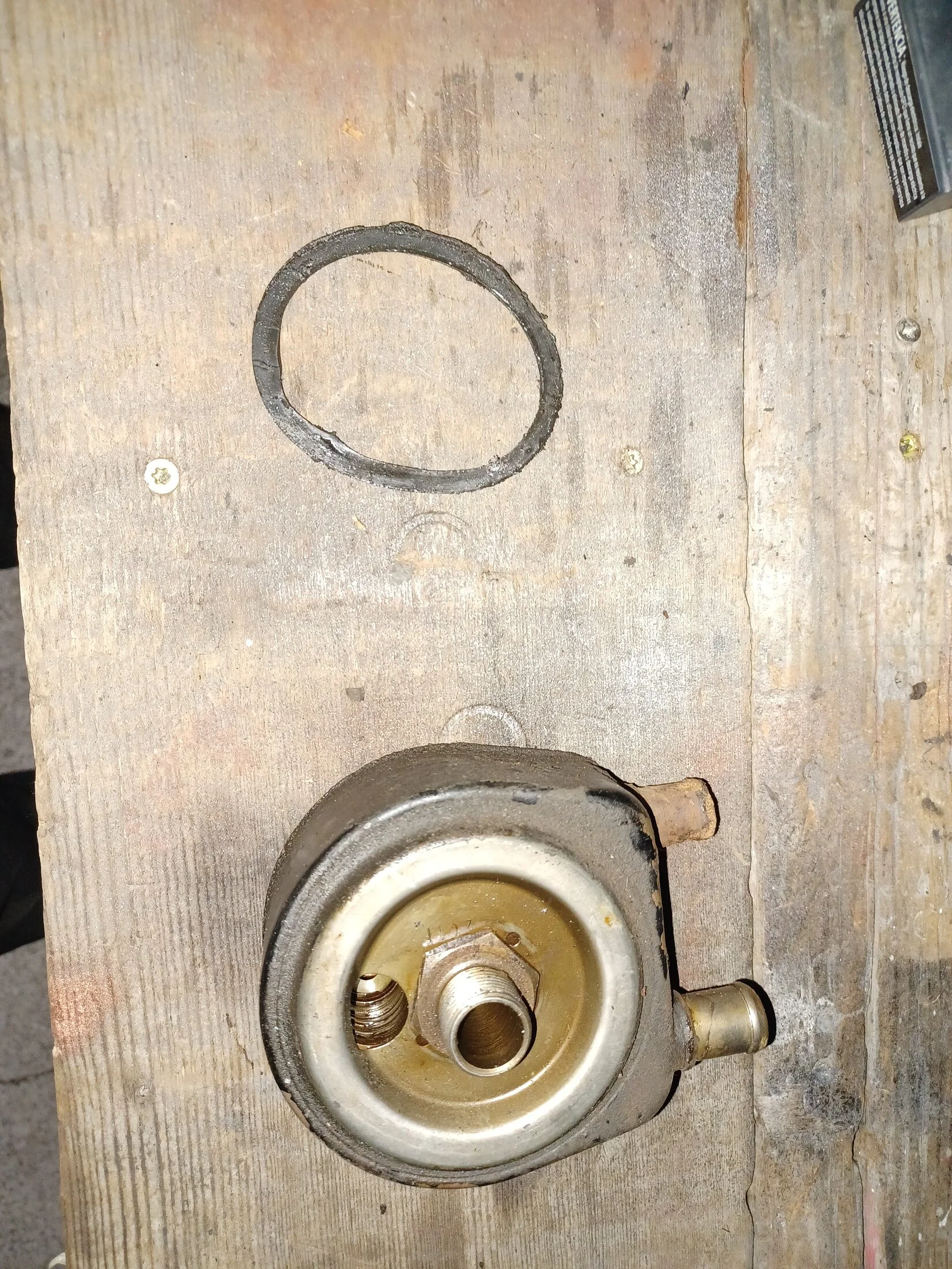

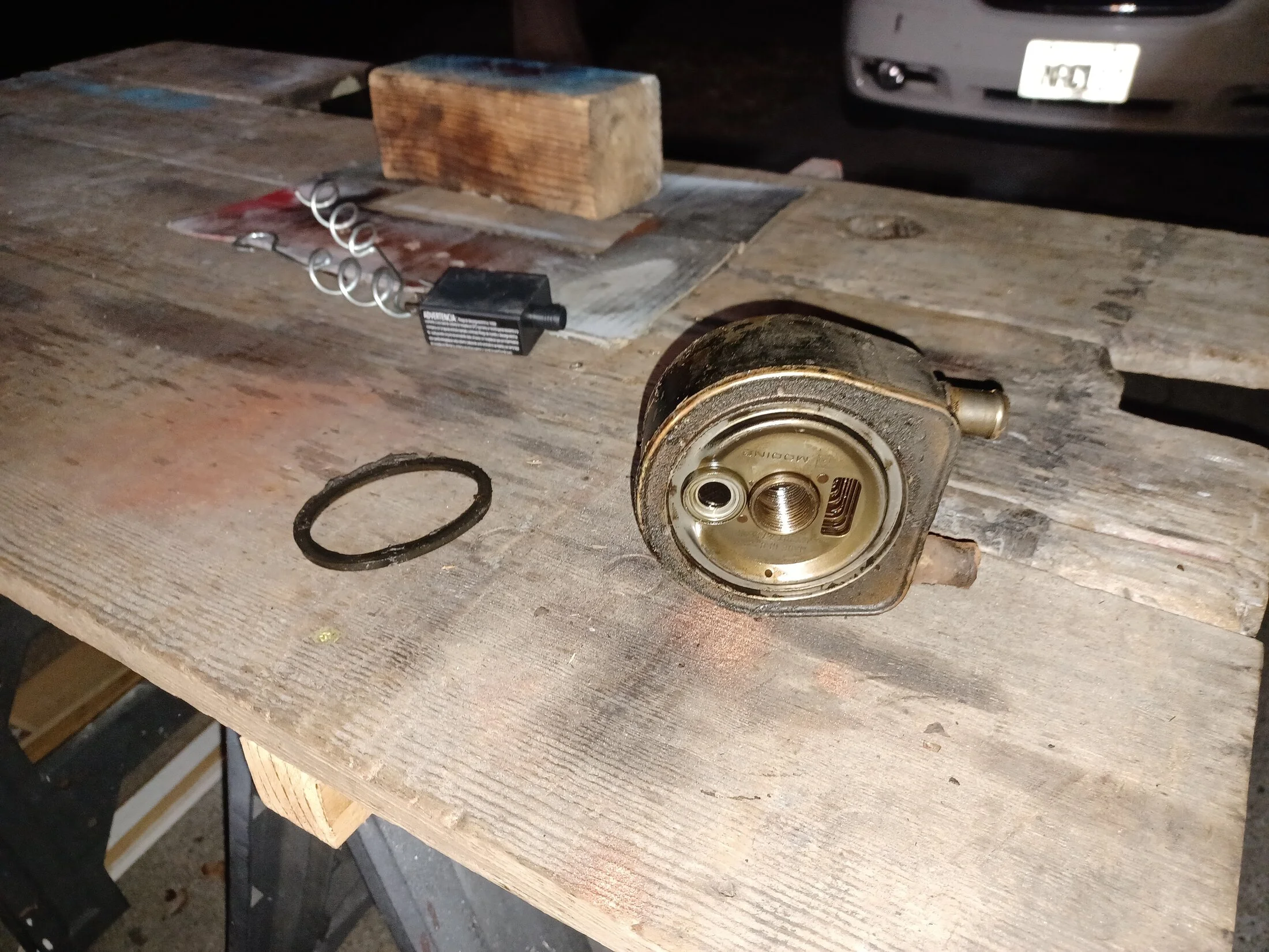

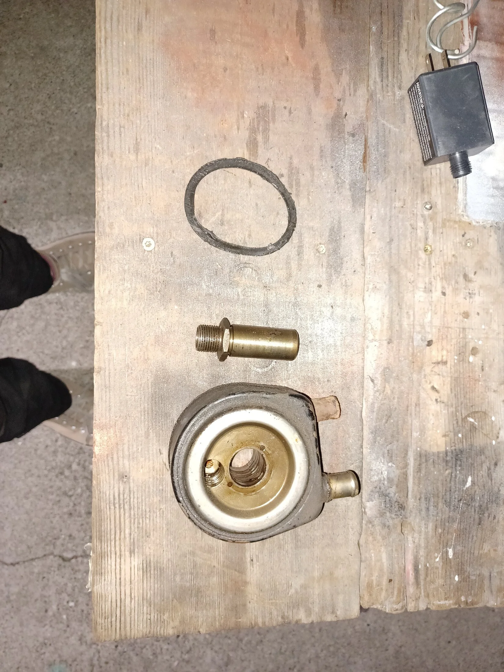

Hey guys I'm at the point where I'm installing the stuff that goes under the intake manifold I have all the original turbo 2.3 Parts but I don't know what they are for example this piece it goes on to where the oil filter would go and it looks as if it is a device that pumps coolant around the oil filter housing am I correct?
