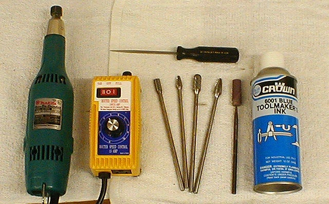

Port match is a good thing with these motors. You can also polish the combustion chambers with a sanding roll. Stay away from opening up the chambers though. The water jackets are right behind there. Ask me how I know! Found an old pic of the tools I used to port match my head.
Makita electric die grinder, HF variable speed reducer (to control speed on die grinder), 6" carbide bits off Ebay, sanding rolls/arbor and toolmakers ink.

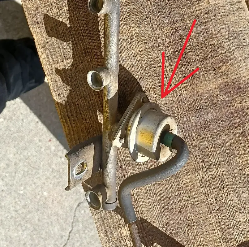

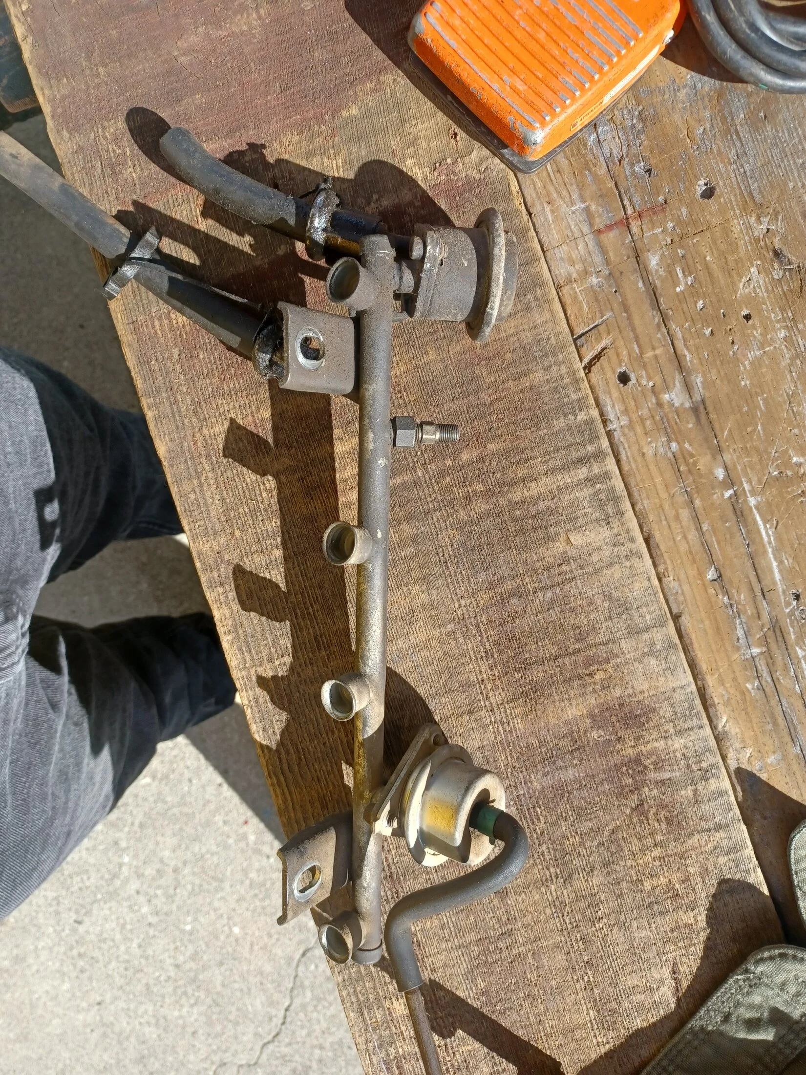

Heres a pic of my fuel rail by the way! Not sure wich is the pressure regulator, im assuming its the one that has the fuel in right? If not whats the other one?

The one on the back of the rail, next to the nipple, is the fuel dampner. Leave that alone. The one on the front of the rail, with the 3 bolt base and a hose coming out of the top, is your fuel pressure regulator.
