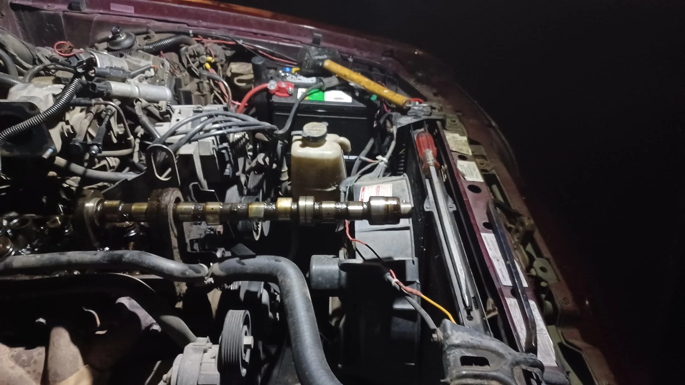

guys, i just fixed the nock in my n/a mustang!!! i did a roller cam swap, and nock no more!!!!!! im absolutly pumped up to finish up that turbo motor, i get out of school for winter break on the 7th, and i plan to get that thing DONE i want to take my tranny to a shop to have it re built, i have some funky stuff goin on and id like it to be looked at via expert eyes before putting more power behind it, as far as the motor goes, i need to assemble the stuff that lives under the intake manifold, oil cooler, catch can, distributor, and whatever else lives there, then its on to the turbo side, wich at this point should just be oil lines and exhaust.
Reactions: General karthief

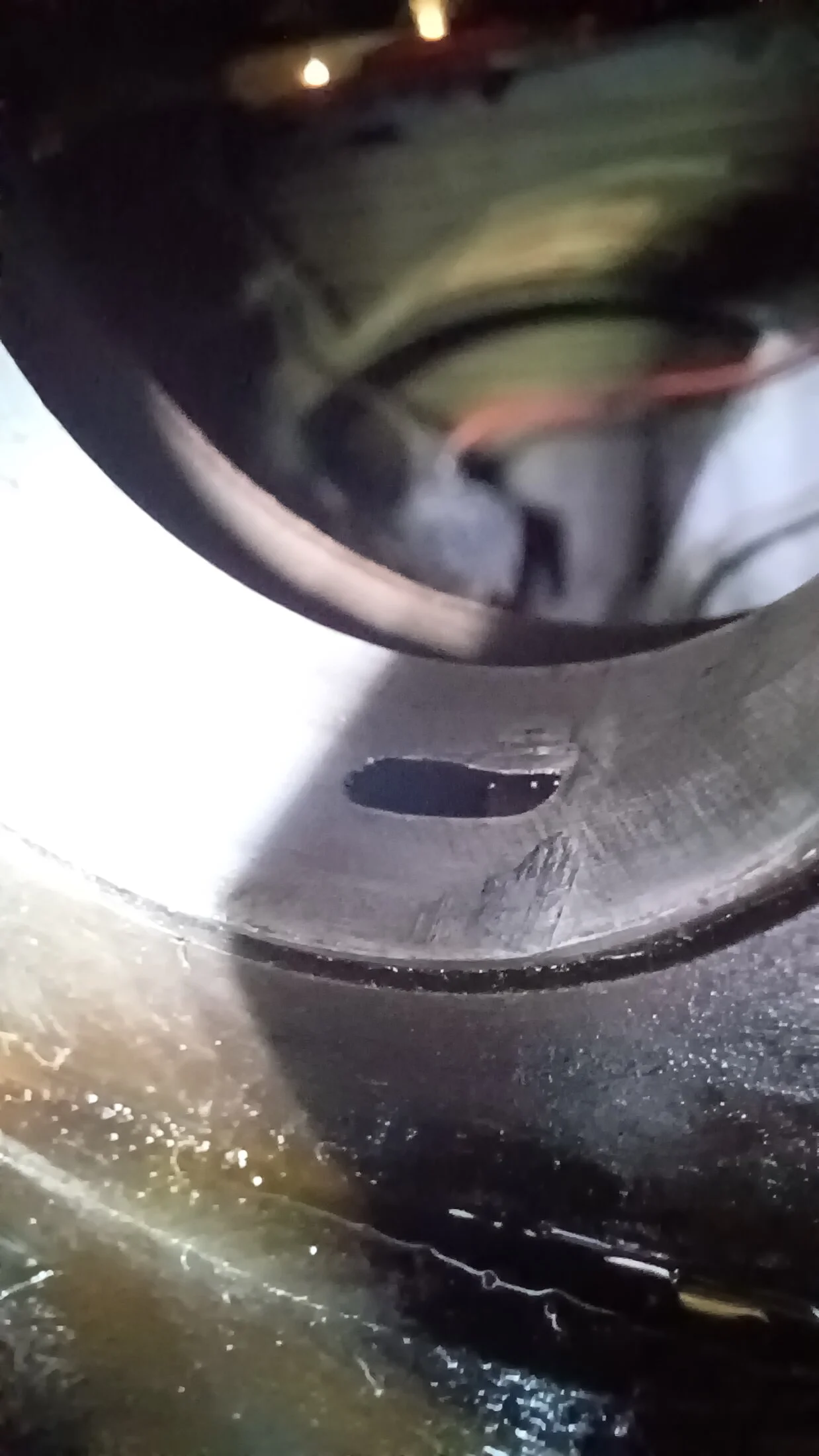

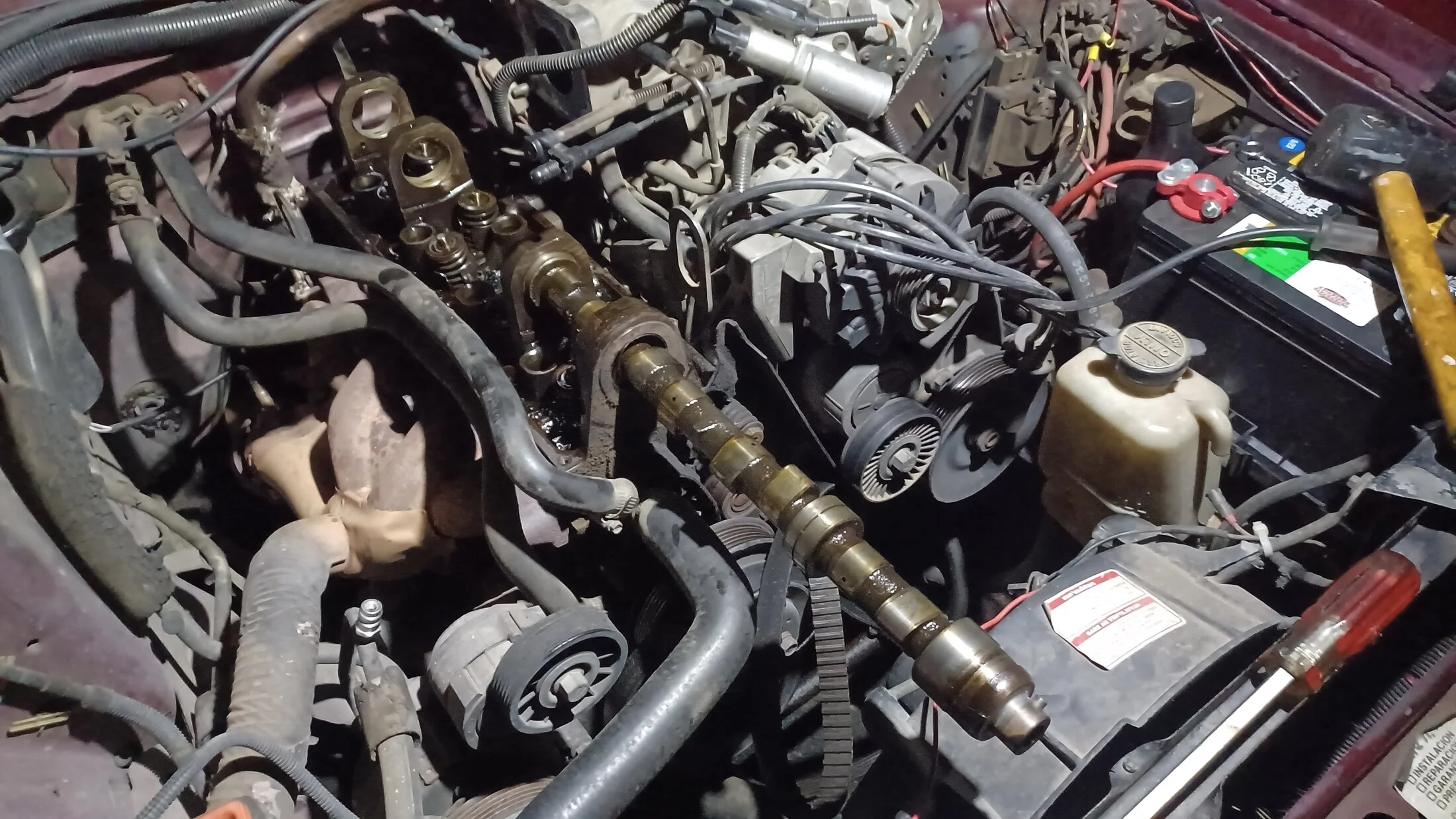

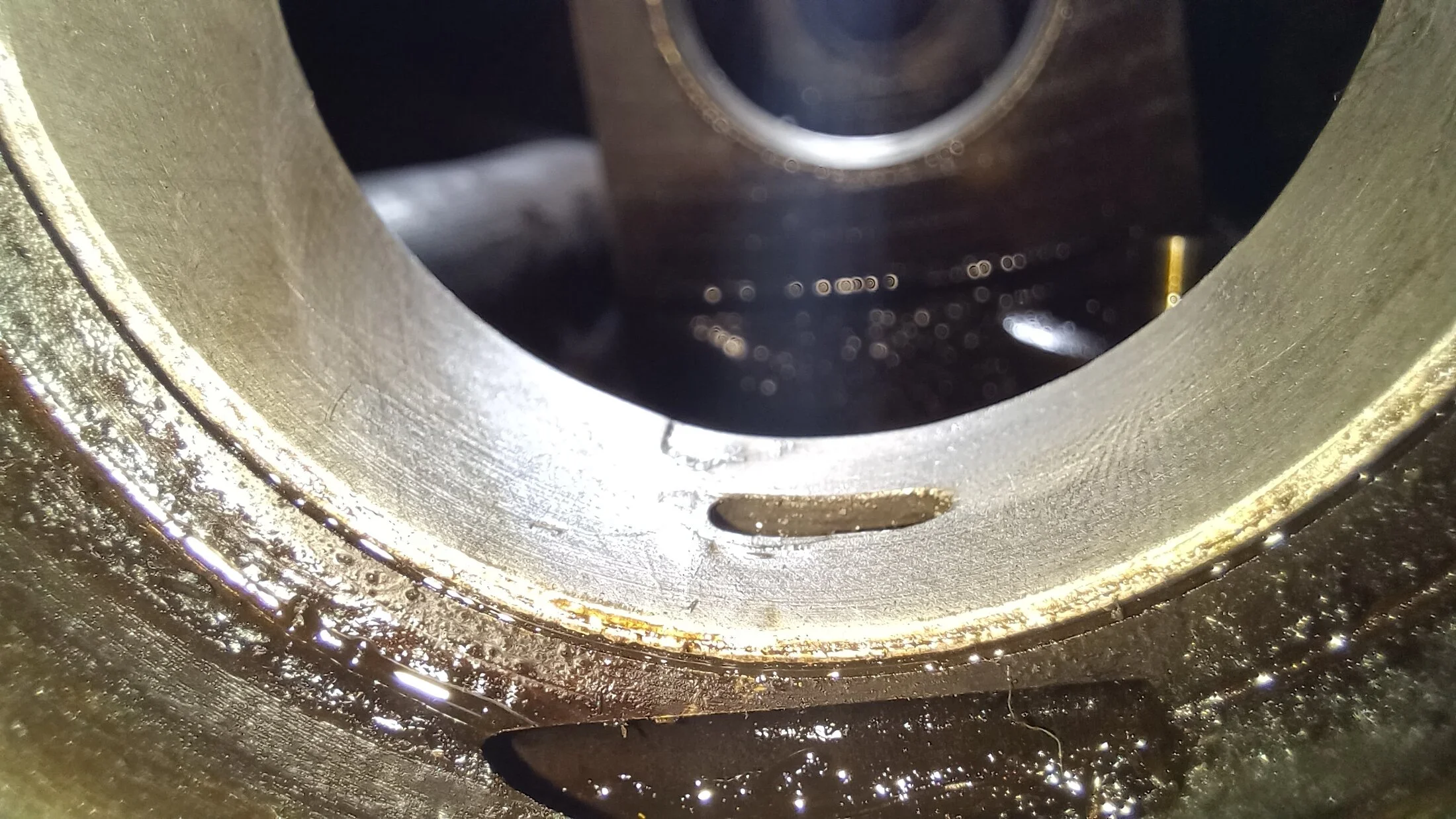

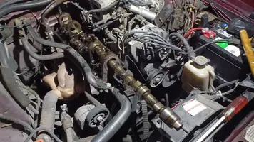

Also, some of you guys may hate me for this, i chipped my front cam bearing while removing the N/A cam, it looked pretty bad, i also couldnt take it to a machine shop so i scotch brited it smooth and then hit ONLY the edges of the chip with some 500 grit sand paper and smoothed it out some more so i couldnt cath my finger on it (trying to eliminate any stress risers or high spots), came out pretty good! Also, the ranger cam i got from big r had a nick in one of the bearing surfaces, and put a ring in the same bearing i put a nick in, so i did the same thing, sanded away any stress risers, and high spots, and installed the sucker! Figure the worst thing that could happen at this point would be a failing cam bearing, and if not higher oil consumption and it only needs to last a month or 3
Photos are of the old cam being removed, and the chip before i clean it up
Also! For those wondering how i got the cam out without pulling the motor like the hanes repair manuel says, i just took out one tranny crossmember bolt and it tilted the engine back enough to give me about 2 inches of clearance to get it out (gotta take off the cam gear first or it will still hit)

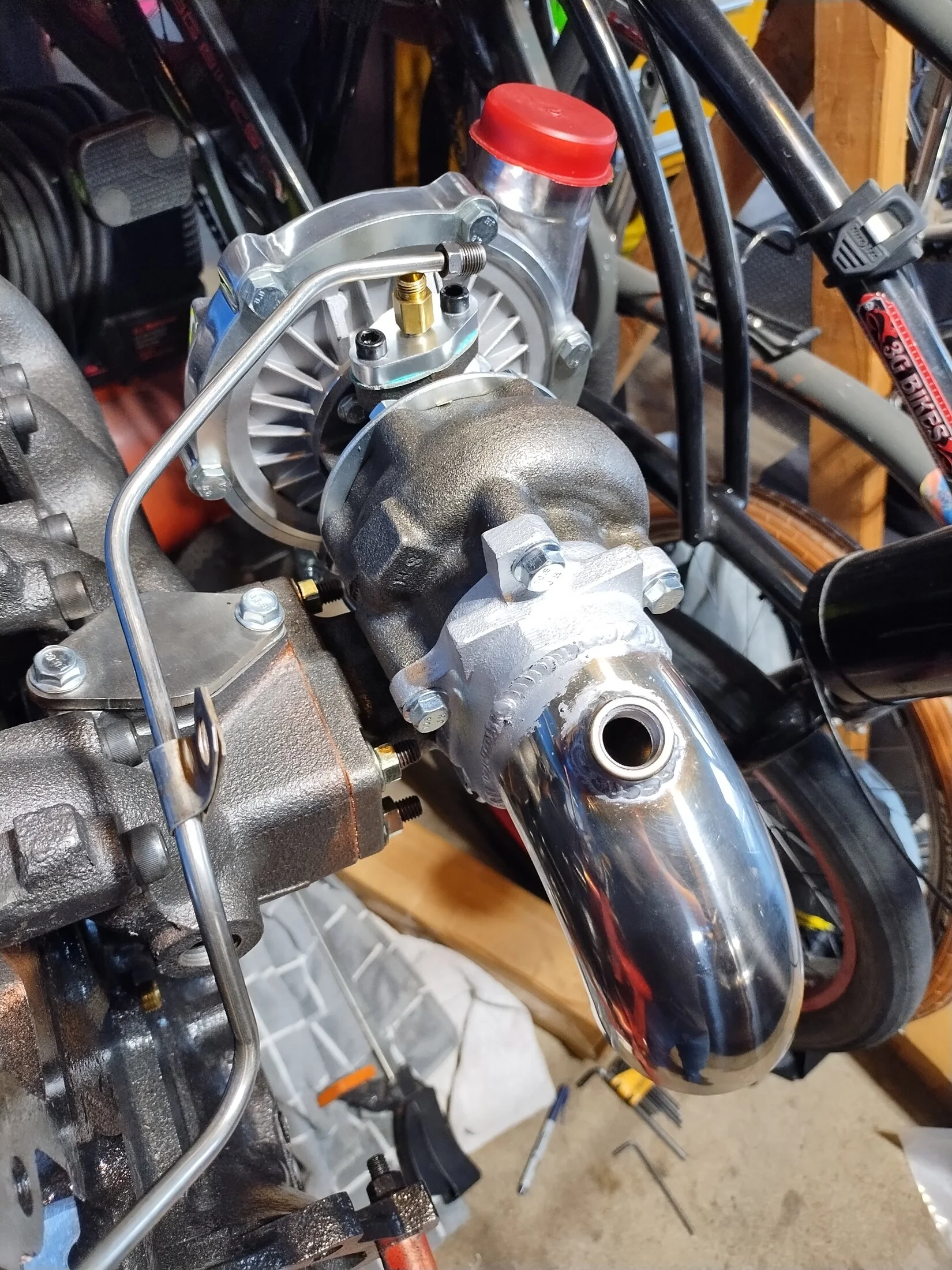

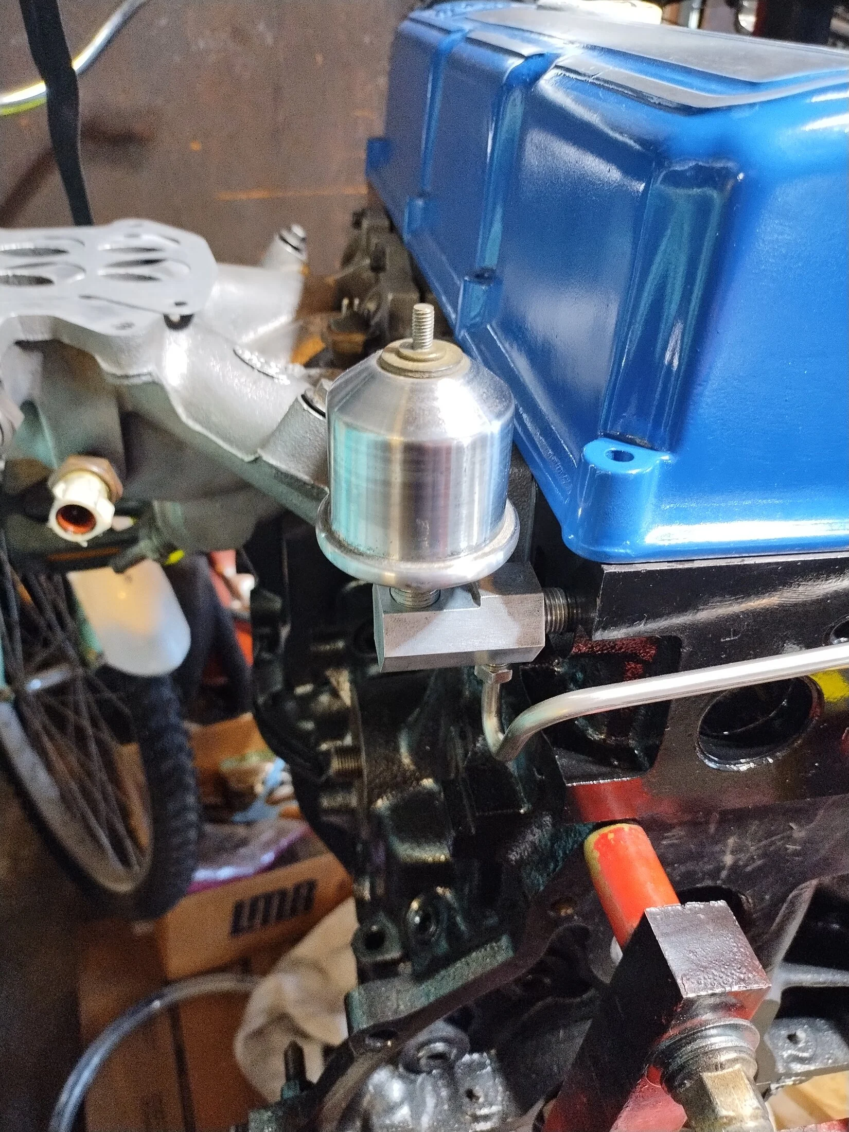

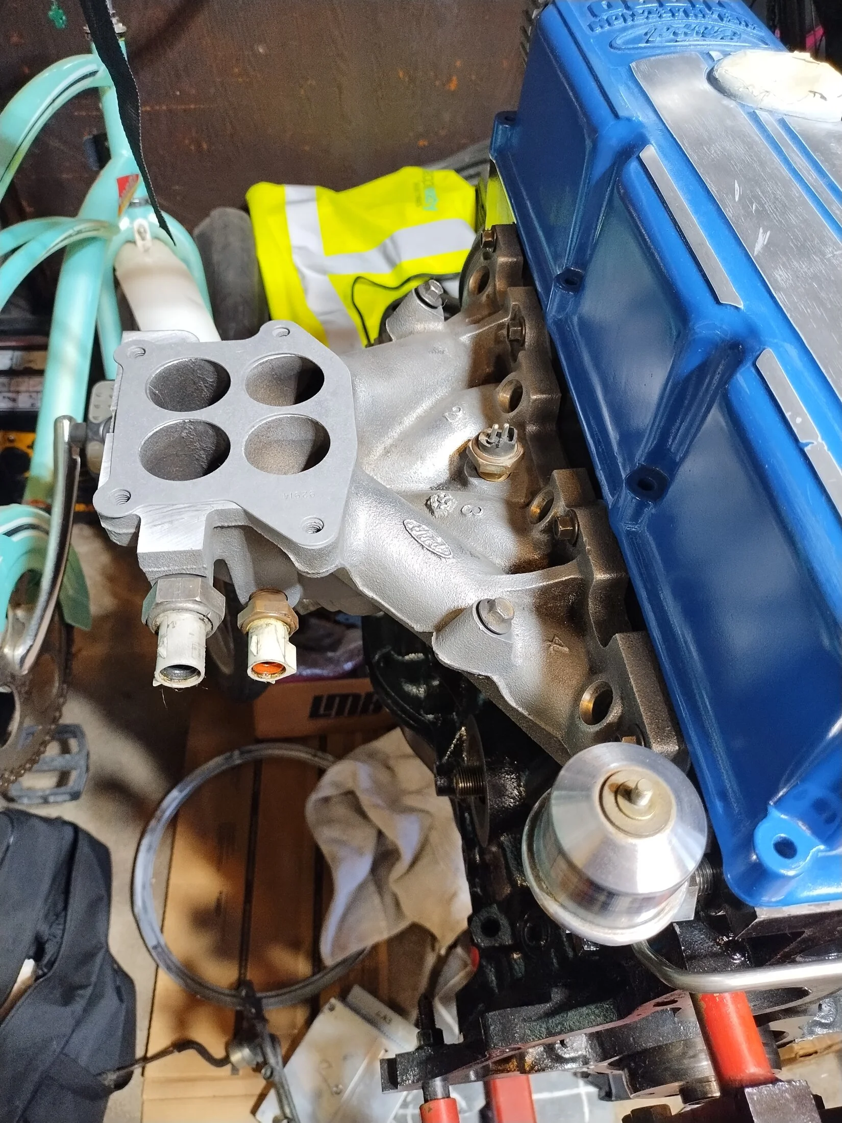

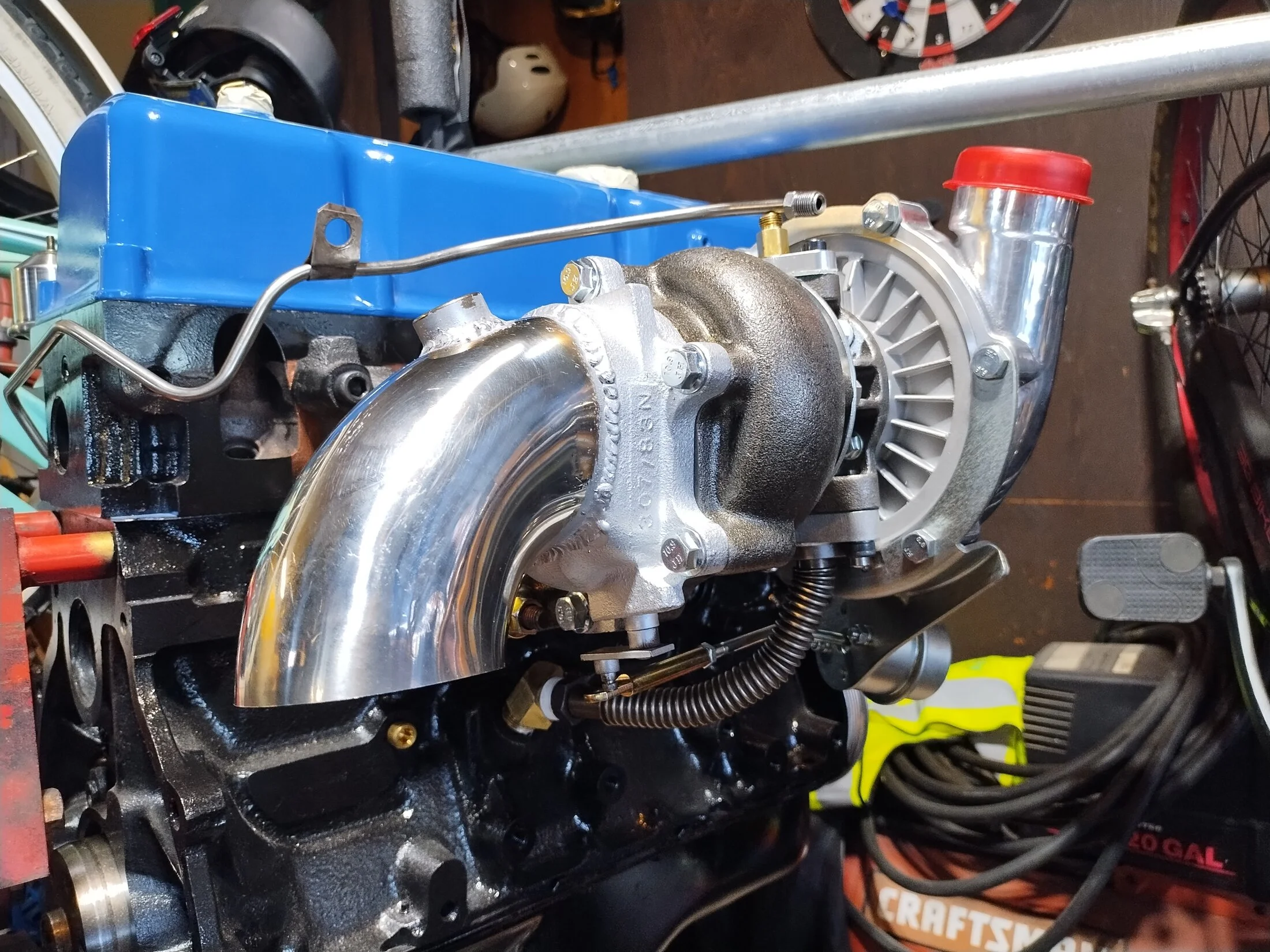

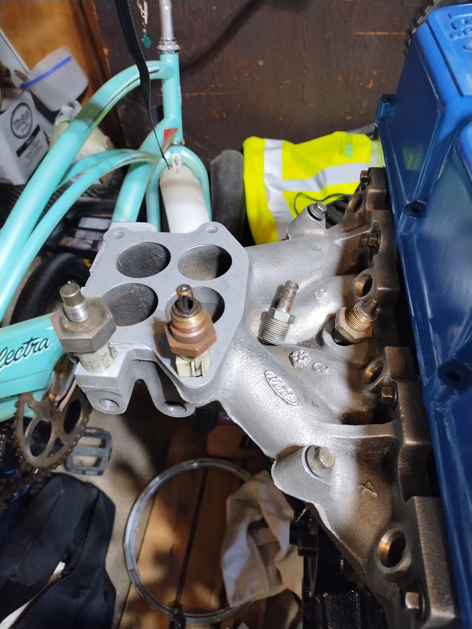

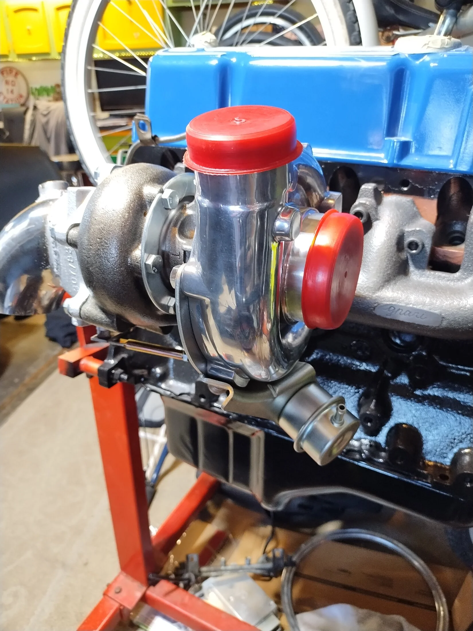

Fellas! I have an update for all of you!!! I got myself that 3-in flapper down pipe from stinger, a wastegate from Chip, and some adapters and stuff so I can use some IHI parts. almost done my exhaust side of the engine. I need to do some plumbing with my dad, we're going from an to SAE refrigerator SAE refrigerator fittings, so I can reuse my old oil line. I like it better than the braided one I got from Chip. I still need the c-clip that holds on the wastegate actuator arm my ihi clip is the wrong size. I have a v band I need welded to the downpipe figure I'll get it welded when I have more of the exhaust so I can get both halves welded at once. Also, do you guys think it'd be a good idea to replace my oil pressure sensor? I polished it up and then realized if the engine had 300,000 miles on it it might not be so good. Next on my to-do list is the intake side of the engine. I have to get my oil breather can mounted
distributor mounted
dipstick mounted
Upper intake mounted
fuel rail mounted
injectors
All of my coolant sensors,
And EGR / vacuum lines
I also need help figuring out wich sensors are wich and were do they go! Thanks!
Then I think I'm at the point where I could consider dropping the engine into the car but I would still have to do all the vacuum and vam wiring

Well guys, due to unfortunate events on my na 2.3 I feel like I have to speed up my Turbo motor, issue is every time I think I'm getting close I find another system that needs to be either bought or repaired or replaced, right now I'm working on fuel system and turbocharger, I need to figure out a way to regulate boost pressure, and I need to figure out fuel lines and then injector wiring
Stinger has an adjustable boost valve, Chip probably has one too.......
and, your N/A fuel rail and injector wiring should work on the turbo motor.

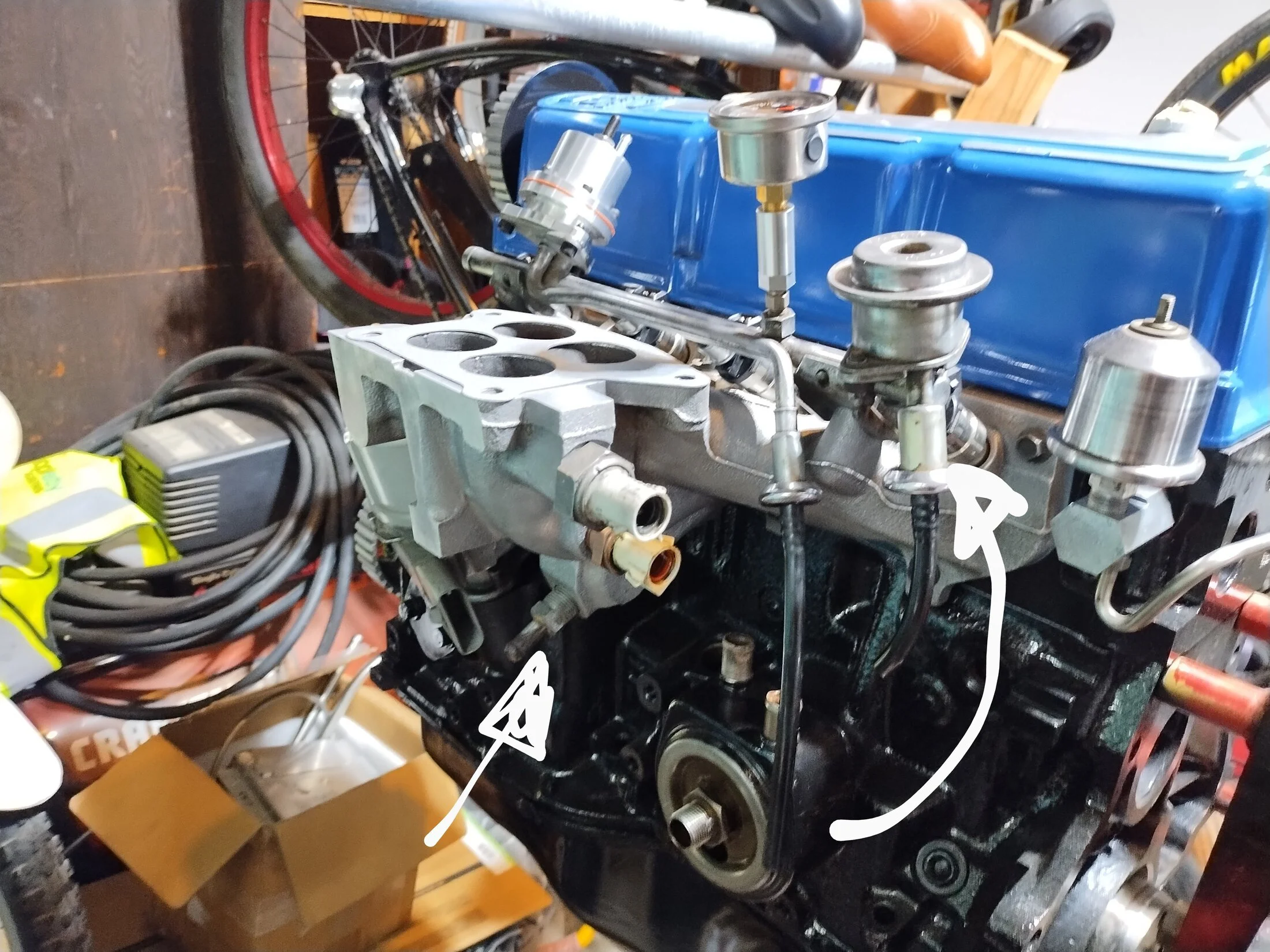

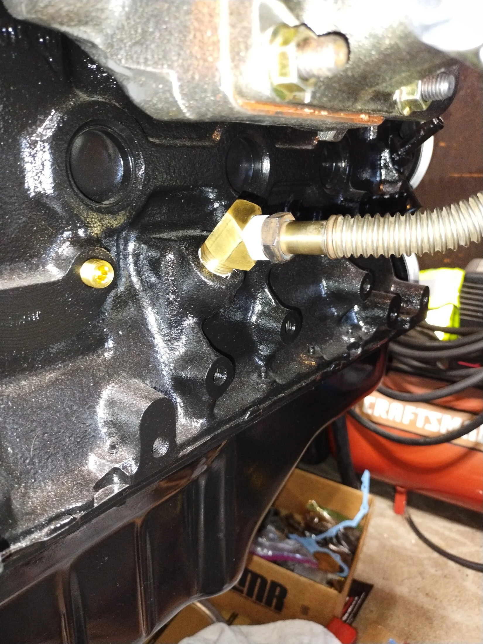

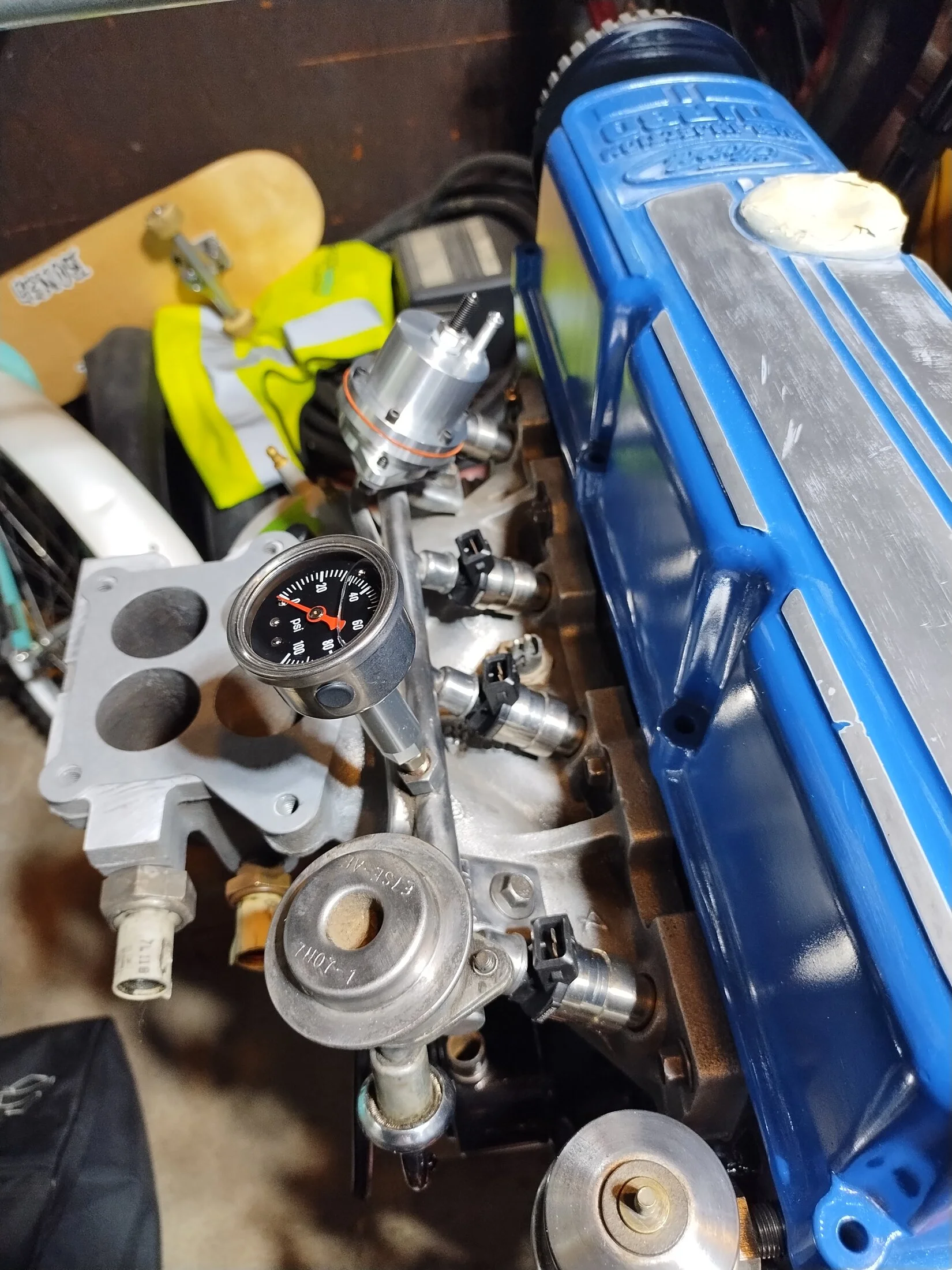

Got my fuel parts!!! Went with a new set of 35lb injectors, and an adjustable fuel pressure regulator, figure id let the girlfriend have some fun and have her put it all together haha, i had some questions for you guys! What/were dose the hose coming from the lower intake barb go? And what is the fuel pressure regulator look alike on my fuel rail?
Also, how do i set up new fuel lines? Are these removable hoses? Or do i put a new one over them and hose clamp it?
Thanks guys!
