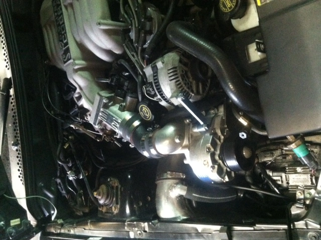

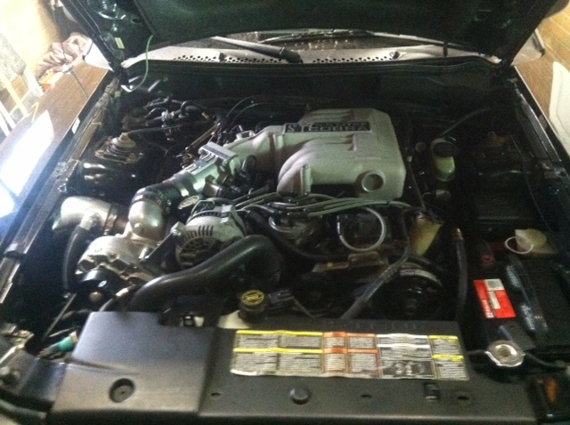

Holy thread hijack, Batman!!! Haha good times. Anyway, I started the install on Friday and worked on it for a few hours today. At this point, I have to cut the 4.5" hole in the fender for the Anderson Powerpipe, install the injectors, spark plugs, and finish removing the oil cooler. I won't have too much time in the next couple of days to work on it, but I am anticipating getting it finished up on Thursday. Pictures to come in the next couple days...
It's alive! Vortech V3 Si installation is complete and the car runs and drives. Here is my full setup: V3 Si, Anderson powerpipe, 80mm C&L MAF, BBK 75mm TB, 42lb FRPP injectors, Focus SVT fuel pump, BBK long tubes and H-pipe. I am considering picking up a ported lower intake and installing that before my May 3rd dyno tune. I found a GT40 lower for a pretty good price off a 93 - does anyone know if the 93 is the same as the 94-95's? I am assuming it is but want to know for sure before I buy it. As far as pictures, I will post them as soon as my phone turns up...

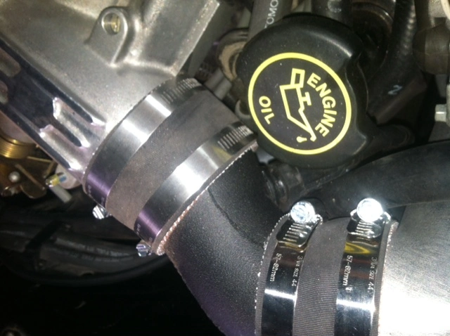

There won't be enough of a benefit to swapping out my lower intake to justify doing it, so I am going to put that off until further down the road when I upgrade the heads. At that time, I will do the Fox TB swap so I can use the metal Vortech discharge tube instead of the black plastic one that is on there now.

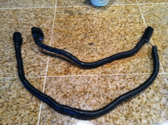

I had to extend the ACT wires about 18" to reach the relocated ACT.

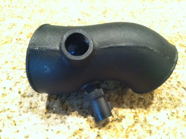

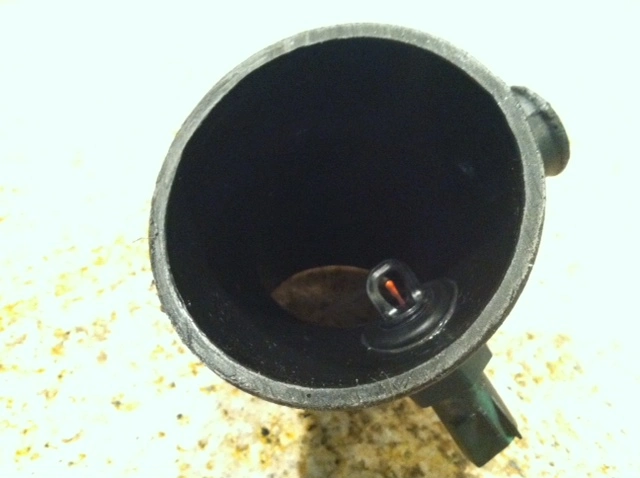

If I would have installed the Vortech inlet system, the ACT would have been located between the air filter and MAF. In this case, I installed it in the discharge tube.
