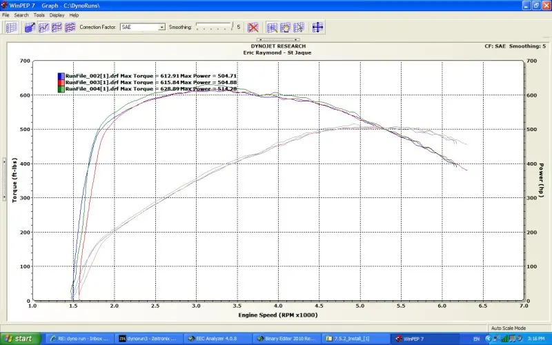

Here is my source, Don Lasota: http://www.lasotaracing.com/techKB.html
He goes on to say on this page that KB's see 230* and above ACT temps when using more than 10#'s of boost. My S trim at 15.5 psi was putting out a hair over 200* and this was after 5 consecutive pulls on the dyno.
I'm just trying to make the OP feel like he made a worth while purchase and don't want him to be thinking that maybe he should have gone with a KB. KB's are awesome superchargers when you can intercool them. There's a guy on Corral that made a sweet looking A2A setup for his KB and his dyno sheet is sick! Dude's making like 600 ft lbs of torque by 2500 rpm! I'll bet that's one of the craziest rides you could take in a street car. If this guy could make a manifold setup like he has there for a 94/95 and sell me one I'd probably switch to a KB myself.
But comparing the 2 different blowers non-incooled the Vortech simply runs cooler.
edit: here's his dyno sheet:
