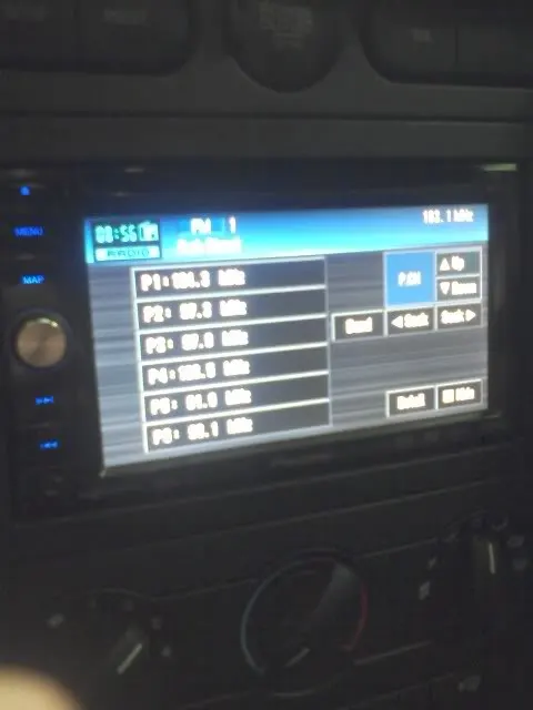

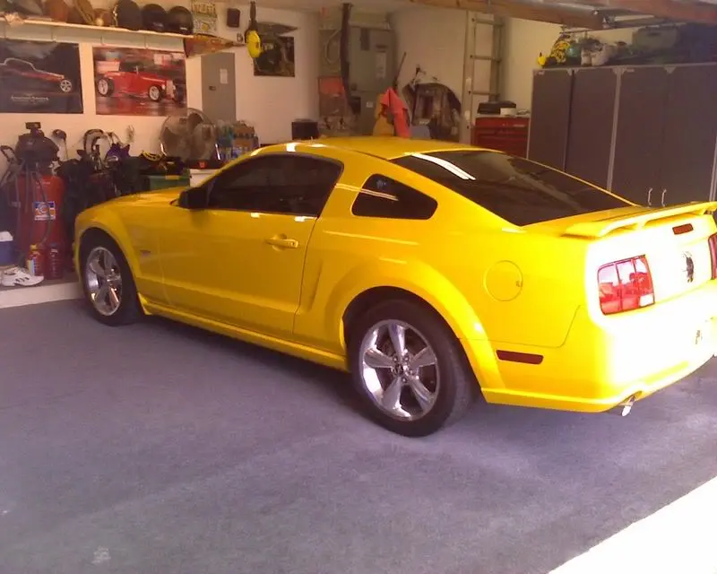

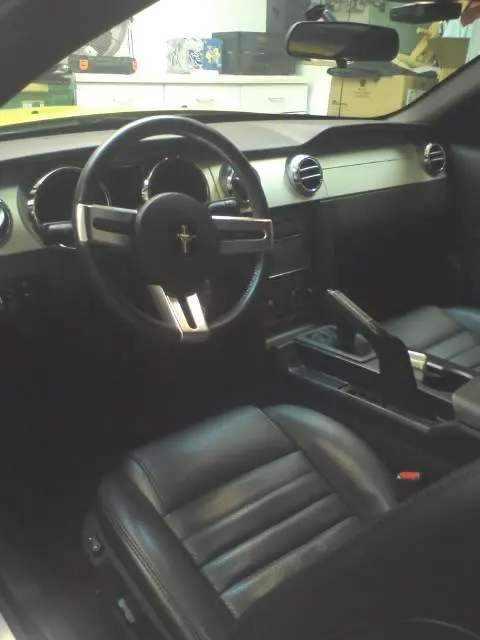

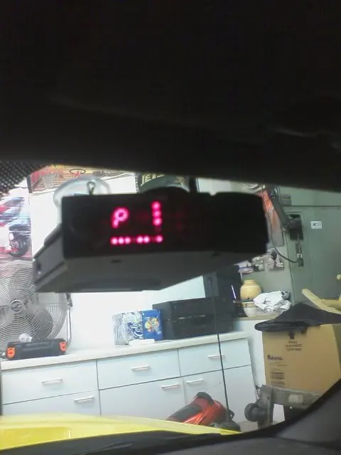

Sorry for stealing your thread Paul. As a daily driver Mustang guy myself I'd say the things you need are:
1. A comfortable interior
2. Great sounding Stereo/DVD Player
3. GPS Navi Unit
4. Valentine Radar Detector
