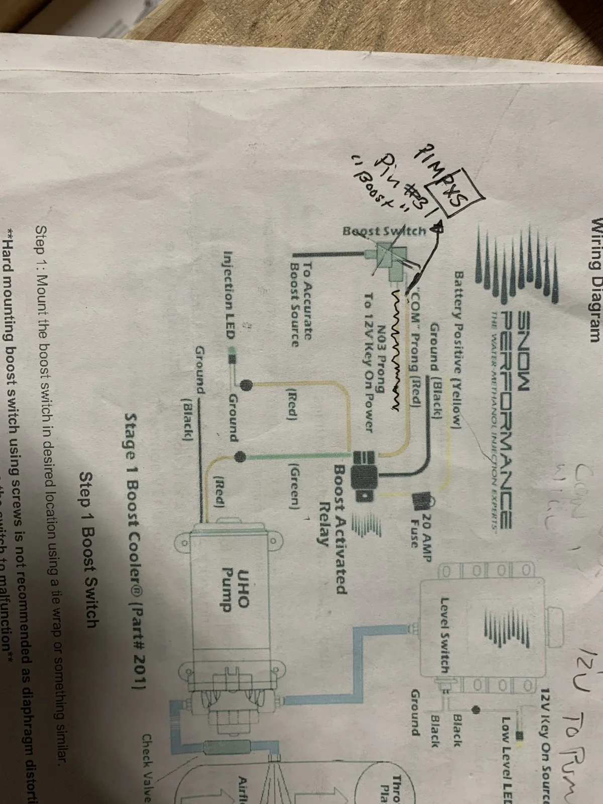

Oh I also wanted to ask if I could activate the meth injection pump from my MS? I know it is possible but we never figured out how to use the tables. Will you be able to help out on that? When I get am ready to add meth after confirming the set up runs good as is
edit: i have the stupid boost switch on there for now and i would love to eliminate it. I wired up from my ecu only to run into walls so i gave up and threw the boost switch on. I can wire it up no problem. just need help with switching it on from MS
edit2: actually i had to wire it up to boost control wire I believe since I am not using this feature on my PIMPXS ECU per Stinger's instructions. I never could figure out how to toggle the pump on and off from the boost control table.
Rather than drawing up my own diagram I just snapped pic of my snow meth instruction.

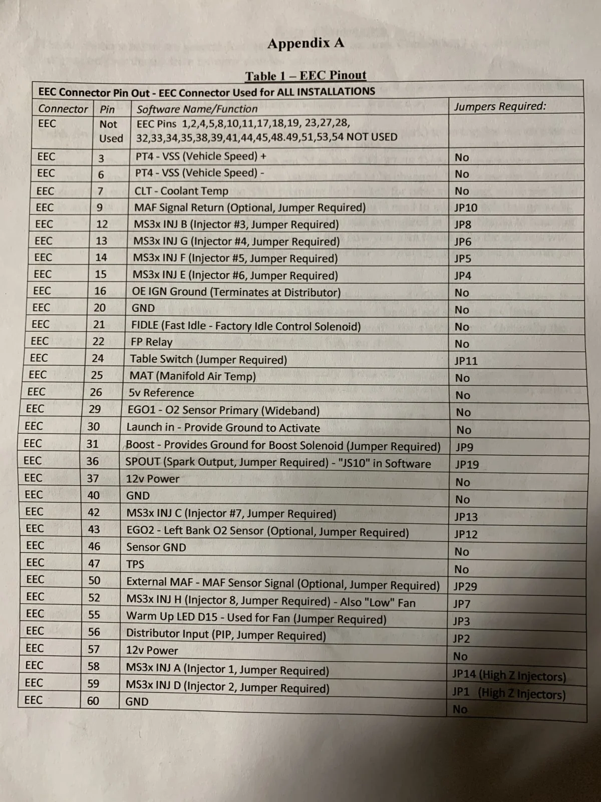

I have it wired up that way. Now I am going to route the COM wire to Pin 31 on my PIMPXS ECU which is labeled as the “boost” pin. It has to be activated by adding a jumper to JP9 which I have already done so. Just unsure how the hell am I supposed to activate this pin.
The guys from Stinger support likes to give very minimal answers to make me keep digging.
yeah... but wired that way it wont function... The boost pin supplies ground to the relay from the ecu... NOT 12v+
looking at a typical 5 pin bosch relay...
pin# 85- ECU boost pin
#86 - 12v+ ign source [must be off when ecu is off]
#30 - 12v fused power from the battery
#87- To the Pump
Is this how I should do it?

Guess I will be paying auto store a visit tomorrow to grab a 5 pin relay.
edit: man I am an idiot lol. I already have the 5 pin relay from my current set up. I’ll just change up the config per your instruction. Thanks. I suppose we will wait on meth’s addition in the tune until I can confirm the engine runs properly.
OK I have it all set now. Ready to use meth kit when turned on in the tune :stir::crazy:
