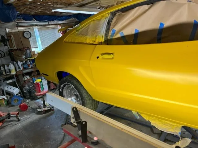

Unhappy update. Well I got the yellow done. Then started on the clear. got the passenger side done and the hood and part of the fender. Ran out of clear, reloaded and began again. I noticed big blobs of clear. Though I was not covering properly, as it looked like a "dry" spot. So ran gun over area on left door, fender and hood. It got worse, then the paint just stopped flowing..................check around and found I had no air......... Check wall filter, no pressure. Went out to my air compressor and the motor was running but not the compressor..............found bell pulley on motor fell off.............make a long story even longer, got a new key, set screws and did all kinds of stuff. Pulley keeps coming off and the belt keeps getting thrown. So, the last thing that can be causing this is a week belt. So, tomorrow off to a supplier for a new belt. I get to sand the clear down to remove the heavy spots..................But I did get the bell housing back from the machine shop. Engine goes in Wednesday.

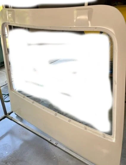

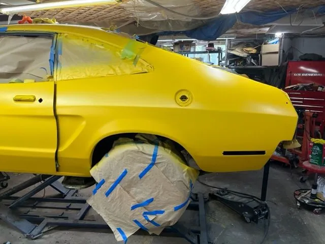

Got the yellow on and did the clear. Had a few runs but working on those. Not bad. Waiting for my air compressor motor to return from the shop. did the primer on the replacement rear hatch.

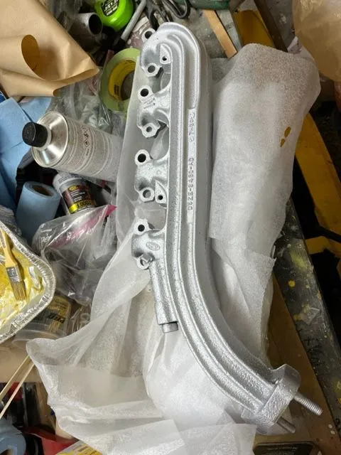

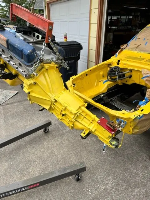

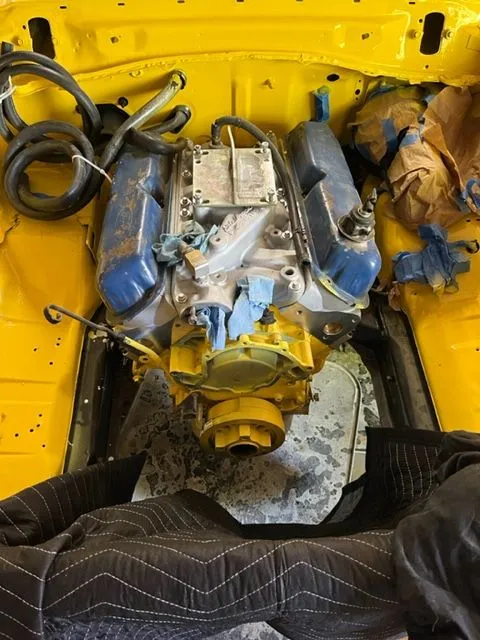

At last, the engine/trans is installed. Got that done Saturday. Exhaust manifolds were powder coated. Came out a bit too silver, but should look good.
Ordering engine parts; roller arms, lifters and push rods when I get back from cruise. I do have new tall valve covers. These just keep junk from falling in......Need to have drive shaft shortened.

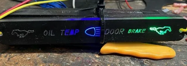

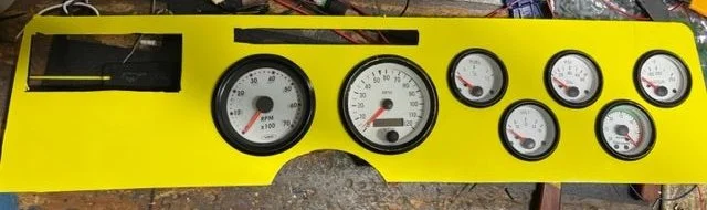

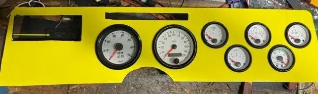

Hello from Oregon. Seems I have been posting on two places. This and All Ford Mustangs. This has been the posting thread I prefer at this time. Sorry for not updating this, but been kinda busy and lazy. Cold weather keeps any work limited. I have been doing some wiring and just finished making my custom
dash using VDO gauges.
I will be painting the support the triple yellow I am doing the body in. The upper hole will have the lights for;OIl, Temp, High Beams, door and each end has a running pony for the turn signals. Will send when that is installed. Had to test about 10 different LED bulbs for I found one that fill each word without just filling the center.

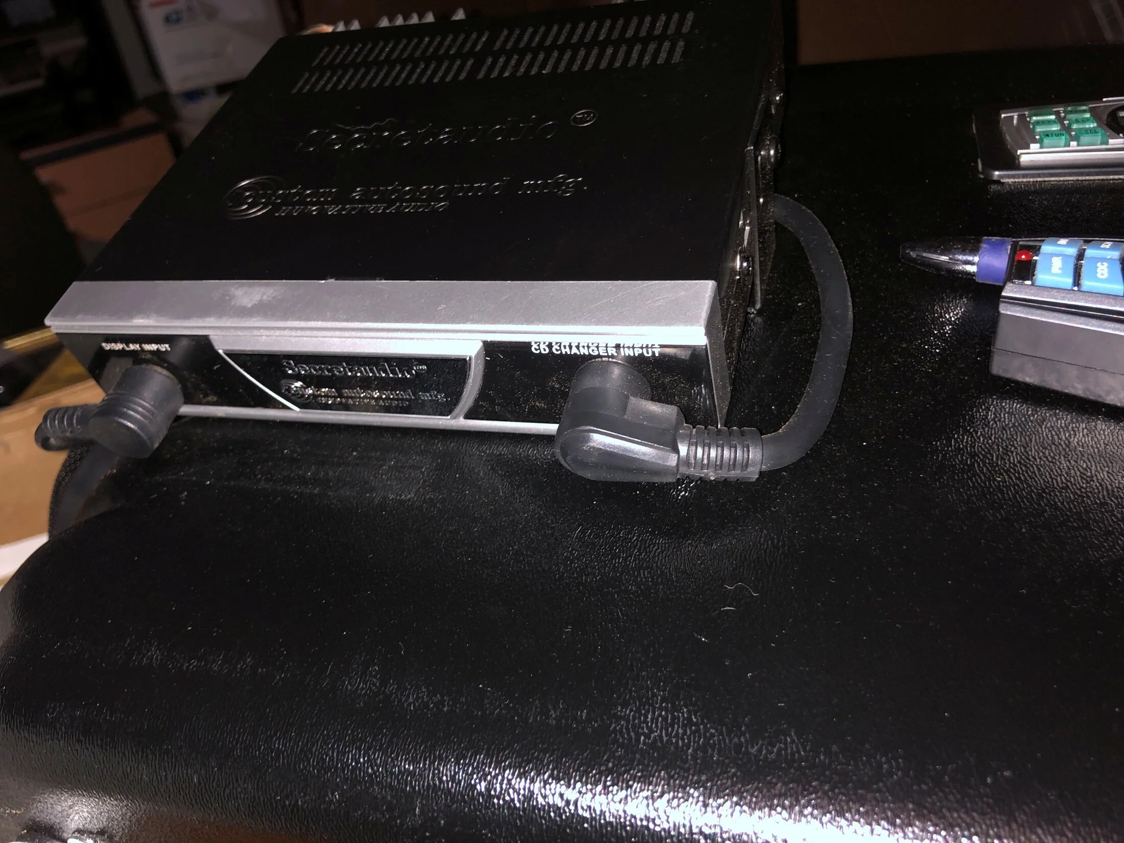

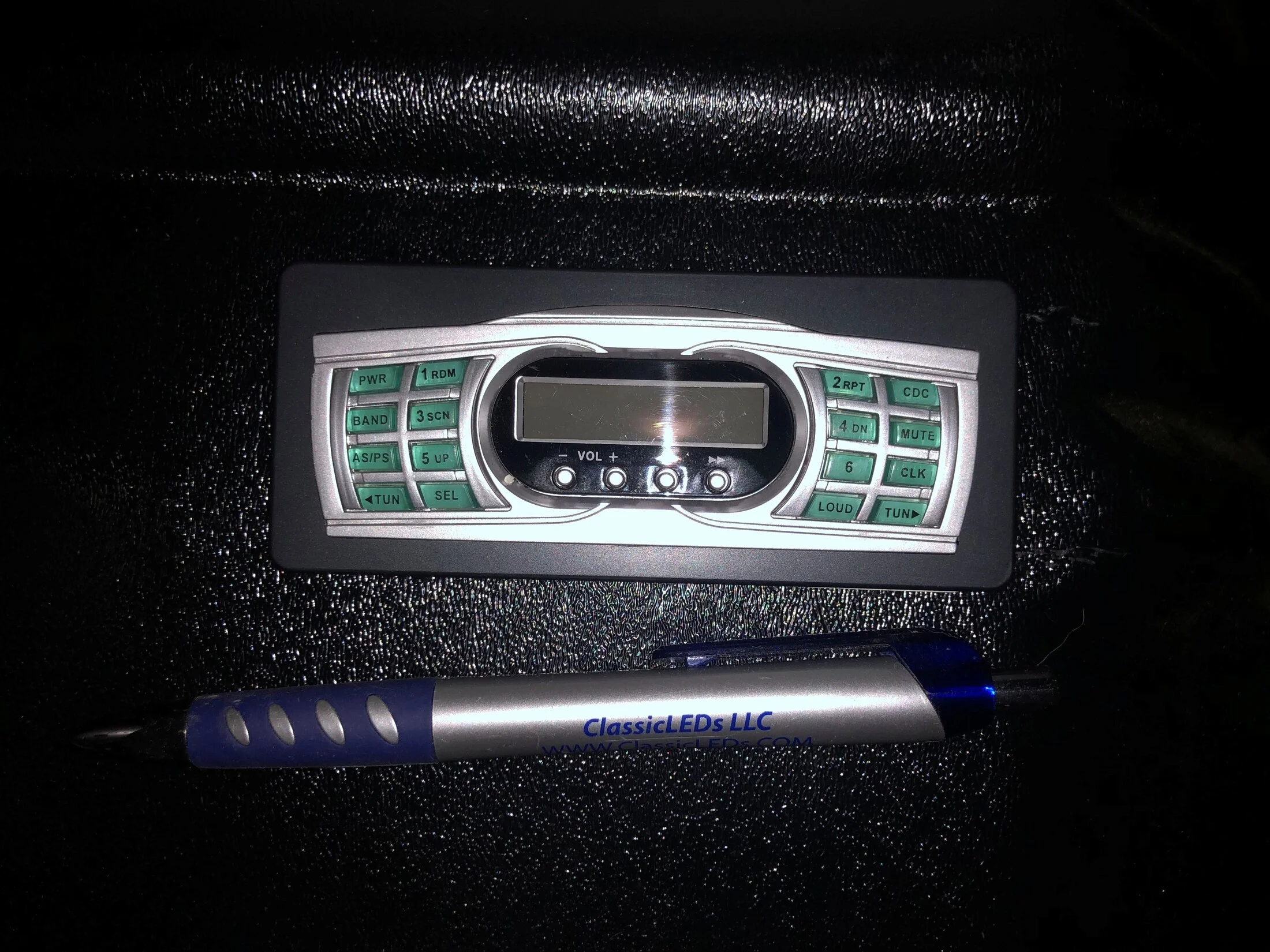

Installing my stereo system this week. Using an older Secret Stereo system I have had for about 10 years. Still new in the box. Found I have two of the 10 disc CD player.

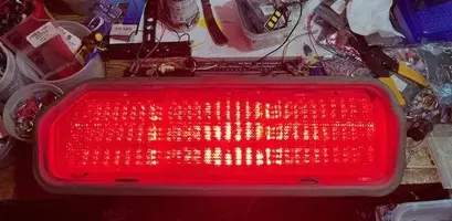

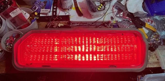

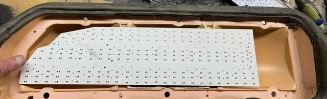

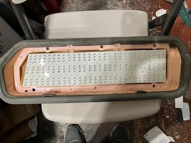

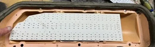

Also finished building my LED brake lights. Did not do sequential as i don't own the company anymore and did not keep a few of the computer chips.
The lens will be all red. Have some white LEDs for the reverse that will be just above the license plate.

Making progress. Almost finished doing the re wiring. Hope to have my Hidden Stereo wired up Tuesday. l Painted new dash and insert on the passenger side just above the glove box. Putting radio/CD control there. Photo to follow as I did not take one. Also finished the dye application of the center console. Used the red one from my parts car. I did not know the center console has a chrome piece going around it. This console was in a GHIA. Had the hardest time finding a yellow vinyl dye. Had to order it from the local auto paint supplier. Painting the area under the windshield in front of dash pad. Also installing an NOS dash pad I bought about 15 years ago. Looks good and nice and soft.....Redoing all the interior panels using SEM trim black. Washed them yesterday and cut holes in panels at the end for speakers. Putting new speakers in doors and trying to put small tweaters in the area under the winshield (what is that area called???) installing relays under the battery air flow cover in the engine compartment. Placing switchs at the end of the console under the ash tray for on/off controlling the electric fan, electric water pump, backup camera, along with red LED lights showing when the fan and pump are not working. Also used plastic coating paint to paint one of the rims black for testing...........Kinda ugly...... Still have not finished attaching the door lock/handle rods.......That's it for now...............oh yea. After many people telling me to put a better cam in the engine I bought one this week. Local family owned parts store going out of busness. Having a big sale. Up to 75% off. So got one just in case I want to upgrade..... Guess I am now as someone is coming over the help. Lucky the front of the engine and radiator is not installed. Center Console Chrome.webp CAM.webp CD Amp.webp CD Changer.webp CD Tuner.webp

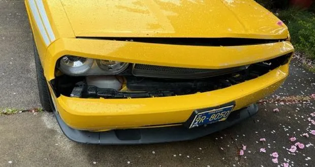

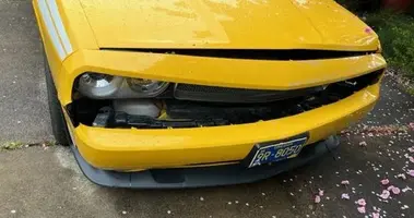

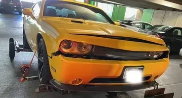

Good News and bad news. According to my wife, while driving to work, a wall in the parking building jumped out and smacked the front of her 2012 Challenger. Lots of damage. Reported to local police regarding the wall jumping out in her way. For some reason they asked her to touch her nose and count from 10 to zero. She loved this car. Insurance company said the car was totaled. She did not loose money on the payout as the car has gone up, a lot, since she bought it. Looked for another yellow RT but no luck. Asked my friend at the local Ford dealer ( I see a strange ending to this) said he had two on the lot, a red and a blue one. Did a test drive but both were no where near the yellow in all ways possible.
There just happened to be one yellow Mustang on the lot. A 2017. Looked and sounded good, but lots of miles and the add-on's told me a younger driver had this........
So after driving a few we left and came back today. I asked about 2024's to compare prices. Well she ended up ordering a 2024 Mustang in Yellow. Seems Ford has not been selling true yellow Mustangs for a couple of years, but 2024 has a yellow option....Should be here in Sept or Oct. She has her 2002 T-Bird to drive.. Challenger Left Front Linda.jpg Chall on Tow trk 2.jpg
