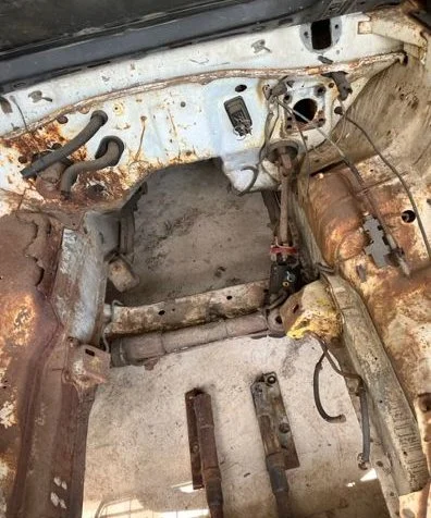

Went to inspect the T-Top It;s a 77 Cobra, no power train but has everything else except the dash. Lots of rust in the engine compartment but all surface except the battery area which is not to bad. The radiator support was cut at the top so who ever could remove the engine. But I have a really good one in my black spare parts 75. Made an offer less then asking, but he said since I will be restoring the Mustang he took to offer. Then showed me boxes and boxes of spare parts along with a spare door, hood and back hatch. Also has a spare cowling. Going up Friday to pick it up. The only thing I saw missing was the supports that go from the fire wall to each shock tower. I guess they did not put these on a 4 cyl car. Has a spare set of T-top glass......Then showed why he is getting out of doing cars and racing. Has an addition 2 that he races.. Showed us a 40 boat!!! Thinking about having the body sand blasted. Was thinking about having it dipped, but that is a lot of work prepping and how do I get a car body only there. That's it for now. Larry

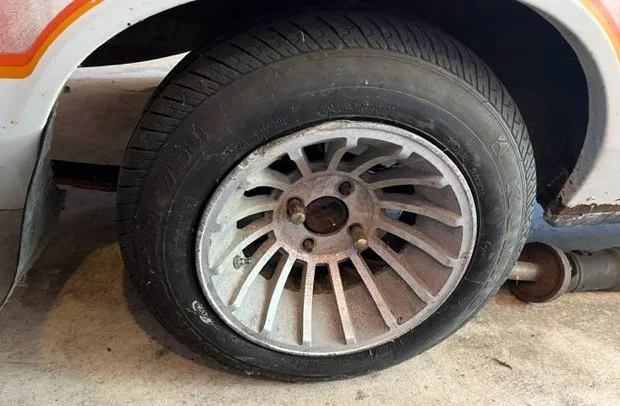

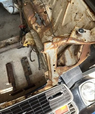

Thanks for the input. I did not see the supports, but they could be one of many boxes of parts. The trim around the T-Tops looked like one piece but I did not inspect all that closely. They are factory installed. i will post photo of them when I pick the Mustang up. Wheel.webp Rad Support.webp Engine Comp.webp
The radiator support was cut. I have my 75 V6 parts car with a good support. Hoping this will work??? Old school rims, but are 13 inch. found some 13 tires at Tire Rack on line. Not as expensive as I though.
The only real rust is in the engine compartment. I am thinking of have this sand blased. Checked into having the body dipped but that is expensive and I would need to strip the body.

I love those hurricane wheels. Wish we could still get 225/60/13's. They fit the rear of my old II in the 80's and looked great.
I have seen a few with the core support cut and just cannot see why. I can drop a 302 and trans with headers and belts installed into and out of there without any issues. Just have to remove the fan. Plug the trans output. I usually use a rubber glove and duct tape but they make plugs for it. The glove and tape method protects the tunnel a little as it tends to rub there. Leave the headers loose so they can move around. Jack the assend up so the nose tilts down. Installing, I jack the front end up as the trans clears the tunnel. Removal I drop it down as the trans clears the tunnel. Last couple times I used a tilt thingy on the engine hoist which makes it sooooo much easier than standing on the output housing of the trans. They fit like a glove. A kids glove being stretched onto a giants hand but still. One brand of headers is a pain ( hedmans, I lay the passenger header in the bay first) but the other two brands (blackjack and hookers) fit fine going in as an assembly. Just leave them loose until the engine is in place.
That engine bay is barren. Looks like it's actually in really good shape though. The battery tray is gone but looks like it is solid underneath the tray. Christine was rotted all the way through there. Down to the seam at the frame rail. Only place on it that rusted through. The battery probably leaked some acid on her. I had to cut about 12 x 8 area of metal out it was so swiss cheesed. One reason the battery is in the spare tire well now.

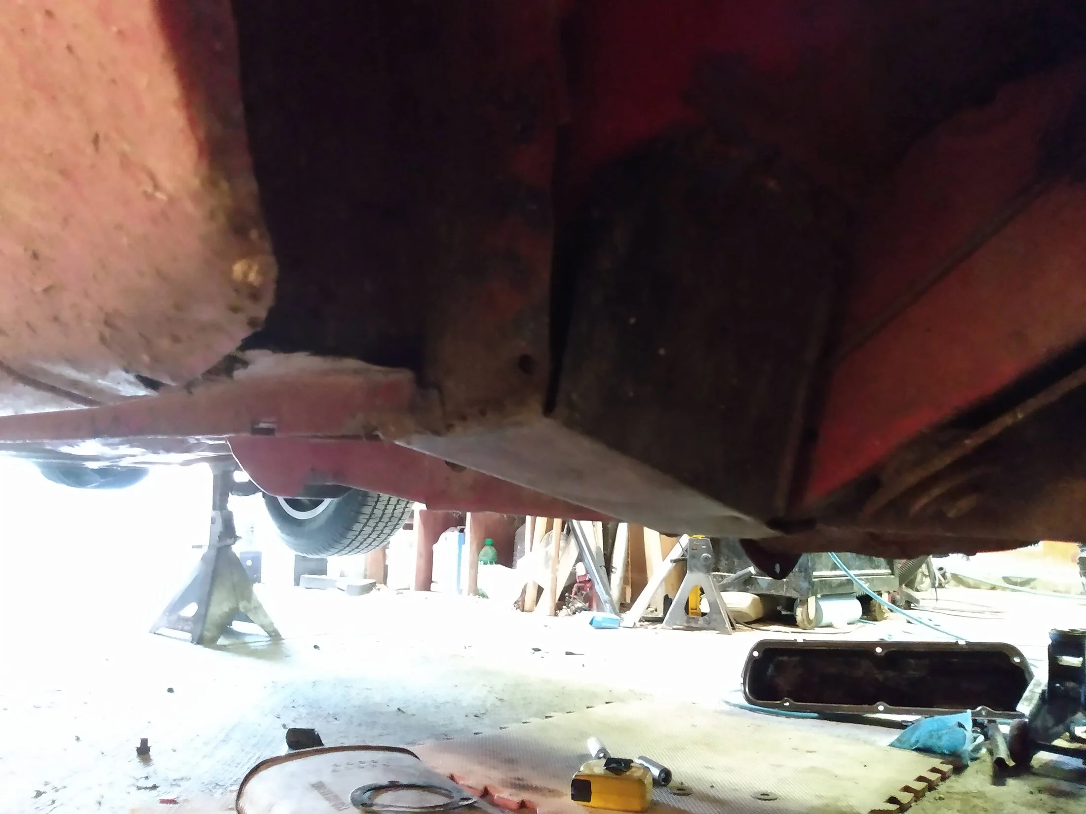

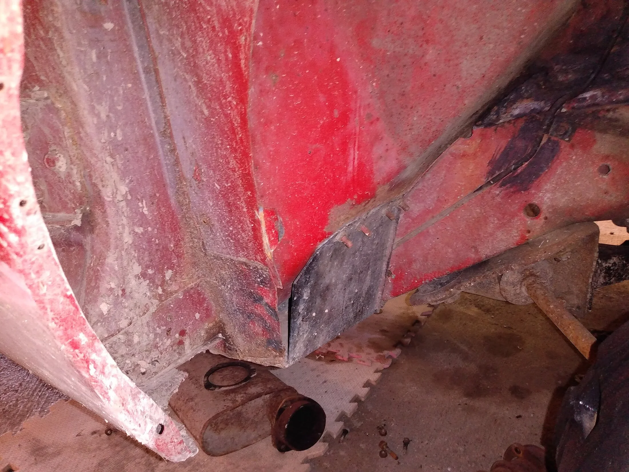

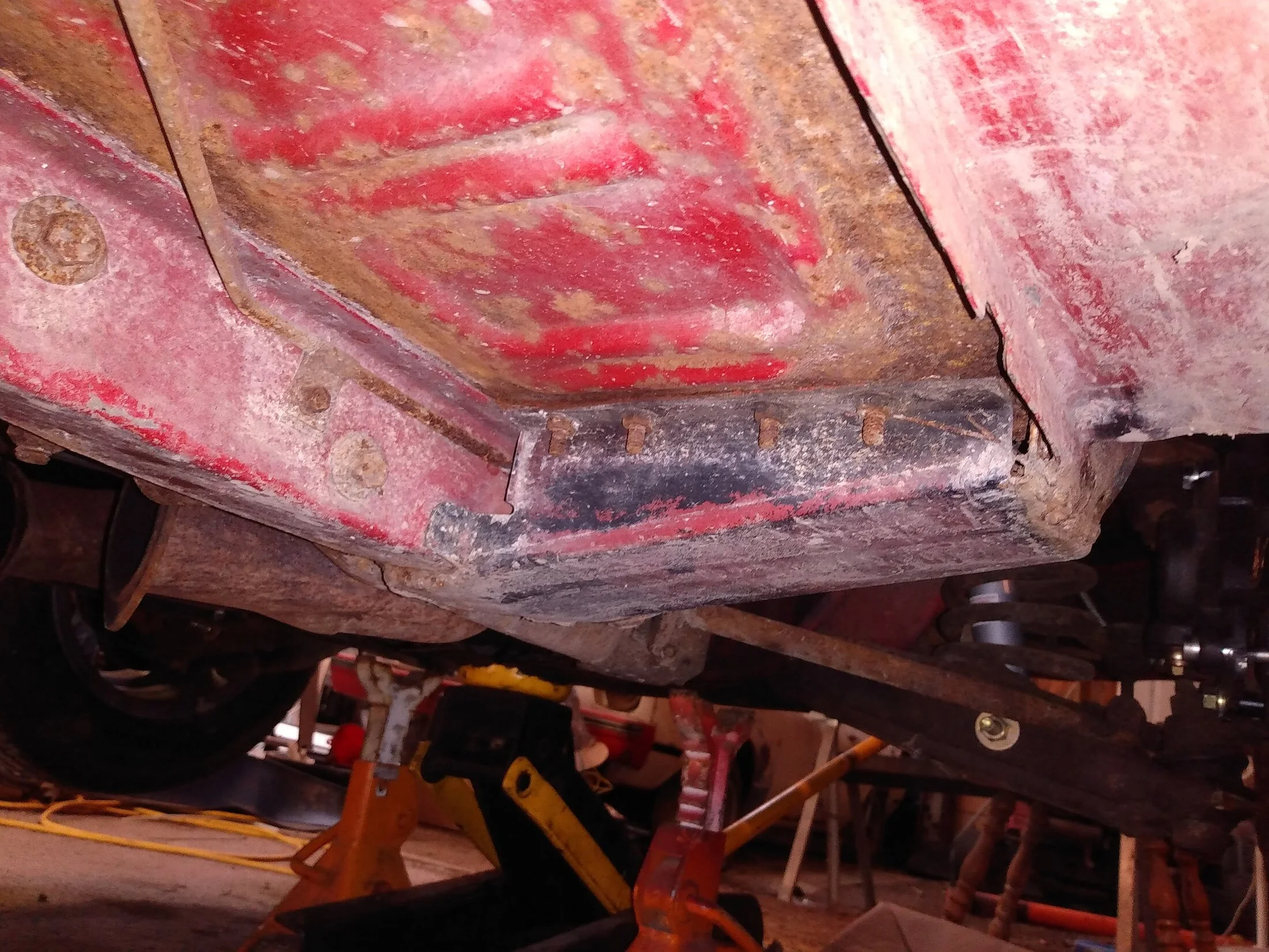

Check behind the front wheels for the torque boxes. The pics below are what the torque boxes look like. I have seen 1 car where they were only welded. May have been added later on that car. Christine has them welded to the subframe and bolted to the wheel well/floor board. The weld was very poor from the factory and broke or just didn't stick on the passenger side at the rail. I had to re-weld it there. So double check their welds.
Anywhere the brackets or boxes penetrate the body have another strip of metal as a backer to samich the sheet metal between the steel.
Ignore the rust. These were taken before I treated and painted the chassis.
Looks like the core support was damaged, so they probably cut it to get the engine out. Otherwise, from the few pics you've shared, it looks like it could be a good project candidate. :nice:
I also has a set of those wheels years ago. Put them on a car I threw together for my sister so she could sell it. Seems like I shared a pic of that car somewhere here in the forums, but I don't remember if it had those wheels on it in the pic. But they really added a little something to it compared to the stock hubcaps it had on it to begin with.
