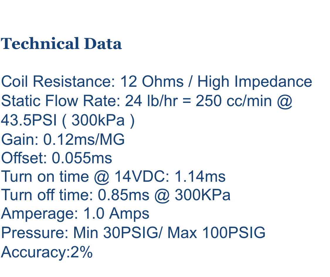

I assume the blocks with 14 in them are where it idles correct? That's a very low number, I like to keep the idle ve above 30 or so. We can change some things to bring that idle ve up. I am thinking your injector dead-time is wrong, this will affect the ve table heavily at low load/rpm.
I know we went through this before but what injectors do you have?
