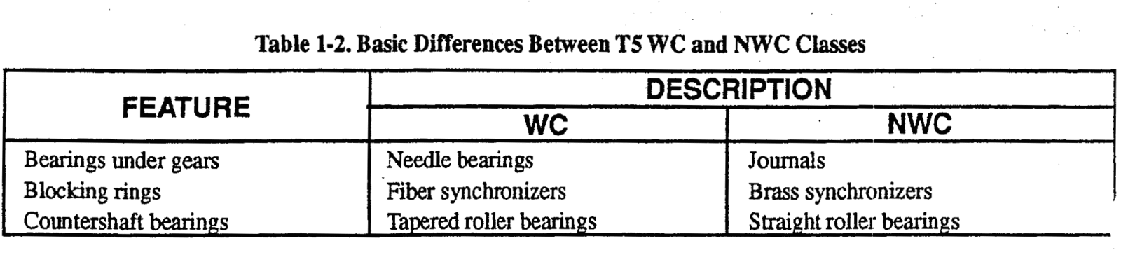

major difference...
fiber vs bronze syncros
which is better?
i know all an all the T5 is junk in stock form. but honestly is one better then the other?
Reactions: Illuminator
The later the Fox T5 you can get ahold of, the higher the torque capacity rating. The T5Z was about the cream of the crop as far as Ford offerings go. Get into something aftermarket (Astro Performance, D&D, etc) and they can really hold some power.
i know im going to over power pretty much all of them unless its a Gforce or an astro.
one thing i do find funny is i know its been rebuilt before. since the inspcetion tag has been removed along with the blue RTV on the front bearing support. but the front bearing race in the link i has pictures shows the difference between the NWC and the WC bearing race. mines the same as the WC. but im running all bronze syncros along with the case showing an 84 V8 T5
