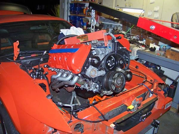

The car was already converted to a Eaton set up by me a few months back but I started having oil pressure issues shortly after finishing and started on the next step of my project. I had a shortblock built so I could run more boost and in the process I'm changing a few things on the car.
Here is a pic after I completed my Eaton swap. I made 411RWHP with 15* of timing and 8.5lbs of boost with this set up.

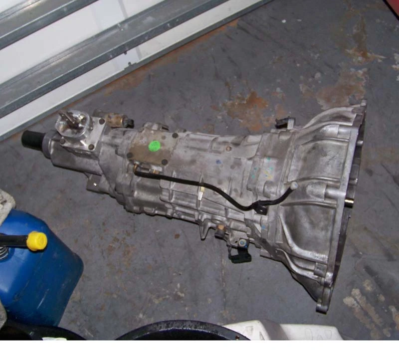

The D&D Viper Spec 6 speed that will be replacing the 3650 that came in the car.

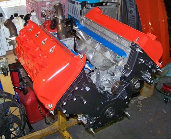

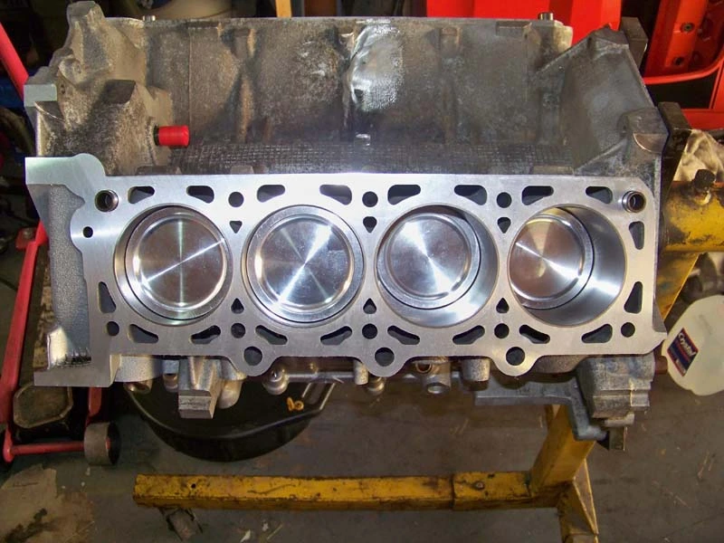

The new shortblock ready for me to start the longblock assembly.

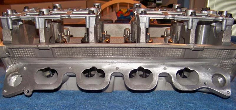

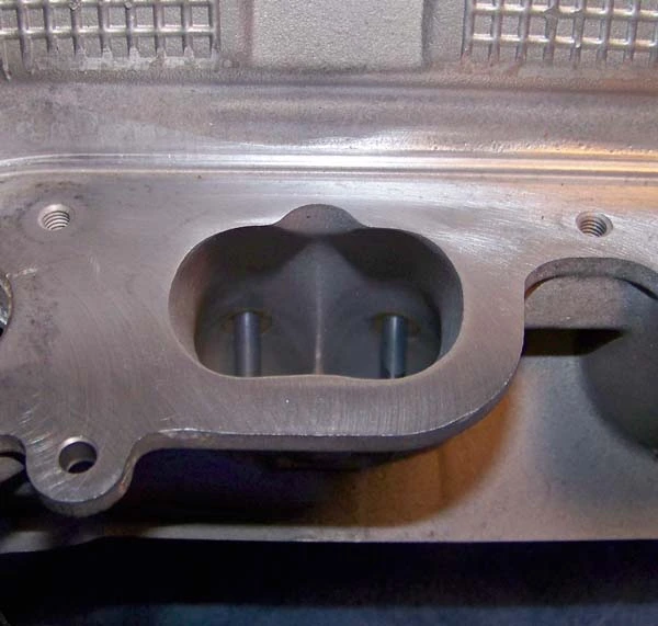

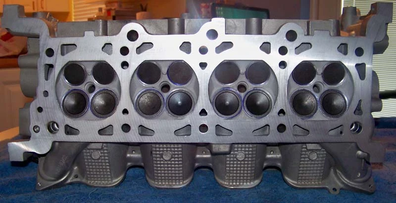

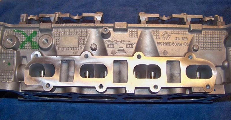

I picked these up from Modular Head Shop. My stock 04 heads ported with Livernois valve springs, new guides and valve seals.

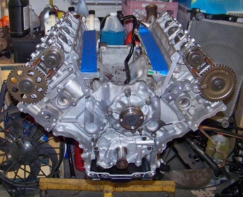

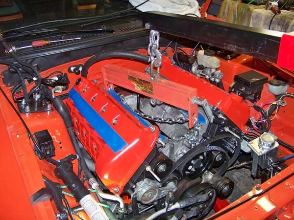

Finally got some time to work on it and got the heads installed.

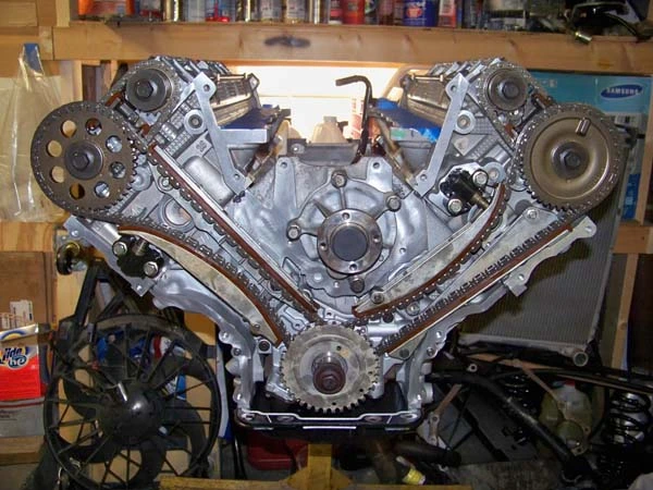

Timing chains on and cam timing done.
Timing cover and valve covers back on.
I have maybe another hour worth of work and it's ready to drop back in the car.
Bill
Unless I missed it, are you still running stock cams or have you stepped up to a custom grind?
Stock cams, Livernois springs to handle the higher boost. After lots of research I found that aftermarket cams just aren't worth it. Very few really pick up any real power, a fair amount of them have issues down the road and the cost vs. power ratio sucks. 03/04 Cobras will make 600RWHP with just the 3.4 and that's what I'm looking for and shouldn't be a problem.
