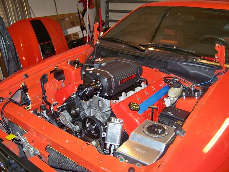

Blower temporarily mocked up.

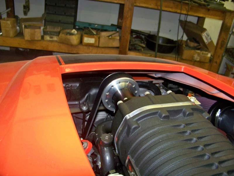

Still going to be able to keep the shaker up there with a whipple under it?
Right now it's looking at the very least I'll have to attach the shaker to the hood because there are no good mounting points on the whipple itself like the Eaton had. My big problem is the pulley. I need at least 1/2" above the pulley and a good 1.5" side to side so it doesn't hit the hood under load. I won't know till the hood is back on.
If it doesn't fit then I'm going to look at a couple of options. Have the cowl portion of the hood raised enough to clear it or if it's really close to the opening then maybe open it a little and trim the shaker back. Last option is a new hood but I really do not want to change hoods. The shaker hood makes the Mach 1 and losing it (to me at least) makes it just every other Mustang out there.

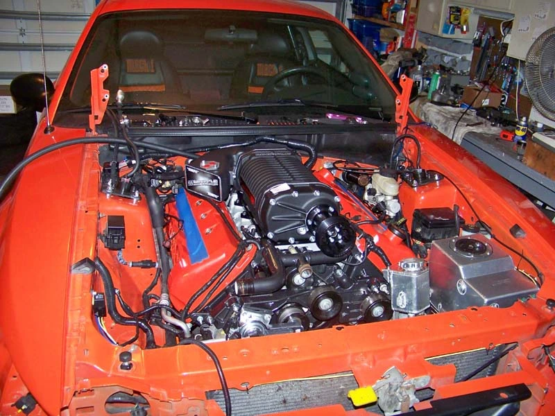

The blower is now bolted up, wiring is mostly done, front accessories back on, intercooler reservoir is mounted. Although it doesn't look like I made much progress I actually got a bunch of things worked out. Back in April I had a wiring problem and fired the fusible link and ended up doing my own fix and down the road it kept on popping alt. fuses. I got a junkyard replacement harness for that alternator and while I was swapping the connector over I found the problem. One of the smaller alt wires melted and wire was exposed and it rubbed the frame enough to pop that fuse. I also resolved a problem with a power steering line from back when I did the swap. My original fix didn't work but now it's good to go.
I had to make some changes to the fuel lines and ordered two more fittings so once they come in I can wrap up the rest of the engine stuff. This is how it sits now.
I'm expecting to have everything done this coming weekend so I can get the front end aligned next week.

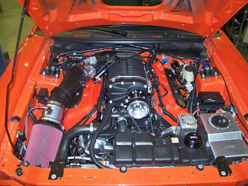

Intake finished up.

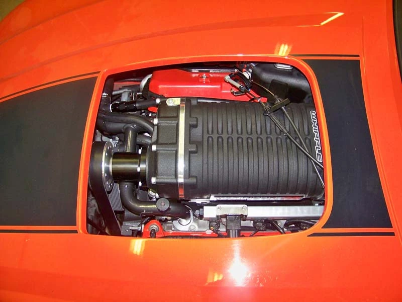

Hood clearance.

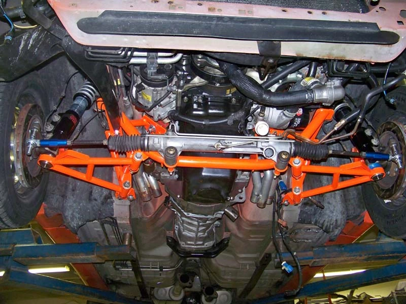

Front suspension.
