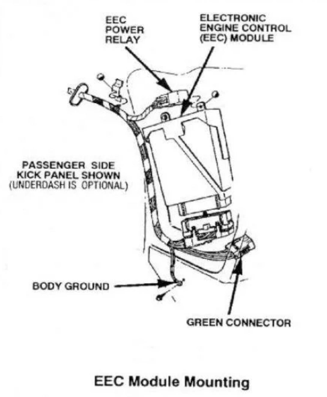

I removed the pass. Kick panel to look for the power relay,and where the he'll did they hide it????
Do you have to remove the blower box, ecu?

  • Sep 14, 2024
  • #60
Reactions: nickyb
