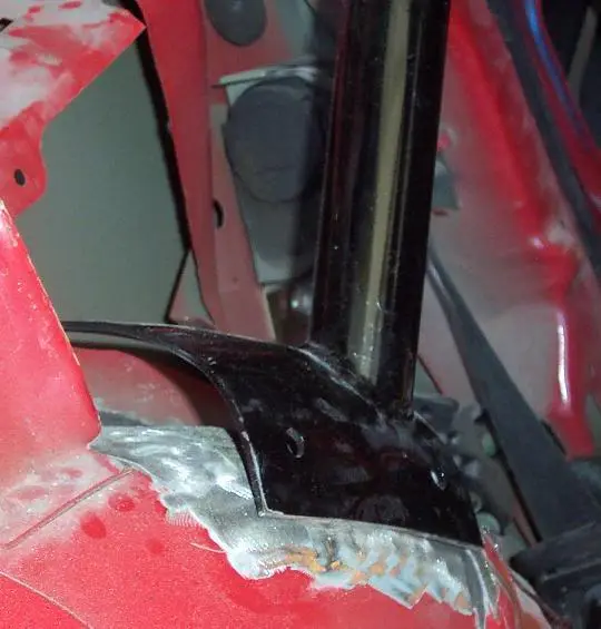

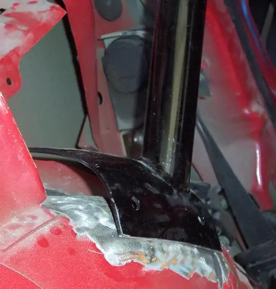

Ok, im telling you this from first hand experience. I got the 6 point MM bar with swingout door bars. The back 2 bars are about 3/4" to 1" TOO SHORT of reaching the wheelwells in the back. Mine is in an LX Hatch though, not a vert.
When i was researching this, i never heard any complaints, but i ran into this dude on here (thehueypilot) and he had the EXACT same problem i did. They didnt cut the back bars long enough on his either.
I called MM to ask them about it, and they said that they have never heard of that. They said every cage is made in a batch and they are made all the same. I sent him pictures and ill show you exactly what i mean...
notice how its too short to weld it right to the wheelwell. Im going to have to cut it and lengthen it to make it work.
Take my advice, if you order it from them, test fit it immediately. If it doesnt seem to line up right, call them right away.
