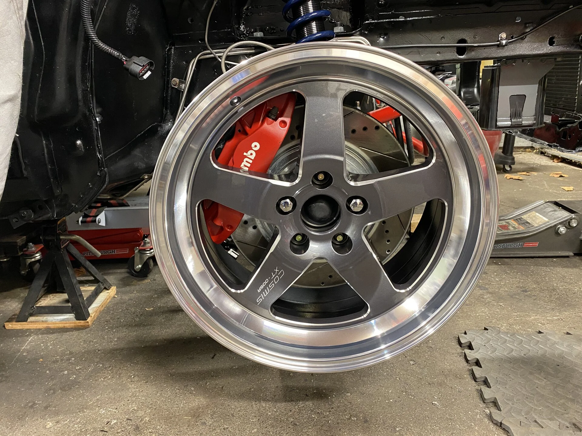

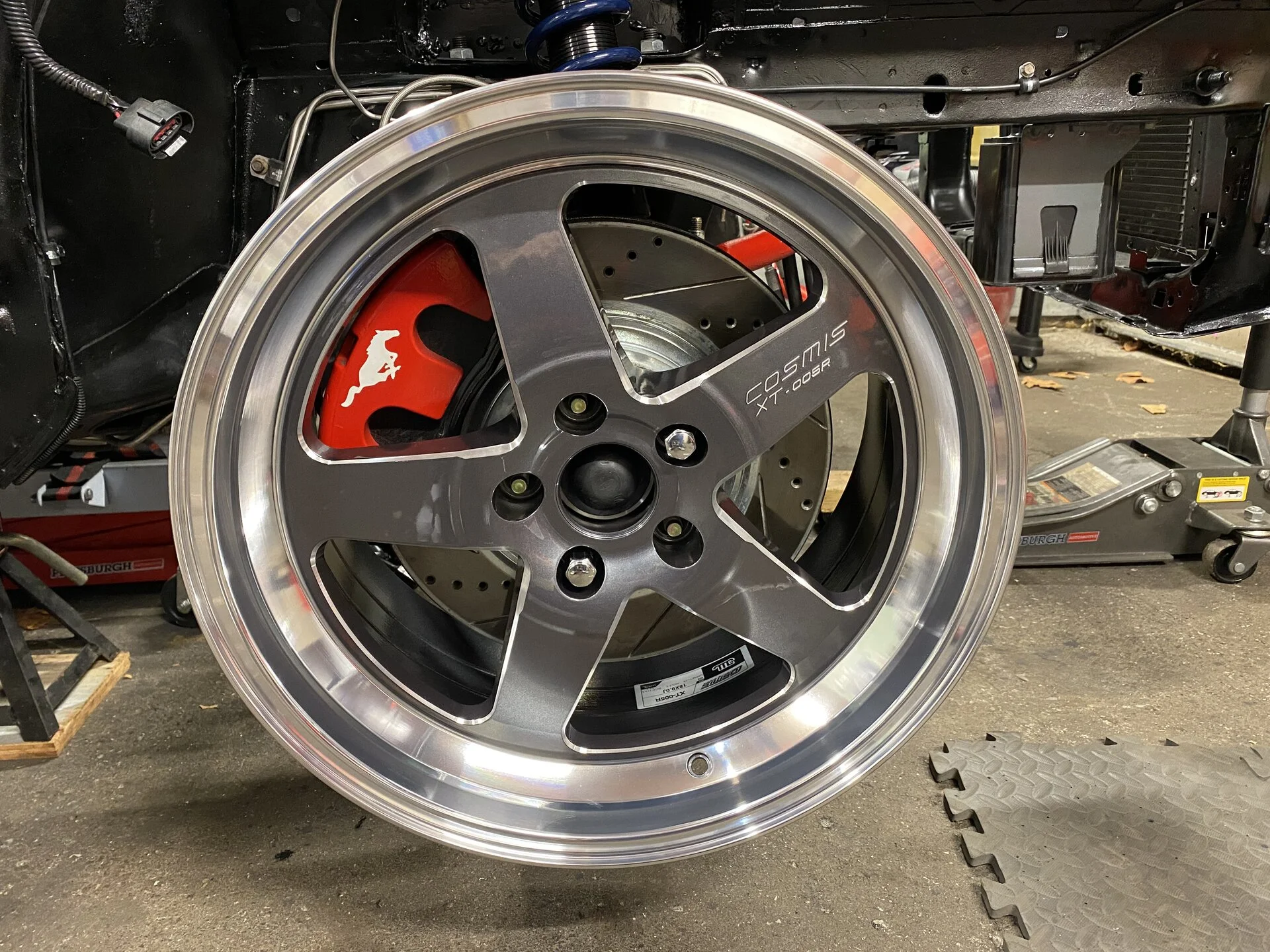

these do not fit with the brembos. I’ve got 6mm worth of spacers on and need more. I prob need 10mm (which I don’t think exists) I’m out of hub for the wheel to slip over. Needless to say, not really sure the wheel would fit the car at that point.
so I tossed on the C6 calipers. Plenty of room.

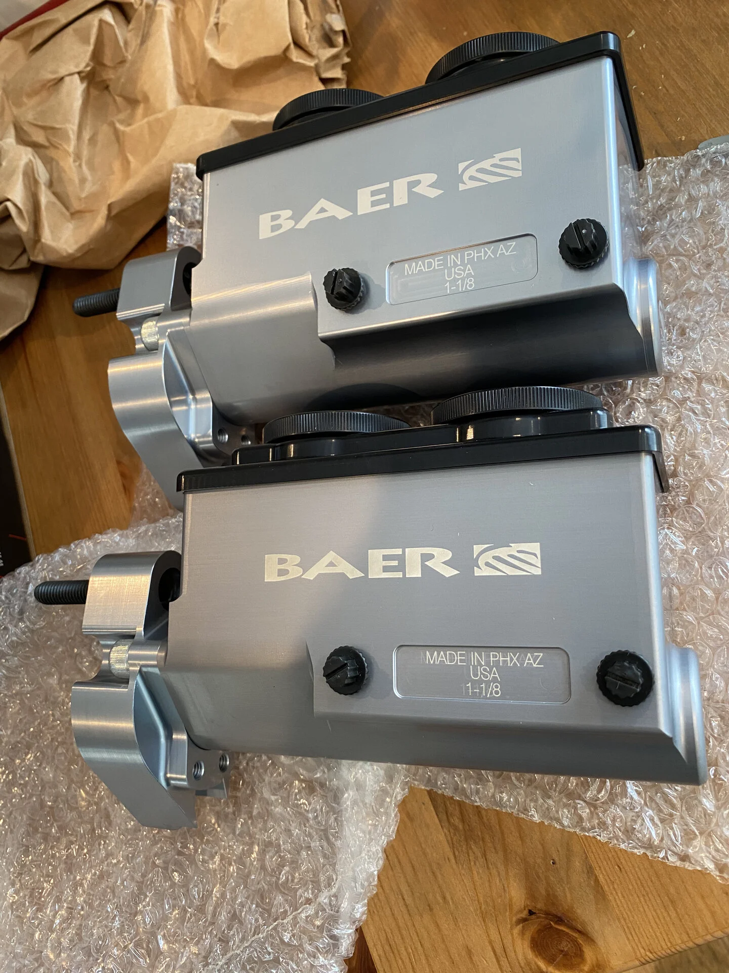

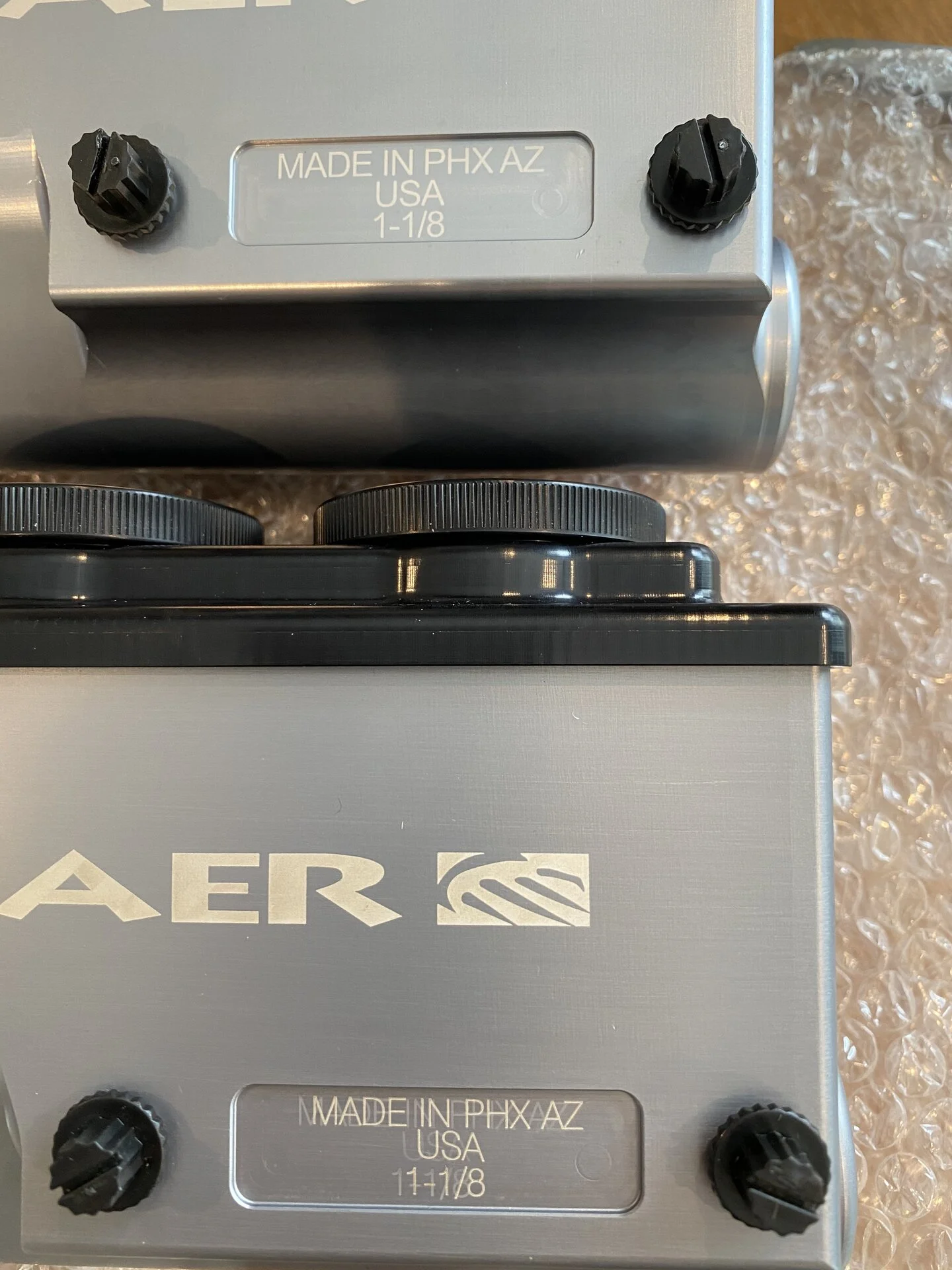

Gotta make a decision here. It would have implications in parts. For instance, I wouldn’t need the Baer MC anymore, which is 1 1/8” bore. The whole reason for using it was the larger brembos and 43mm rear calipers. I have the oem MC and conversion lines in a shelf ready to go.

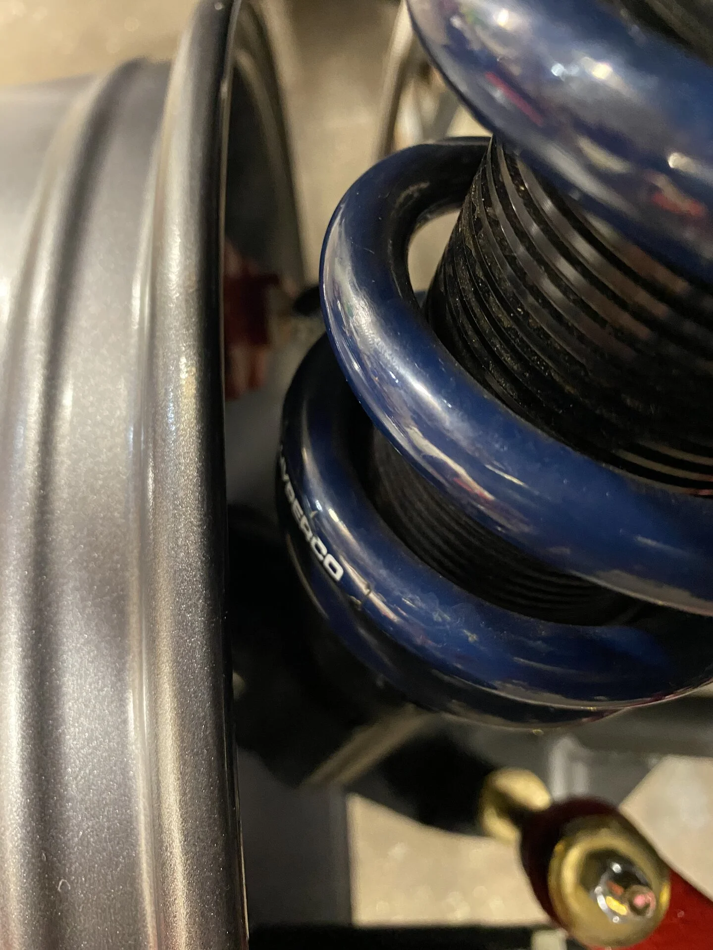

secondly. Here’s the clearance to the coil over. This was with a 3mm spacer on, which would be removed.
it’s tough to get a sense of where the fender will sit in relation to the wheel without an actual fender on the car. The distance to the coil-over is similar to my 17x8 cobra wheels. Obviously these are 18” so perhaps they are a little closer, but keep in mind I’m running 96+ spindkes so sticking out too far is a concern.

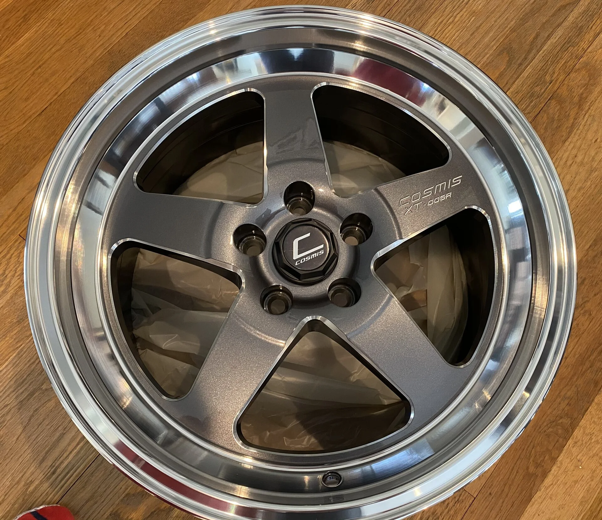

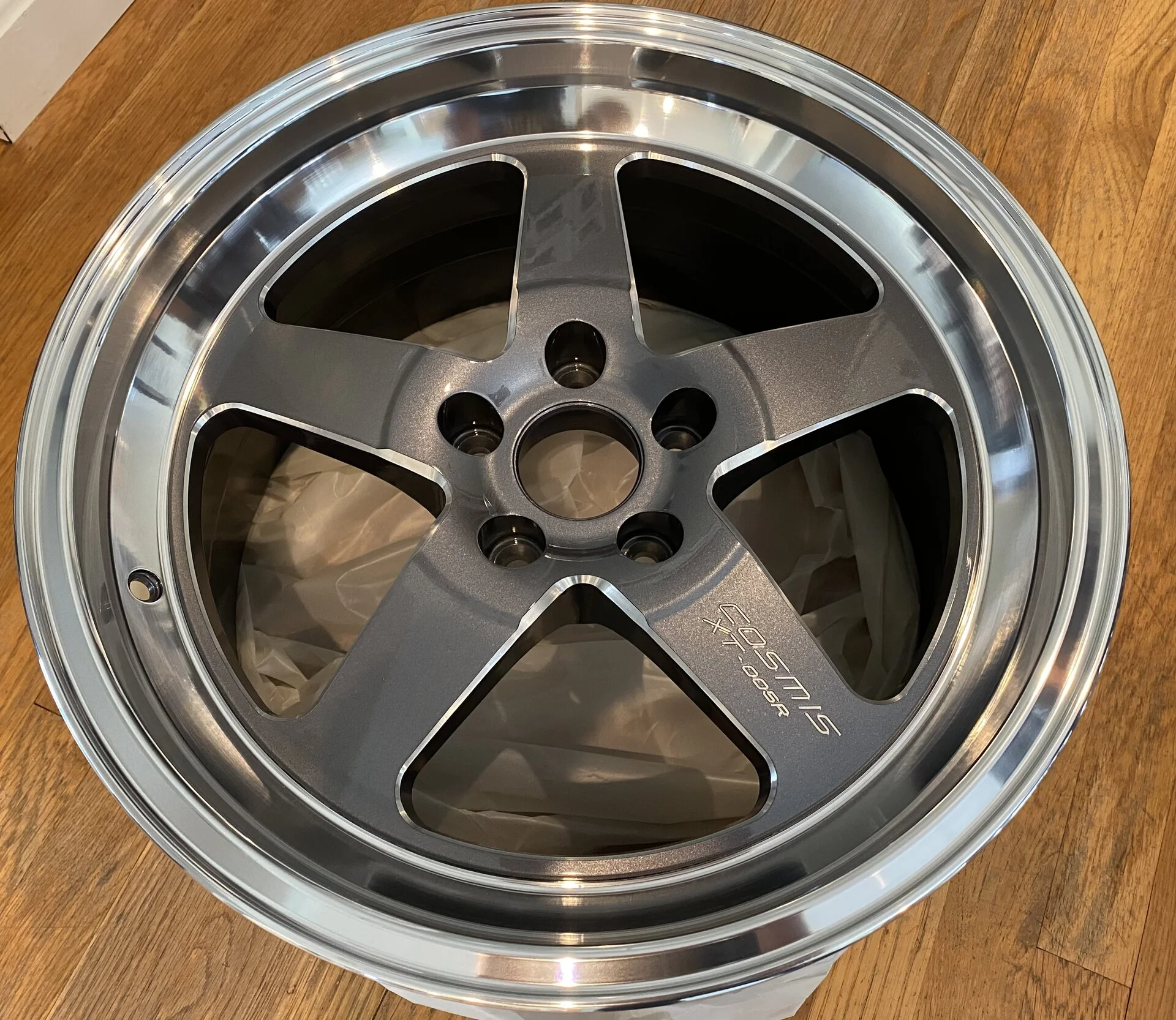

overall, I love the wheels. The c6 setup worked fine and fit perfectly. Plus I can swap wheels easily.
