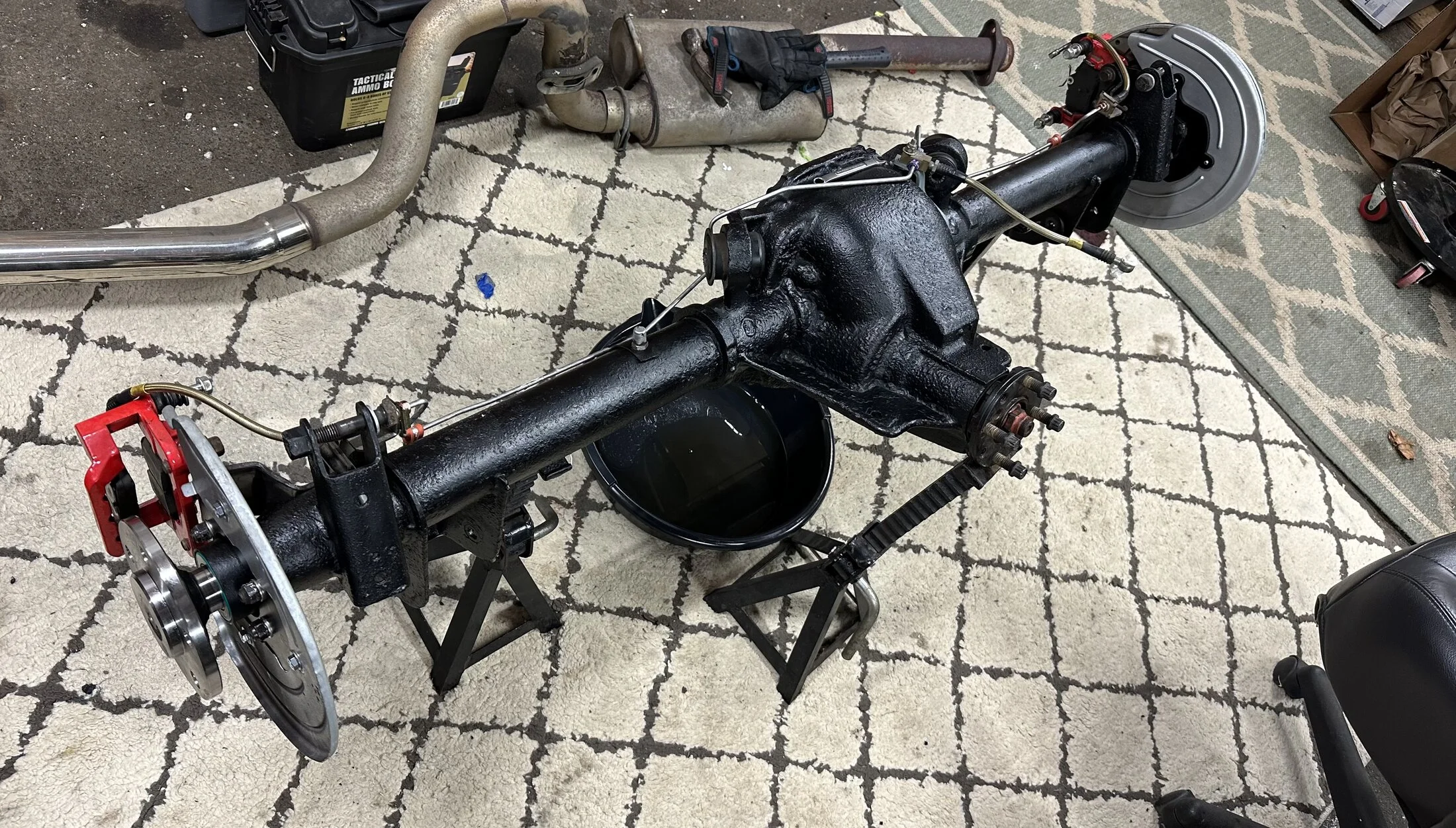

I ran the phb with both
control arms, I didn't really notice any bind. The rear did feel really solid cornering. Could it have been binding? I guess, not sure i would know what it felt like, but it sure didn't feel like snap oversteer which i have experienced.

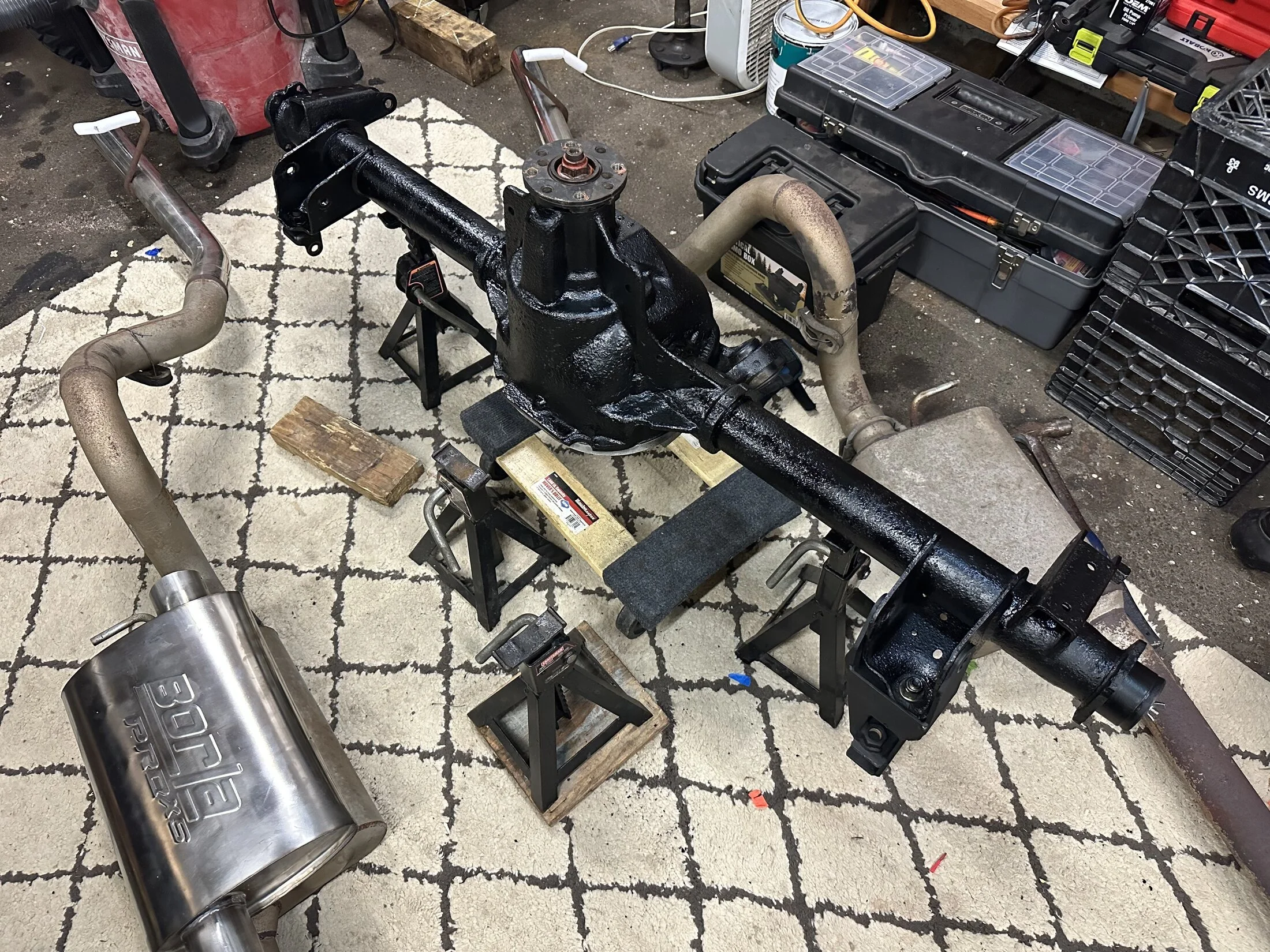

I'd just do it all now including the torque arm then finish the exhaust. The torque arm nearly installs itself if the
panhard bar is already on and setup correctly. I read the directions like 20 times, but most of it can be done with just common sense.
Sometimes i feel like MM directions make things like the PHB and torque arm seem daunting, but they really aren't.
Only thing is that i didn't weld mine, had a friend come over and do it.
Which was nice because now i know why i sucked at welding. Because i only looked at one gauge after i turned on the tank. Probably one of my dumbest mistakes ever. So i had the tank on, but not the valve to the welder!. Freaken amateurs...
I also used the heavier set of Torque springs as per their recommendation to match my front springs. Couple odds and ends to finish up before i see how it all works on the street.
I have trouble believing one arm keeps the rear straight under load. If both tires hook i can't see how the rear isn't rolling on one side.
