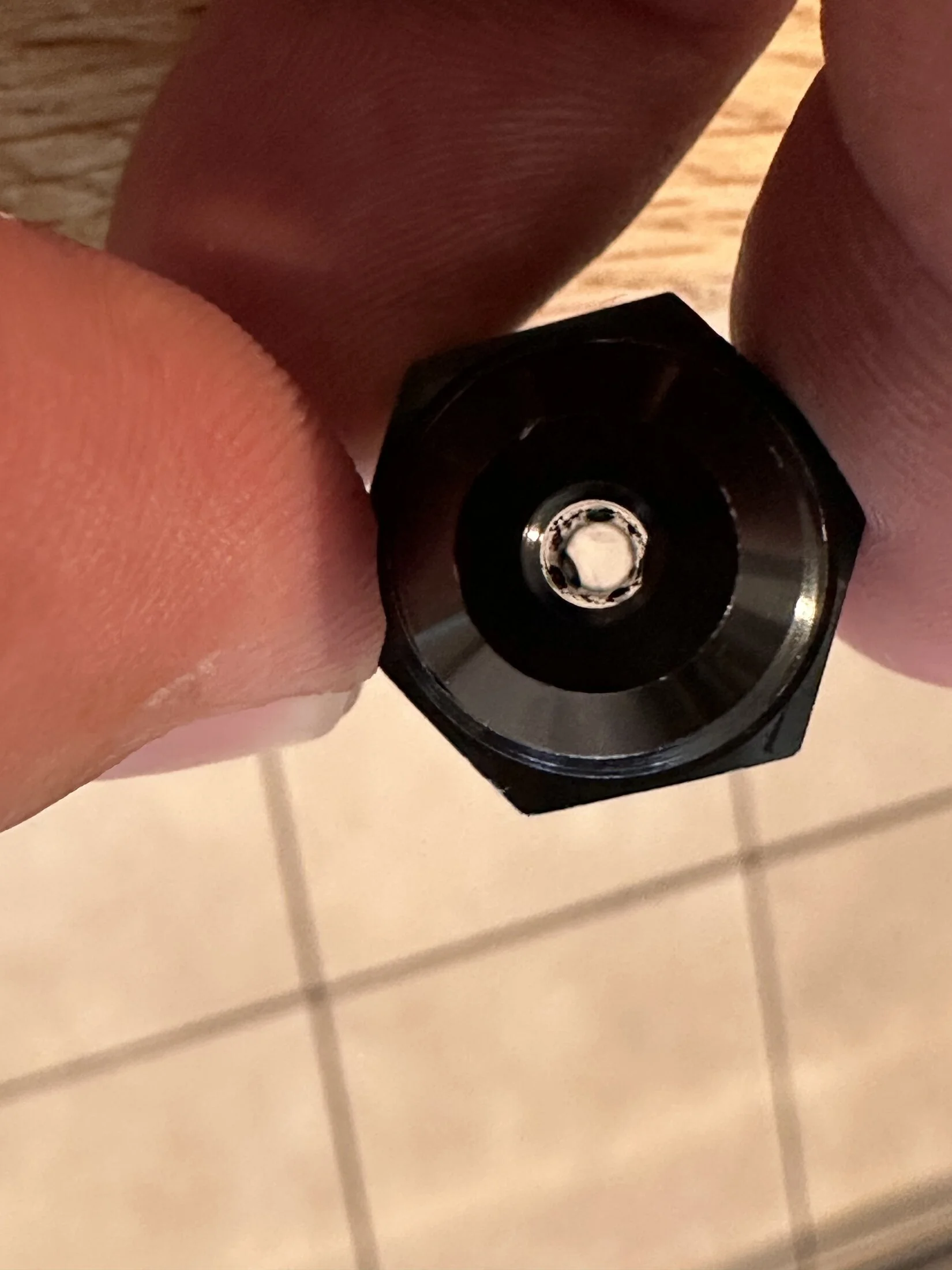

Took the reservoir off. Here’s the fitting.
I ordered a 6AN to 1/8” not fitting to mount in the side. I think that’s the route to go. I will drill this a bit more open though

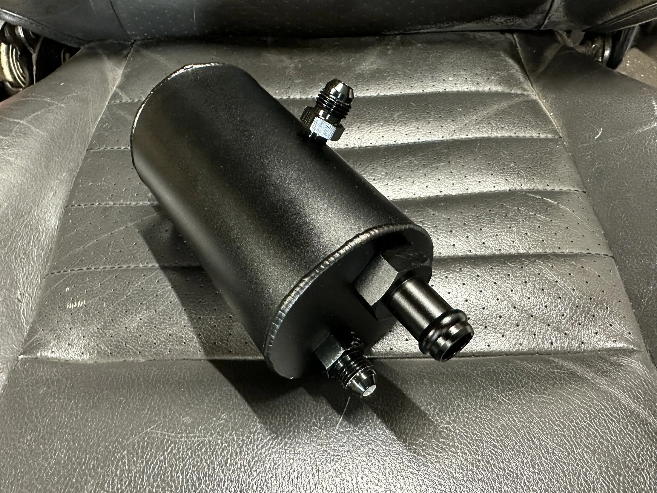

Fittings arrive. Drilled out the fitting for the return for the steering rack. There’s a diffuser inside so I think I can allow a little more flow. I don’t want the pump to strain too much.

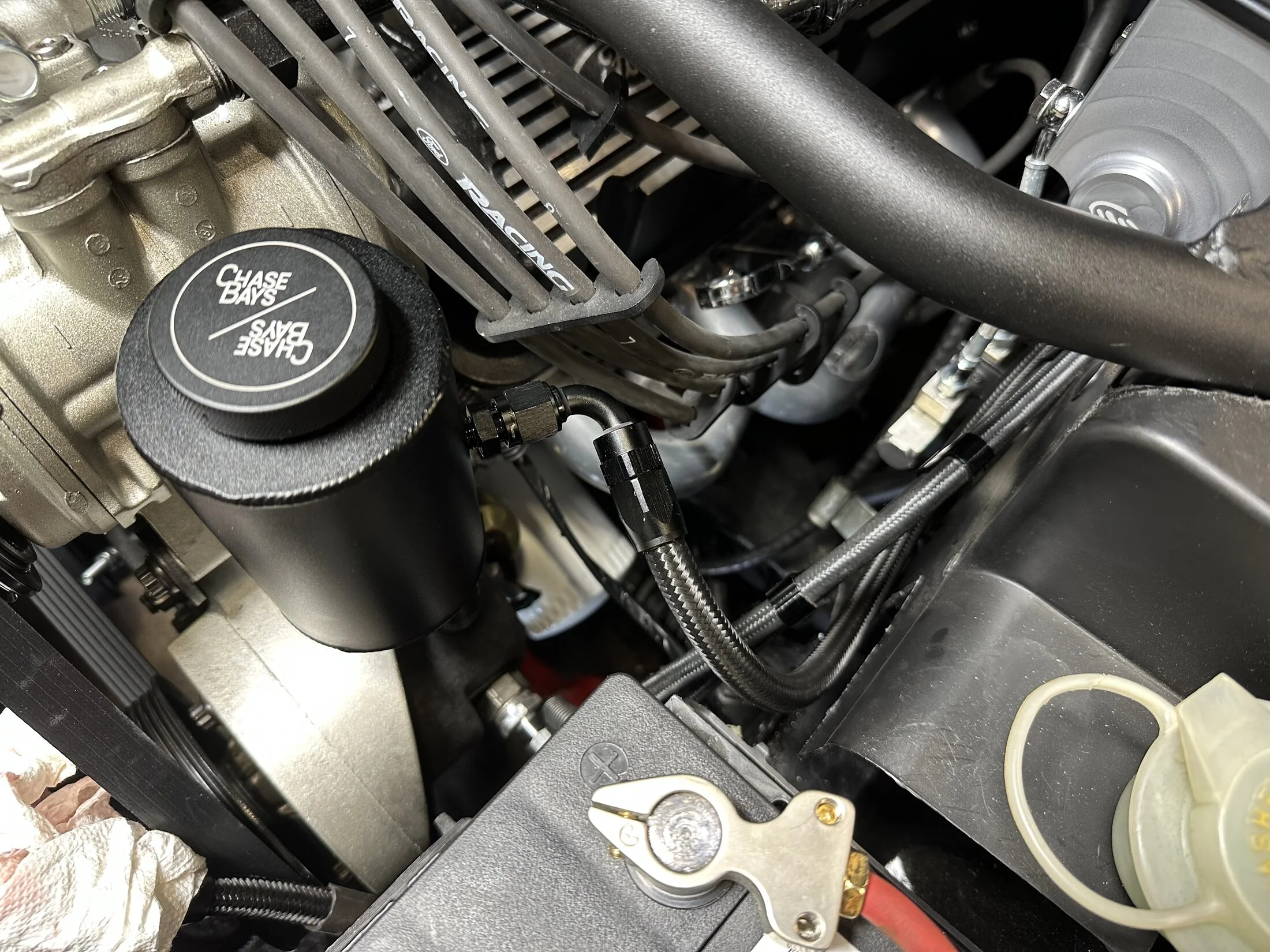

Drilled and tapped for the hydro return on the side of the bottle. I want zero backpressure on this line so I chose to just give it its own port. I could have also tapped on the bottom but real estate was tight there
I redid the plumbing for the hydro return.
Had to order. 45* fitting for the steering rack return. Should be here in a few days. Then bleed and test.

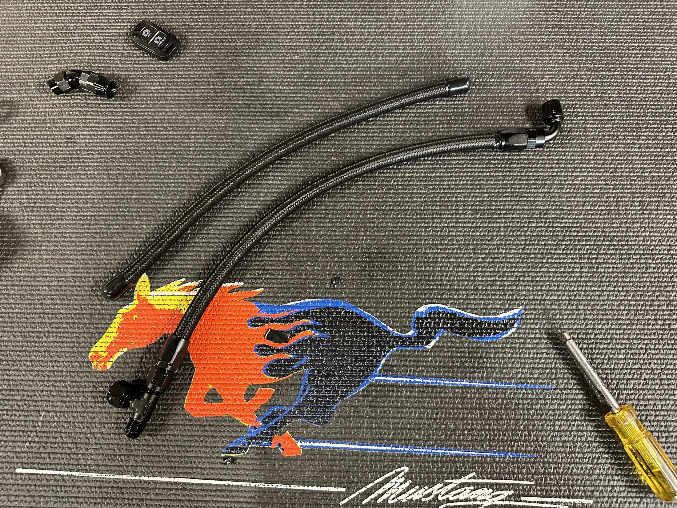

60* fitting arrived today. Perfect angle for clearance under the bottle and away from the brackets and down towards the rack.
But now the hose is 1” too short
I could use a short peice, use two straight couplers and a Union, but I’m adding more complexity and leak points.
A new longer hose was $17. Shipping…a week. Grrr.
I gotta do it right with the least amount of fittings/failure points, so we continue to wait.

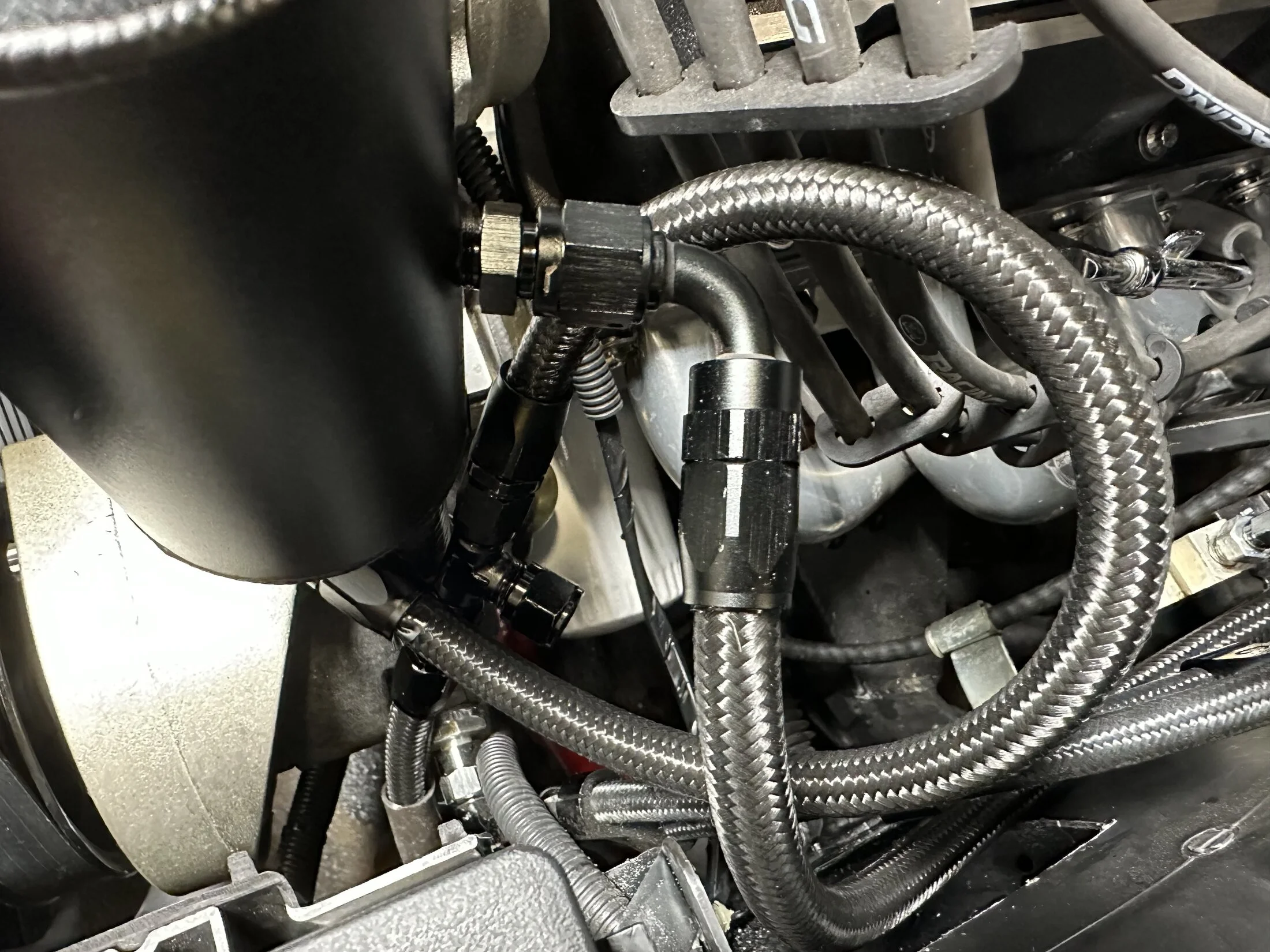

Cobbled up a temp line with what I had.
90* will connect to the reservoir, and the other end will connect to the line going to the power steering cooler. That line is on the car and already has a straight coupling. Should work for short term testing.
When i get the new cut of hose, it will be one continuous piece, connecting at the PS cooler and then one fitting into the bottle. Less potential leak points since it will be one fitting, vs 5

Success. Just went for a drive and braking performance is much more improved. Now it stops without too much effort!
My temp hose layout. Not ideal but gets the car driveable. I’d be paranoid about one of those extra fittings working loose and spraying the header with Type F. That’s why I want minimal fittings

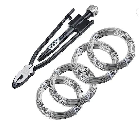

An fittings typically don't work loose. Most racers change all the brake lines from 45 degree double flares over to 37 degree JIC fittings for reliability and ease of removal and reinstall. Military and domestic aircraft use JIC so that has to say something. Also, JIC fittings are not as high of quality as AN fittings.
Knowing you though (and believe me I understand) it will stay parked until it is done like you want it which is always very nice and done right. Glad you worked the issue out as there is nothing more frustrating than not so bueno brakes.
