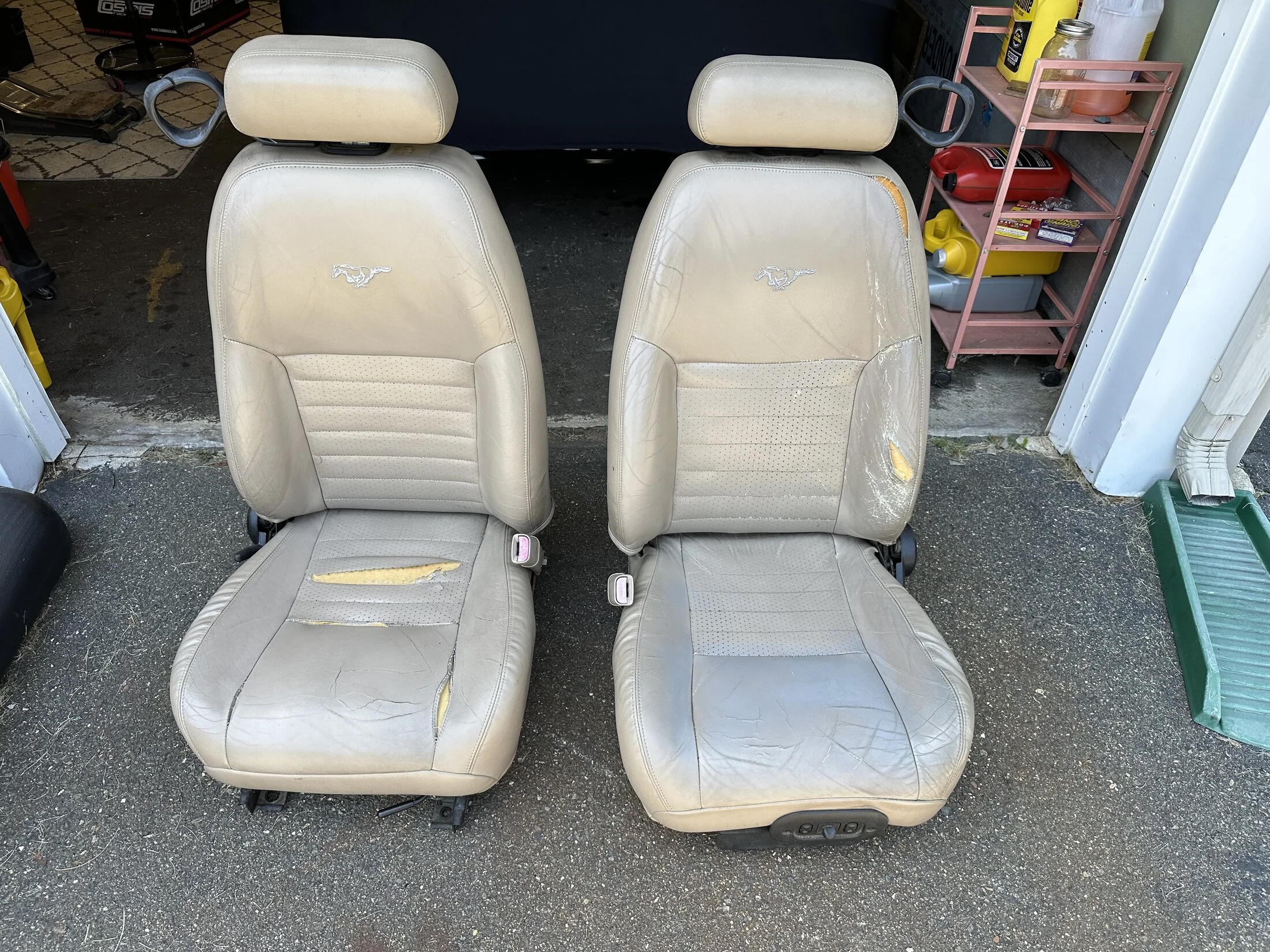

Gotta work my magic on these seat.

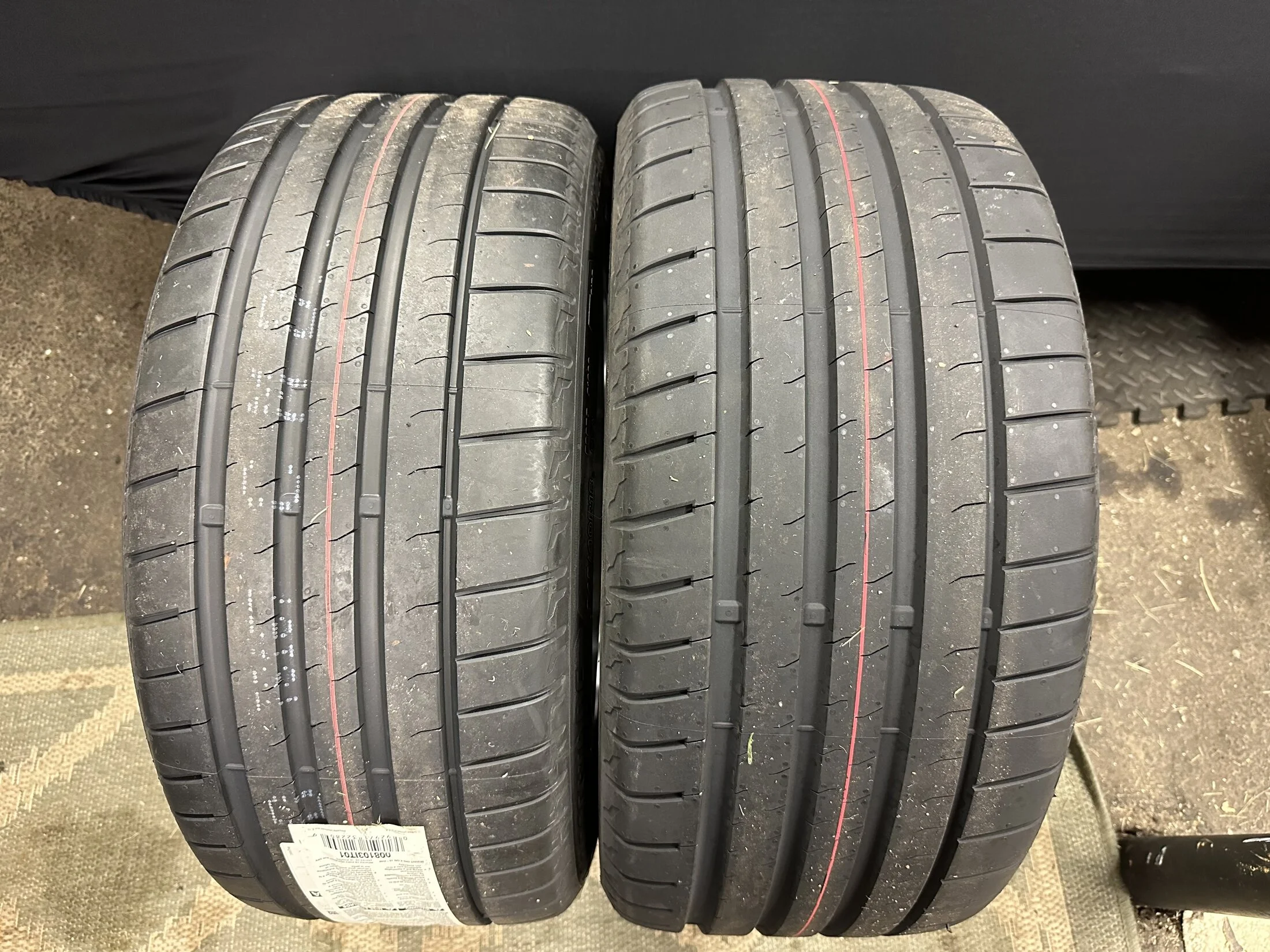

265/40/18 and 245/40/18.
The 265 is more square than I thought it would be. This just might fit as is with no spacers. Will test this out lasted tonight

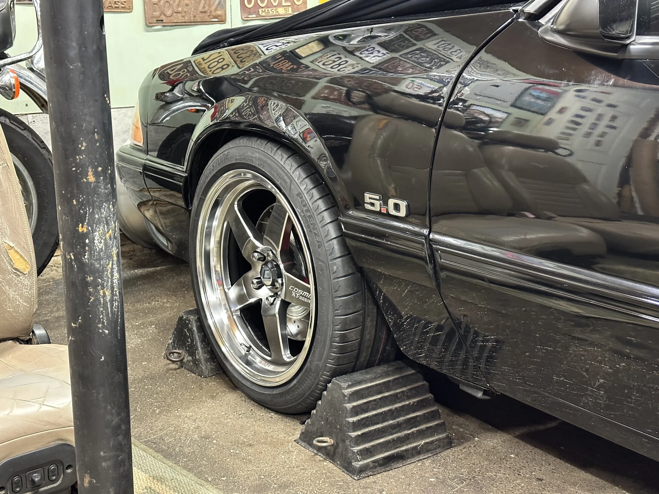

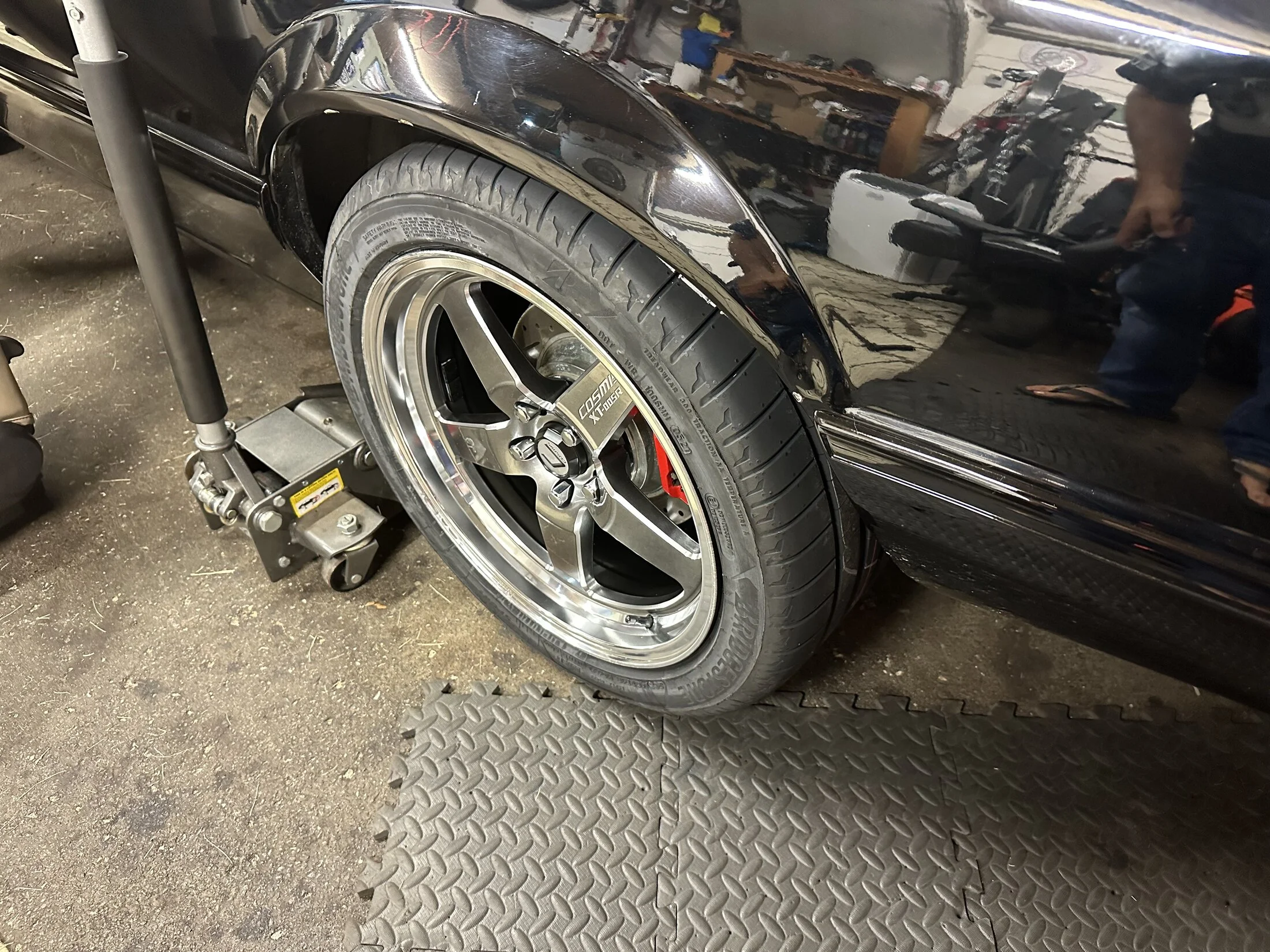

Wheel is on.

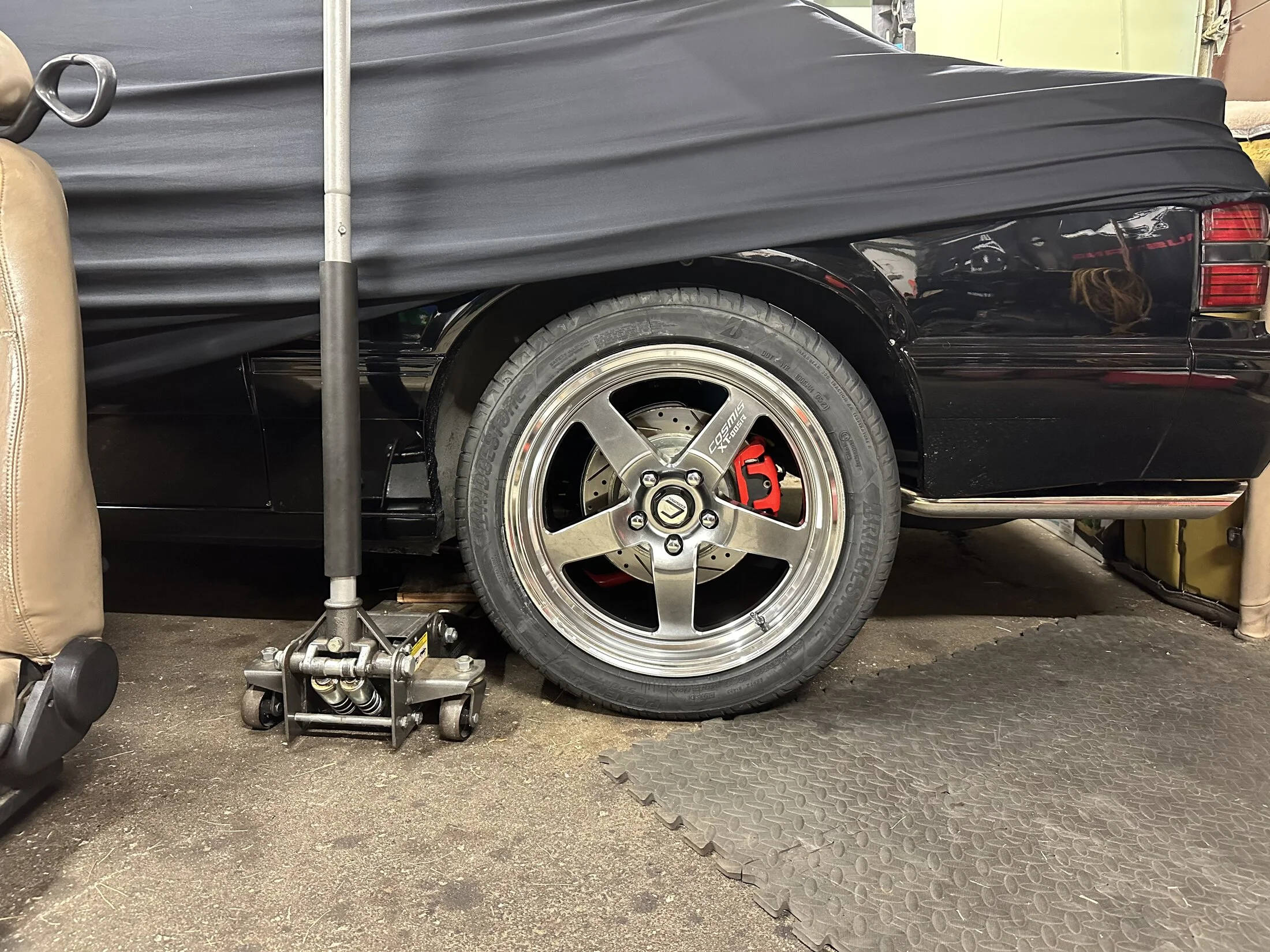

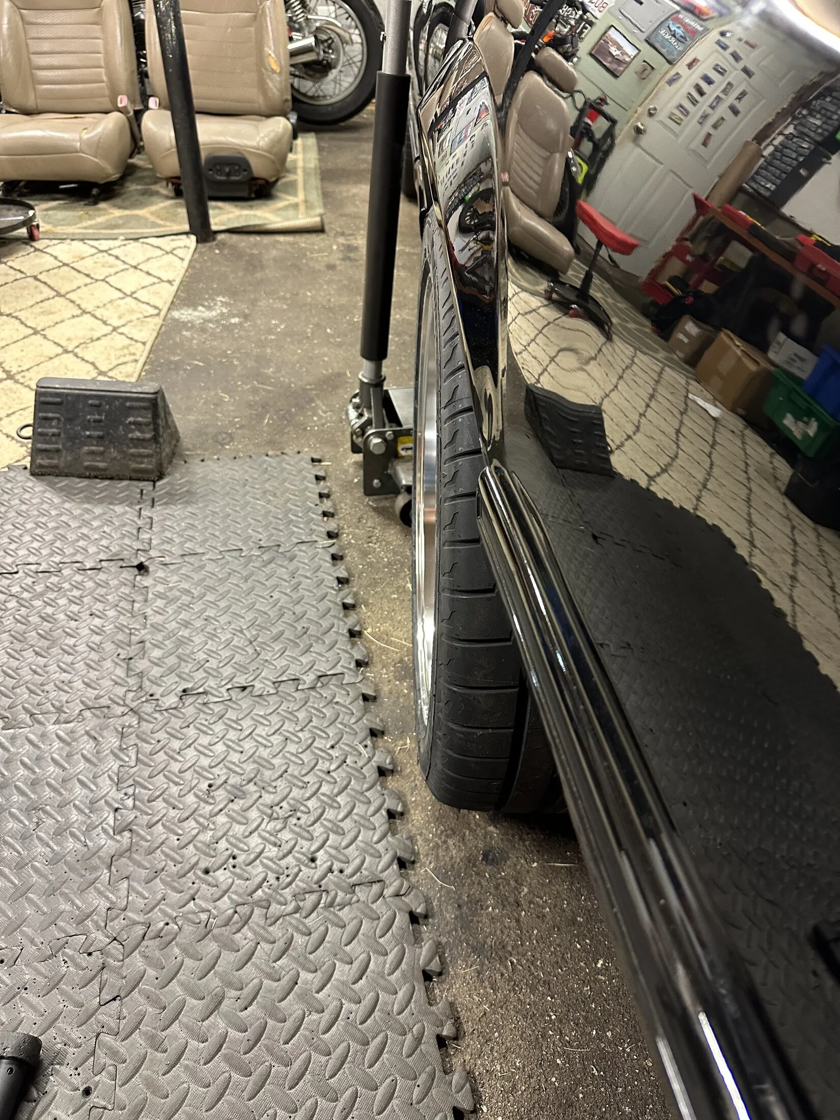

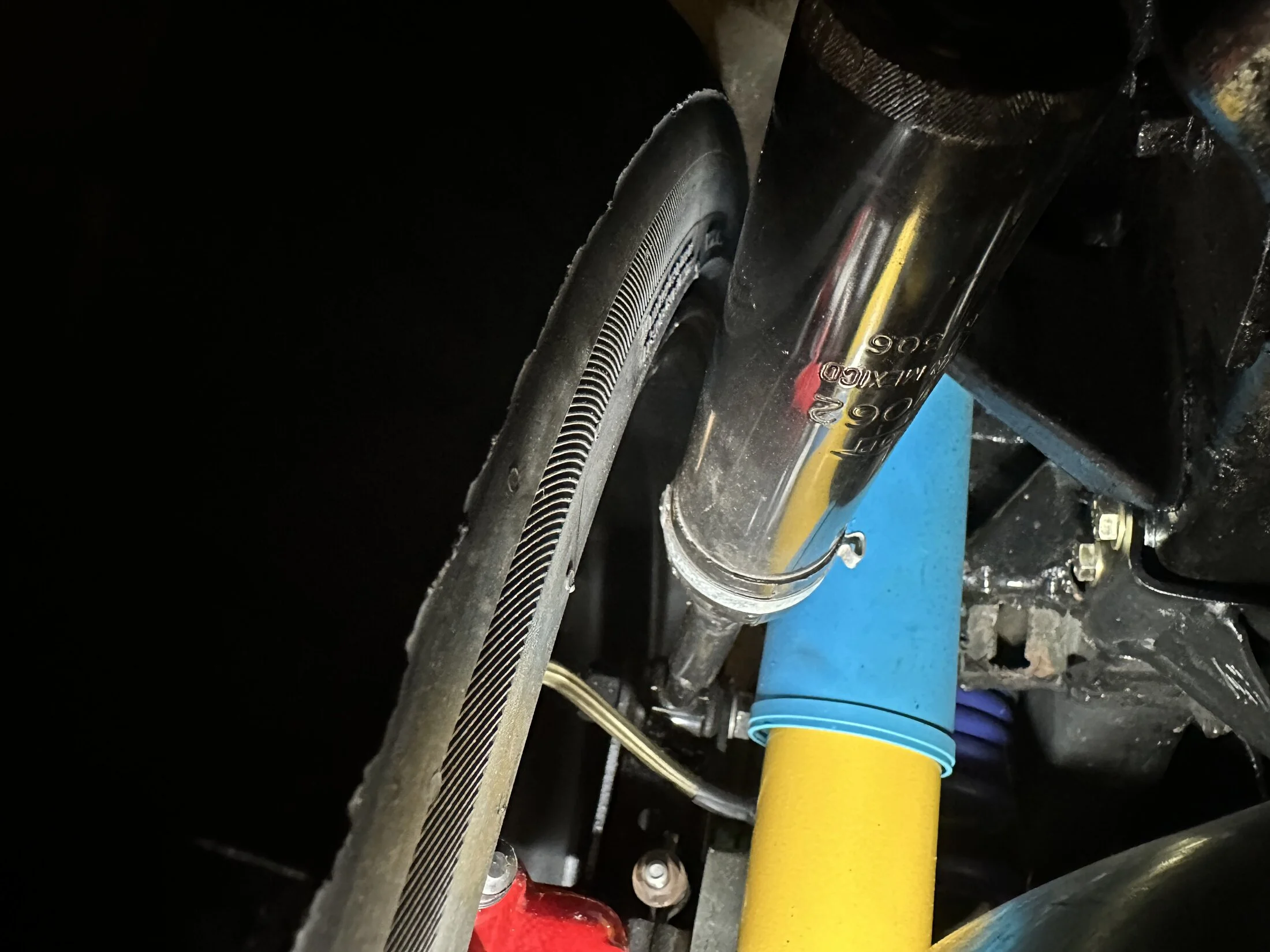

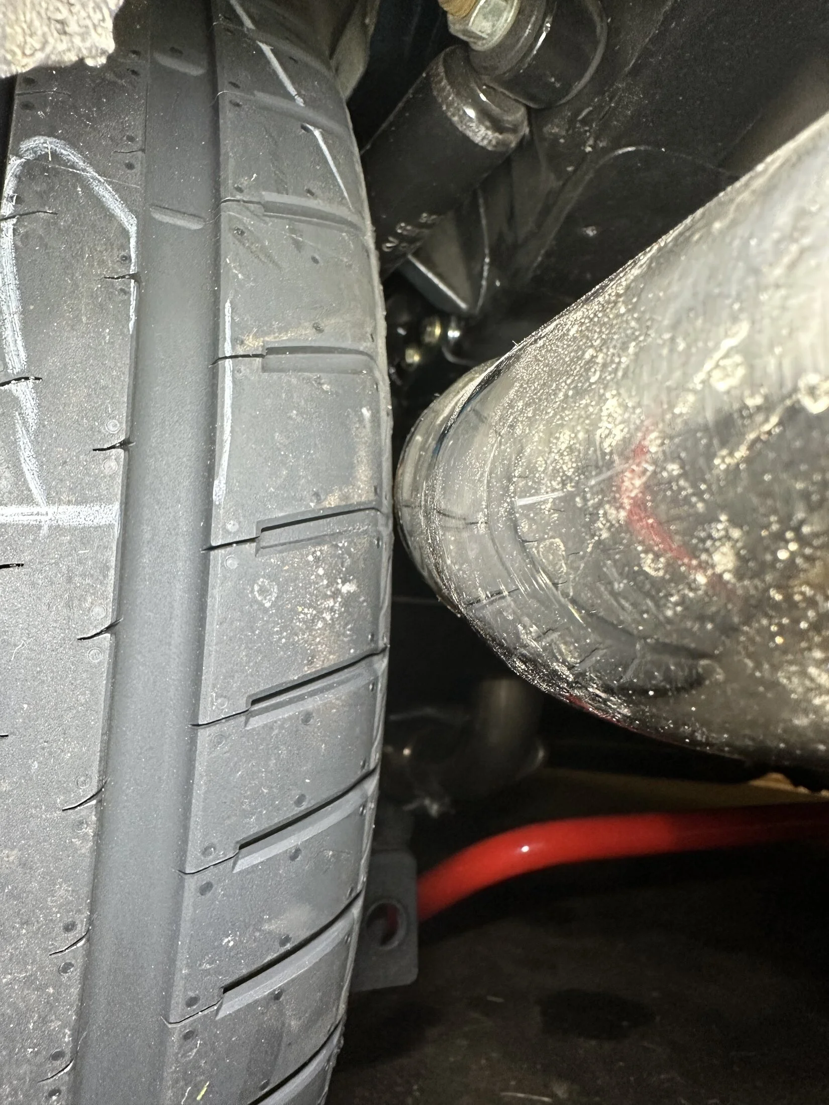

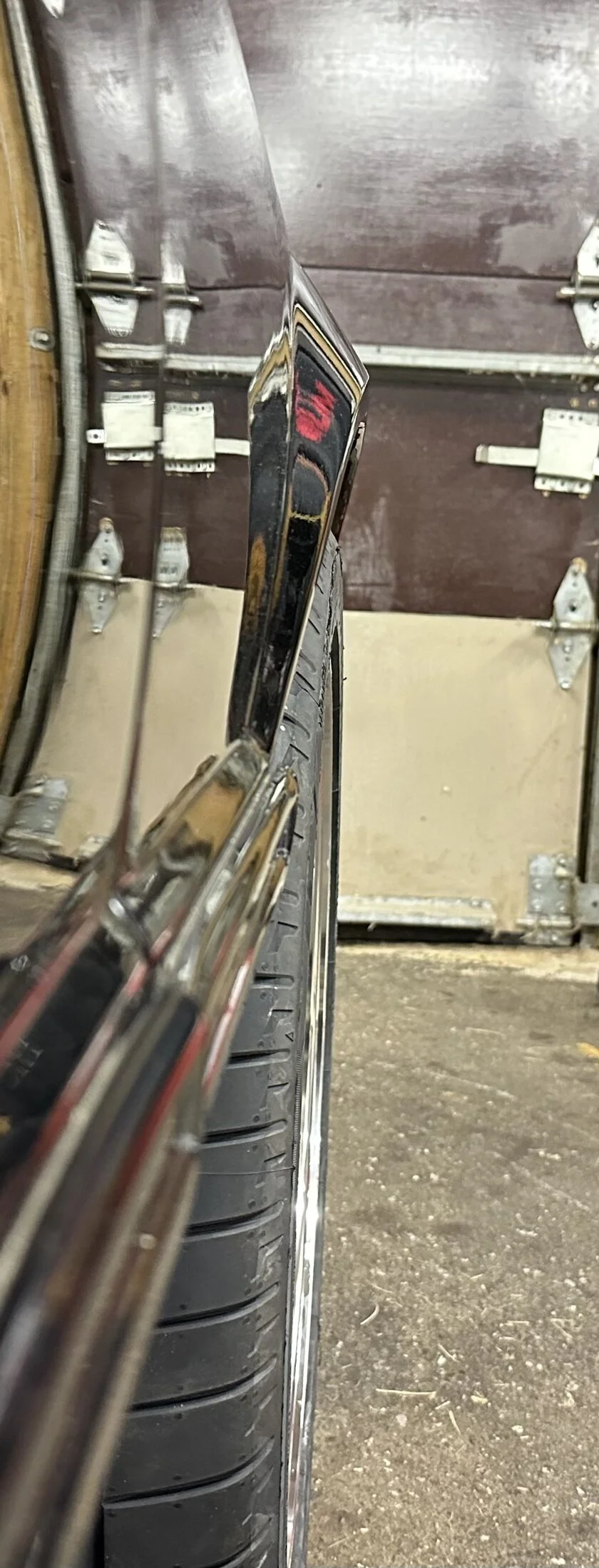

A little more sucked in than I’d like to see. I had to toss a 5mm spacer on. It hit the tailpipes.
But with the 5mm spacer it’s looking pretty good.
Plenty of clearance on the quads
Just barely clears the tailpipes. It’s tight, but I might be able to cheat the tailpipe in some. Need to check other side and hopefully it’s the same.

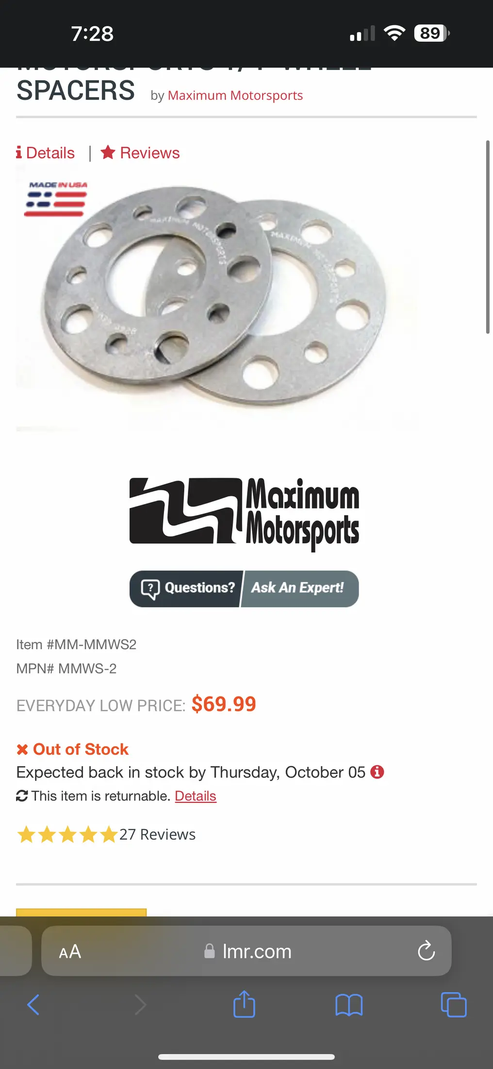

Gonna order up the MM 1/4” (6mm) spacer. I have ten turns on the lug nuts, so plenty for this size spacer. I trust the MM spacers.
I still think SN95 axles is the way to go here, but for now I’ll just get the wheels on just to get my obligation to Cosmis out of the way.

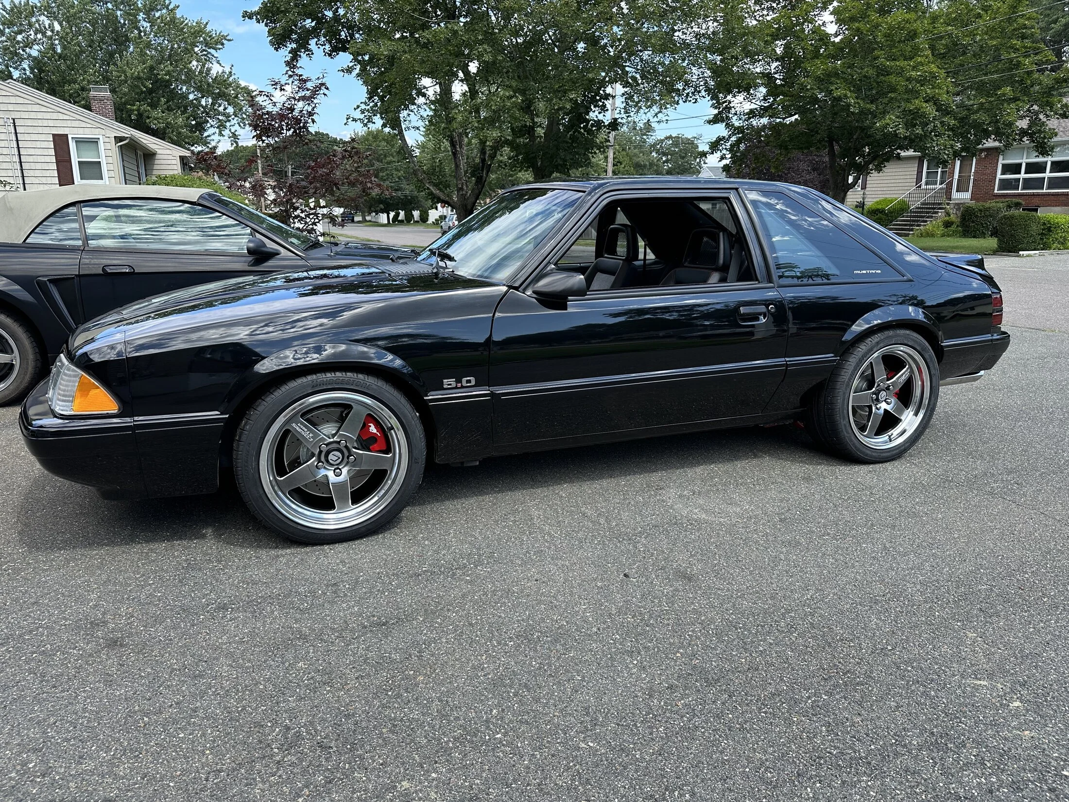

Played musical spacer tonight. 0.640” of spacers and I was able to catch 2-3 threads with the lug nuts
So if I went SN95 axles that would be 0.110” (2.5mm) more than this. I think I’m safe, especially where I don’t slam my car low.
Guess it’s axles swapping time.

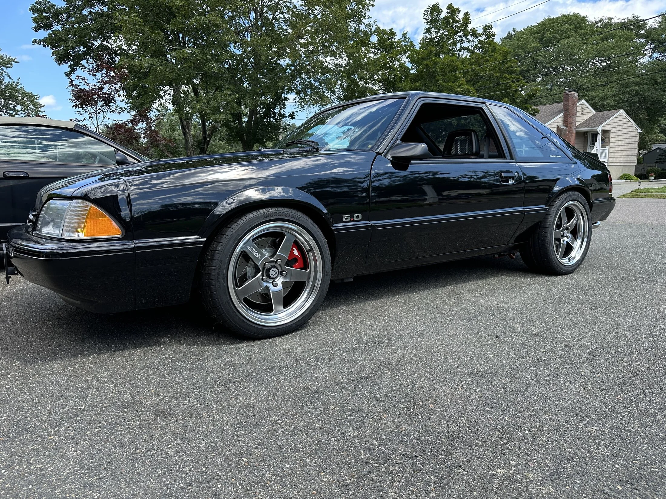

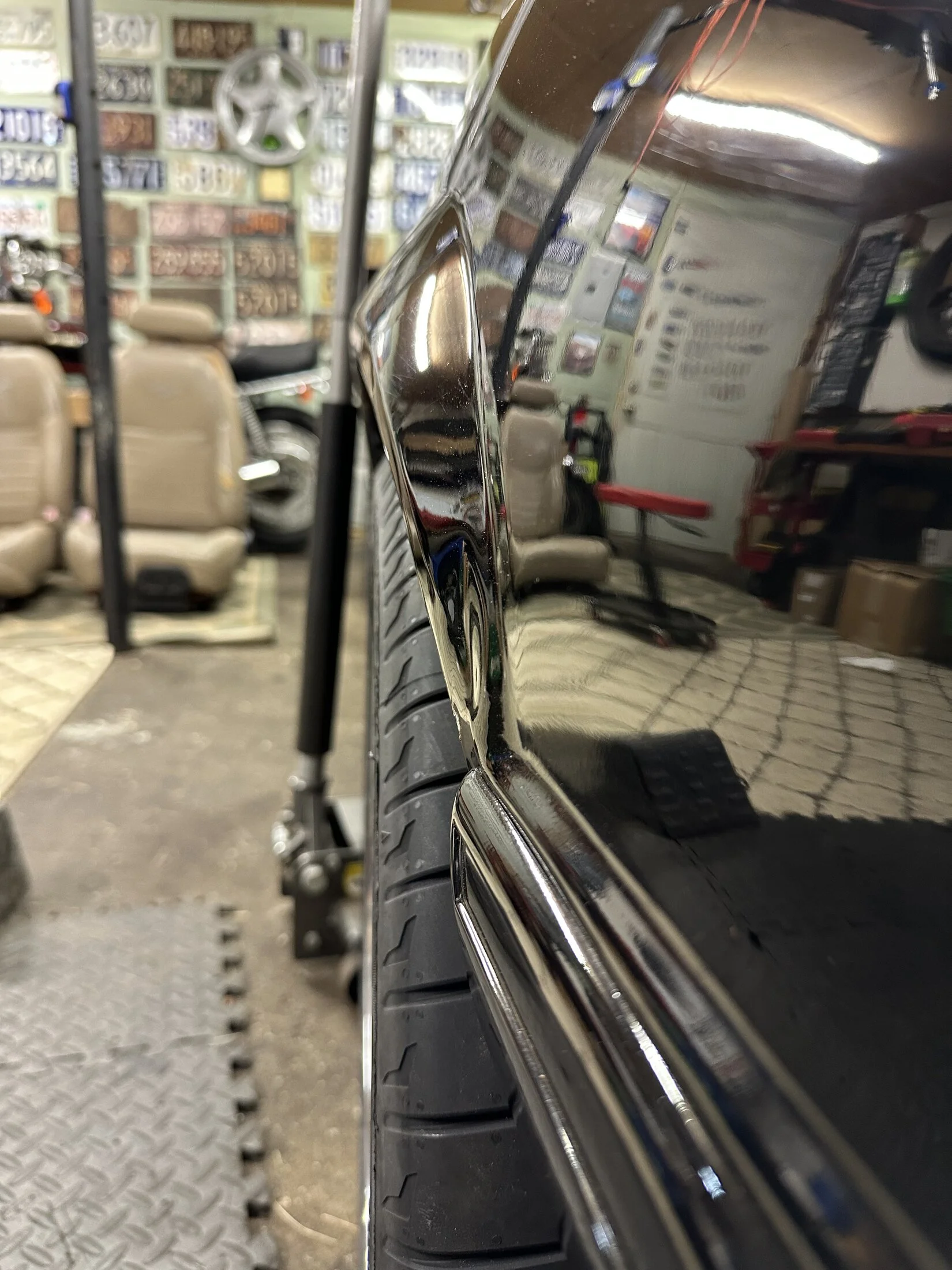

Also, played with the front fit a bit by adjusting camber and ride height.
I think this looks perfect. I might have to lower the rear 1/2”
Yes, car needs a wash, but at least thats proof i've been driving it!

SN95 axles installed. Just need some gear oil before I can go for a drive. But glad I didn’t mess with spacers and studs. This is perfect fit IMHo.

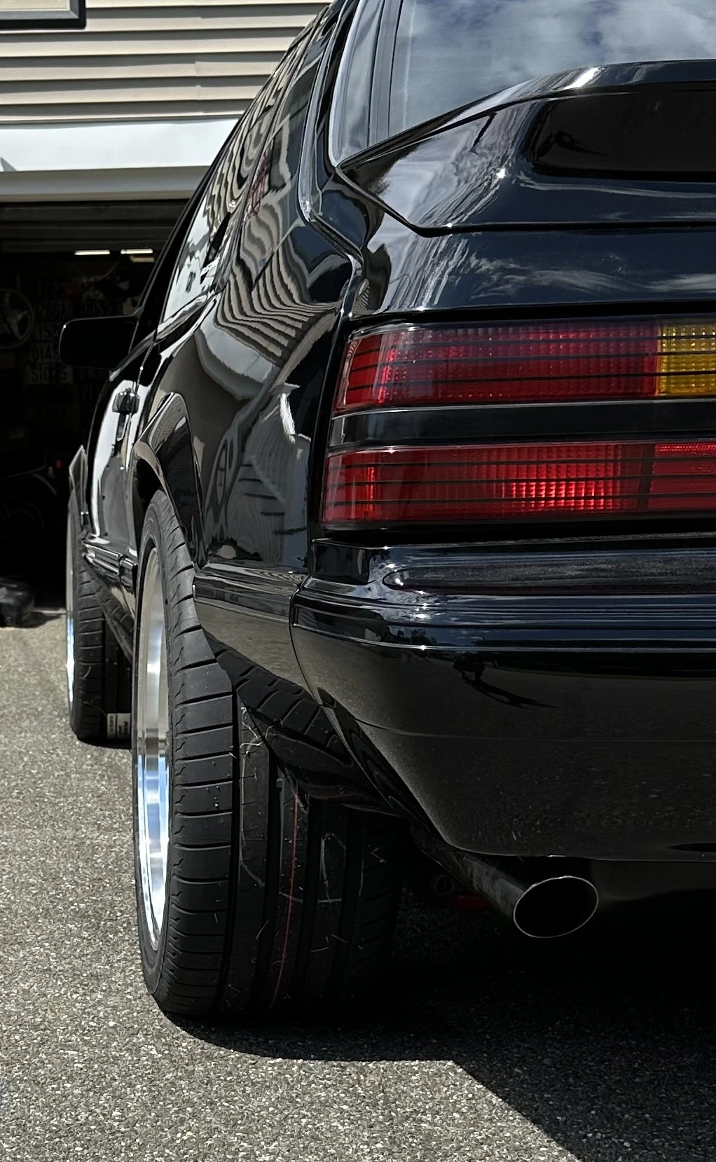

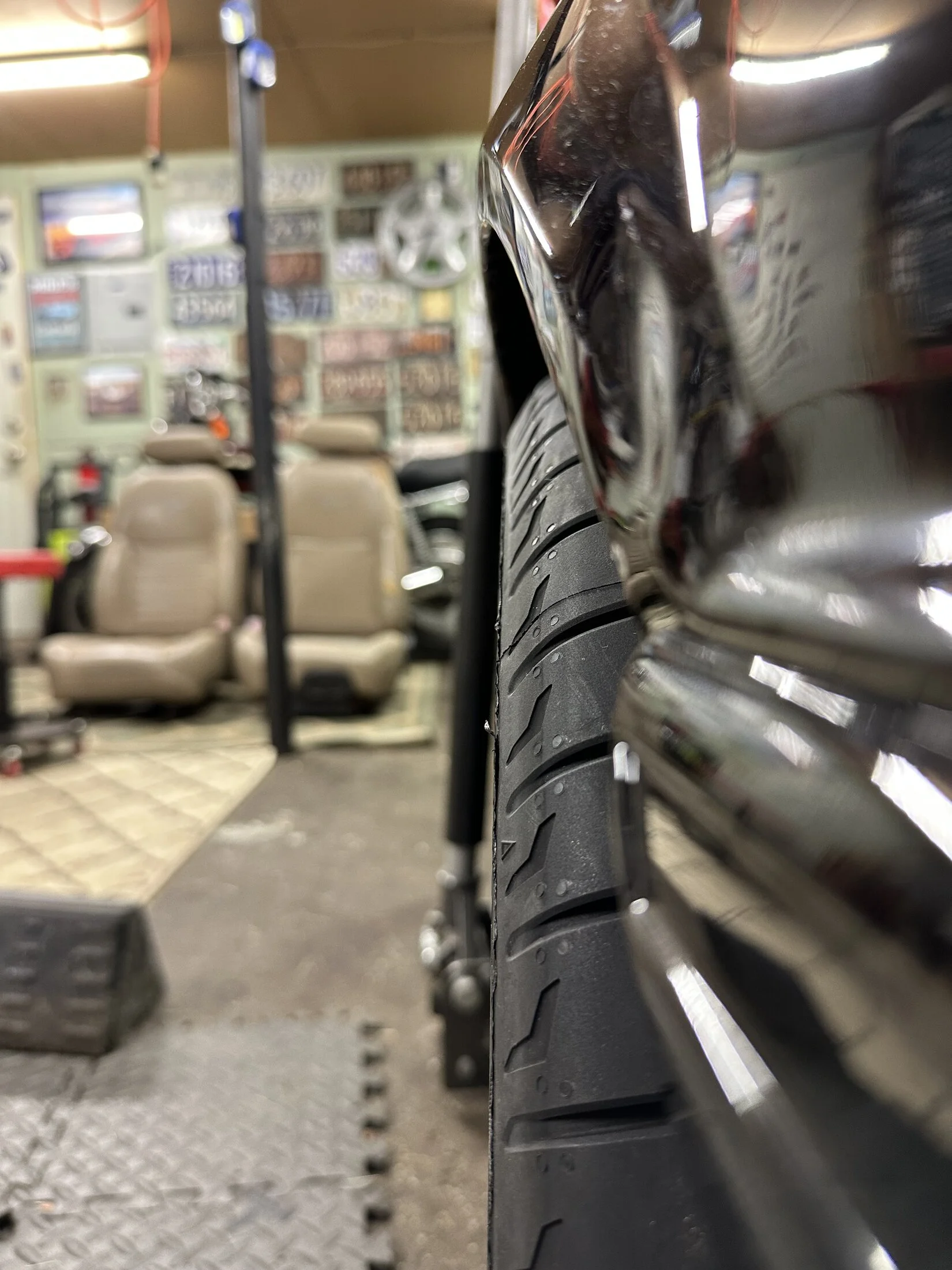

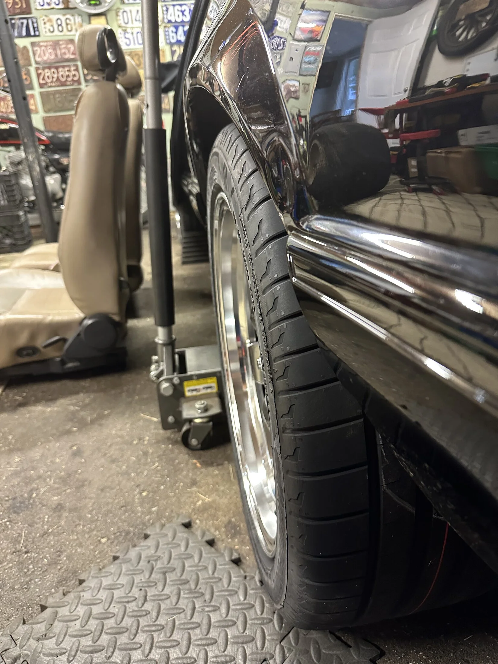

Definitely got the fit right. In hindsight I could have gone 275 out back, or possibly even 285. I could probably stick a 1/4” spacer on now and still be fine.
Didn’t drive the car due to no gear fluid but turned it around and amazed to see no front rub
