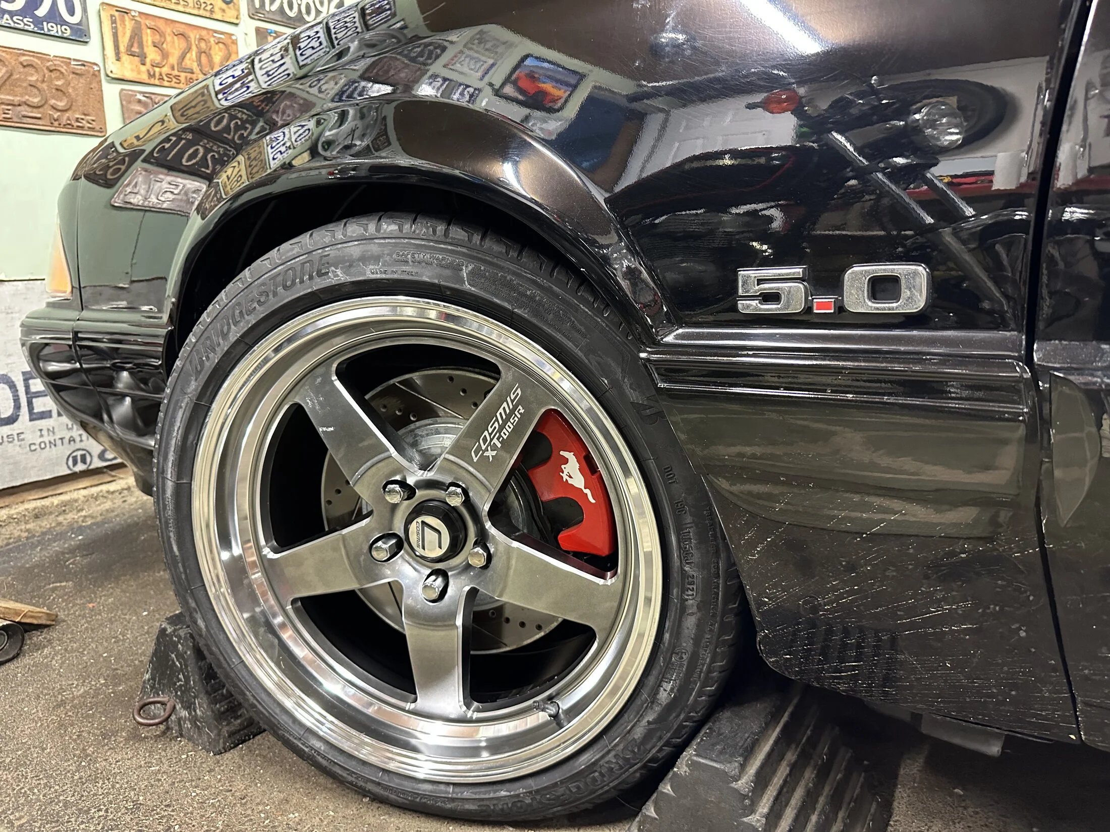

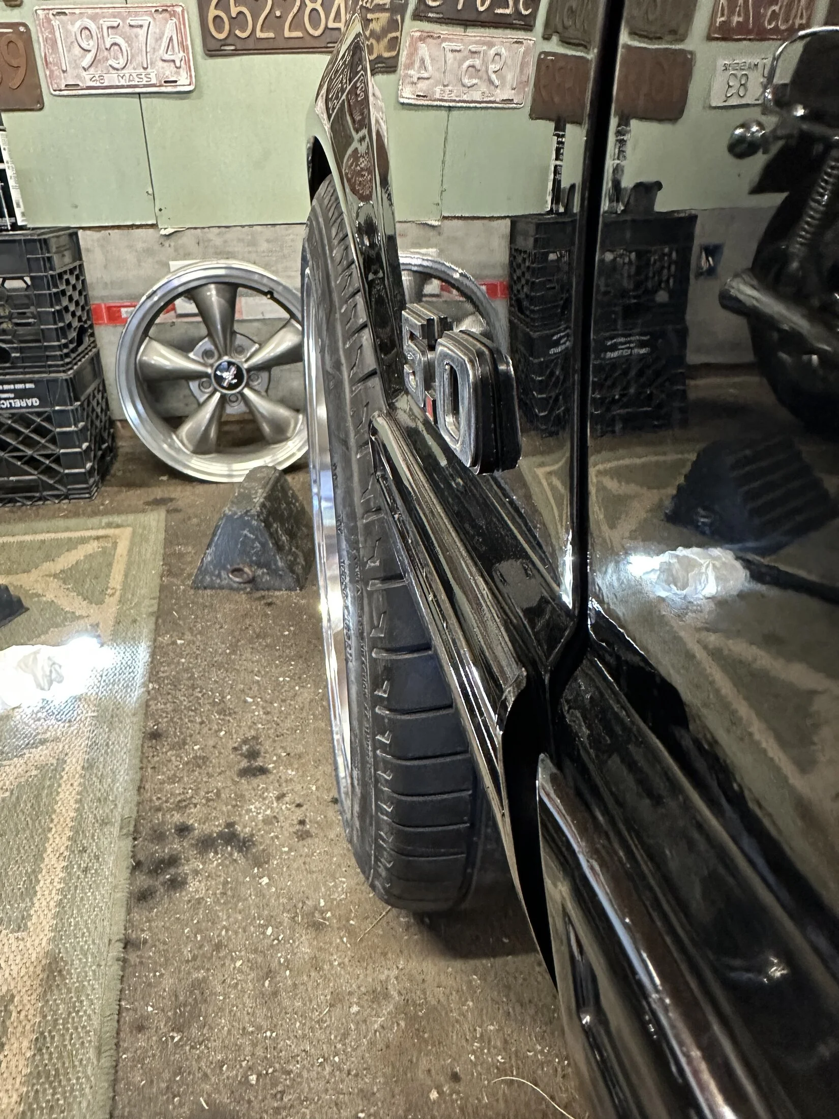

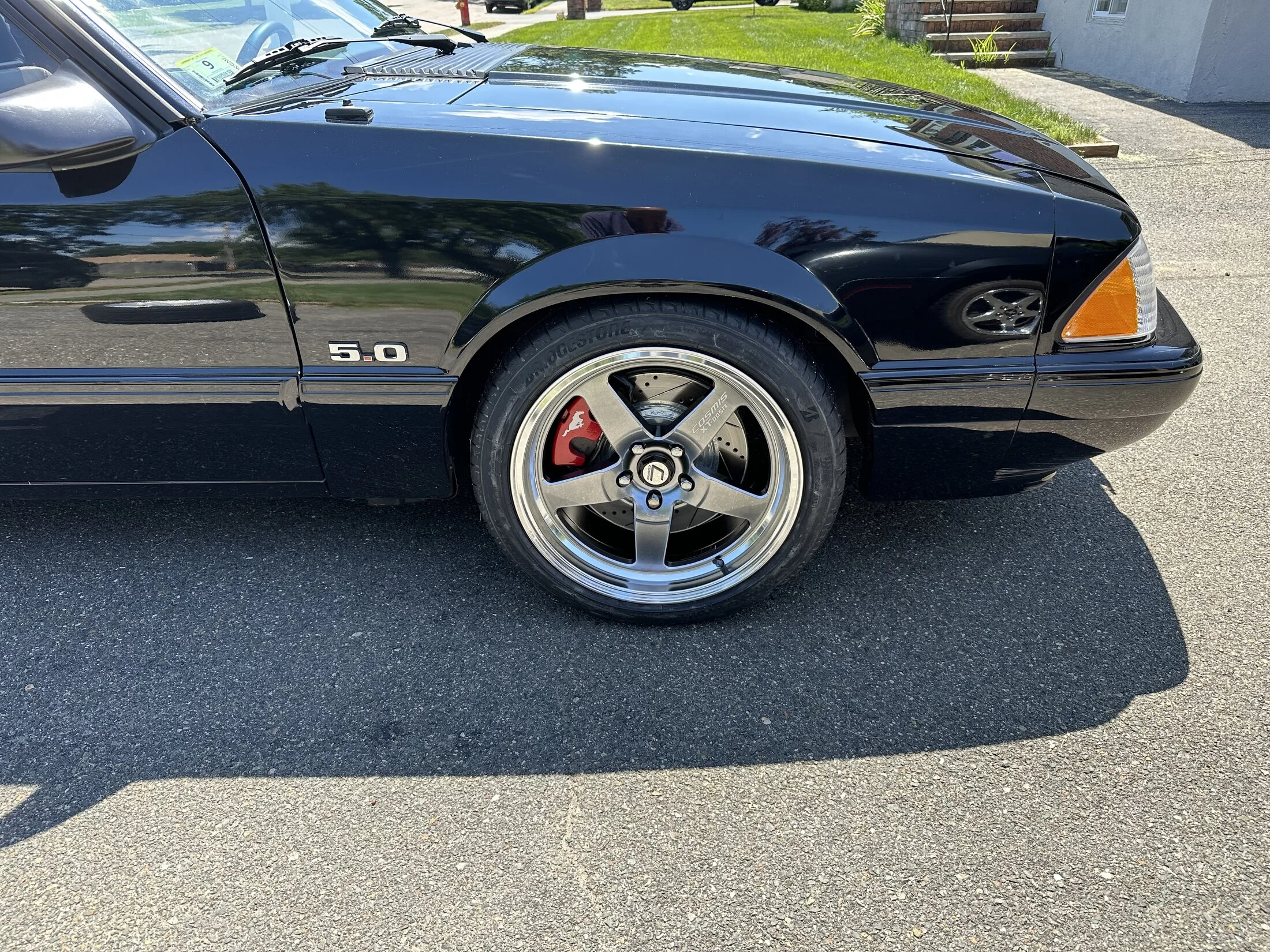

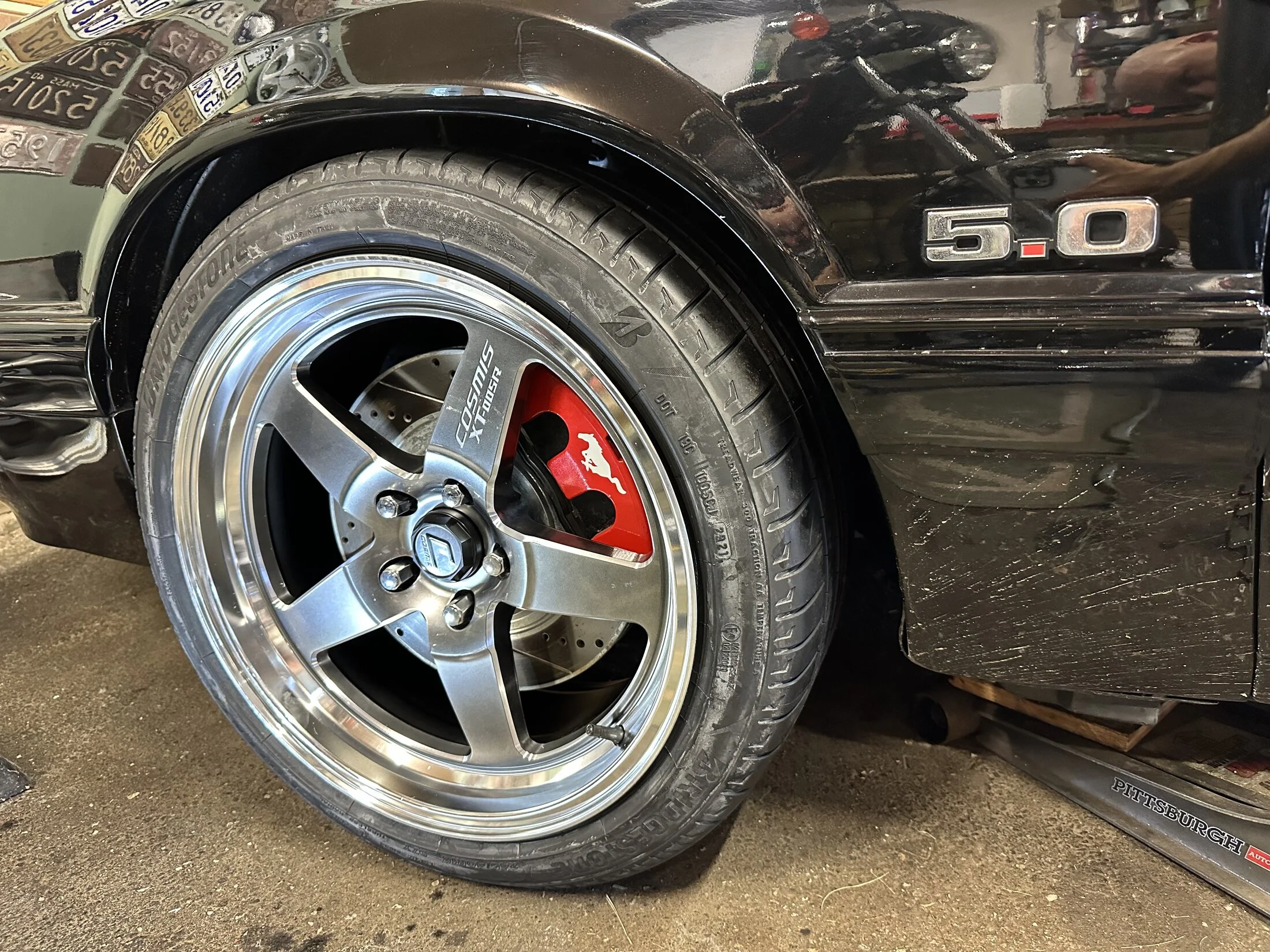

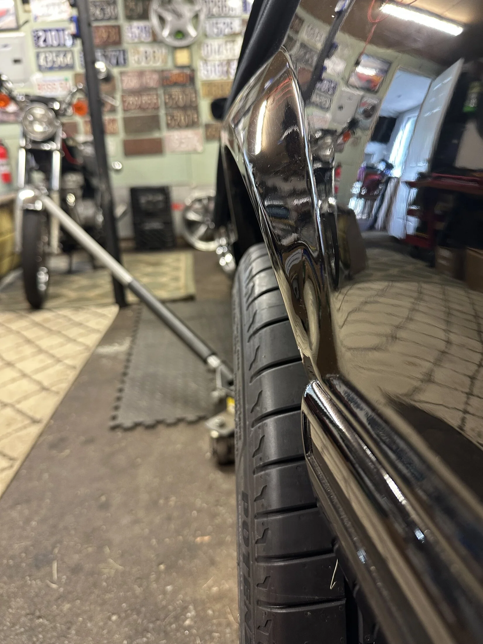

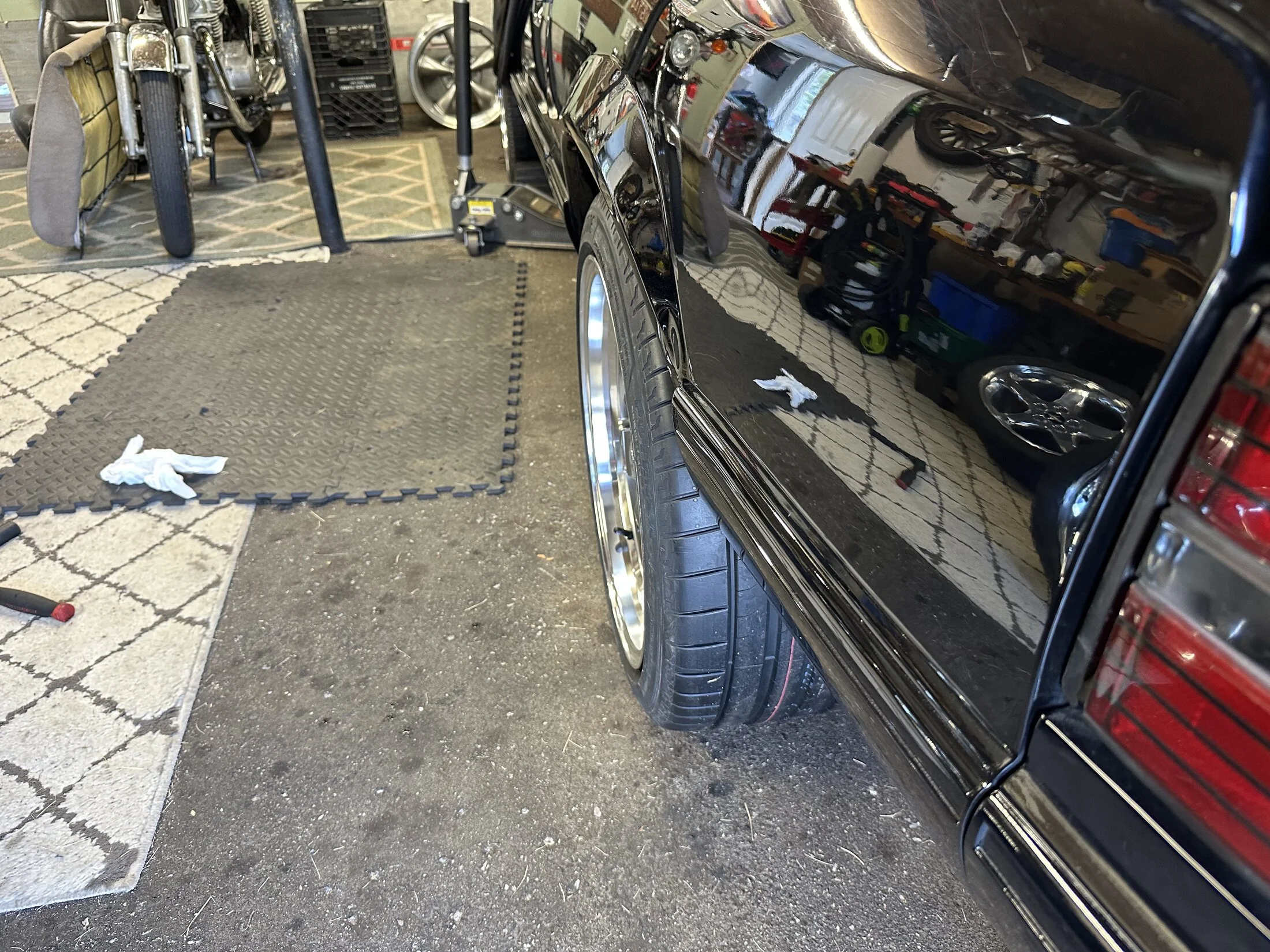

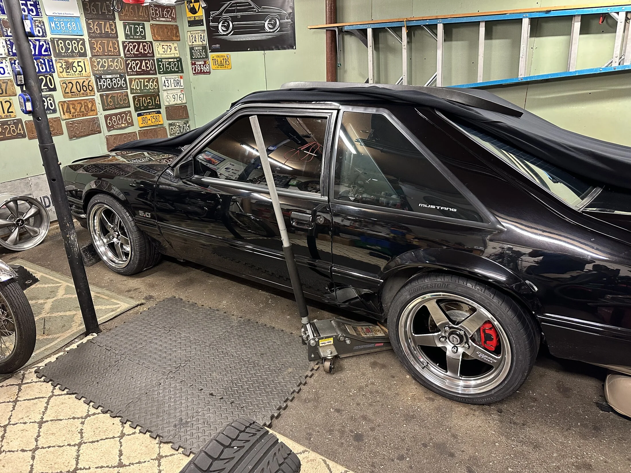

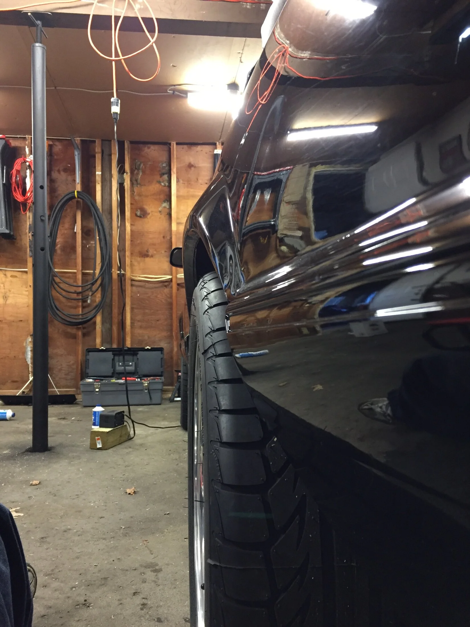

It's really more of a 94+ solid axle wheel. I think that's what's called out on their site. They cater to a few different makes and models so their offsets are for what's popular really. Since I have a fox, i have to pay a little bit more attention here.

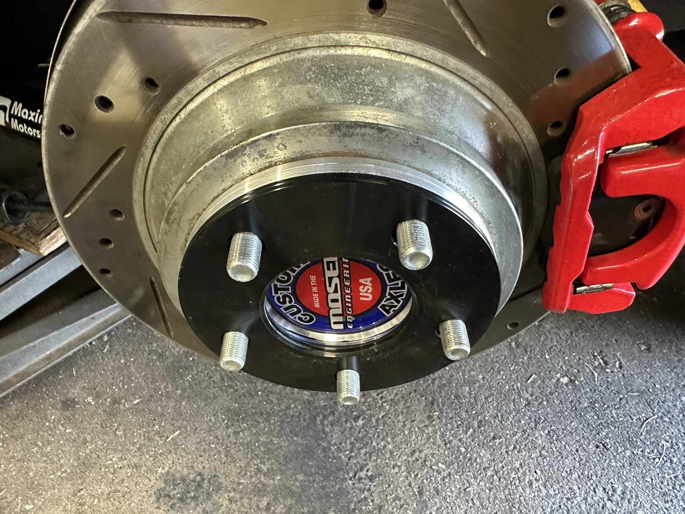

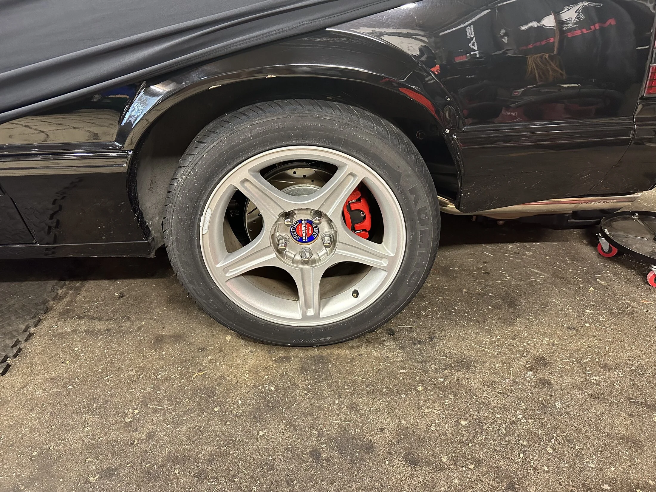

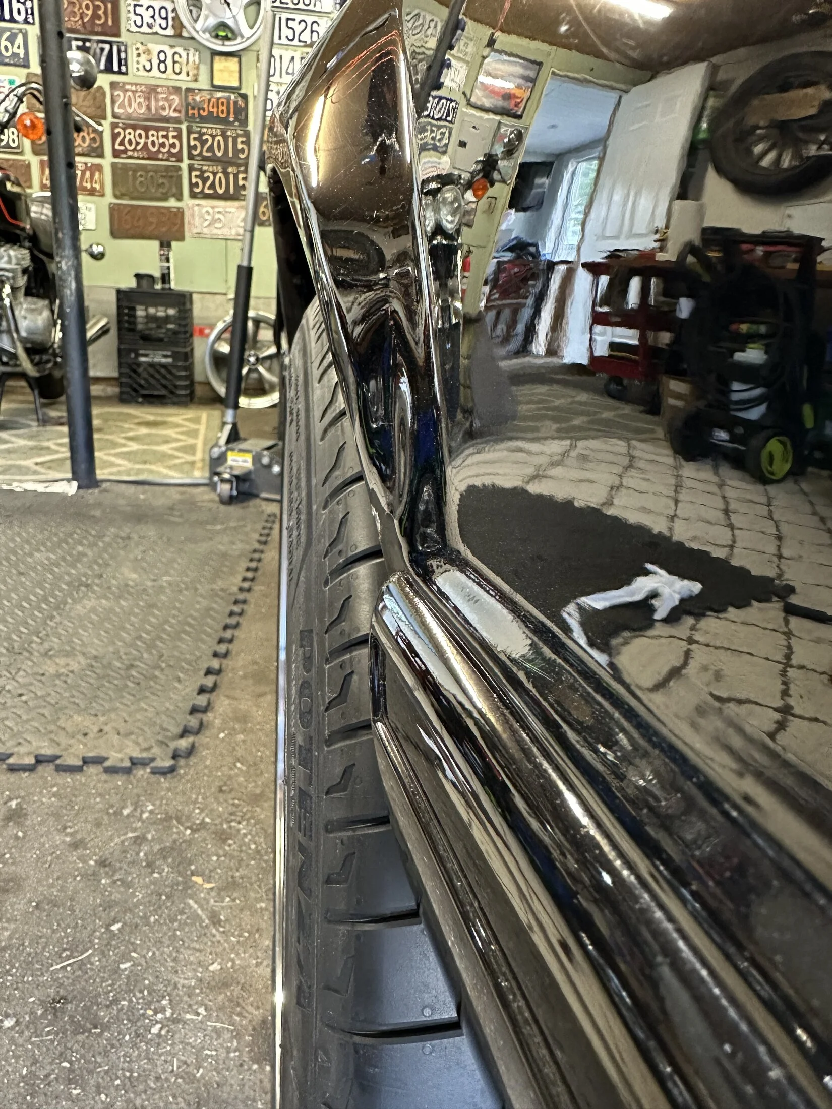

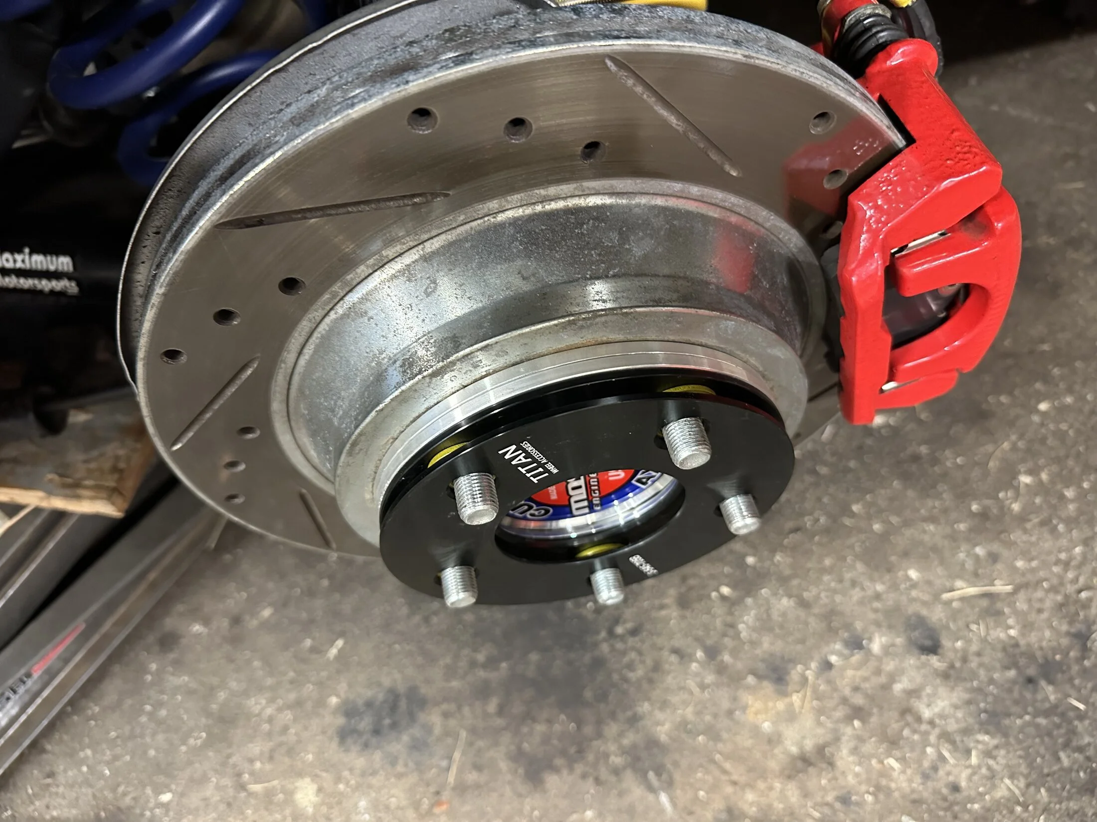

I think i can square the front away but adjusting the strut/spindle bolt angle, but out back it looks like i'm either going to go back to SN95 axles, or perhaps a 1/2" spacer and extended studs.
I ordered up some 1/2" OD washers to stack on the studs to simulate a spacer and test for clearance. I also think i'm going to run a 265/40/18 out back.
