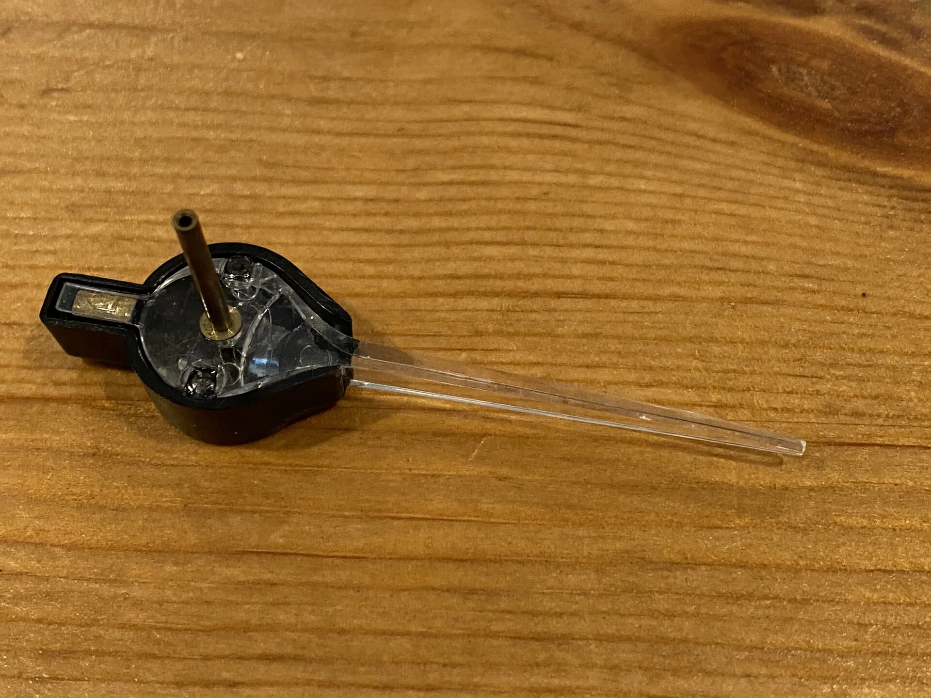

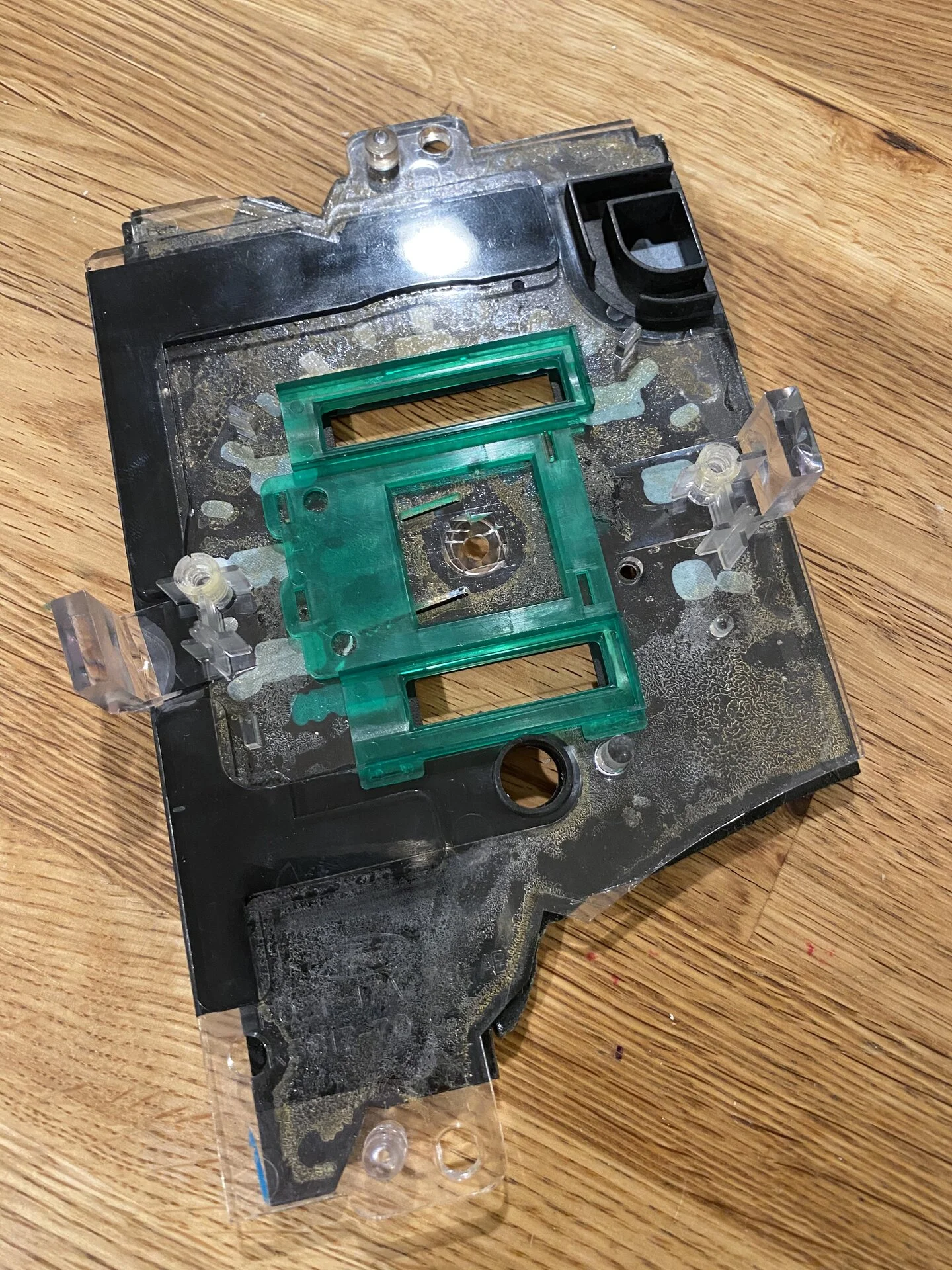

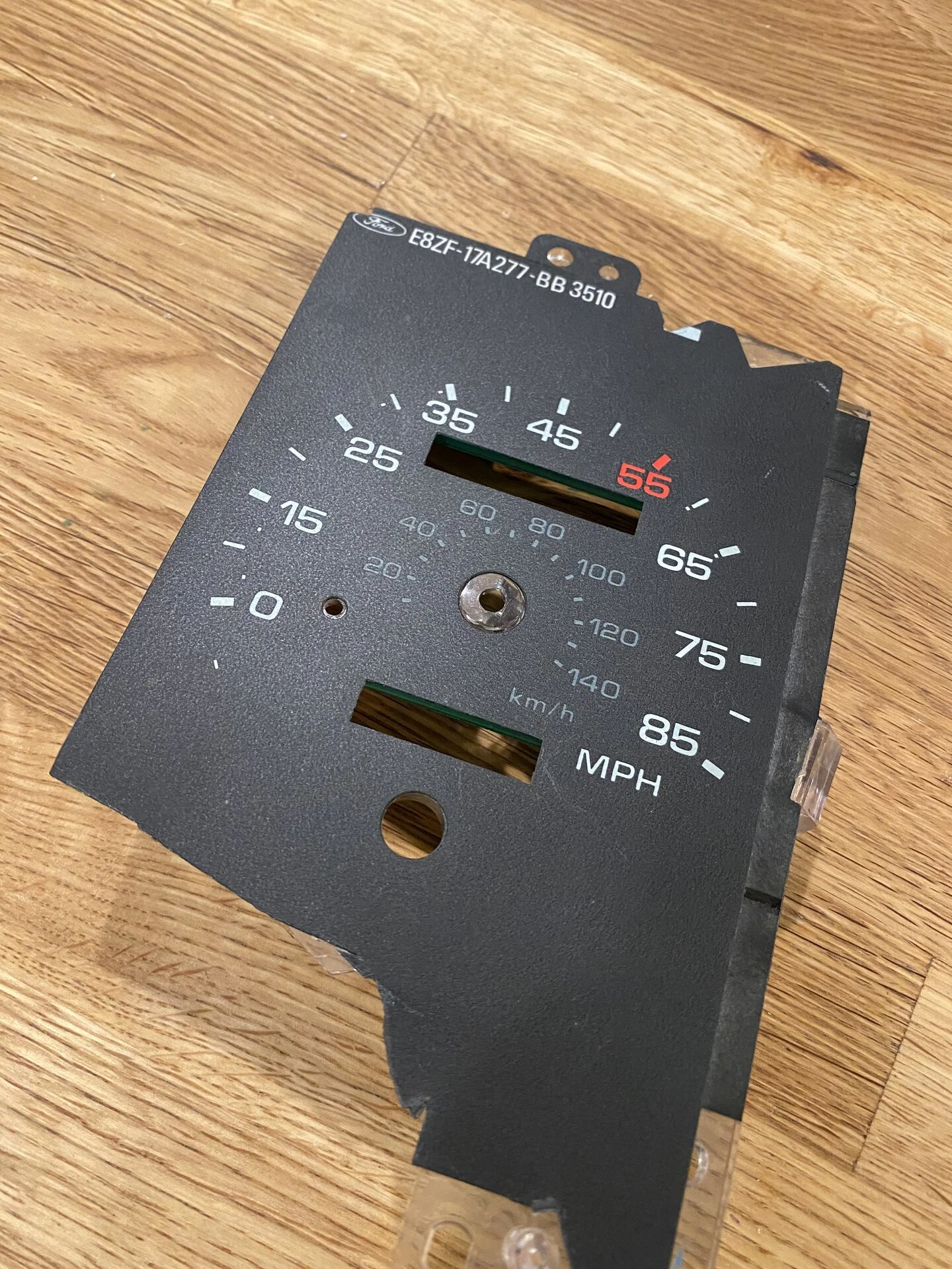

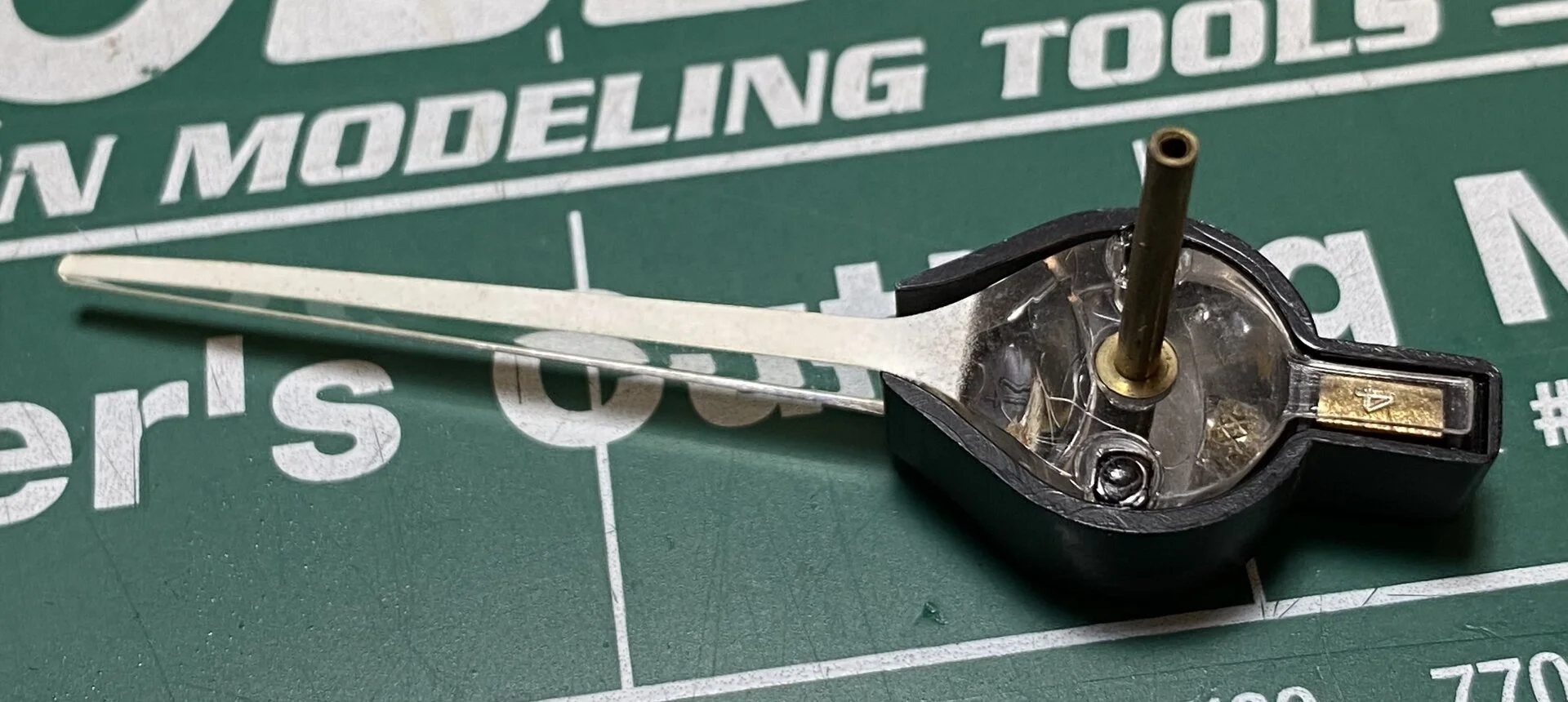

i pulled apart one of the 85mph speedos I had. Here’s the detail on the needle. When I did mine, I removed the white with nail polish remover, and then repainted them the exact same pattern. They are painted on bottom Only
I was gonna play with this a bit and see if there’s any way to get the glue off the face, reglue it or maybe change it do they light up a different color if I sandwich a clear plastic in between.
I really like white numbers on a black face and blue needle

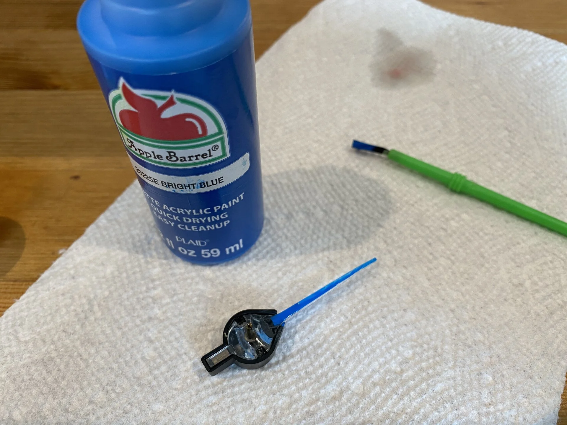

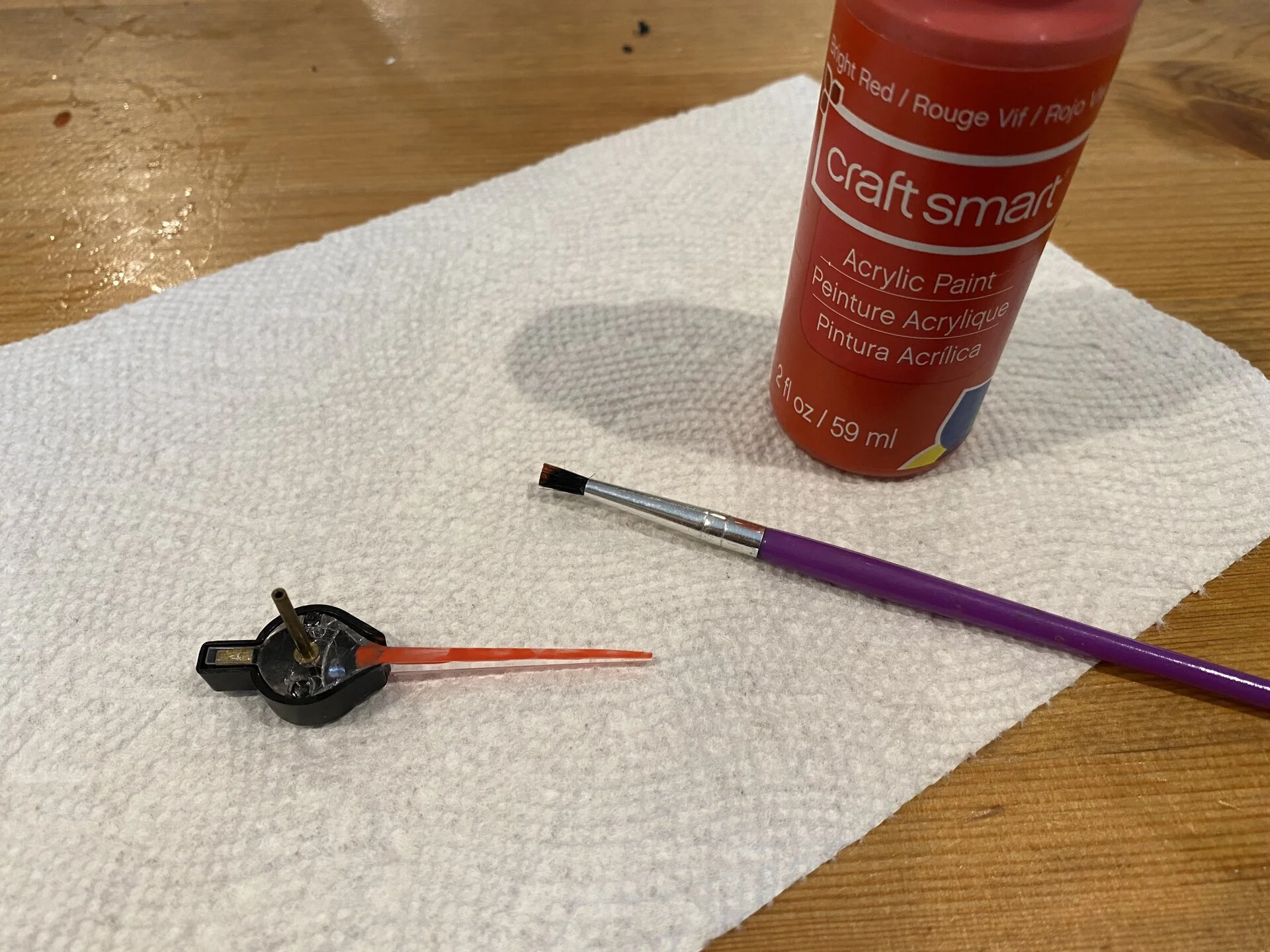

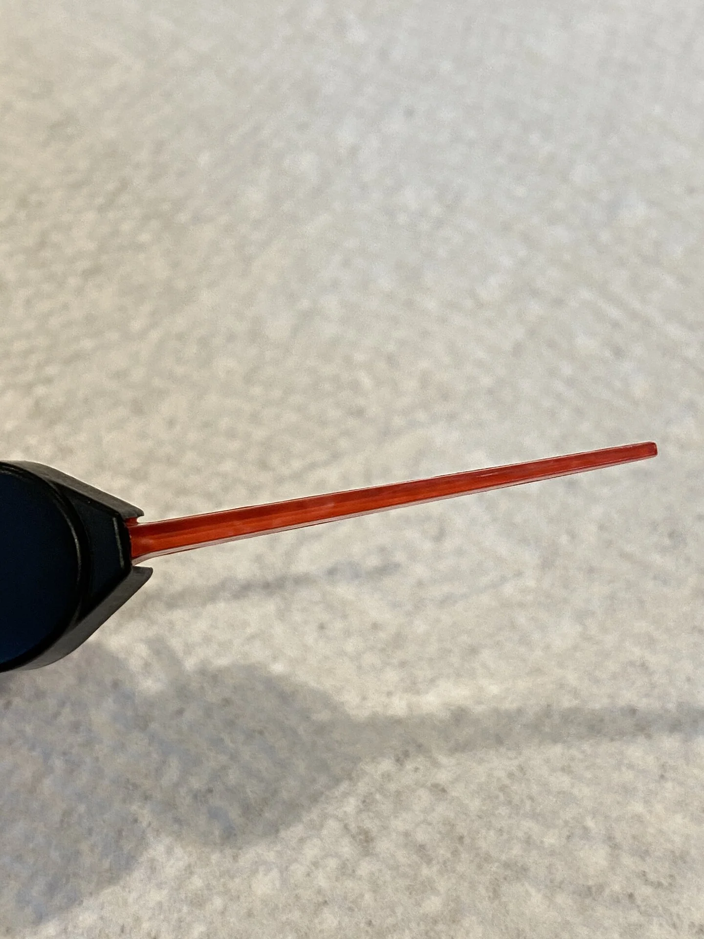

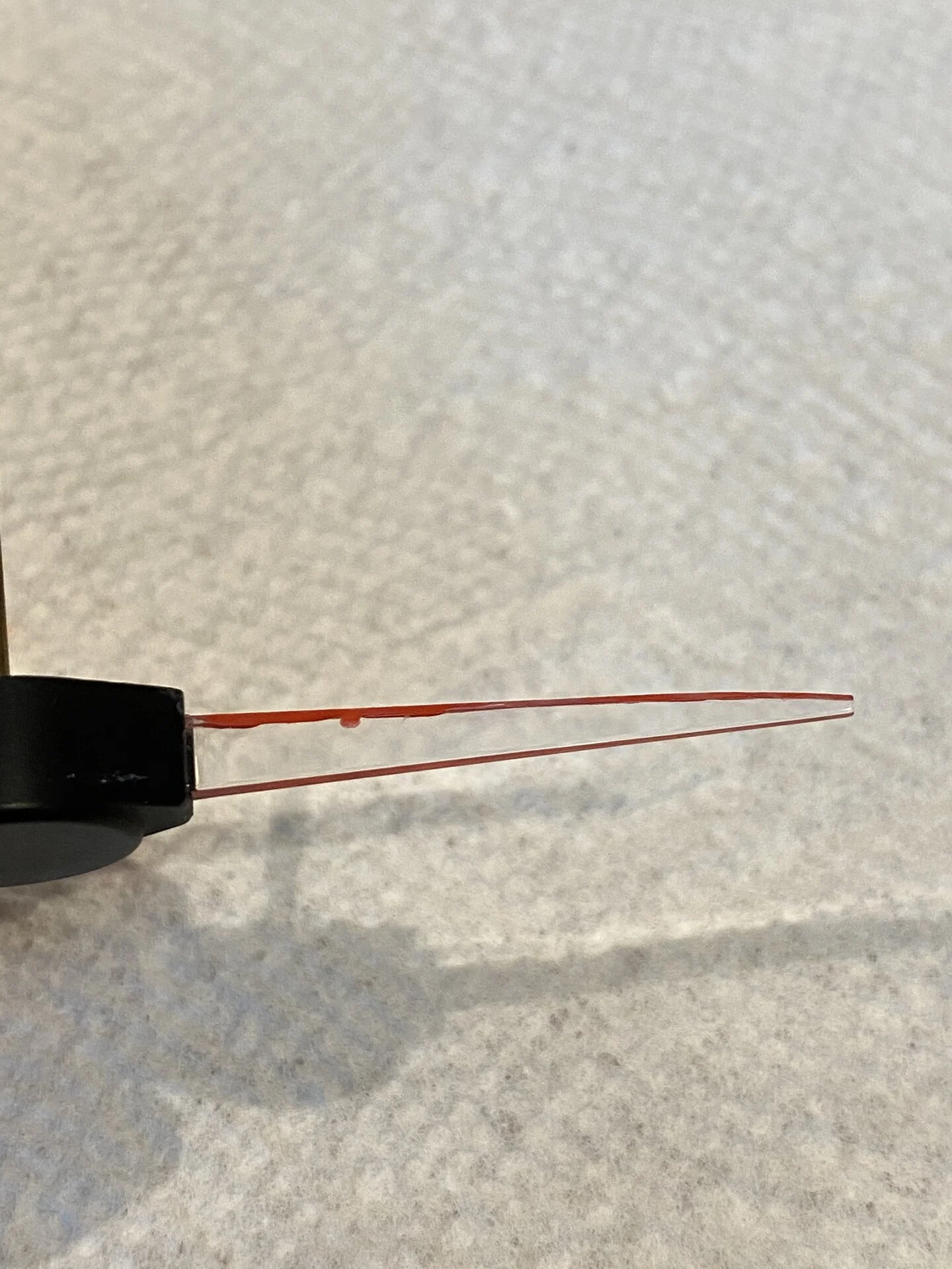

Playing with a needle. A little nail polish remover (acetone) on a q tip takes the white paint off easily.
Use sparingly. Too much will damage the needle (cracks)
I grabbed whayever paint I had handy. Wife had some red acrylic artsy fartsy paint so I used it. I just painted the bottom. Needs a few coats to be thick enough to glow evenly. You can see I didn’t paint the center hub portion to allow light to shine up and disperse into the needle

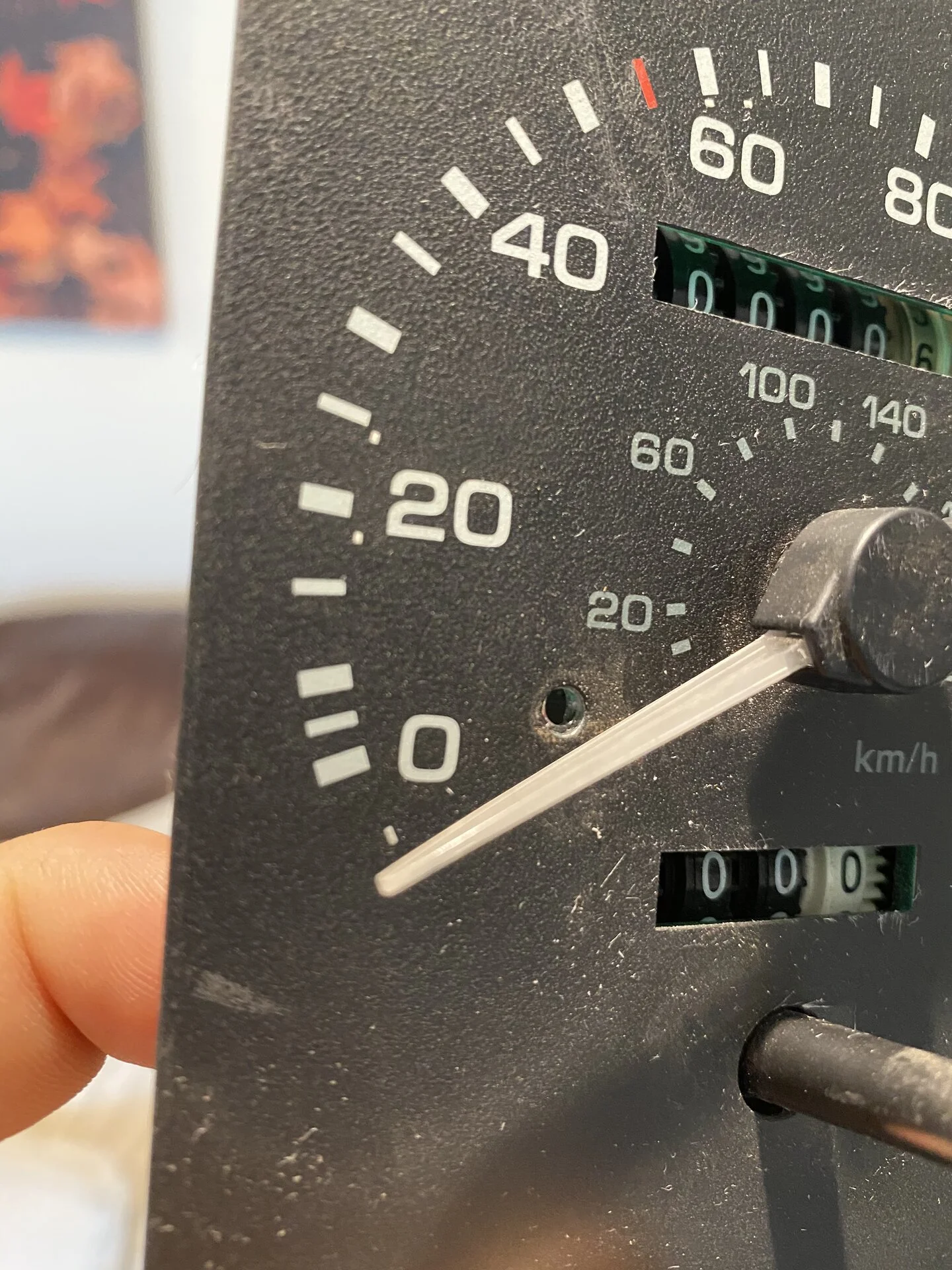

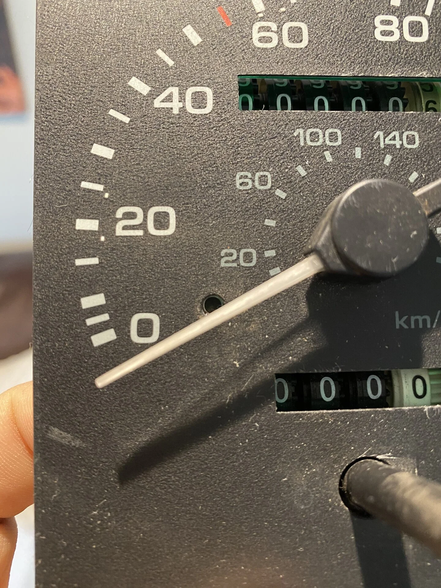

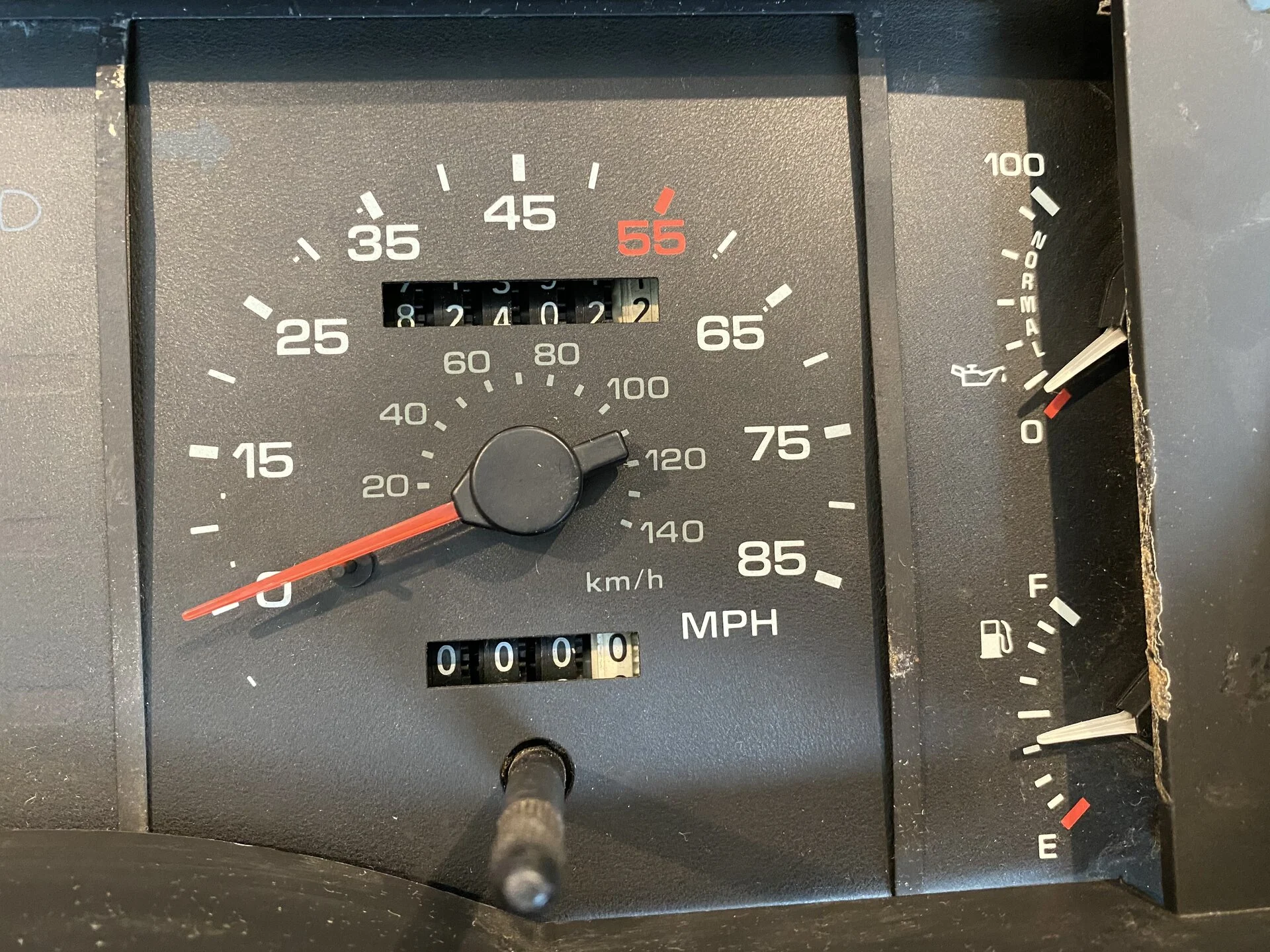

anyway, how critical is it to match up the needles to where they were? How can you be sure that they’re in the correct place? I saw your comment on using tape, which seems easy enough. I was just going to paint the top of the needles but I’m considering painting the bottoms after seeing this.
None of them are very accurate, but before you pull it apart, cycle your key on and off with the car ice cold and you can see where they sweep and reset to. After your done, put the cluster in the car with the bezel off abs cycle key to on and reset. I usually like the tank topped off when I do this too.
Volts, oil pressure and fuel are easy. Temp I think will zero on the bottom tick of the engine is cold, but this one you will need to check.
tach points right to zero. If you move the needle around it always resets there. Easy
speedo can be easy too. On the 140MPH there’s a tick mark under 0mph. Pull the speedo rest and it should line right up. Knowing that, should be easy to reset.

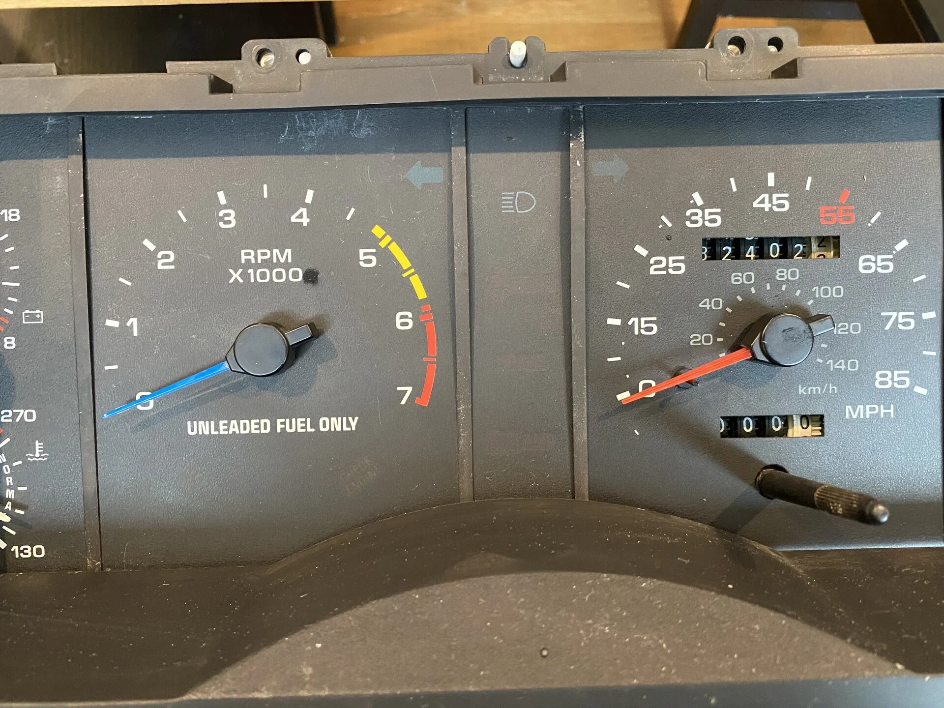

I’m literally playing with my spare cluster as we speak. Looks like I need to order some LEDs however

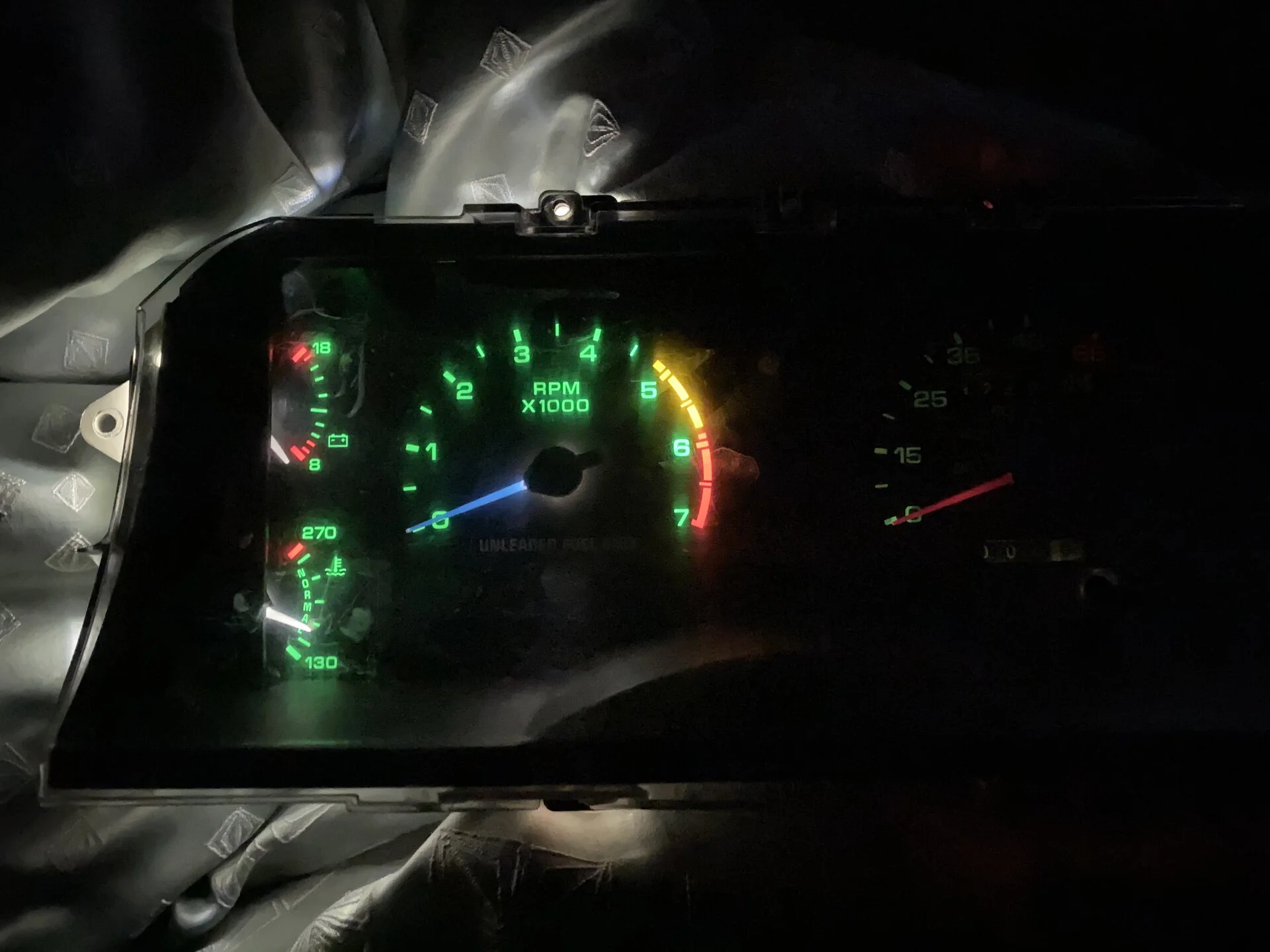

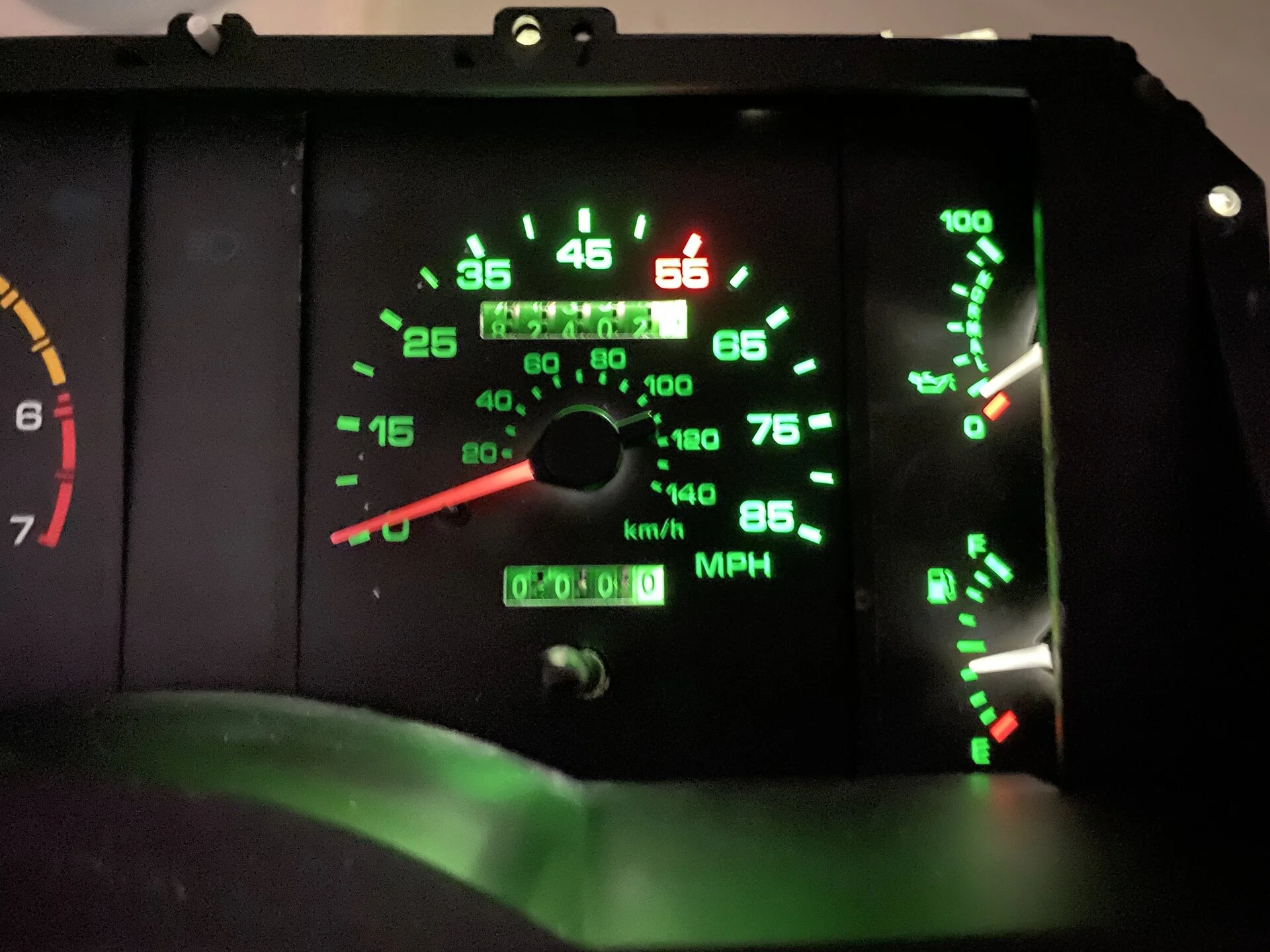

Red needle installed on my crappy parts cluster. This cluster is a hot mess of hackery, but it gets the job done as a test unit. Pretty sure a wasp built a nest in here at one point. I pulled the 140mph speedo out and will store that as 87-89 140mph speedos are tough to find.
anyway, not my first choice of color for the shade of red, but it’s what I had.
only had two white LEDs. Gets the point across though. Ford should have used red needles from the start
Gonna try to paint one blue next

blue looks...jury’s out. Pictures of lighting never display the true look. Need to see in person. Needs some tweaks. Gonna go paint a needle red and see if I have any blue LEDs
That looks terrible (to me, in my subjective opinion to which no one is required to subscribe).
Not digging the Blue needle.
I think Red needles and white LED bulbs is the way to go. Keep it simple
there doesn’t seem to be any way to address the green tint of the faces without overpowering it with a colored LED. At that point it’s too bright.
maybe that’s why I like the LMR guage cluster. It’s white vs green
Anyway, project done. Gonna paint these needles red (with Testors paint) and swap them with my other cluster when I get a chance. Already had white LED lighting in the cluster

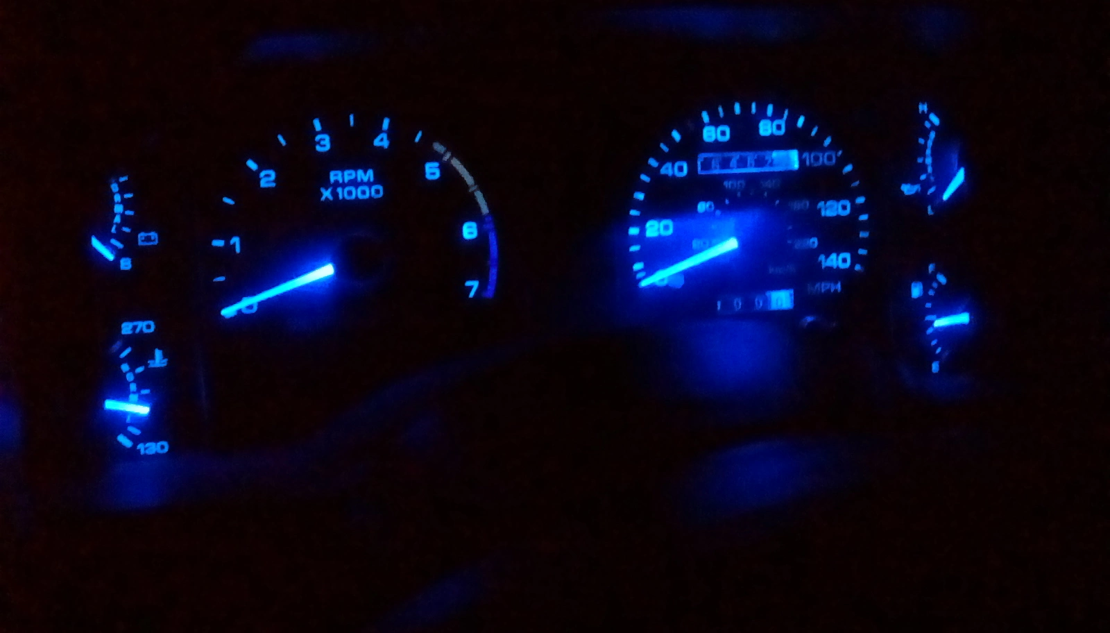

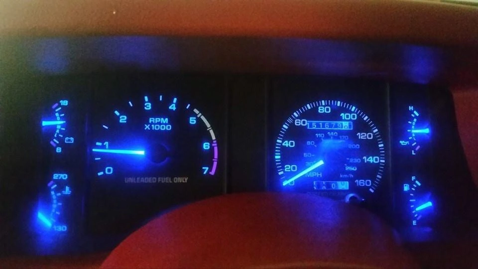

Come to my house I'll show you in person. I got these on Amazon, and they are awsome,plus my stereo has exact blue light.

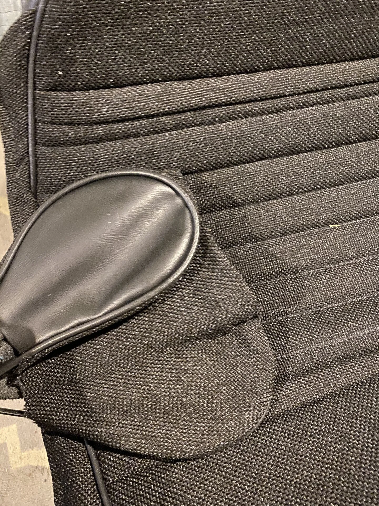

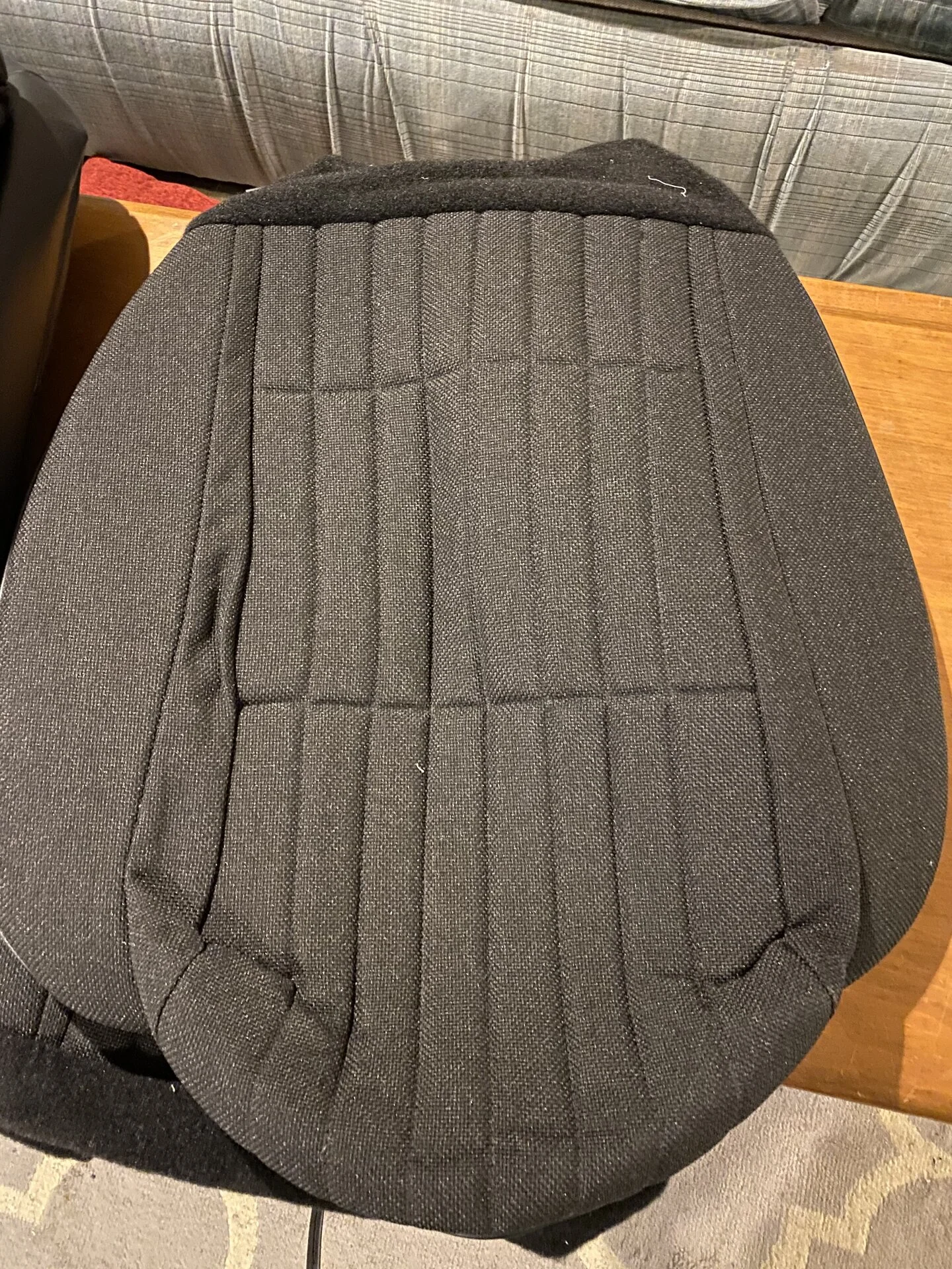

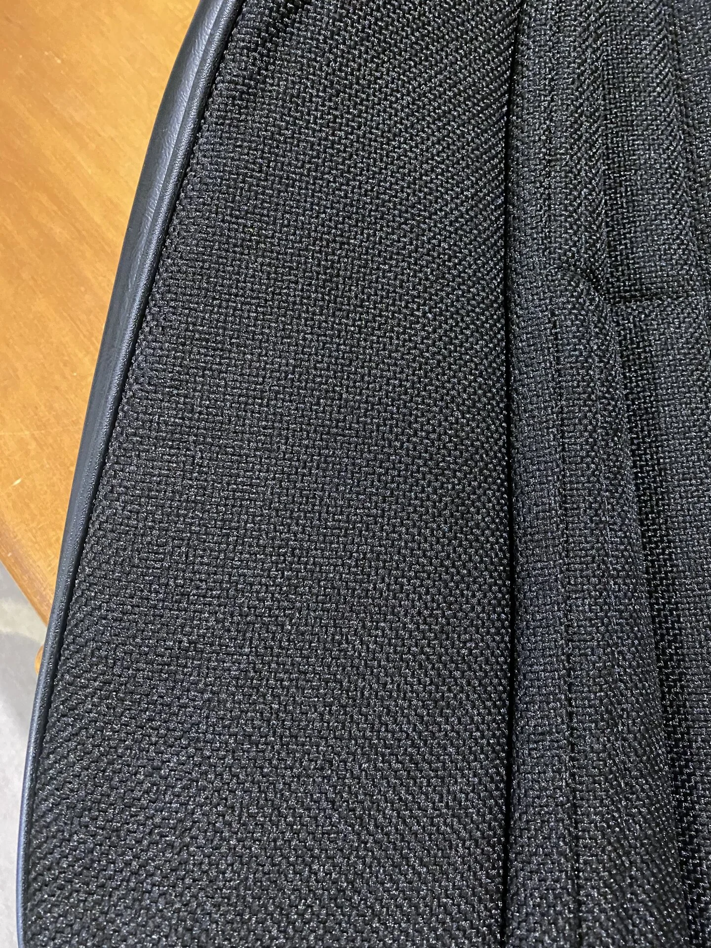

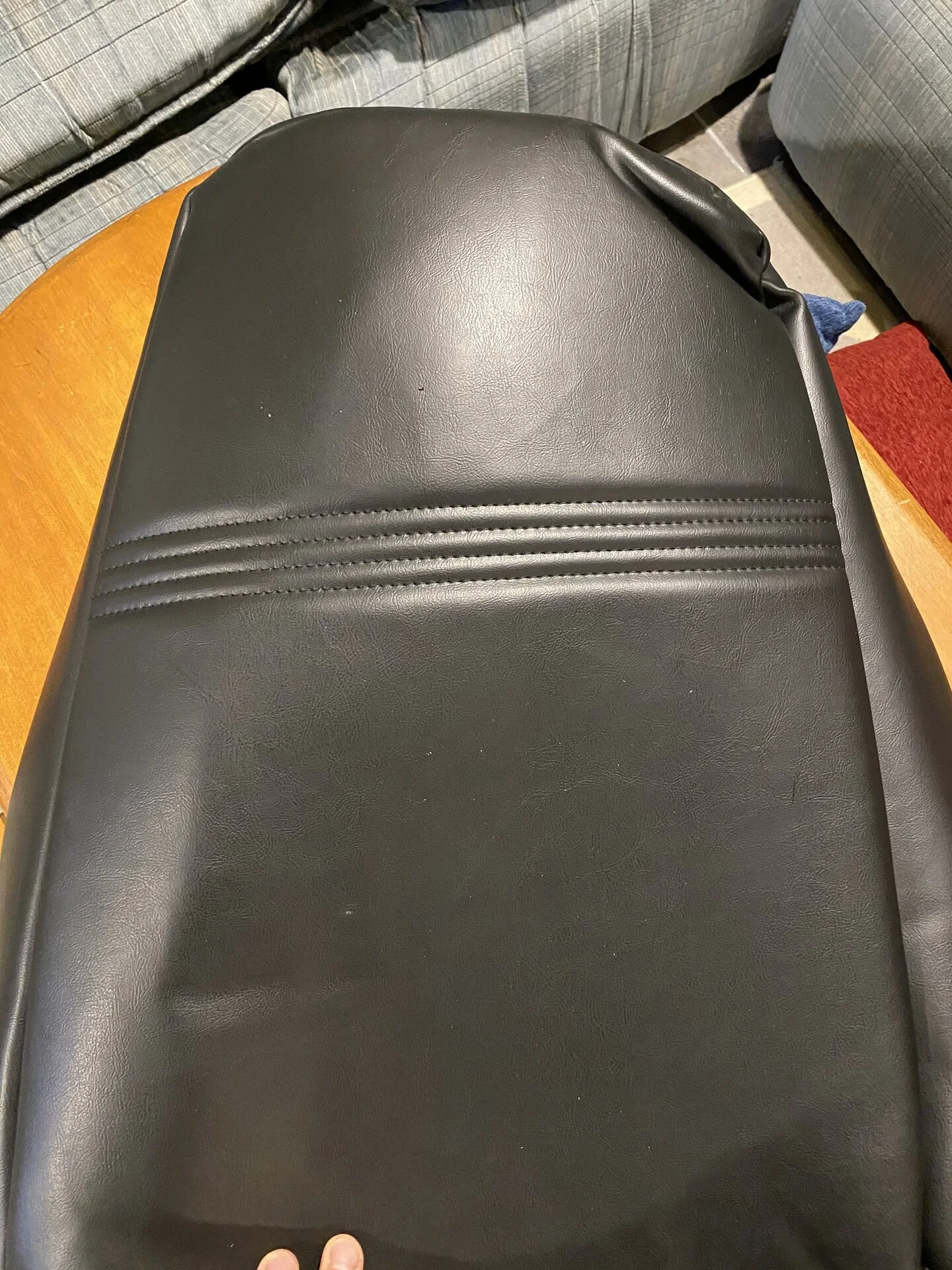

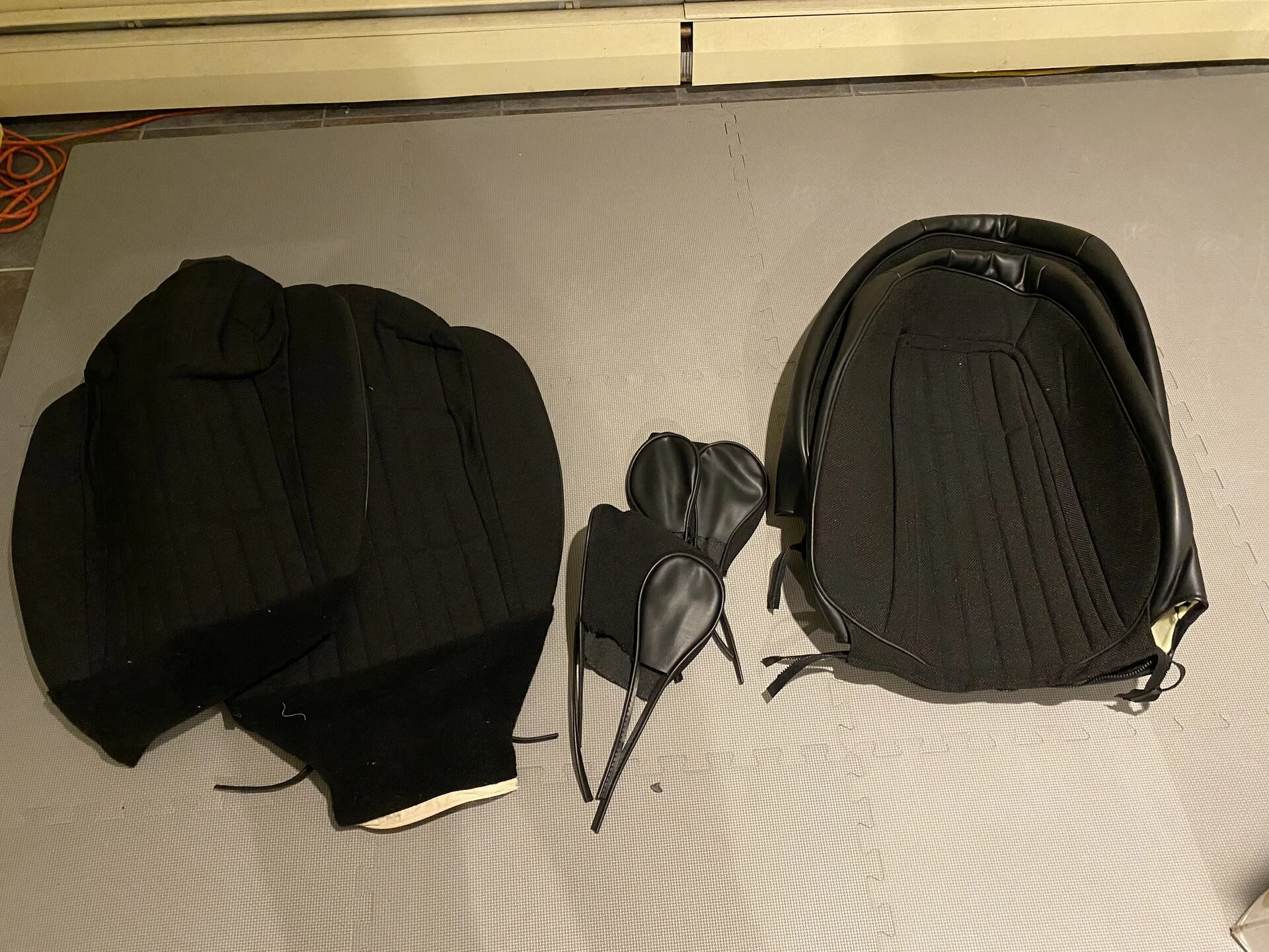

So I was browsing EBay and saw an auction for seat covers. They were ACME brand upholstery for 92-93 seats, in black. It was a $9.99 start price auction. So I threw in a bid.
a week later I won them for $28 plus shipping. I think the seller even underpriced the shipping.($20) The ACME kit with back seat retails for $400.
didn’t expect to win them. I don’t even have nor want 92-93 seats. Maybe I’ll find a junk set and recover them one day to kill a long winter and then resell the seats
I said I was downsizing my parts collection. This isn’t helping.
