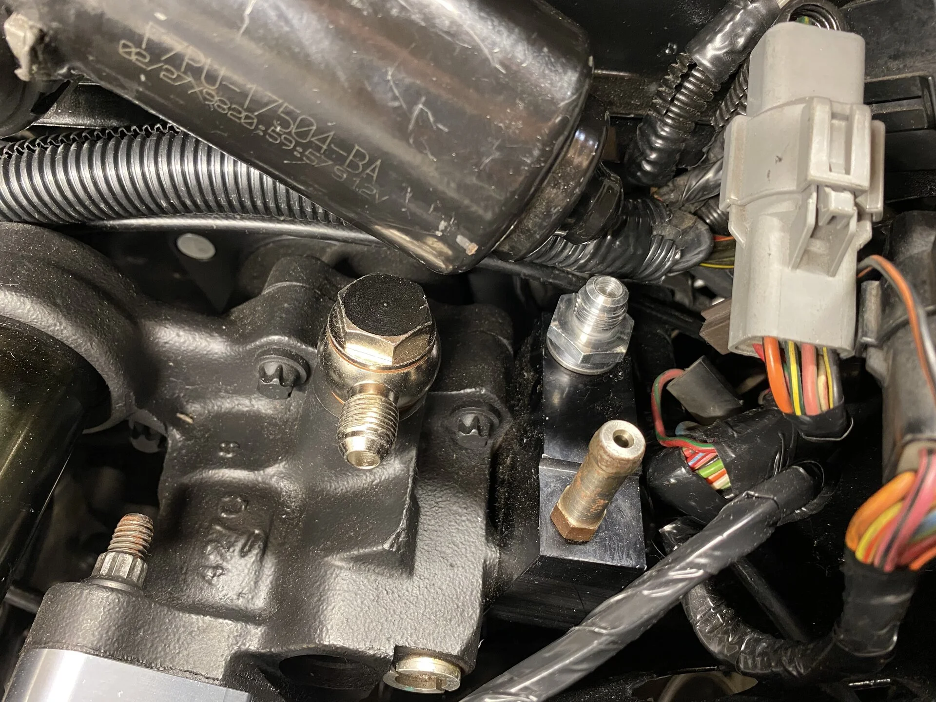

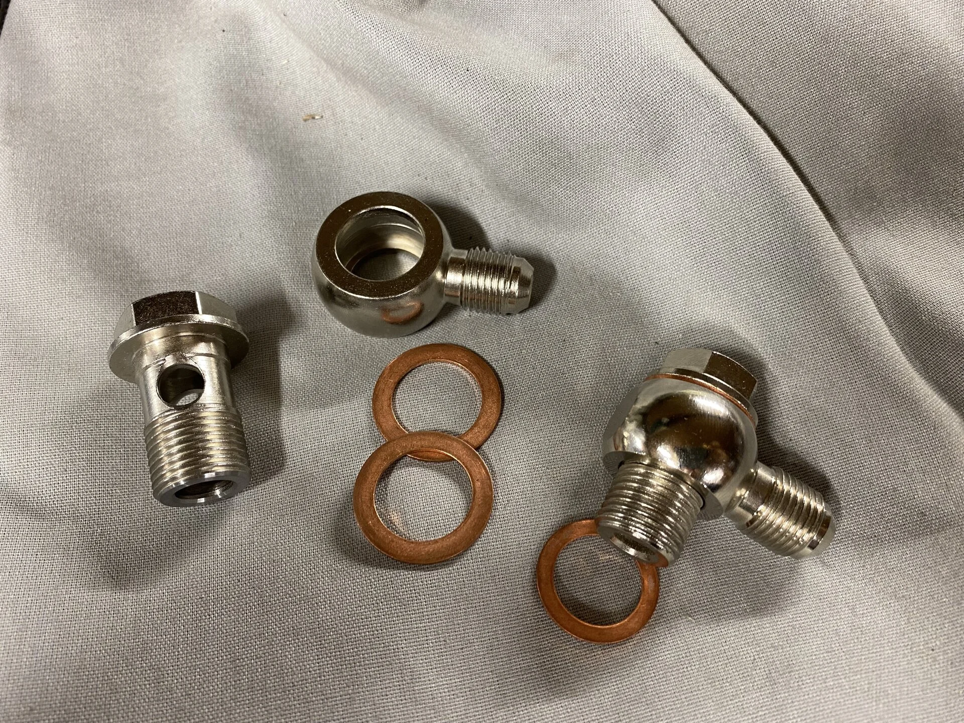

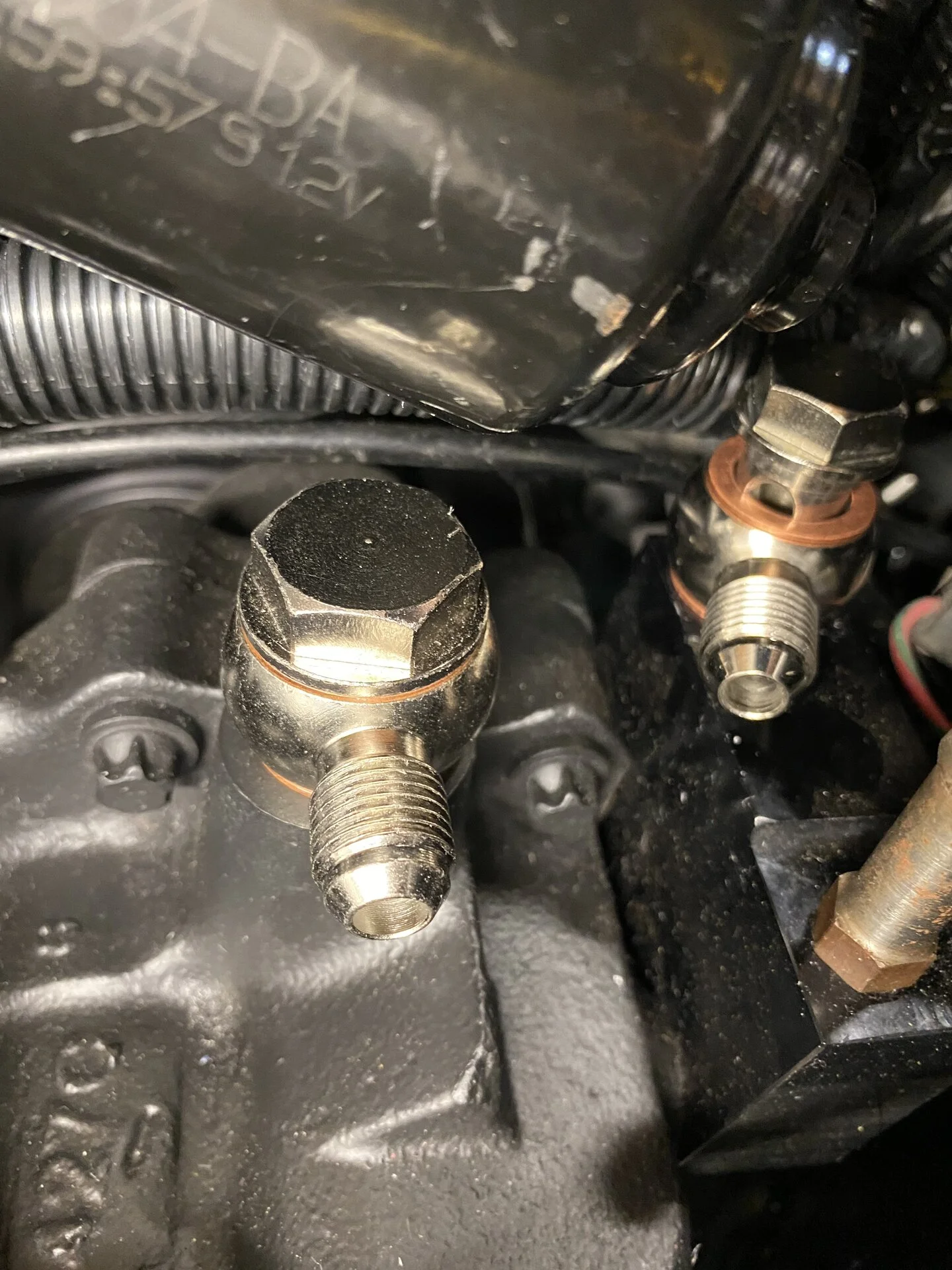

Ordered up some banjo fittings for the hydroboost. M18 and M16 to 6AN. Neither really fit well out of the box. The M18 banjo was too long and bottomed out. Was 30mm long. I chucked it up in a lathe and turned it down to 28mm. Fit great after that.
The M16 banjo didn't really fit well at all. It was too close to the block on the hydroboost and wouldn't let a 6AN fitting thread in. Ended up swapping it for a tuff-stuff 5550P fitting.
