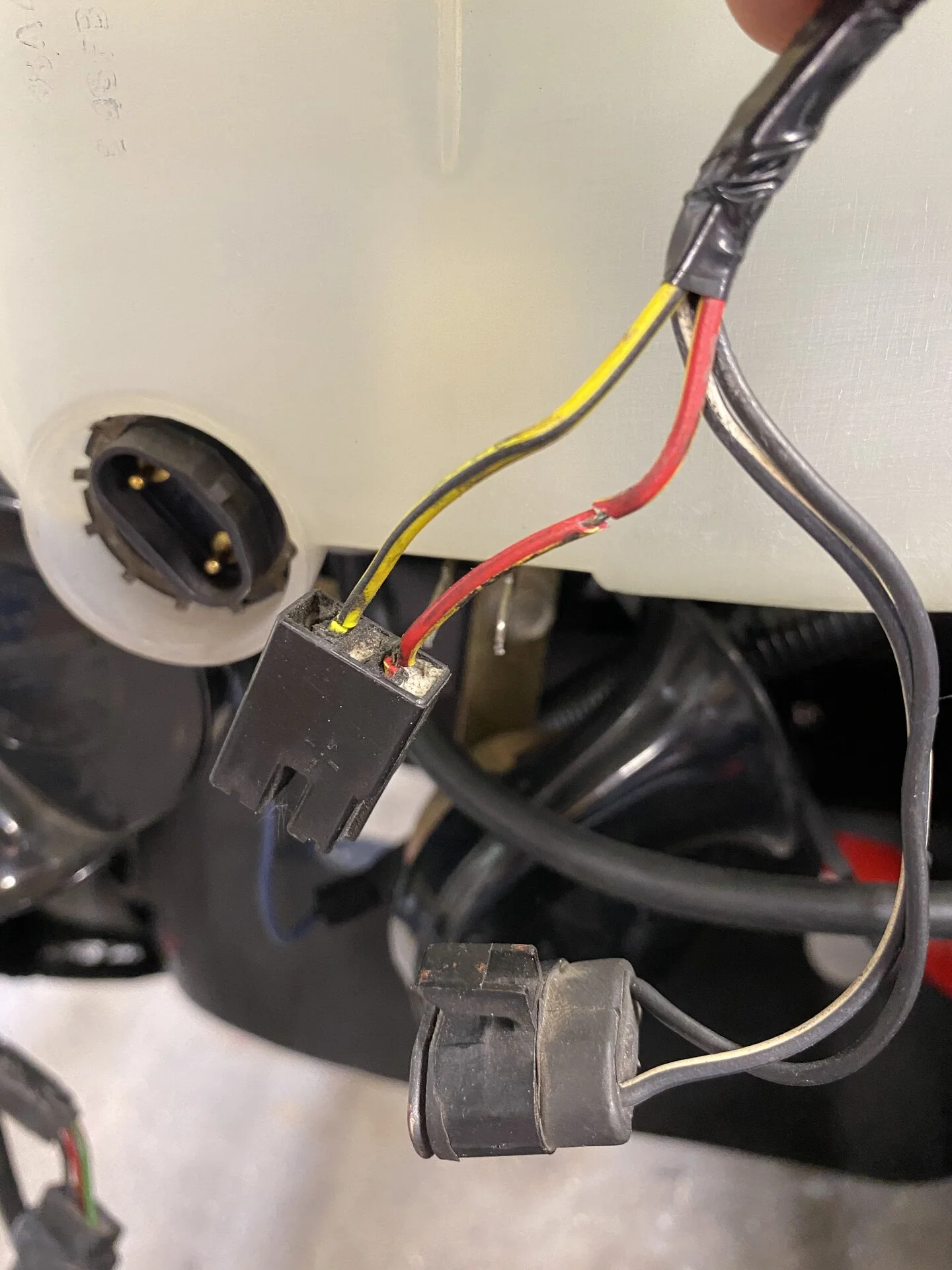

Also, any where to get a new washer fluid level plug? This thing is falling apart. I wonder if two blade terminals would just fit the prongs on the tank. Somewhat hack, but non-essential
and yes, having this non-functional would keep me awake at night.

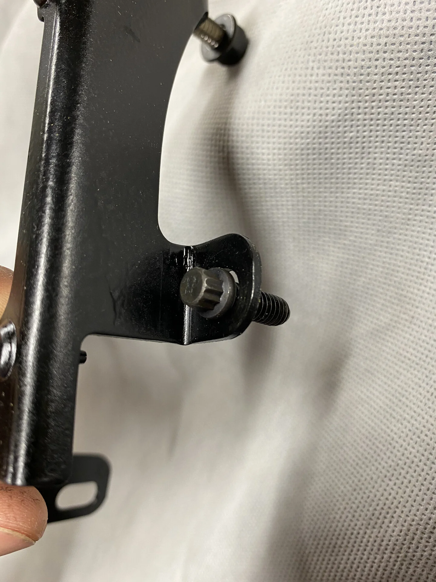

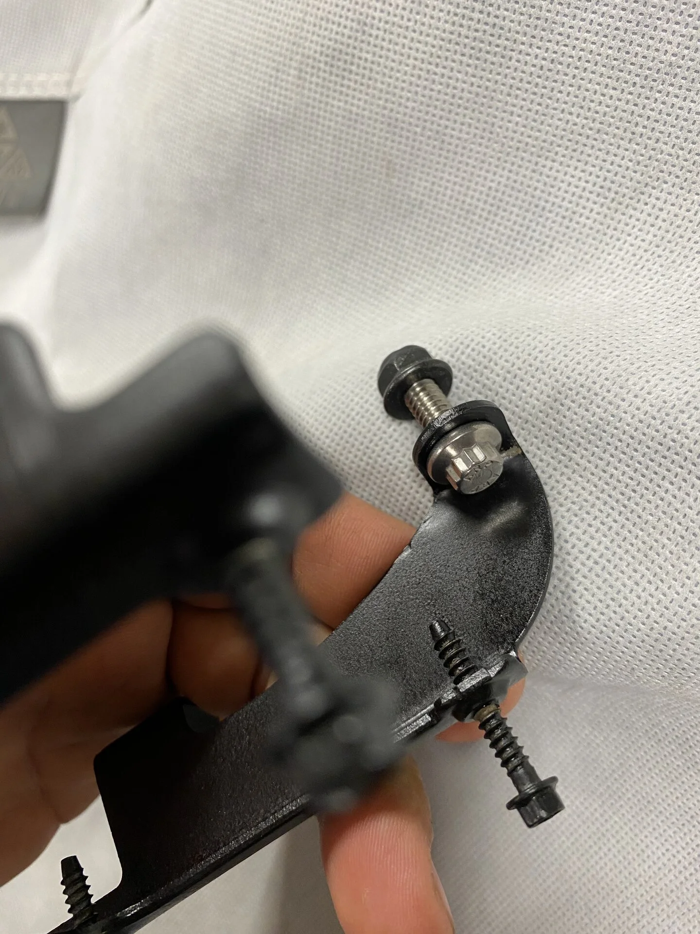

about to bolt up the coil bracket. It’s going back in the original spot. I’ll likely pick up a spare and powdercoat it, but I have some spare ARP hardware to bolt it up.
stainless 12-point or a more subtle black 12-point?
I know I know...nitpicking bolts??
1BFAA277-35FF-4A1B-A56E-EC6891F713AD.webp 4B2D0366-401B-4078-8CE9-BCEA448AD37B.webp
Reactions: RaggedGT
I vote for shiny! I like the slight contrast here and there..... especially with quality stuff......... like you did with your master cylinder and braided lines!
Shiny bolts it is. Installed during lunch. No pic, I’ll grab one later. Also finished mounting and wiring in the alternator fuse block.

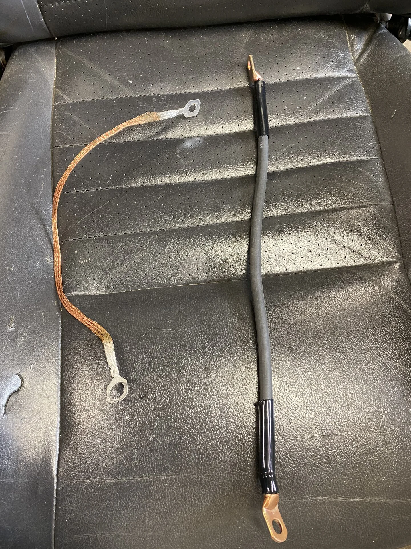

Had some extra 4ga welding cable and ends so I made up a short cable to replace the firewall ground strap. I figure it wouldn’t hurt.
A lot of Ford vehicles from the time period into the late-‘90s had that low fluid sensor and plug. Best bet would be to hit up a local yard or two and find a used on that’s in better shape than yours.

Oh nice I need to do this. My old ground strap back there isn’t in the best shape. Has a small gouge in it and I’m sure that’s not good.
I ended up just using two spade connectors. It fit remarkable well and made a tight connection.
Some Goo (shoe or plumbing) or E6000 would waterproof those spades. I’d put a layer of clear tape on the existing plug, plug them in through the tape, and build a new plug on the spade side with the gel adhesive with about two to three layers. My dad rebuilt a double smacked Olds fancy smancy plastic fender model and used that type or of stuff on plenty of interior pieces about 25 years ago. The last time we saw it, the interior pieces were still right in place. The straightened body work also held, but the aftermarket water Bourne paint needed attention.
