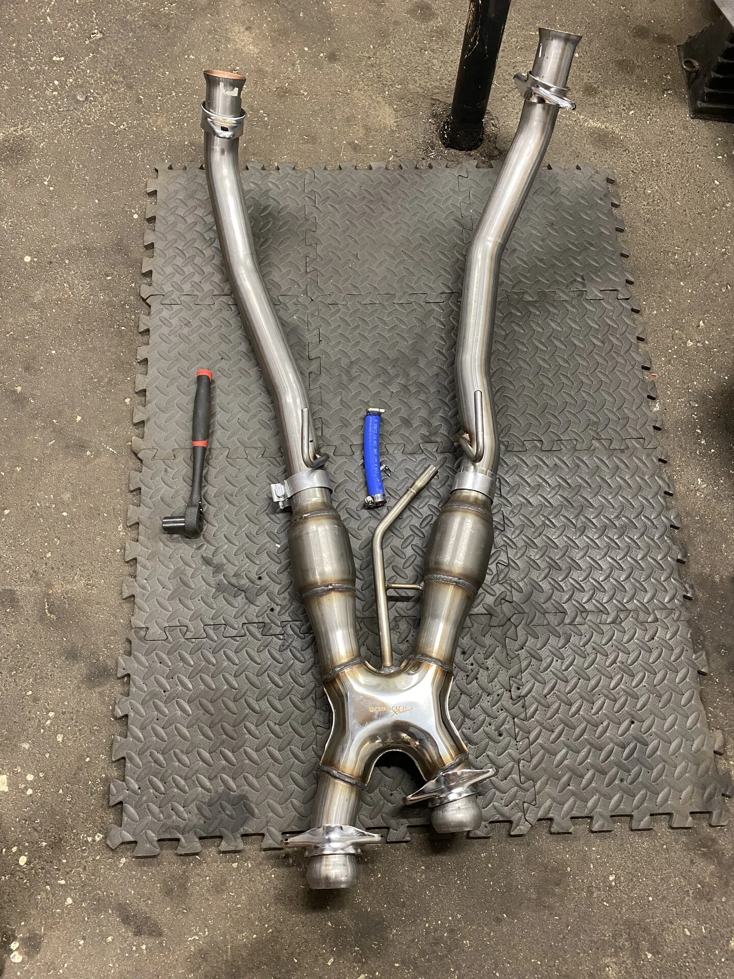

Welp, had to pay some attention to the Fox. Really felt like I was neglecting her with all this S550 love. Even my wife said I hadn’t laid sat inside and rowed through the gears making vroom vroom noises since I drove the gt500. She was right :(
So I started working on installing the exhaust. Installed the o2 sensor harness first. Then I started assembling the x-Pope.

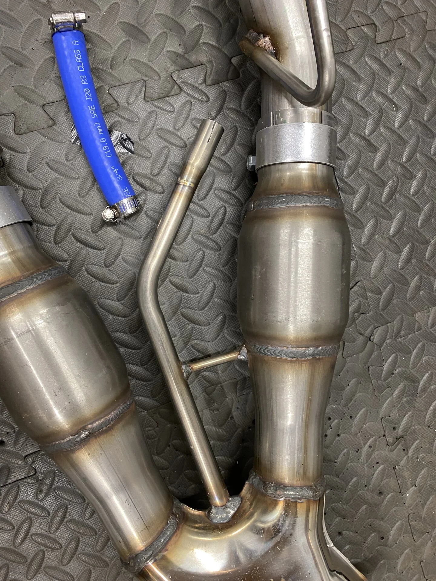

was starting to put it on the car when I remembered I needed to block off the useless air tube. This wasn’t exactly routed the smartest way
I may cut it back to the support and installed a shorter silicone hose with plug. That way if the EPA every gets crazy I can reinstall the original pump and pipe. Hopefully not.
hipefully have the exhaust done this weekend and the car back on 4 wheels.

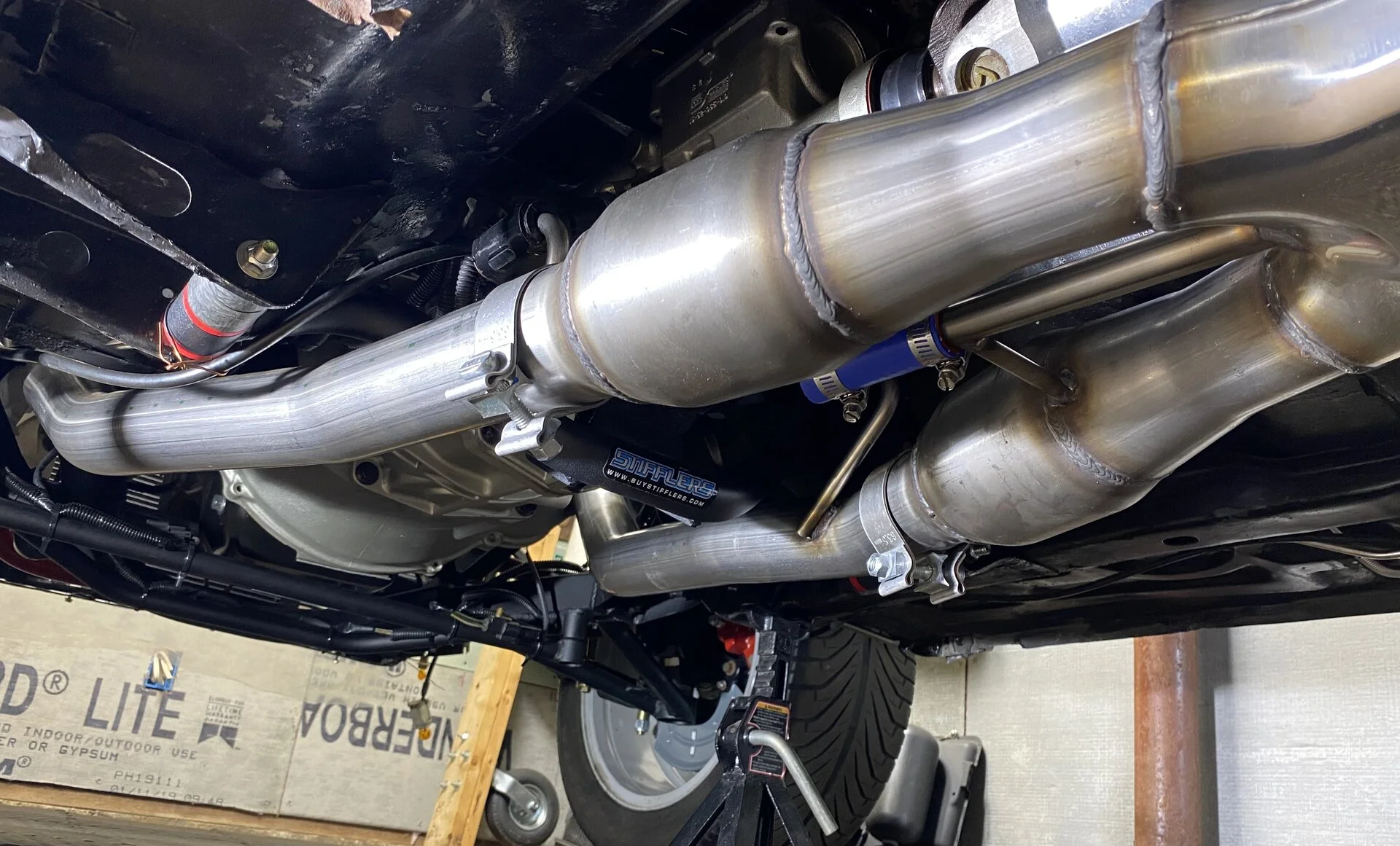

Ehhaust is installed. What a PITA. Took me 2 hours but done. It fit fine, but trying to do it on stands and moving around to every location and slowly tightening and checking clearances was tedious and exhausting. Lots of up and down. But it’s done.
o2 sensor harness run and o2 sensors installed.
filled the t5 back up car is back on 4 wheels.

I have this same piece. I bought a SS bolt (I think it was 5/8”) and inserted it into the end of the Thermactor tube and used a clamp to hold it in. No hose…
WhiteCobra95
5 Year Member
May 2, 2006
350
46
49
I wonder what size and how true that pipe is before the flare. I was considering cutting off the flare and using a compression fitting with a cap. That way, it's always possible to couple up to it again with a hard fitting if necessary. On my previous H-pipes, I've always shoved in a piece of solid stock and welded it shut, or smash the pipe flat if the wall is thin enough (BBK parts are, Magnaflows were too thick) and zip up seem. I was far less concerned with O/R pipes since the air pump doesn't do anything, but it would be nice to keep the door open for an air pump installation on a mid pipe with live cats, even though it's only for cold start emissions.
Mustang5L5
Put lubricant all over the balls
Mod Dude
Feb 18, 2001
36,174
12,091
224
Massachusetts
I ended up cutting it back to the straight portion. A 3/4" hose slipped perfectly over the end and a 3/4" peice of bar stock into the other end and 2 hose clamps. I just wanted to keep the possibility of adding the air pump in the future at a later date.
Not as clean as i'd like, but easy to do and quickly reversible if i want to add the smog pump later on (which i don't but who knows what will happen in 10 years or so). All my smog stuff i've removed is packed into a box and stored. Only smog stuff left is the EGR (for now).
If i added the air pump, i'd just connect witha 3/4" long hose and call it a day. I did this back when i had my stock H-pipe and the air pump.
