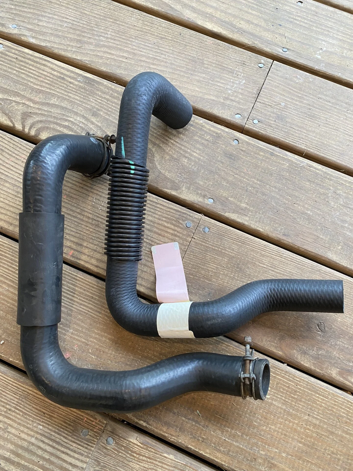

Rad hoses came in.
I’ve said it before, but I’m just not thrilled with the quality of Motorcraft parts for our fox bodies these days. They seem cheap.

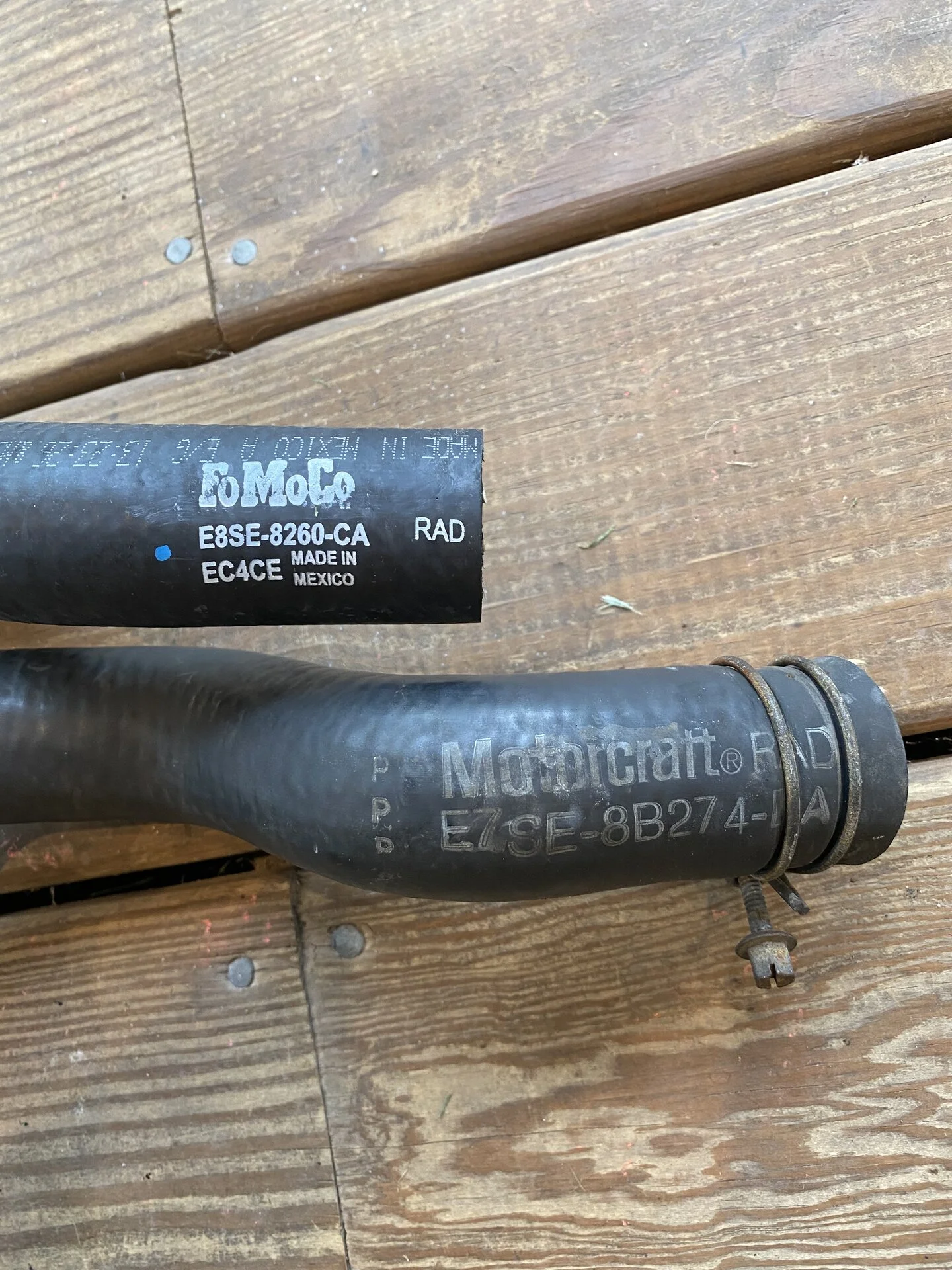

New Motorcraft replacement vs either my oem hose.
Actually, I may have replaced this hose in the late 90s. I seem to remember doing so but it still has the stapled on oem hose clamps. Also shows an E7 part number so maybe it is original
I’m almost tempted to just reused the old hose. It looks better, lacks the cheap corrugated crap, and feels just as pliable.

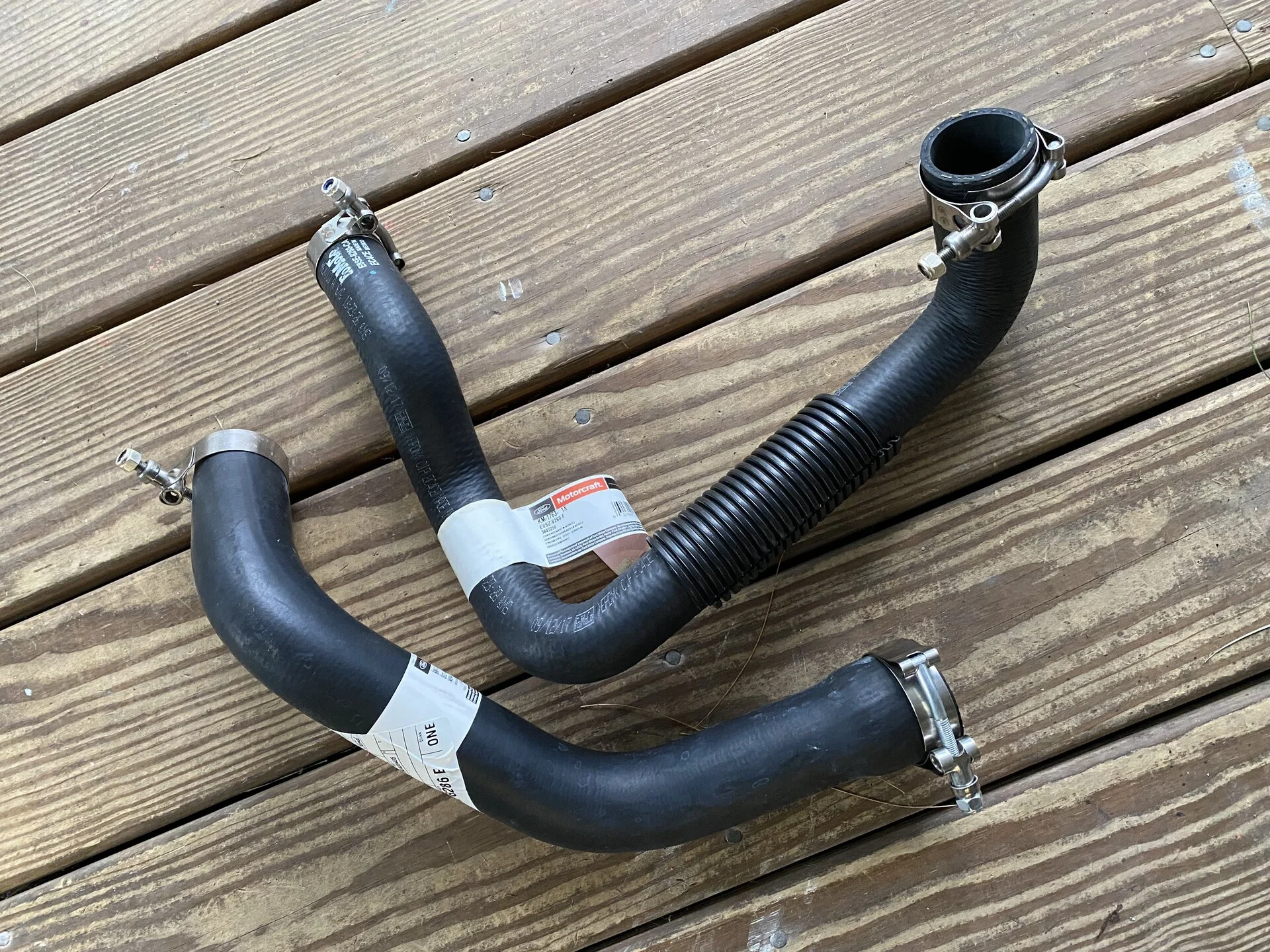

  • #886
Noobz347 said:
Nickle electroplate the OEM clamps.
New stainless T-bolt clamps

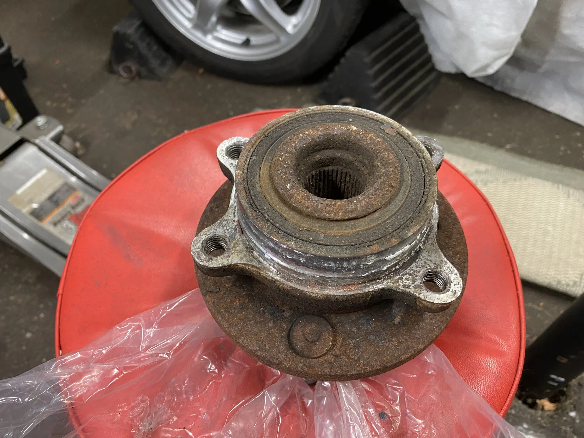

Well, opportunity to work on the Mustang this AM got displaced by daily driver maintenance.
Changed out a howling wheel bearing on my Taurus. 3rd on this car. Not a bad job, but my distaste for fixing “normal” cars is growing exponentially. So many other things I’d rather do with my time.
