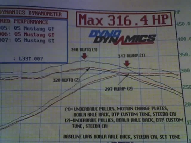

Do you have any track or dyno numbers for the two?
I sure do.
Lemme get a pic of it.
Excuse the quality but I believe it's legible. (cell phone camera)
Two runs, labeled (1) and (2).
You can see a gain of 20rwhp and 20fptq on the run labeled (1), the only addition being the IMRC's.
The baseline run is not labeled but you can see it parallel the #2 run by about 8-10 hp, this was without the UD's and run #2 with was with UD's. (+8-10)
This was all graphed before I added the LT's and the Prochamber.
Hope it helps. :)

Good info! Thanks. From what others have said the elimination of plates doesn't do much. Looks like they just may.
how was the SOTP feeling after the charge motion plate deletes? According to the dyno sheets it did give a nice increase. Were the two dyno runs done on the same day?
Everyone has a different opinion/dyno result. I have heard that you gain anywhere from 8 to 20 rwhp. That is weird that it is the wide of a spectrum. At the same time it all depends on the tune, dyno, conditions, and heat sink. Anyone else have any other dyno results with Charge motion deletes?
