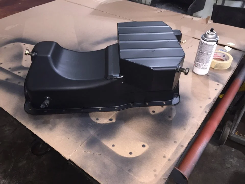

That's a funny looking soup bowl.
I like to use it for my pourage lol

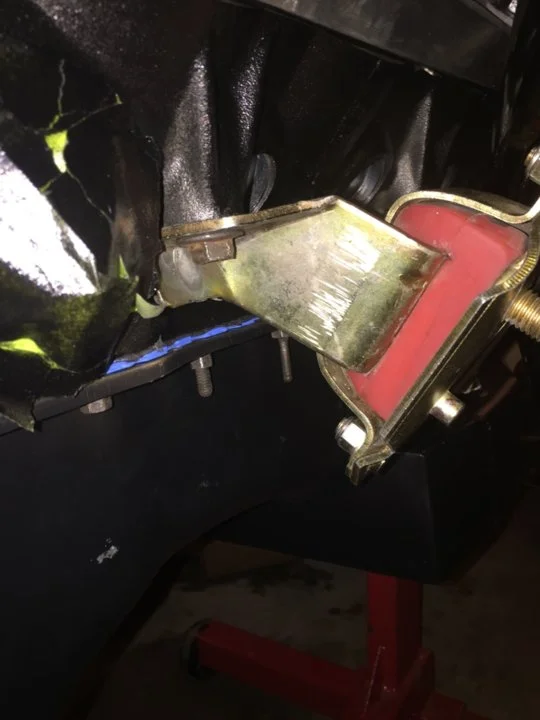

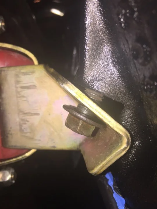

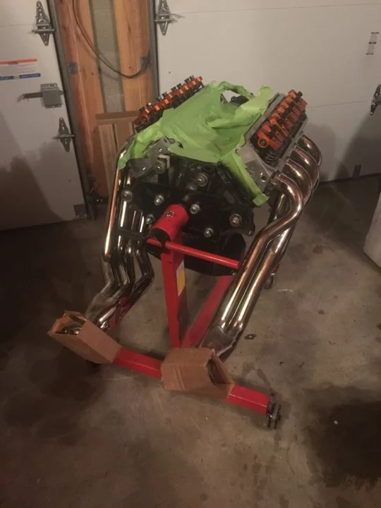

Of course the motor mounts don't fit right ...
That's odd.....
What headers are those?

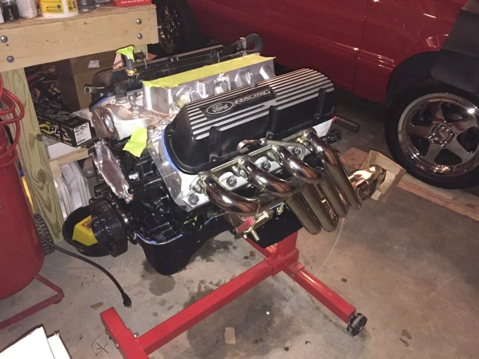

TOOLOW91
20+ Year Stangneter
8,501
8,761
S.I.NY
Mar 28, 2015
#2,208
  • Mar 28, 2015
  • #2,208
RangerJoe said:
That's odd.....
Joe
1 3:4 bbk

Welcome to Dart block life...you gotta trim those motor mounts, buddy. Are those headers the ceramic coated ones?
Nope lol I am cheap and it don't sit outside lol . I massaged the header it's all good . What did you do to your mounts you have pics

Im guessing you might have to oblong the hole where the bolt is to make the mount fit better against the block im thinking .
Yes but then the motor will sit higher. I am gonna recess the back of the mount where the parts of the casting protrude in and that should do it . Hopefully.
I used a cutting wheel to trim a little off of it so it would sit flush. I didn't take any pics of it tho.

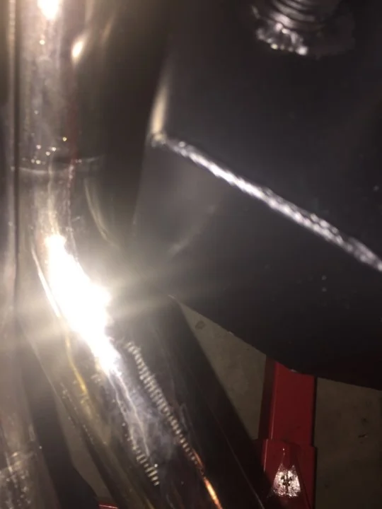

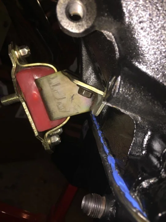

HI YOOOO look what fits now

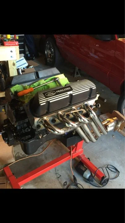

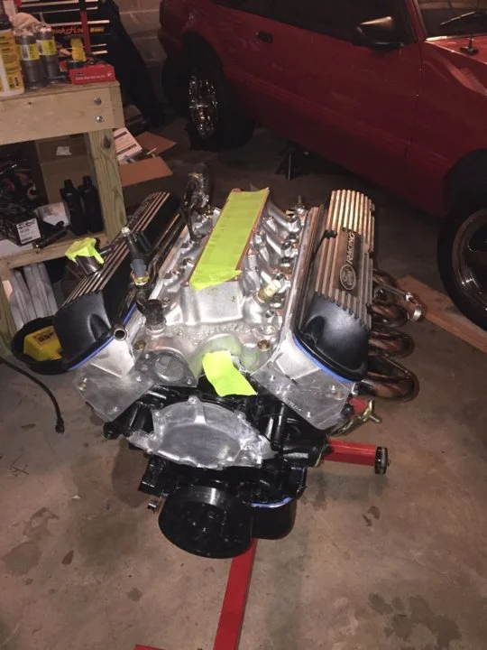

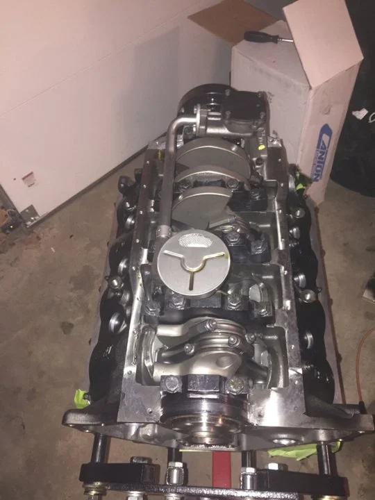

Something else found its way on the motor too

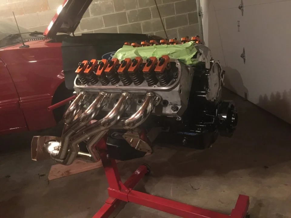

MY 85 GT said:
Making some nice progress Jeff....!!!!
Yup gotta get the t stat on and my loop of hoses off the back . Take the pipe off and paint that . But for arguments sake it's ready to go in the car
