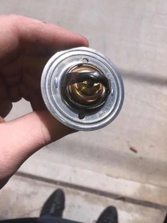

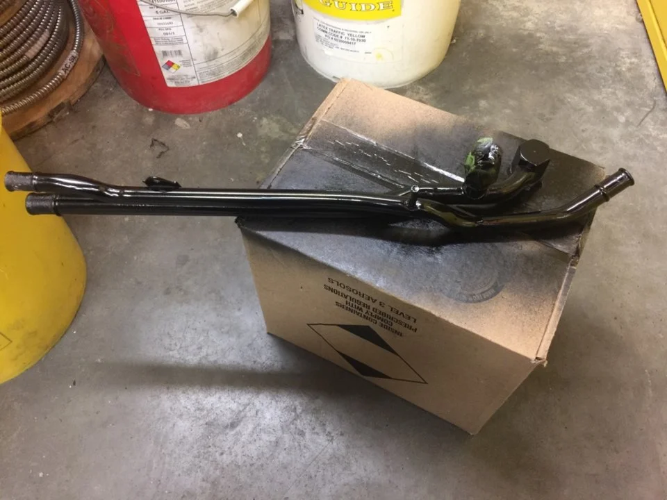

pulled the heater tube off today later on when I have some time gonna paint it as well as the t stat housing . Also drilled out the t stat just to give it some bypass

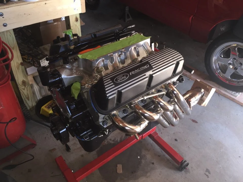

No they are going in just like that . I have the shortys that hang to the same length as a long tube with the two extensions on it for the x pipe and never had an issue getting it in and out with them all together .

I didn't have the sack to install my engine+T5 along with my LT's. I just dropped the motor & trans in and installed the LT's while the engine hovered in the bay and then bolted up the motor mounts. It's the passenger side that needs the wiggle room which requires the engine mounts to be unbolted to scoot the motor over to the drivers side to install them.

Oh no the TRANS will be done on the floor lol . Just the engine and headers go in up top
looked like long tubes....i was thinking maybe you had a trick i didnt know about..lol

What I meant was I used to do it with the shortys that. Came full length with the x pipe extensions . Those are most deff long tubes on in the picture lol my bad
ok thought so.....i had to do the lift engine and persway them in.....a few times...lol...looking good though!
Looks good bro! Once again you guys are running circles around my build. A 6 y/o + twin 20 mo old girls keep this Dad busy! Keep up the good work!
My son and I helped a friend of mine drop his engine into his 85 with a T5 and longtubes bolted to it less than a year ago. There's a trick to it though and it takes at least two people.. but we had it from off the concrete and bolted in in 10 minutes.
Jack up the rear of the car leaving the front on the ground. One guy under the car with a jack to catch the tail and jack it up with one pushing the engine hoist forward. Three ppl makes it even easier.

What a difference painting that pipe made . My crystal ball says in the near future - few weeks I may or may not be ordering a tko600 for this pig
