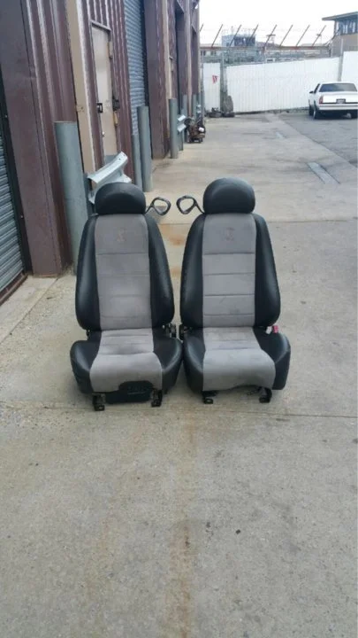

Nice. There was a dude selling a set around here for $1500. They're nice seats, but daaaaayum. Don't need them that bad.

TOOLOW91 said:
Interior is getting a slight change . 03 cobra seats on the way
Nice!
and I'm jealous, I'd love a set - did you yank them from your friends termi after leaving Myrtle Beach....

89oem said:
Nice!
Nailed it . Hes getting mint black ones with the charcoal inserts . And im getting his at a redic price. After being in them for 10 hours each way and still being comfortable i was sold.
If it wasnt you your cars twin was at MW. lol

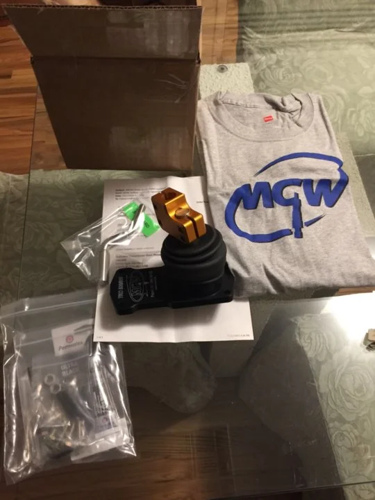

got some goodies today. 198 shipped mustan week special with tee shirt
Reactions: stangboy and A5literMan
Good choice! I wish I had bought one. (Got a cheap knock off shorty)
Heeeeey, I have one of those too!! Can't wait to see how it feels compared to my old Steeda Tri-ax.
