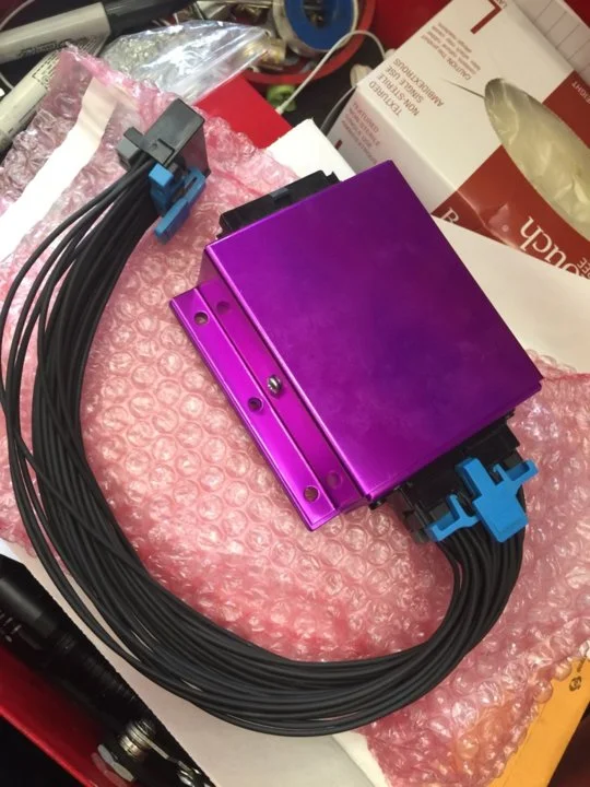

Yeah, I know they'll plug right into my injector plugs but does that mean that the injectors will be the imp that I need?
Best way is to run the number right on the body of the injector it will tell you. If you have the Pms you need andersons driver . I don't remember if you said you did but if not most real Stand alones do either or

I'm thinkin that he,( @stangboy ) isn't gonna plug an EV-6 injector into a older factory harness wired for EV-1's.
The EV-1 injectors used in OEM Mustang applications are high impedance unit's( 12-16 ohm) I believe. Obviously, the easiest way to tell what impedance the injector in question has, is to put an ohm meter on it and check it.

TOOLOW91 said:
Just changed the tps in this thing . Idles fine but breaks up I set all the settings in the Pms for it . At this point I think it's just down to needing a tune . I want to check for vac leaks first and then send it on its way .
So wait... are you getting it tuned by someone else USING your PMS, or are you having it chipped?
TOOLOW91 said:
Amateur mistake number 1000. Bought 60lb injectors and installed , tried to fire the car. It would barely run not even at all with my foot to the floor .
Thought maybe the meter was bad etc . Racked my brain . Run the part number on the injector to find I bought low imp injectors and forgot about it . So 260 later I'm awaiting the injector driver from Anderson .
D'oh!
It wasn't very long ago that I had this discussion with a newer member here. He responded with, "Well my buddy...". Ah well. He figured it out eventually. lol His setup didn't need anything larger than 42s anyway.
I believe they make the adapters .
I thought that it was a completely different connector?
Ford Racing EV1-EV6 Mustang Fuel Injector Adapter Kits M-14464-A8 (94-04 V8) - Free Shipping

Injector driver comes Thursday woot woot

Injector driver came we will now be in business
