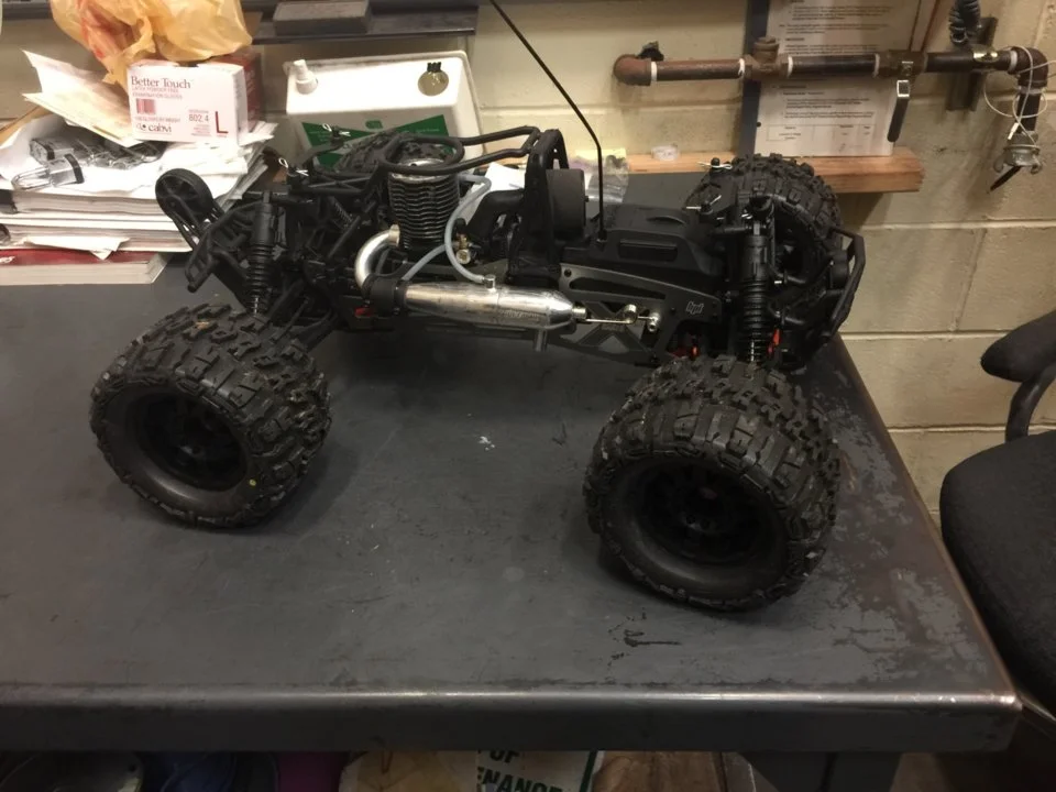

FYI: RC cars are expensive. Just sayin.
I had a t max like 10 years ago that I sold -FYI: RC cars are expensive. Just sayin.
My savage I got for 165 off with all the discounts I couldn't pass it up
- Dec 19, 2010
- 5,721
- 4,244
- 224
My savage I got for 165 off with all the discounts I couldn't pass it upalready did the full engine roll cage , wheels tires , splined hubs, wheelie bar and fuel tank mod lol .
They are fun. I have a buddy that has them. The nitro engines are cool, and they even make little superchargers for them. I stay waaaay away though. Too many expensive hobbies as it is.

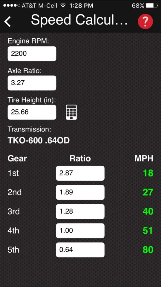

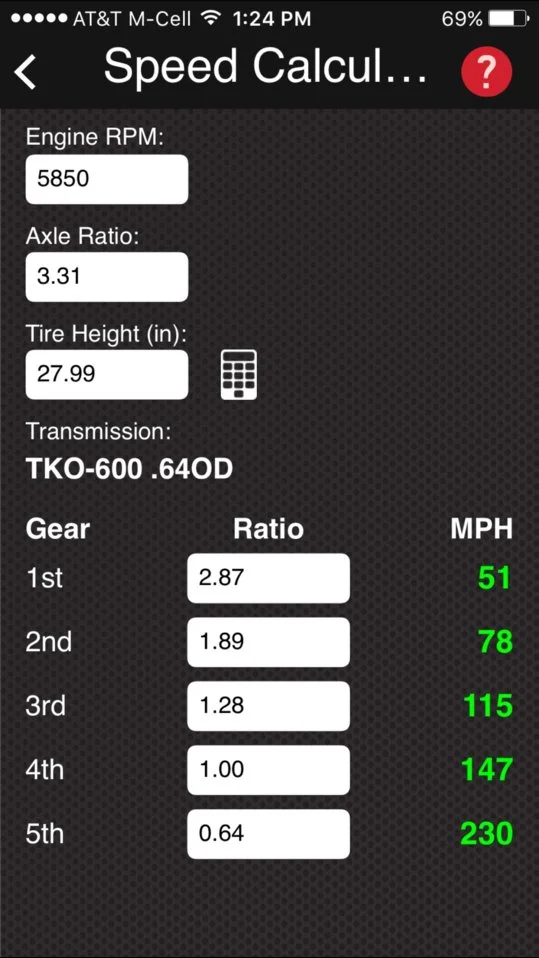

The other question is do i step down from a 3.55 to say a 3.31 or a 3.27 when i build the rear with the 31 spline carrier . Im thinking 3.31 may be the gear. But would like to hear more educated answers then mine. Sorry the pics are so big. @84Ttop @srtthis @Boosted92LX @hoopty5.0 @madmike1157 @A5literMan
Its always gonna be a street car. But will get some abuse at the track a few times a year. First gear is over right now before you even blink under full power. And eventually if it ever sees the YSI like i plan its gonna make 80 horse more if i had to guess.
Here is the calculations at the rpm I trapped last time I went to the track . I did it with a 17 and if I decide to throw a 275/60/15 on it which i would for the track.
This is at highway speed with the 17s

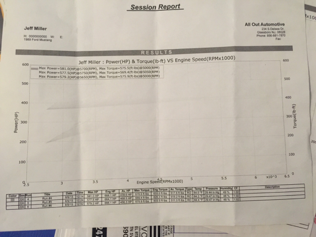

What rpm do you make your most HP and torque? And your examples have a self imposed 5850 rpm limit. Is that your shift point? Max rpm (which I doubt but just asking)? I think there is just a slight performance differential between the 3.27/3.31/3.55's. I do think the 3.31's would probably be the best compromise. First gear rips are going to be darn near impossible on the street no matter what(probably goes for 2nd & 3rd &...lol-Mr YSi).
I do wonder why you want to go the "big blower route" though. Because street car. I think you're being conservative on the power increase. I wouldn't be surprised if you see 650-700+rwhp(depending on pulleys etc). I'm sure you're traction limited as is. Lol. I'd probably keep it more conservative for more "street time". And I'm all for drag strip performance. Just asking?? If this is what you want to do??
Car pulls to 6k and peaked after 5k. The heads are the restriction big time here. 5850 is just where it went too on the first two shake down passes. We all agreed with the tune being super conservative 10.9 that day - inching up on the tune a bit but not being greedy and another 200 rpm on the shifts the car has 130 mph trap in it without a doubt .What rpm do you make your most HP and torque? And your examples have a self imposed 5850 rpm limit. Is that your shift point? Max rpm (which I doubt but just asking)? I think there is just a slight performance differential between the 3.27/3.31/3.55's. I do think the 3.31's would probably be the best compromise. First gear rips are going to be darn near impossible on the street no matter what(probably goes for 2nd & 3rd &...lol-Mr YSi).
The blower comes down the fact of the s trim just is never going to be as efficient as a ysi is . Going to a ysi will not only give me the room to grow way past what ill ever make but at the level i plan on staying at will make it much more effcient and create way less heat.
When I was trying to determine what gear ratio T56 I wanted I used these calculators and looked for 3rd/4th rpm sweet spot at 35-45 mph since you have to be able to drive in that around town, I balanced that with 2k +/- rpm at 65 +/-mph upto to the 75 we all run on the interstate, since thats a general around town and long haul interstate speed, you could do same for rear gear if you trans ratio is set....My SOP says it worked great, 1st is a little quick but speeding in1st and getting there fast, hey thats fun
