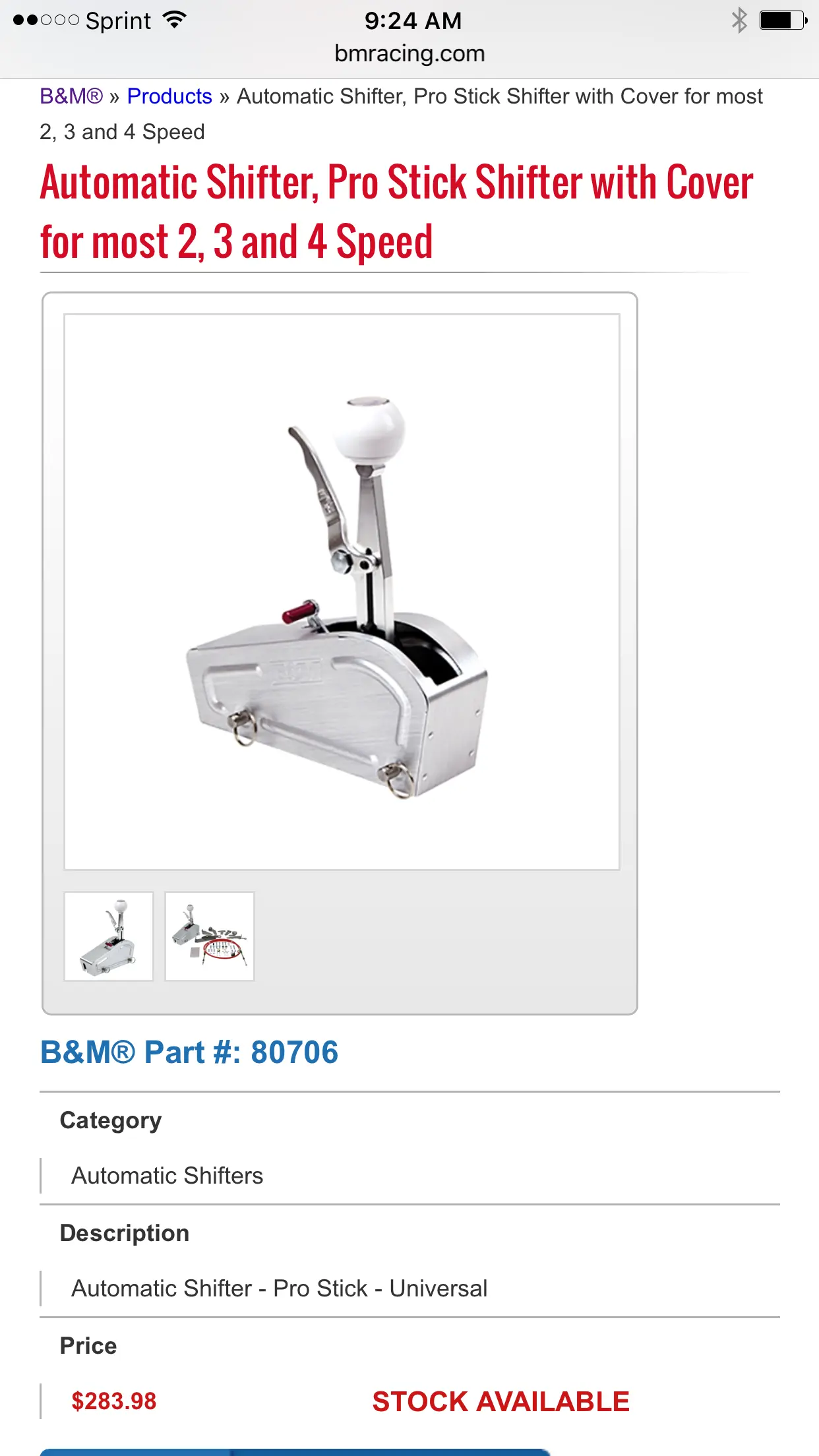

I had one of these in my 79 with a manual valvebody c4 Jeff. It was fun, that car was a handful.. So the whole manual trans thing wasn't missed. Lol
My favorite auto shifter of all time. If I ever go back to auto, I'm getting another one.
