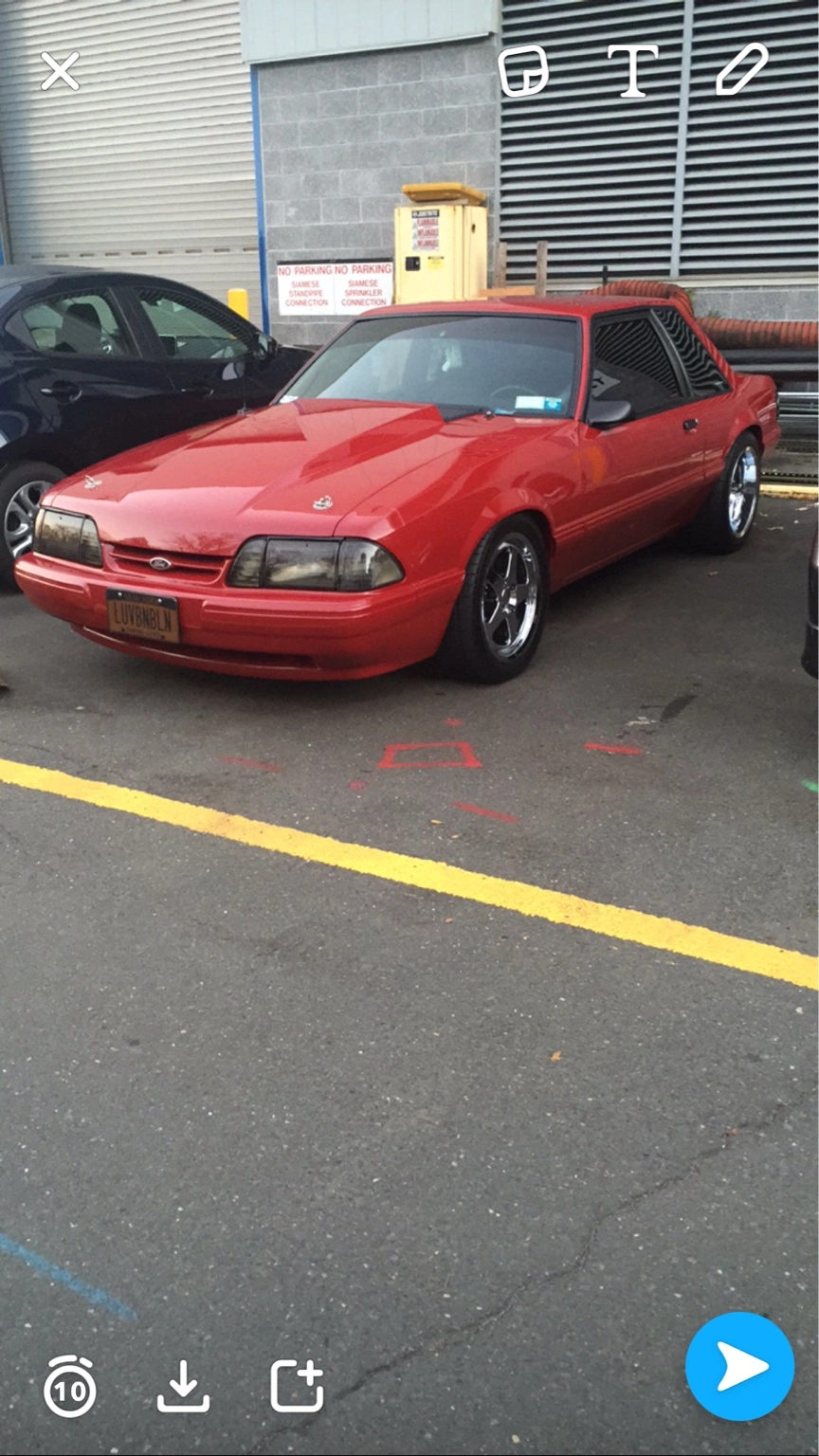

Getting there .

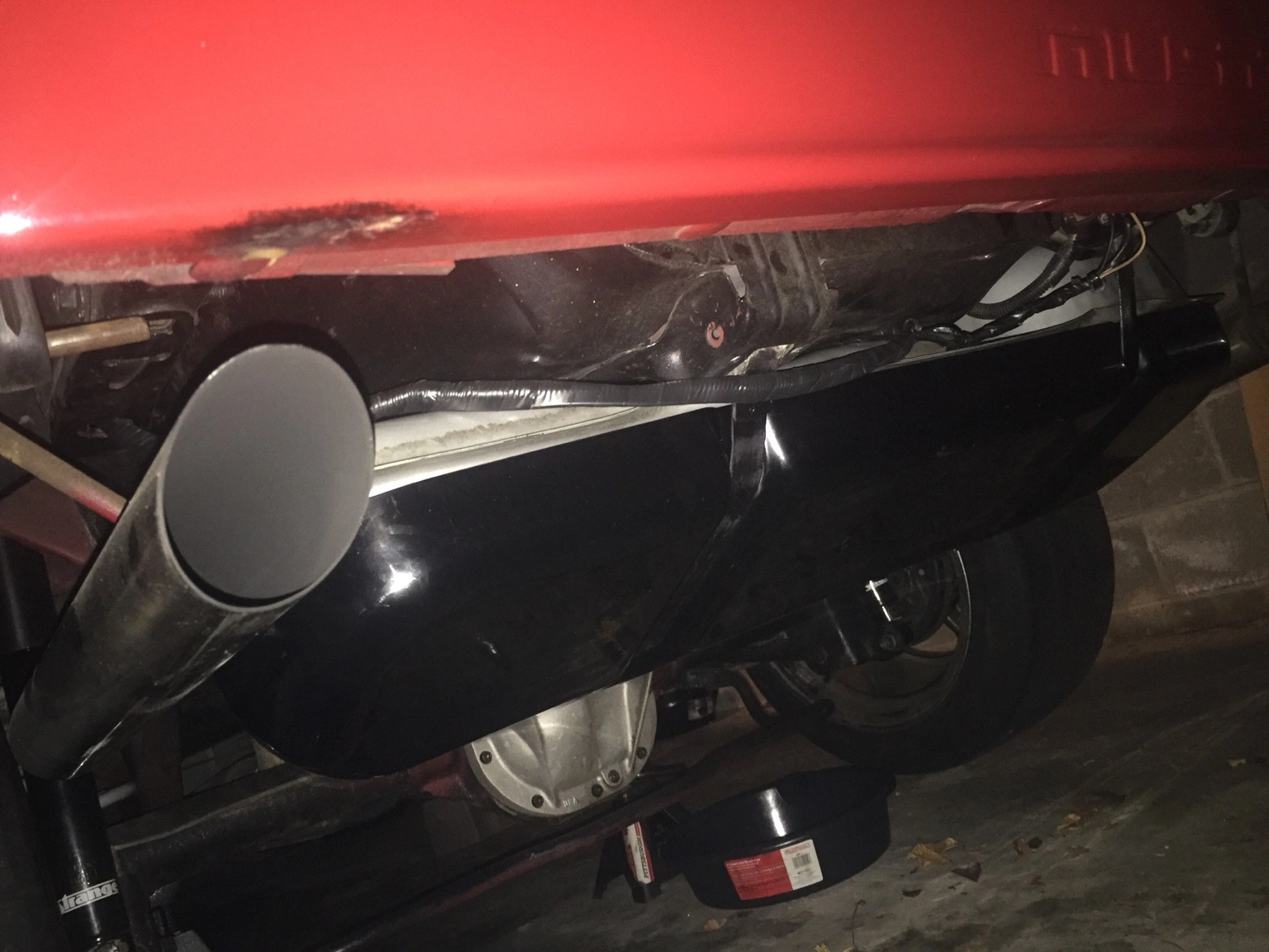

Sent from my iPhone using Tapatalk

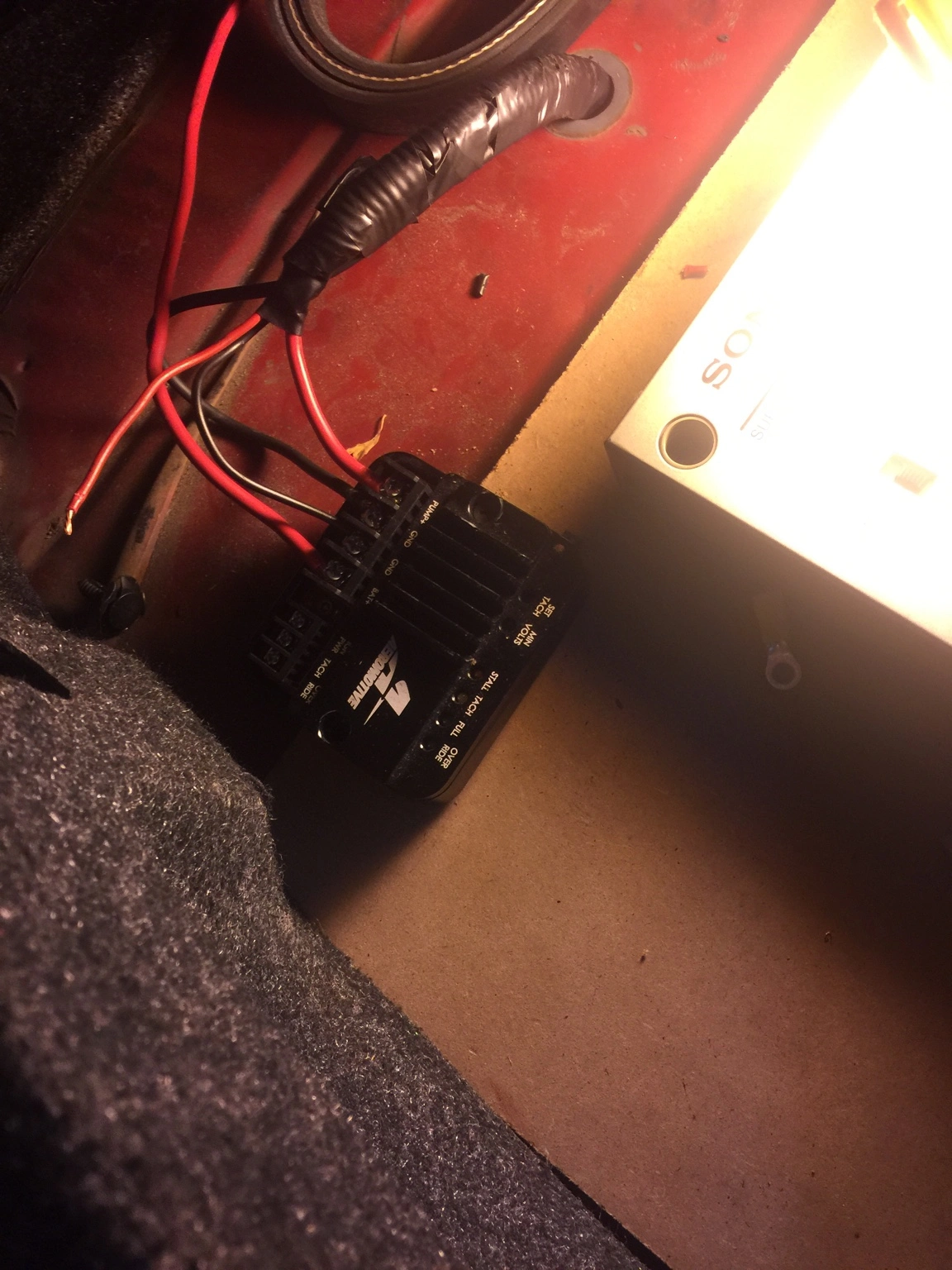

Tank is in . Has fuel . Pump primed with the controller wired in . I ran the rpm signal from my msd box in the very front of the car . What a pain in my ass . But it's in . Loomed under the hood and hidden. Time for bed .

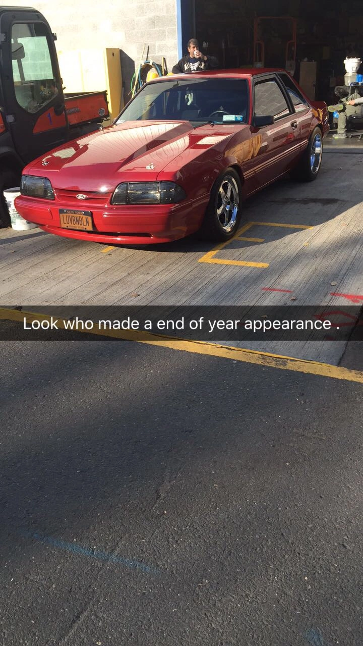

Fixed a little hiccup where the pump wouldn't prime cuz the 12v signal wasn't clean enough to the controller.
Drove it to work yesterday obviously . Drove it today too like daily driver status. Pump is so quiet . Fuel gauge working . I'm pretty happy right now .
Aeromotive tech got in touch with me . Had a long convo . That dude really redeemed the company with me .

THOUGHT * i fixed the hiccup. Once the car is warm and you go to re start it it does the same thing where it puts the controller into safe mode. The only thing left is that it maybe doesn't like the old pump ground as its main ground. So i am gonna add a ground to chassis. If that doesn't do it then there is an issue with the controller.
