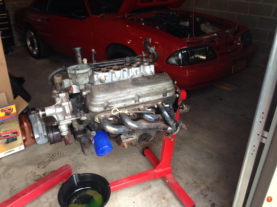

TOOLOW91 said:
more meaningless progress it's on the stand
It may seem meaningless but for anyone who's done it (alone) knows that it's a lot of work to get it there on that stand. I just wrestled mine out of the back of my truck last night and it took a while because it was snowing and my driveway was slippery and the canopy on my F-150 was getting in the way of the boom extending upward.
I have a question to you (or others that know). What size bolts did you use to bolt the stand to the back of the motor? Are they 7/16" SAE? I have the same HF stand but mines the 1/2 ton.
7/16-14 . also i used a 4 in bolt with washers i could not find a 3.5 in bolt and 3 in was too short

progress I'll just leave this here

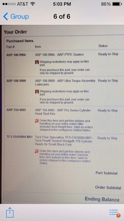

Jess I was scrolling down the picture but didn't find the part where it said the total @TOOLOW91 lol
