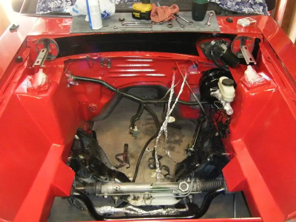

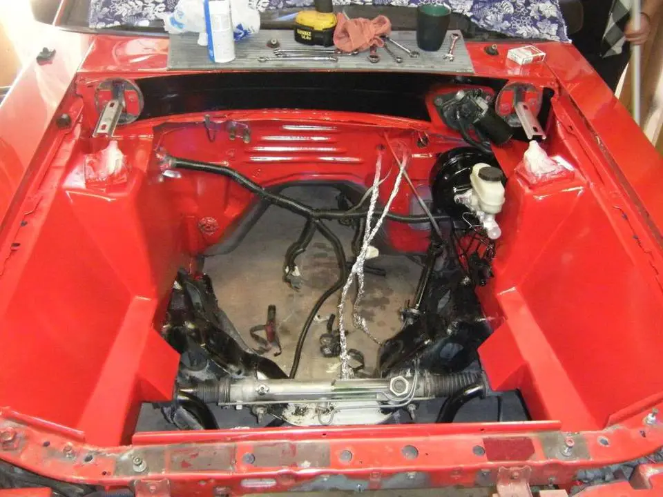

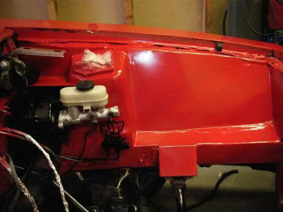

Well didnt get much done today fighting a head cold :( I did get the firewall panel colored and mocked up.Got the mastercylider in painted and the brake lines attached and painted.Untapped all the wiring and then reloomed them all with new loom,installed the hinges and i think thats about it? Antone know who sells the new boots/weather striping the hinges sit in?

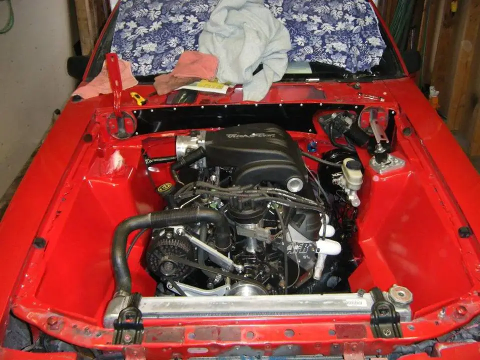

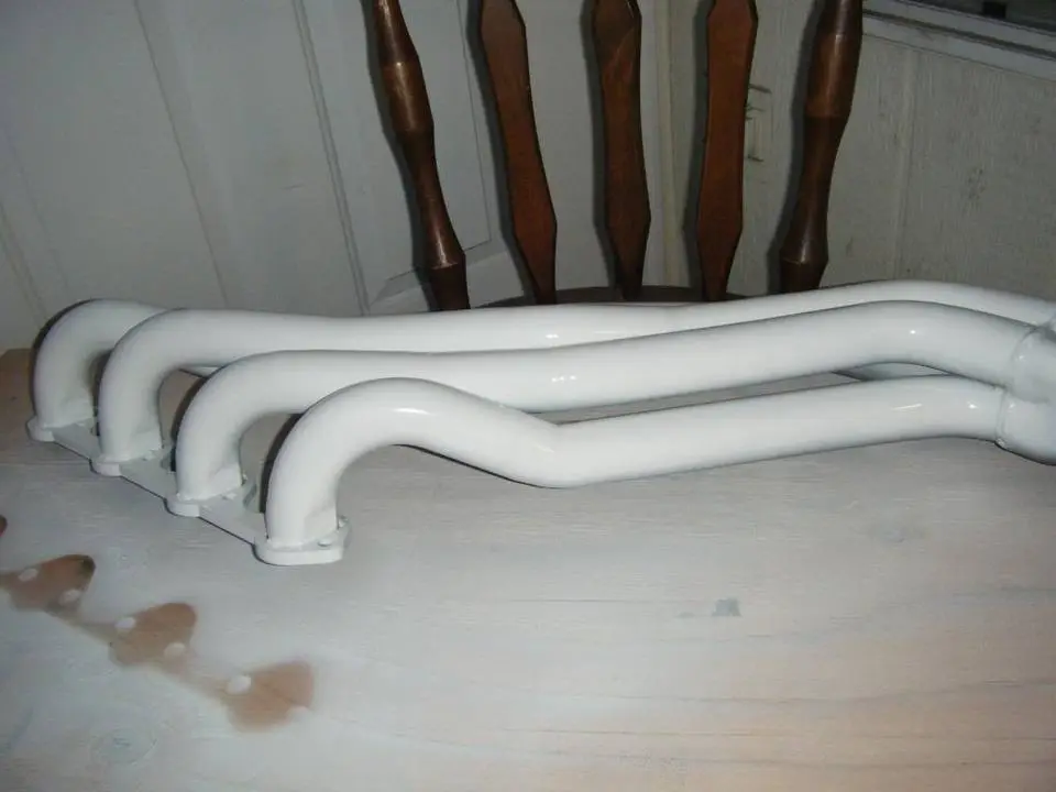

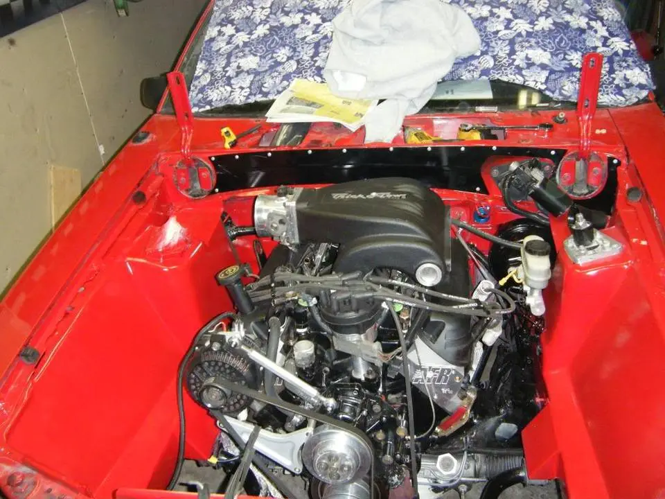

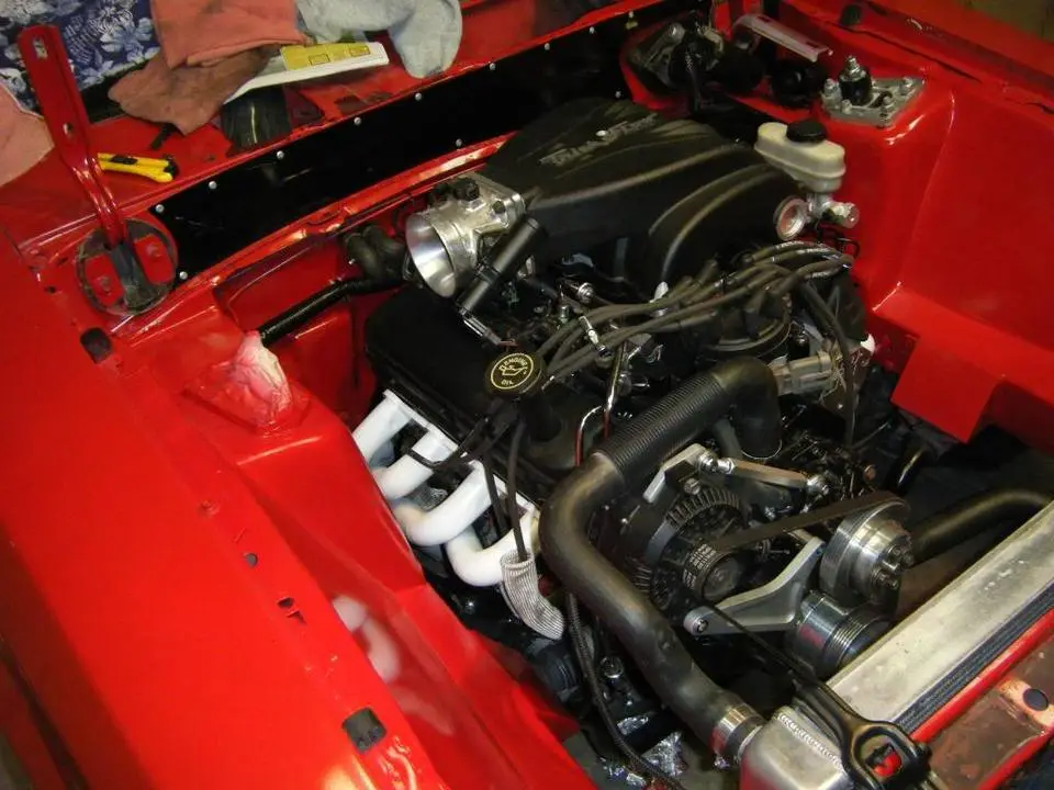

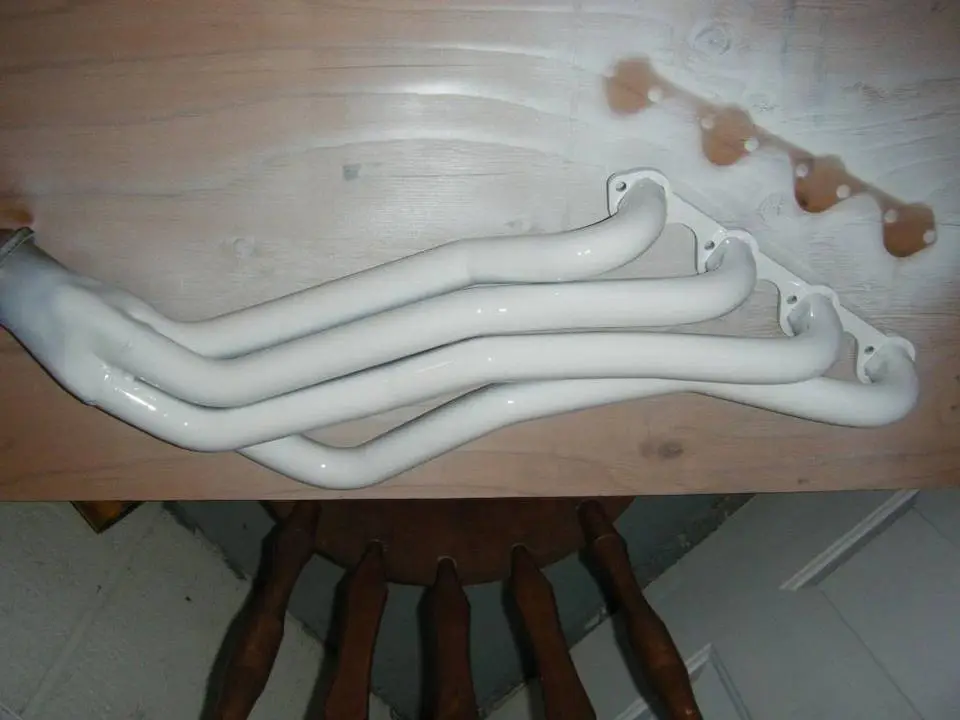

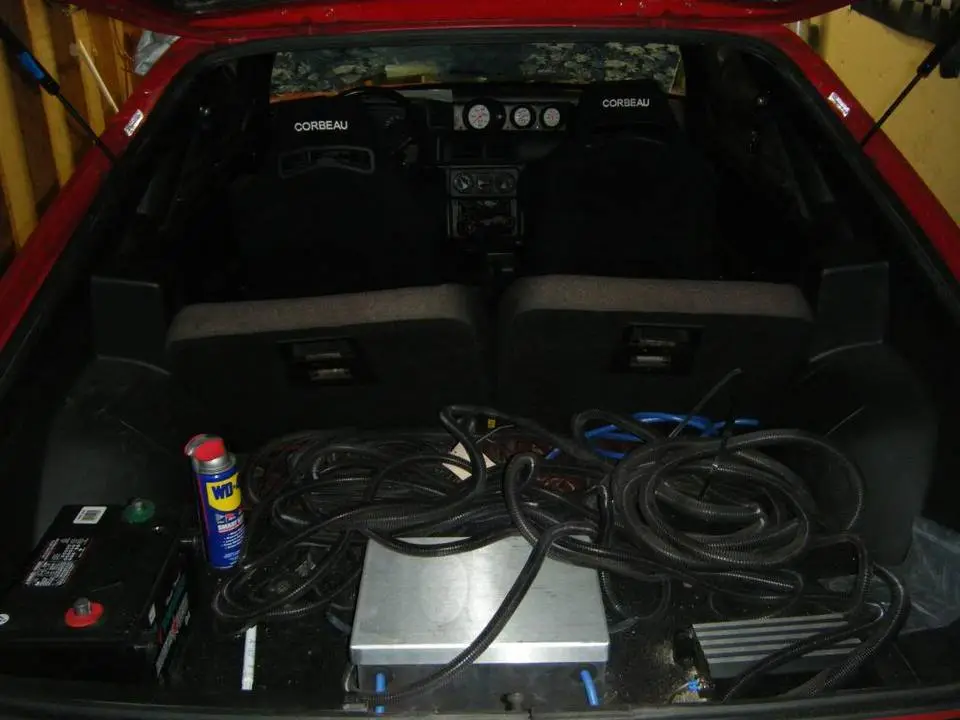

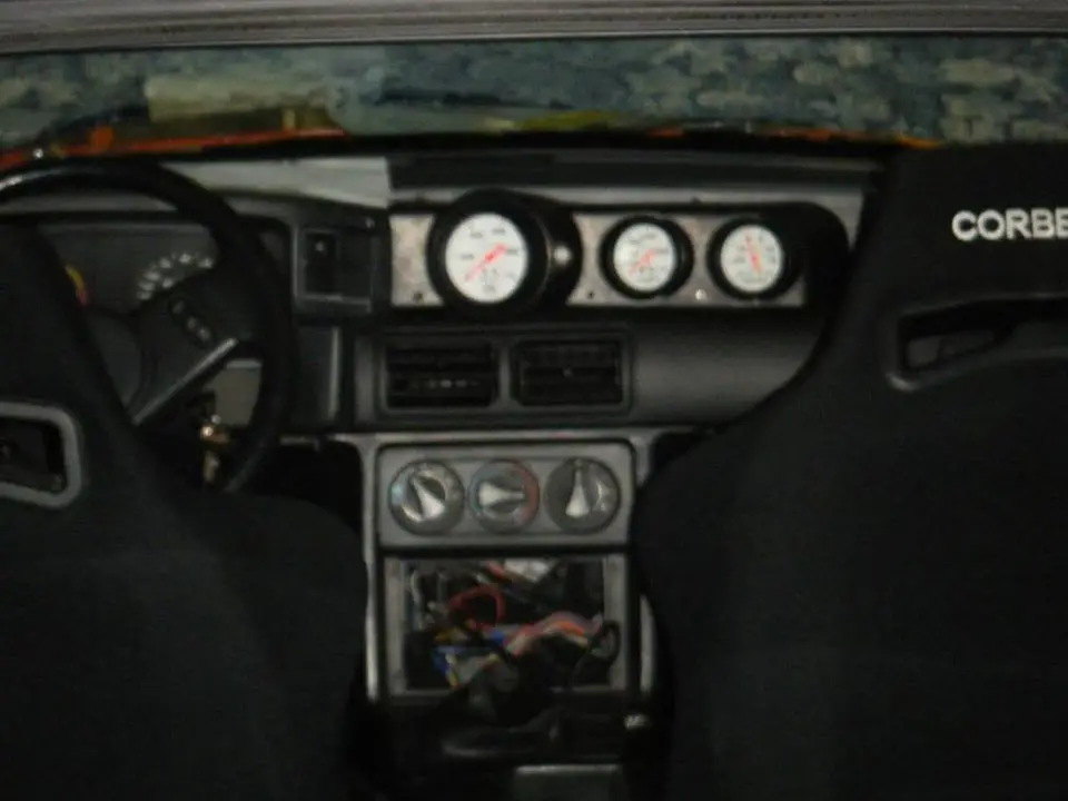

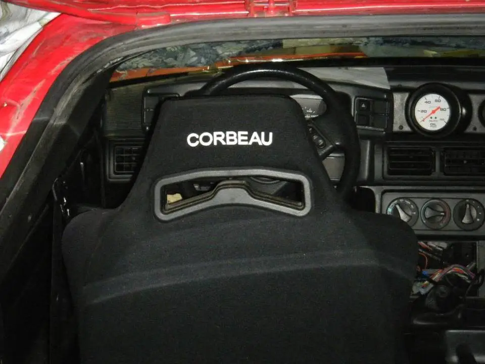

Well the day started bright and early at 6:30 AM thanks to DNADOA :D Worked on it till about 2 and took a nap,got up picked my daughter up at 4 from school and went back out for about 2 hours.So heres what we/i got done. Bleed all 4 wheel brakes,rivited in the firewall panel (after a few scratches :mad:) installed the motor,then i took the bell housing back off cause the headers wouldnt go in with it on,Found out they will from the bottom with the bell houseing off. I have taken my chances and painted them with dupli color high temp (1200*) with ceramic paint. Hopefully they will hold up? if not it's off to jet coat. Jet hot coat wants $280 for show polished finish plus shipping to and from to AZ but they dont offer white :( like i want.I really think the white will BAM with the black engine and red bay!?Here are a few pics and also a few of the interior.Tomorrow i hope to install the headers,run the alt wire from the battery, mount the coil,install the trans,drive shaft,exhust,put the new oil filter on and fill it with oil,install the radiator and top it off. Then thats it till i get an electric fan :(

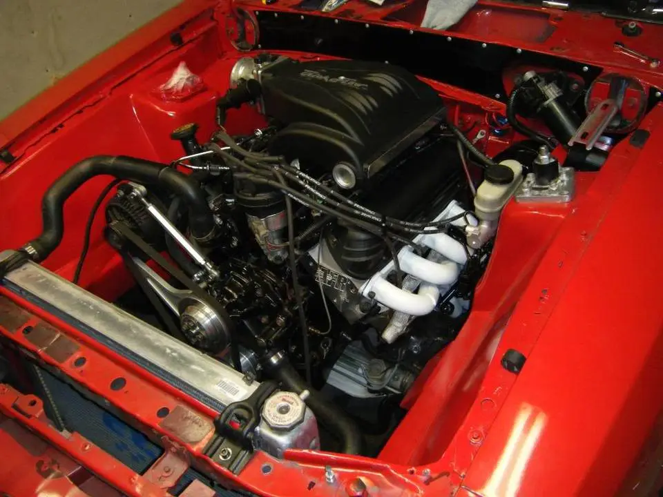

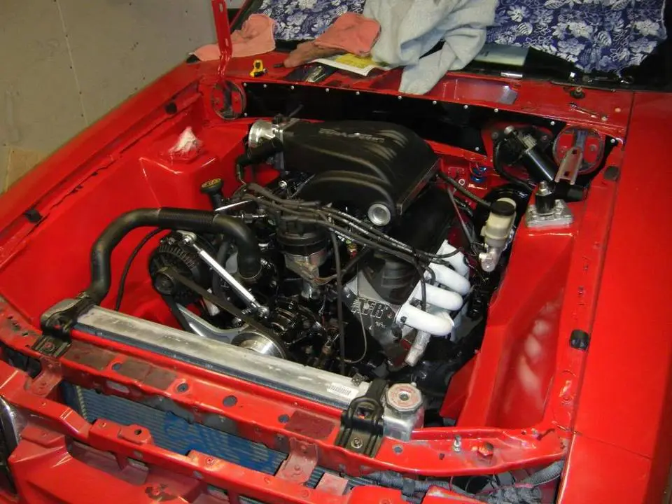

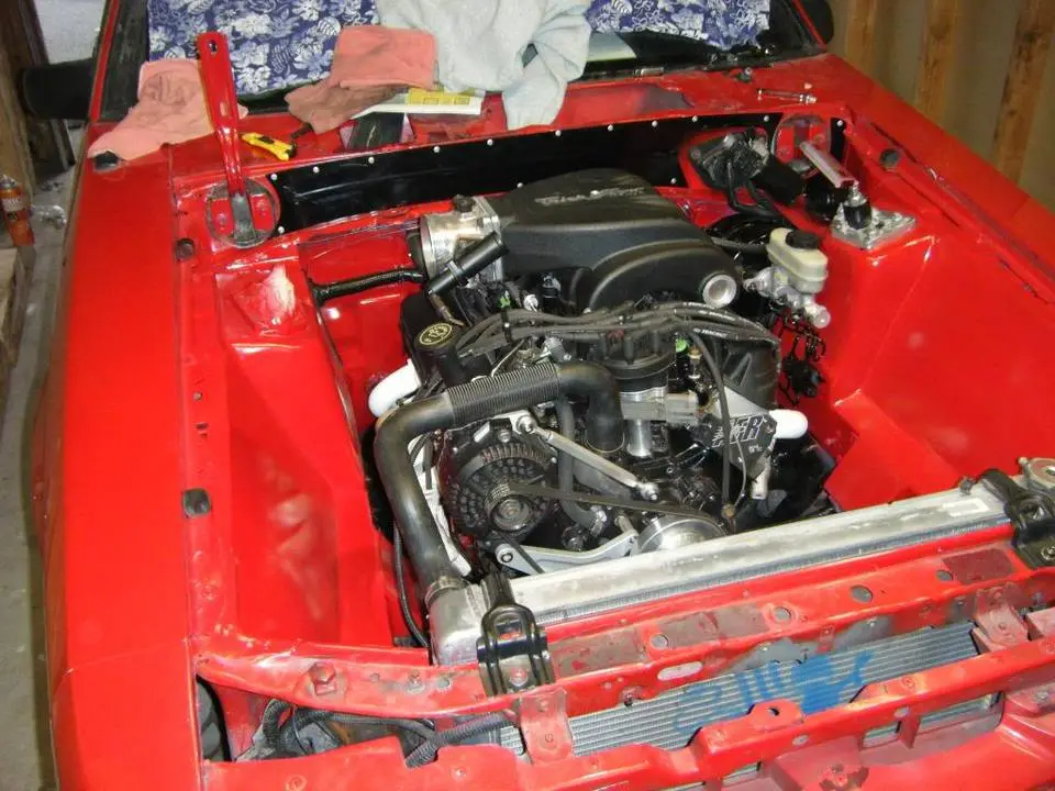

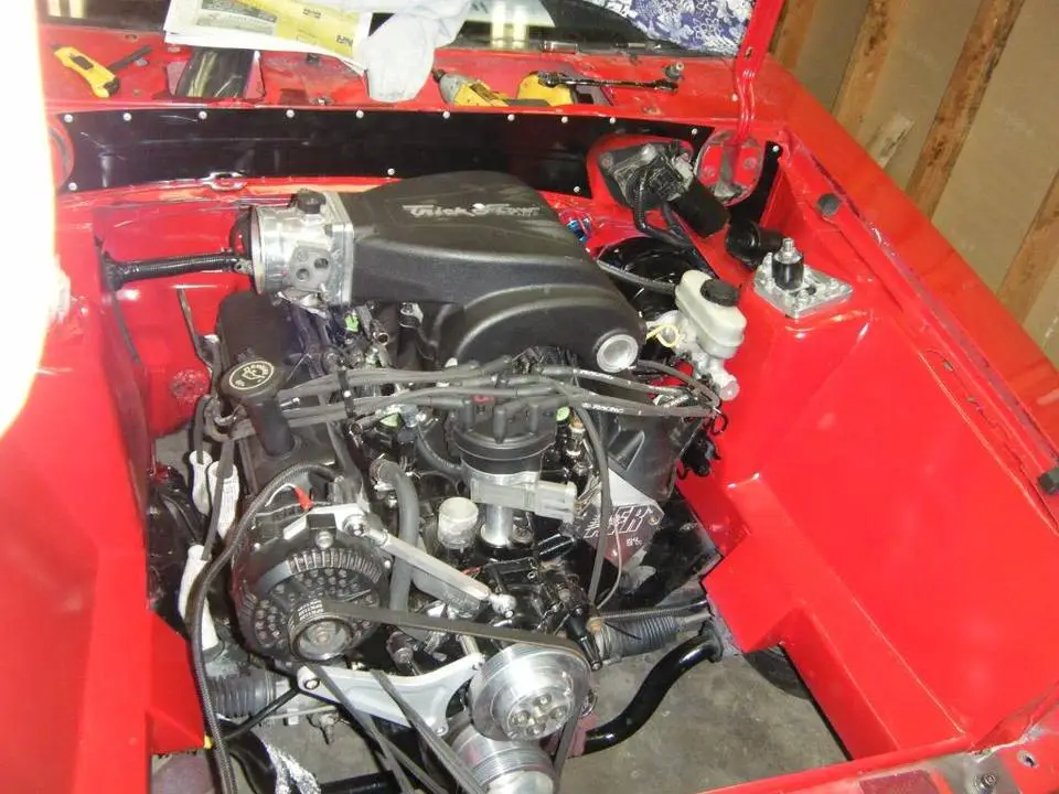

Picked up a fan today but the dam thing is way to big, so tomorrow i'll take it back and get a tauras one. Today i got the trans in headers on radiator in alt hooked up.Tomorrow i'll get the correct fan, install the driveline, hook up the + for the alt, hook up the MAF wire,hook up the coil, hook up the clutch cable, install the shifter, and fire it up!
