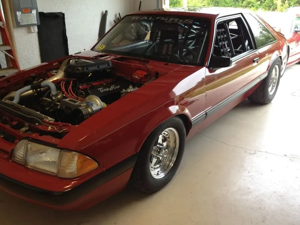

I'm running a CHP Big Bore 427" with TFS 245cc High Ports, TFS Box R, and a Flowtech TLSR cam. I've only made two shakedown runs so far. (just got the car running) It ran 155mph in the quarter on an easy hit. This combo made more power than you can really use on the street. I love it.
Is it okay if I worship your car for a second? Lol that thing looks soooo killer haha. Congrats on an awesome car. Where did you get your cam?
